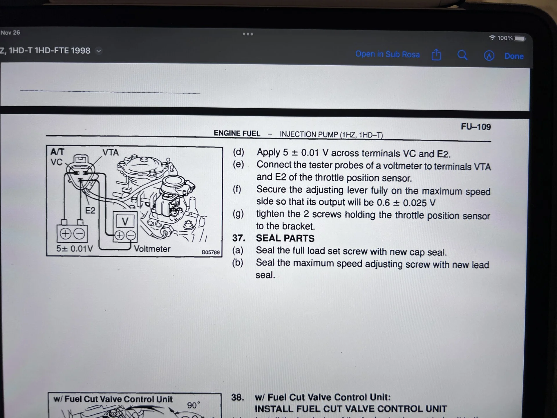

Finishing up my boost compensator install and came to the portion where I need to install the Throttle Position Sensor (TPS). The FSM states I need to supply 5v to terminals VC and E2.
My question; Whats the best way to supply 5v? Or is there a better method?
I added the boost compensator without electronics. I didn't know there was one available with a TPS.
Details on mine below in the signature.
The compensator itself doesn’t come with a TPS but since I have a 1994 with a auto trans, its part of the trans ECT system controlling shift points and kick downs (when adjusted properly that is).
