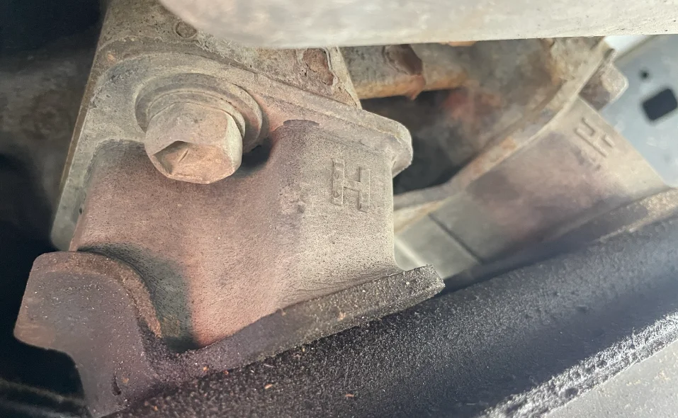

I've come to the conclusion that a rear trans mount does not exist for my 1992 HZJ77 automatic.
Here's what it looks like:
Has anyone ever seen this mount? I can confirm that it is NOT any of the following mounts:
12371-58060
12371-58010
12371-58021
12371-61020
12371-61031
12371-17010
12371-68041
My closest guess is this mount: 12371-17080. The end edges are different.
12371-17020 is the correct part number and that's discontinued.
12371-17080 is for an R151F manual transmission but it might work. Buy one and see.

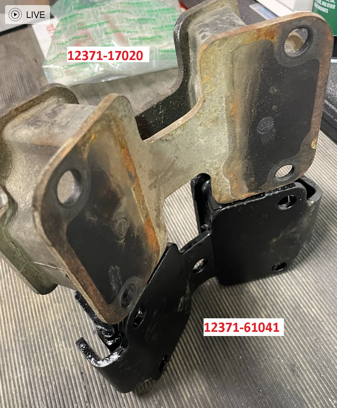

For anyone interested (i.e. all 8 people that own an automatic HZJ77), I finally resolved this.
Cruiser Outfitters (@cruiseroutfit) helped measure a bunch of their inventory. I'm grateful to them.
12371-58060 - does not fit
12371-58010 - Cruiser Outfitters measured no
12371-58021 - Cruiser Outfitters measured no
12371-58031 (EGM58030R) - Cruiser Outfitters (NLA)
12371-61020 - Cruiser Outfitters measured no
12371-61030 - Cruiser Outfitters measured no
12371-61031 - does not fit
12371-17010 - for manual HZJ77
12371-17020 - for automatic HZJ77 (NLA)
12371-17080 - close fit
12371-17110 - NLA
12371-67030 - does not fit
12371-68050 - does not fit
12371-68051 - maybe

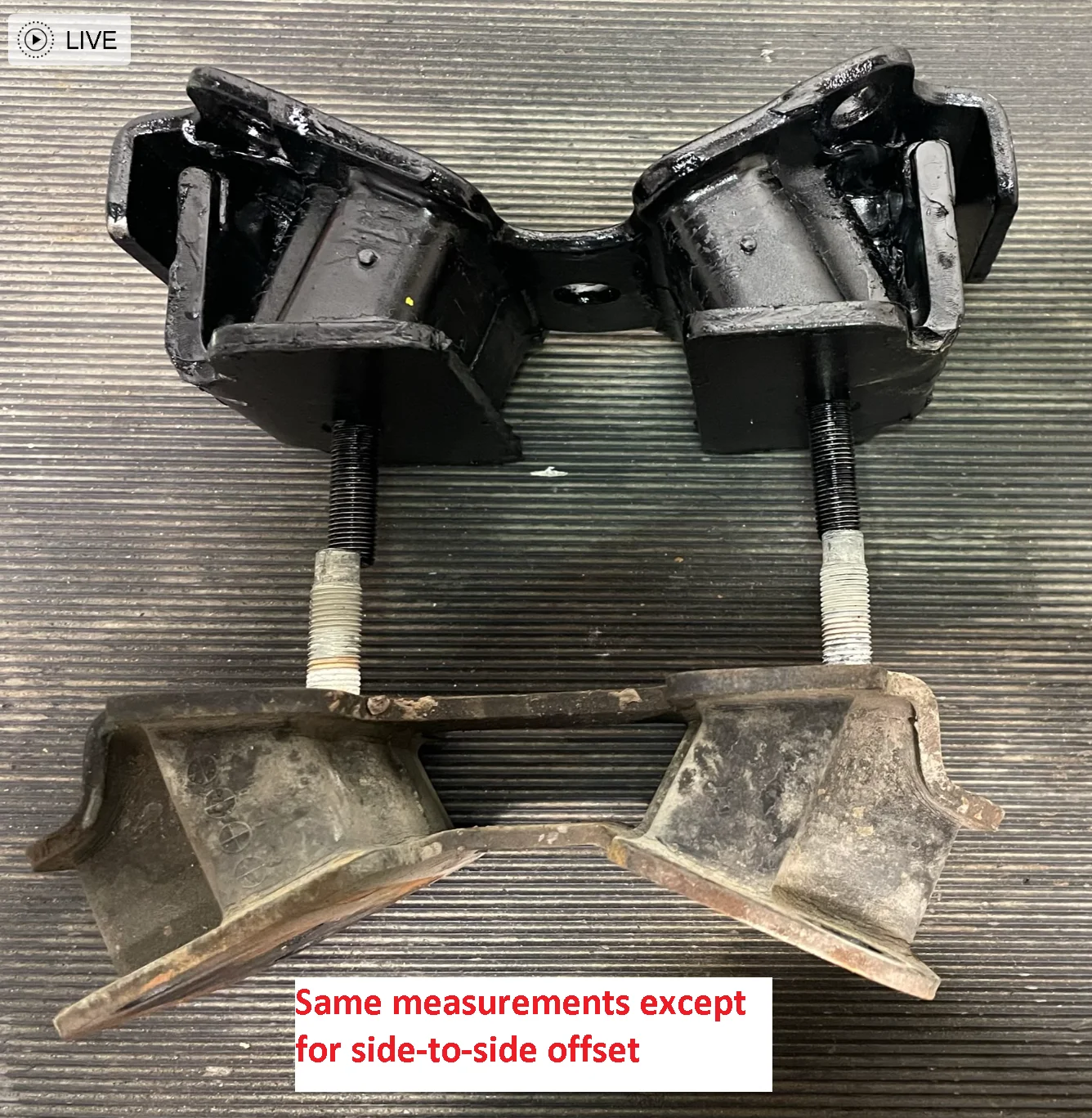

12371-61041 (EGM61041R) - fits with offset
I found an old post from Kurt referencing the same issue.
' BJ74 engine mount - https://forum.ih8mud.com/threads/bj74-engine-mount.858487/page-2#post-11099841
Using that information, I tracked down a 12371-61041 (Cruiser Outfitters EGM61041R), and it fit great:
Had to oval out the cross-member points a bit, and it fit perfectly.

@Fishbulb I used this:
It's a Taiwanese (?) rubber company repro, and the 2 bolts that mount to transmission crossmember were not exactly correct, so I had to open up the mounting holes, but otherwise it was the only option I could find. I tried other Toyota part numbers but they would not work.
