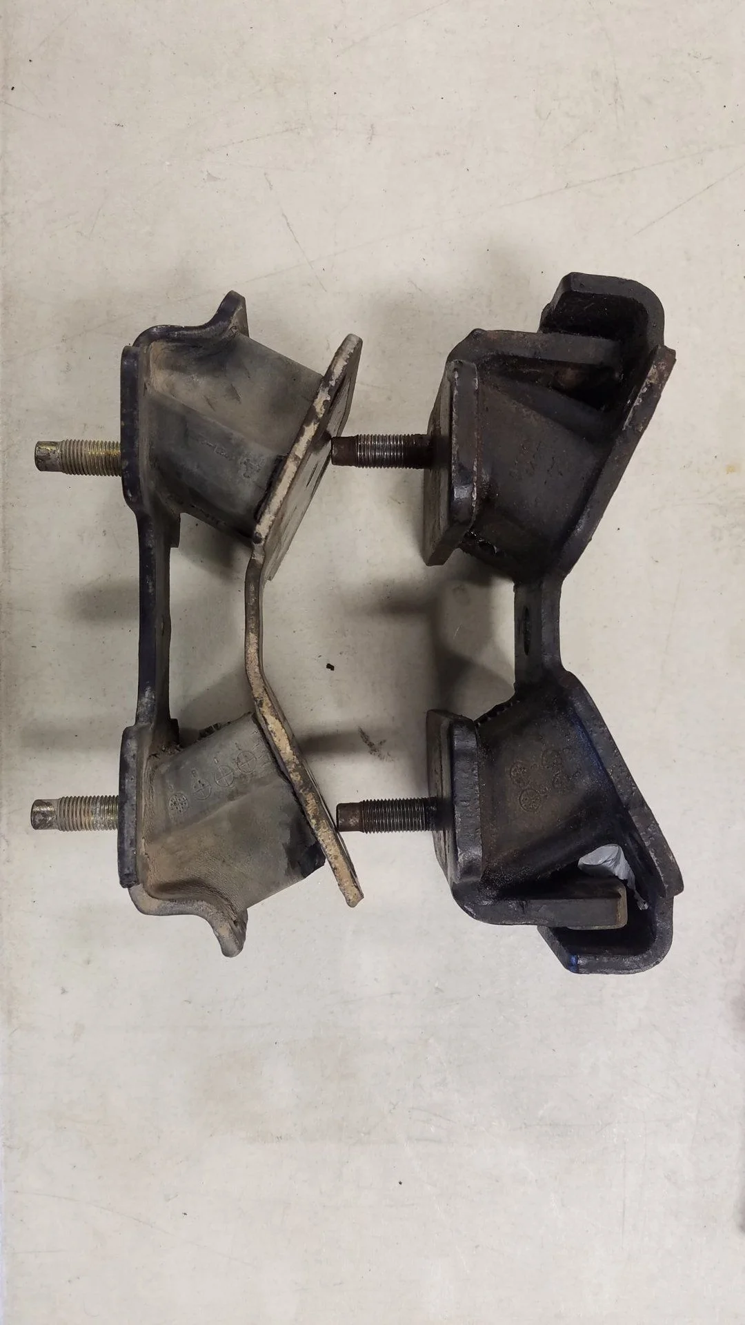

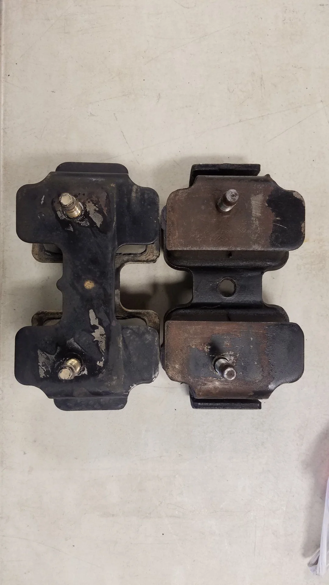

Fwiw, the FJ62 mount (12371-61041) is a good fit. The stud location on the bottom is off by ~5mm and requires just a few minutes of massaging to fit. Sadly both the 58031 and 61041 are discontinued OEM. We have an aftermarket solution for the 61041 and are working on a solution for the 58031 proper too.
I was doing a last minute CruiserFest prep on my BJ74 (auto) and found a torn mount. We looked at a half dozen mounts from a similar era (early FJ60, FJ80, BJ40, BJ60, etc) and found the FJ62 the best fit, identical on the top at the trans and withing 5mm on each stud. I ovaled out the holes ever so slightly on the cross-member and it dropped right together. The FJ62 has more surface area and "flaps" to prevent side to side movement in the event of failure.
Comparison of the 58031 (left) & 61041

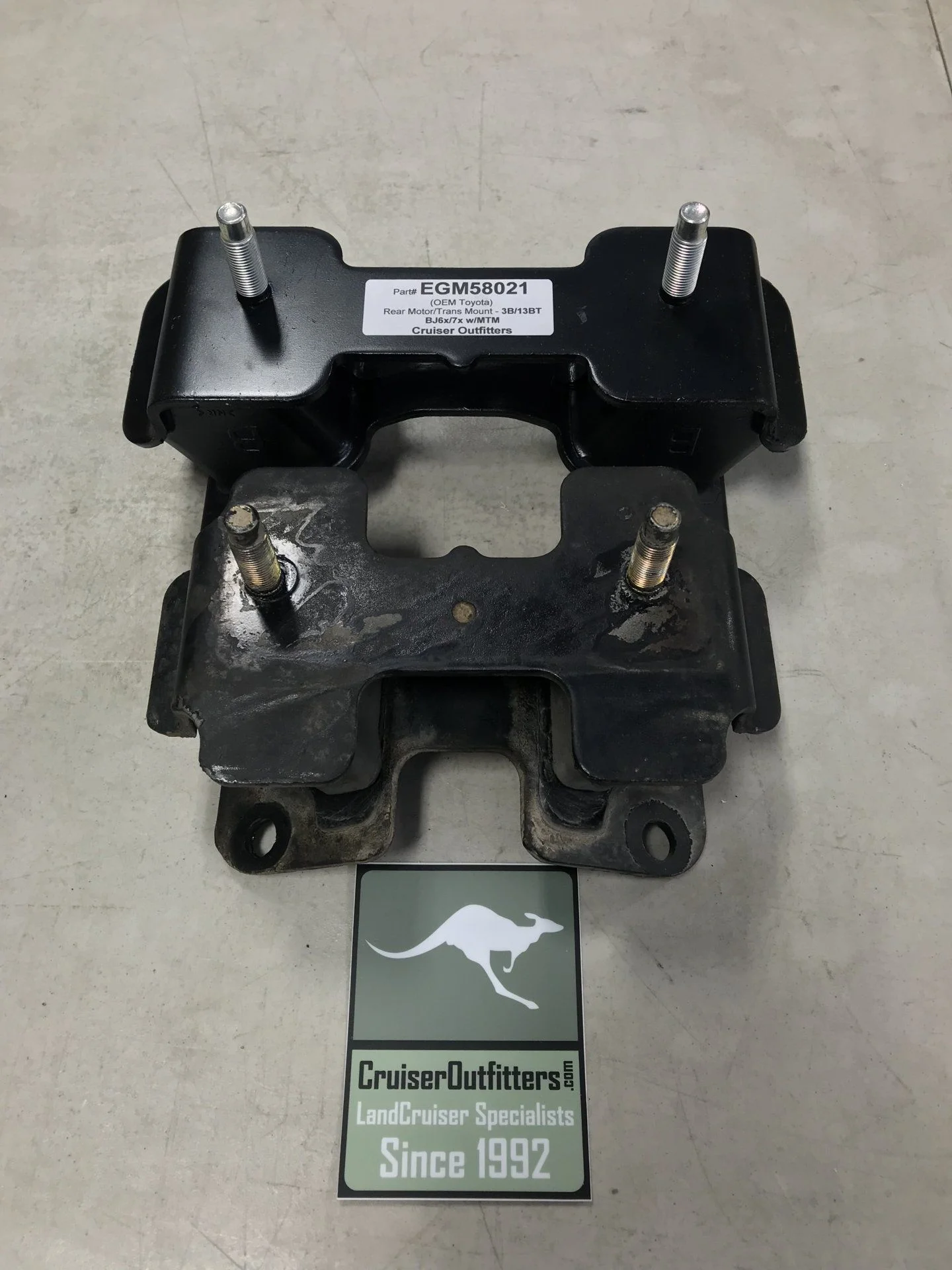

Might want to try 12371-58021 if you have one lying around. Bolt holes might be too wide though on the top side.
Way too wide on the top and bottom unfortunately.

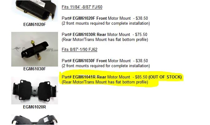

I'm out of the shop at the moment (en route to CruiserFest) but I know as of last week we didn't have any of the 12371-61041 in stock but will have more en route soon.
