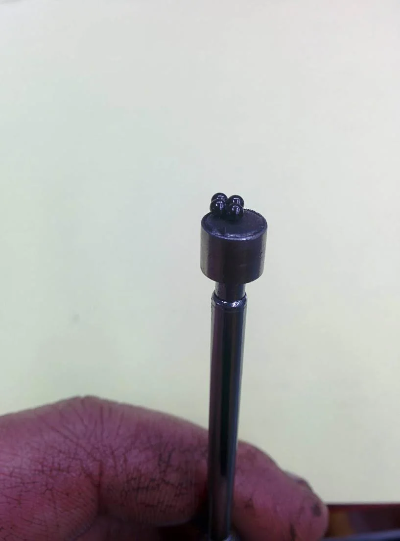

Governor shaft bearing came apart. Tiny ball bearings through the pump = carnage

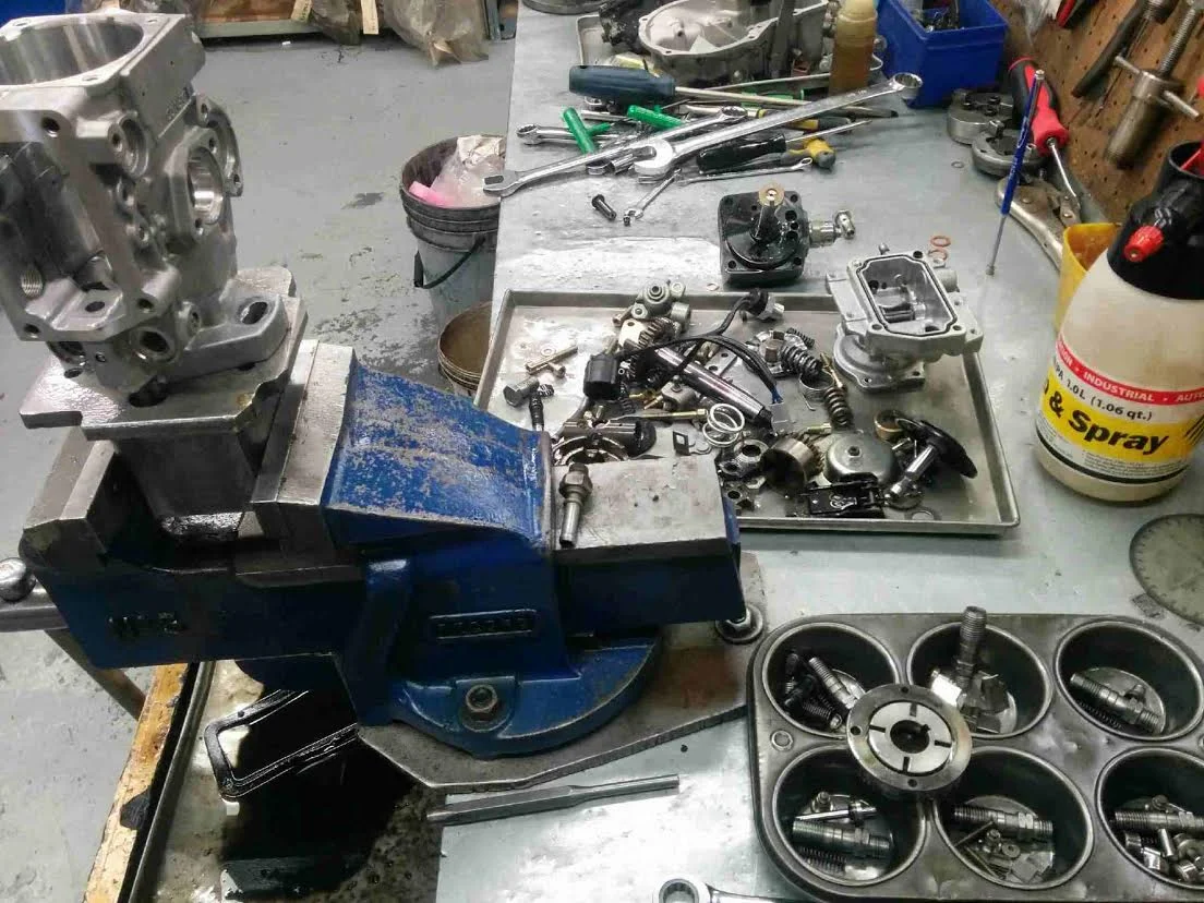

Lots of other little mistakes as well.
Lots of damage. Needs a new housing. The advance piston pin broke in two.
Had to beat the piston out. Piston is fxxxed.

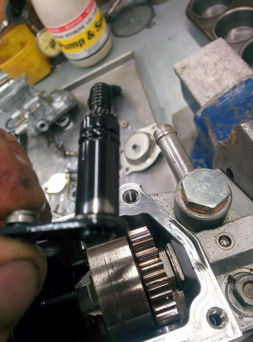

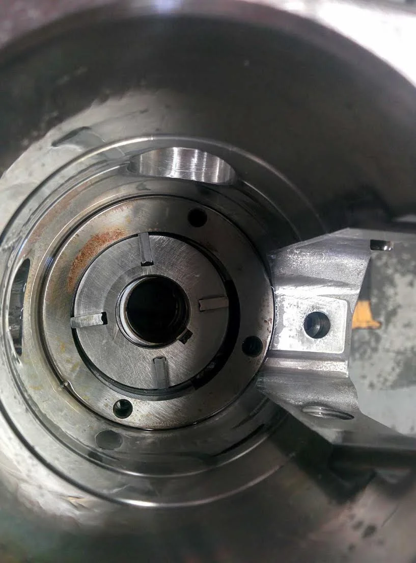

Weight carrier is all carved up.
Funny thing, nothing looks new considering you ran it for about a week.
Throttle shaft and supply pump look older than that.

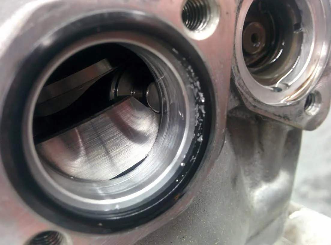

Rust on the supply pump liner already.

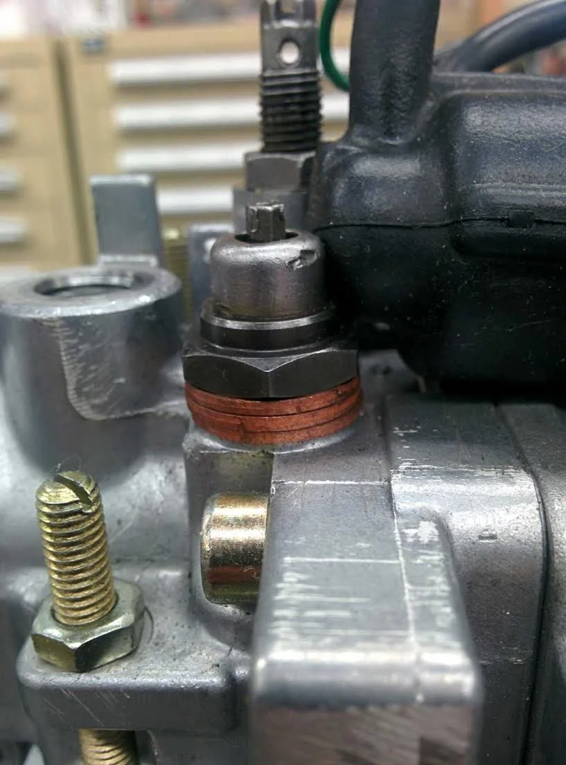

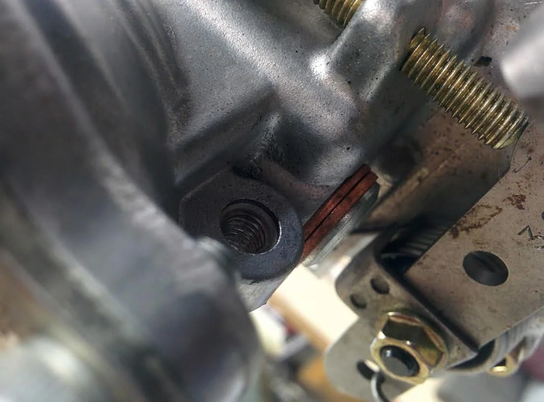

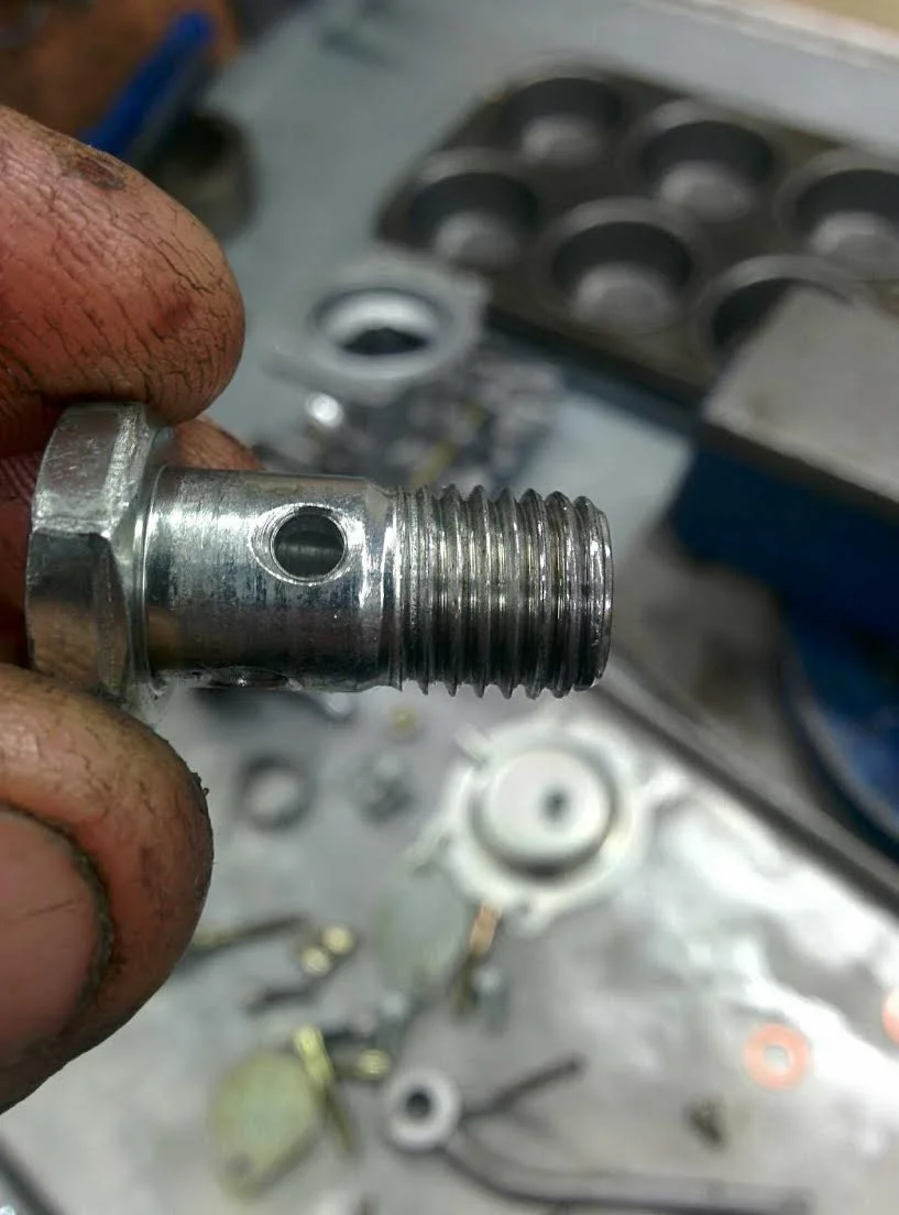

The wrong inlet bolt. That is why it couldn't be tightened.
I put a VW feed into it and it threaded in perfect. Strike two.

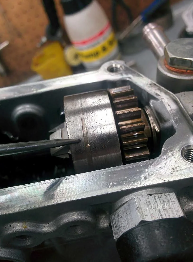

Grooves on the weight carrier.
The throttle shaft wear. Not bad but not brand new.
The black is a face hardening and its only riding on an aluminum bore.
more metal on the acsd hole

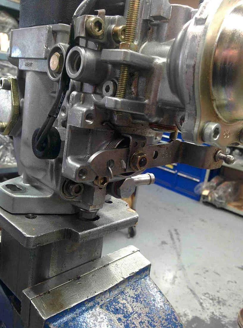

You can't really see the idle screw, but its like out an inch and the high idle stop is backed off all the way. They are supposed to be almost even. Ill put a proper spring in so its right.
None of these were even touched by me mark. Idled at about 800rpm and I was about to do a tune on it when I had a break from work. Then this all happened.
What happened was they probably used a high mileage used bearing in the governor sleeve.
It came apart and sent the ball bearings flying. I found five. Looks like the circlip failed or it wasn't even installed correctly.
Bosch uses a solid bearing-less sleeve....

I wouldn't have ever guessed that it was what failed. Me and the boss were wondering where the fxxx the balls came from and the peices of the circlip.
Then we looked at the sleeve. Looked completely intact until we pulled it apart. Pretty hard to fake this.
Not sure why ther are used bits in there, the bearing discs aren't even lapped.
If I use used stuff I at least try and make it look and work like new at least.
