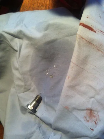

The pump after a HUGE headache fiasco is not going to Australia and is back in safe hands (Canadapost lost the parcel in Canada with pump and injectors on the way to Straya for 2.5 months)
Stay tuned on what is found.
