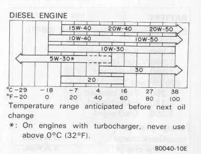

For my 12 years of ownership, I ran 10W30 Shell Rotella in summer and 5W40 Chevron Delo in winter (it can get really cold up here!). I NEVER had any problems and the engine was strong as can be. I used to change the oil every 5000km (3000 miles) sharp. More importantly, I used original Toyota oil filters in every oil change. (I bought them by the case)
This oil chart is from the 1HDT manual.
This chart is for conventional oils. Surely it should be updated for modern synthetics. AMSOIL Deisel Oils are up to 2X OEM intervals - No less than one year regardless of mileage.
