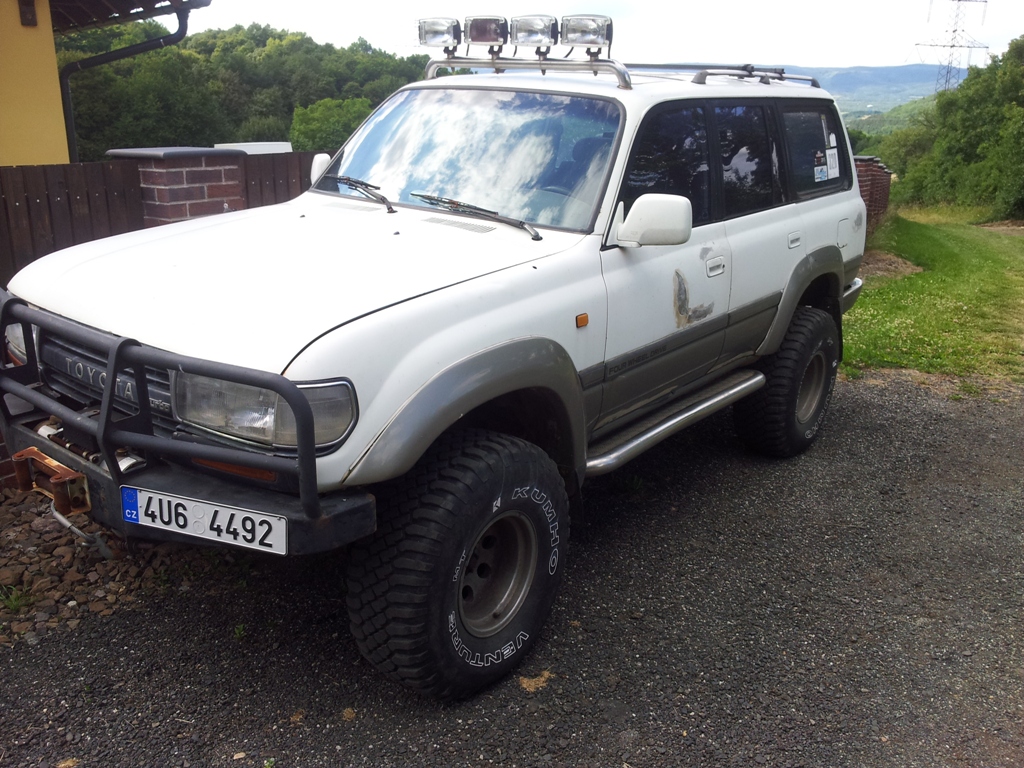

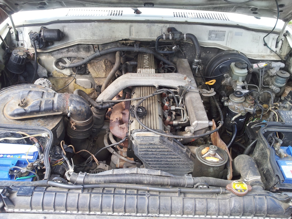

This is the machine itself:
If the steering wheel is on the same side, and have the same type on trans (auto or manual I mean) its fairly easy. Some wiring involved, but if you have an entire donor vehicle, the mechanical bits are bolt on.
Steering wheel on the same side, trans is different - i have I believe A343F automatic while the car has manual transmission.
Is the engine 1hd or 1hdt ?
That's a 1HD-T, no doubt. Like Tweeek said, if you have the whole truck it's not too bad. I'd stick with the manual trans tho and source the clutch parts if they are different which they probably are. They're not too hard to get from the UAE or several other locations.
No such thing as a 1HD, that would be the 1HZ (non-turbo diesel) which has a different head (IDI vs. DI), but pretty well the same bottom end as the 1HD-T.
There is no A/C there ? What the heck , I am sticking to 1fz-fe :(
