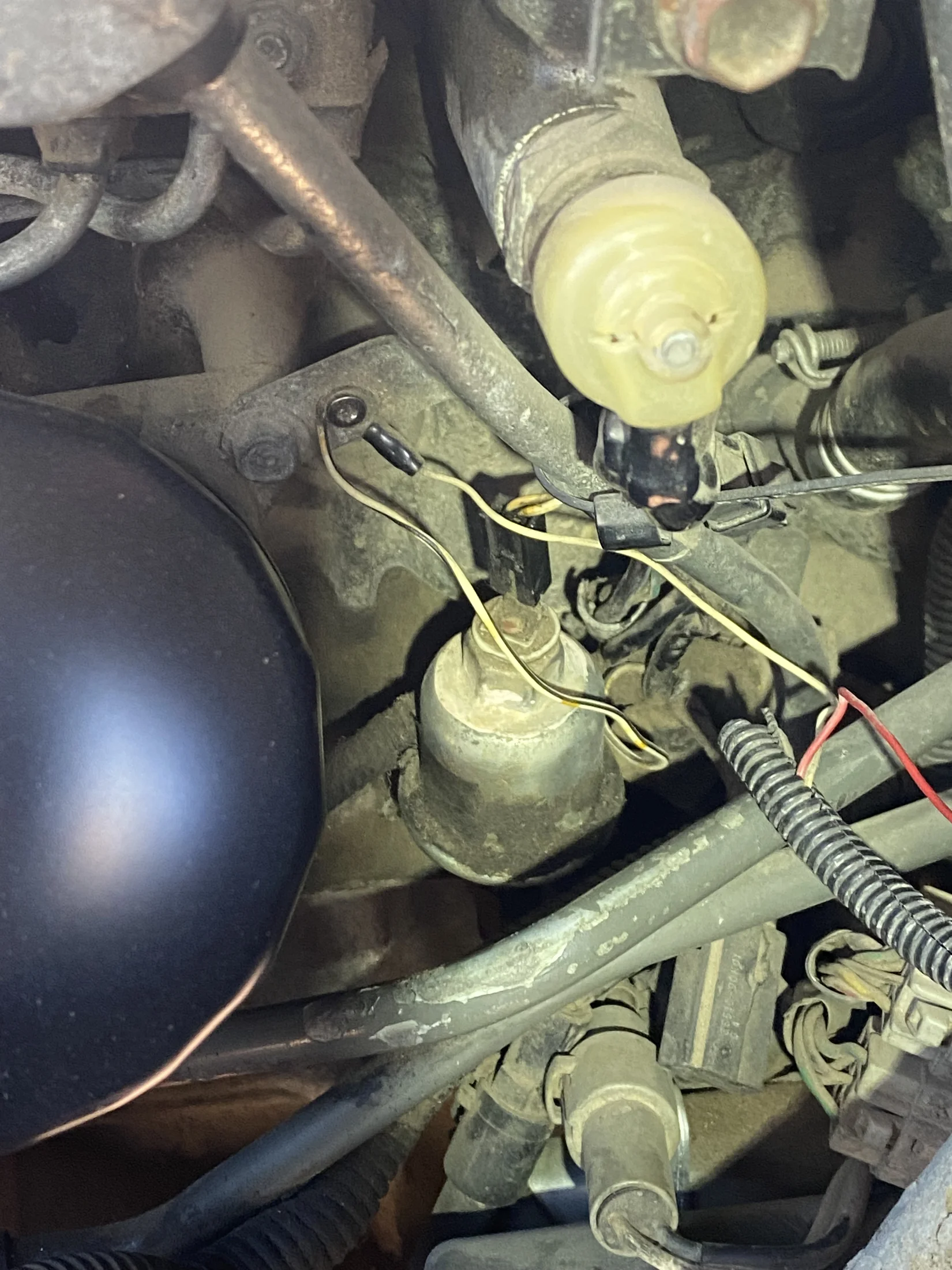

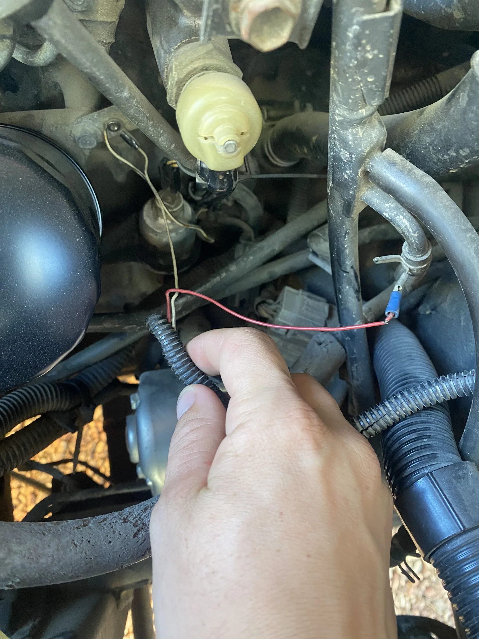

1990 1hd-t. Trying to chase down my oil pressure gauge in the cluster that does not function. However I've noticed this sender unit itself is obviously not OEM and has some funky wiring going on. I see the one OEM plug that would slide over the spade on a OE part but I am not seeing the other connector that slides over the nipple on a OE sender and in its place is this conglomerate of utterly small gauge wire grounding out on a clamp and running into the firewall. My only assumption was it was some sort of sender for an aftermarket gauge that is no longer with my truck. Has anyone seen anything like this and or point me in the right direction as to where to chase down the other connector I need in the harness. Id like to be able to see some sort of oil pressure for obvious reasons.....
Thanks Ian advance
UPDATE:
Appears this one is off 70-80s older chevy truck. Going to take a shot in the dark and say it was used for some sort of non standard gauge
