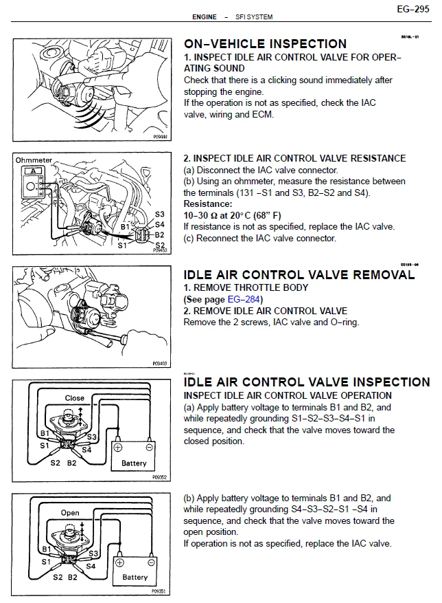

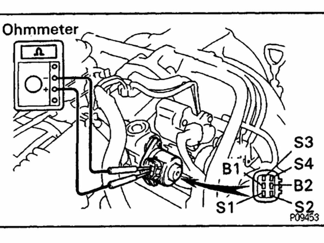

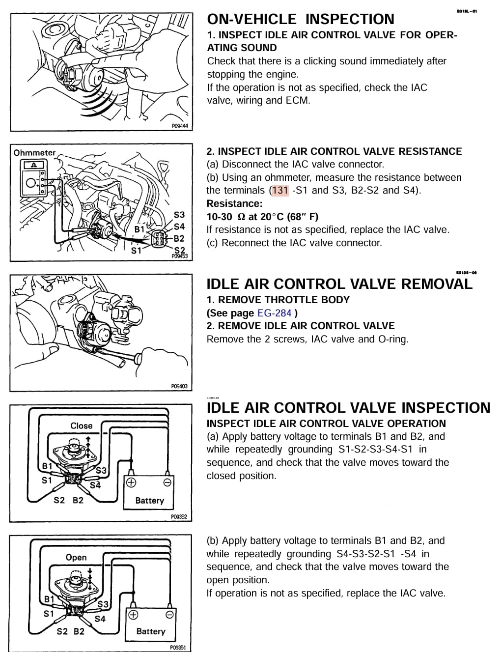

Hi, mine is an early 94 model, and yes, it's gasoline and LPG. I have been starting it on gasoline. I have JIS screwdrivers, after reading this in another thread. I have a copy of the FSM, and found the testing procedures. I'm a little confused about the electrical one, as FSM says " (b) Using an ohmmeter, measure the resistance between the terminals (131 -S1 and S3, B2-S2 and S4).", on their diagram, I can find no reference to '131'. Have attached these images for reference. Any thoughts?
"131" is typo. It should read "B1".

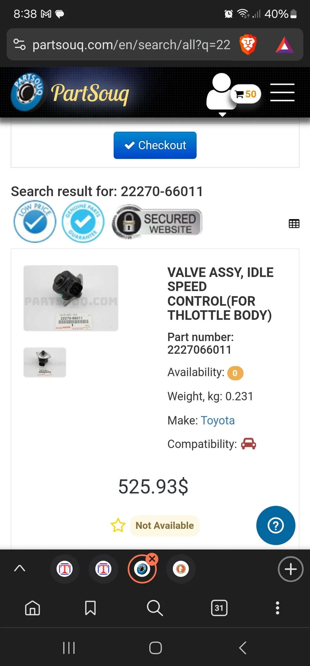

Also, FWIW, if the IAC is defective, since the '93'-94 IAC is no longer available, use the 1995-EoL versions, 22270-66011. It's a direct replacement.

perfect, thank you for that, and the new part number for the IACV! I will do some testing this weekend and give it a clean while it's out! Even thought about getting a cheap $35 one off Amazon just as an additional test, if no change, then refit factory one and move onto the next possible culprit..

That price is well above the US retail price. No idea what it would cost in the Antipodes.
I'd email Dave Stedman at Japan4x4 and ask him what a real price would be.
I'm in Australia, I have no idea what the retail here is, but I'm hoping mine is okay!
Retail at your local Aussie Toyota dealer is likely 30-50% higher than partsouq.
Definitely try cleaning yours. They are fairly simple, just do it carefully.
Partsouq.com or Japan4x4 as linked by @Malleus are good sources for parts.
Partsouq.com would typically have parts at my door in Sydney in around 5 days, faster than Toyota can usually get stuff from the Melbourne warehouse

I've tested the IACV per the FSM, and I believe it has failed. If someone could please double check for me? I had hear the click click click from the IACV when you turn the car off, and if I unplug it and start it, the revs jump right up to near 2000rpm (not sure if that tells you anything). @mudgudgeon @Malleus

There is a off vehicle testing procedure in the FSM. Remember this is a stepper motor that only moves in very small increments. You won't see it move put holding on to it you will feel pulsing. The test procedure doesn't mention it takes multiple passes to see in and out movement.
I can not see this off vehicle testing in my FSM. What if I pulled off the IACV and had it connected and cycled the ignition?
Look at previous posts in this thread there are pictures from the fsm, specifically post #6. Most likely removing but still connected before starting would only push it out. That test would be insufficient.
and
and
Ah yes indeed haha that's my photo.. I'm an idiot! I'll definitely do this and report back.
