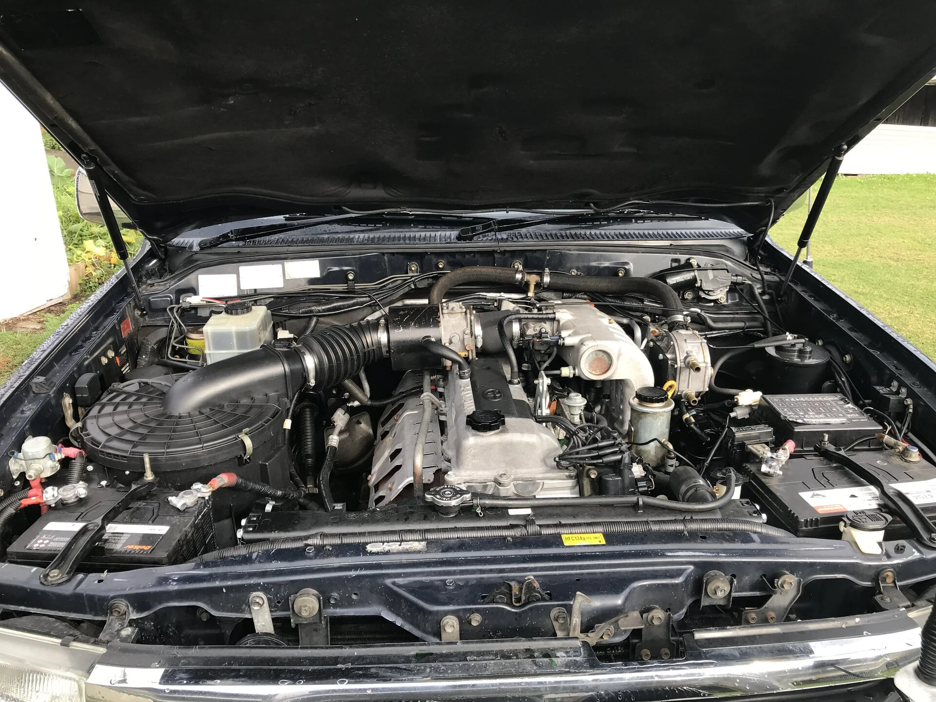

are you able to provide some pics of the setup / engine bay?

Thanks for all the informative replies, yes I believe it had backfired when the old owner had it because I had to replace the air box as when I purchased the vehicle the bottom of the air box was split in about 4 different places which I assume would be a backfire outcome. My vehicle is actually an fzj105 lol I’m not sure why I posted in the 80s tech section. I think one of my other threads on here was moved to the 80s section for some reason so I just automatically posted in the 80s tech section. But yes I will look into bypassing the mixer ring for the lpg. I mean I know they are heavy vehicles but she just feels gutless :/ unless I’m really putting my foot to the floor and even then it feels like I’m trying to pull a steam train behind me.
My mixer round thing also says lpg spares, I will take photos for you tomorrow and we can compare specs

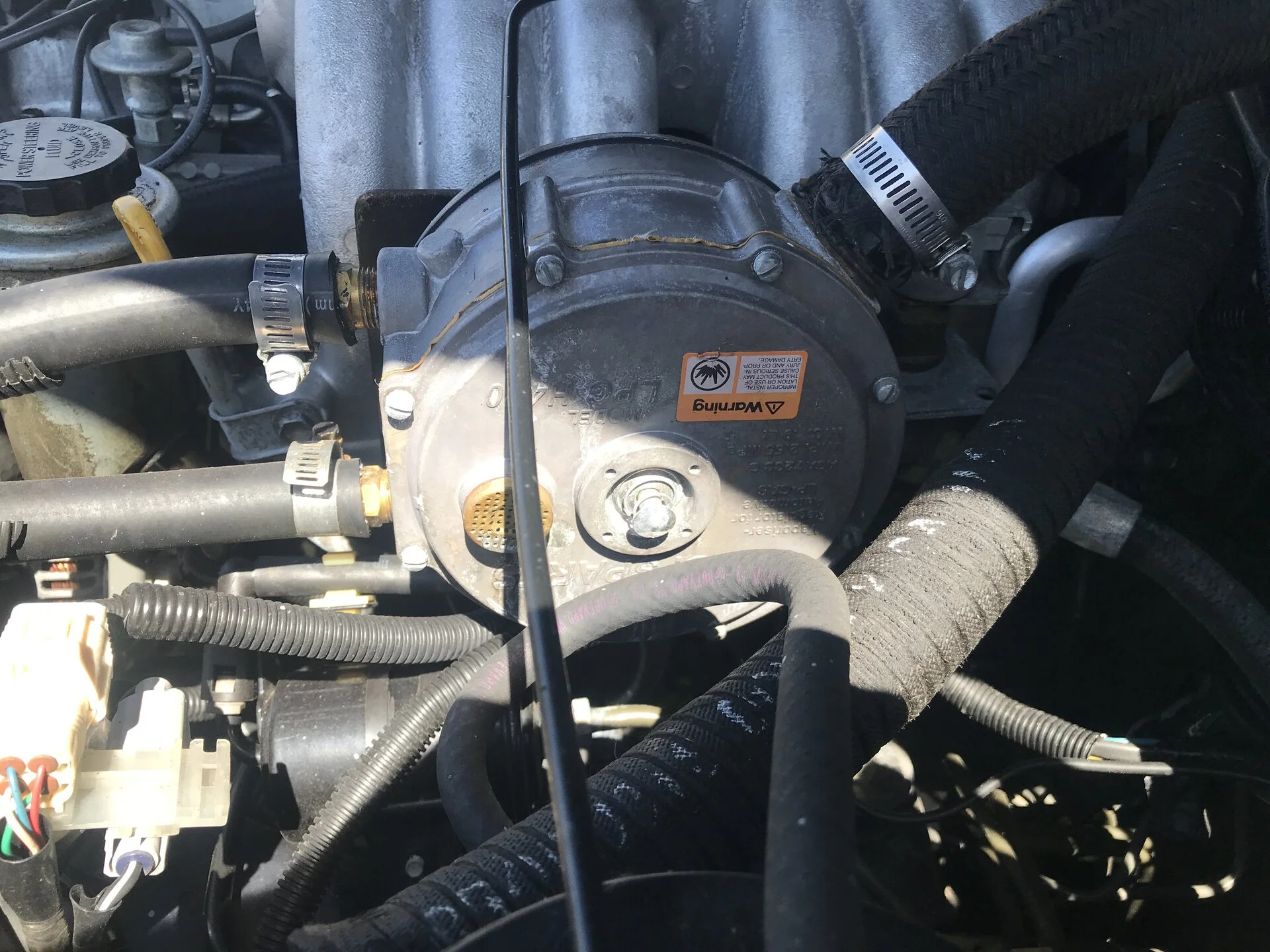

Here is one I took a few weeks ago

looking at the pic's its similar to mine in that the converter is in the same spot however the mixer setup is different. Mine is just the impco in line between the air filter and intake
if it has had a backfire to the point where the air box cracked there is a very good chance the MAF is damaged and probably the reason for sluggish performance

Your gas system doesn't seem to be fully connected - at least on the vaporiser.
On mine, the two front pipes connect to the radiator to run warm water through the unit to vaporise the gas.
Yours are not connected to anything going from your last photo.
The vaporiser itself looks identical to my, also not working, lol, one.
Your mixer looks about three times as long as my one however.
I had heard that backfires can damage the mixer - I think the diaphragm gets damaged, and I guess that could block the air flow in when on petrol.
I'd undo the two ring clamps - the one on the airbox and the one on the inlet manifold, and move all of that back to make room for a replacement non-gas intake pipe and give it a test.
If you don't ever want gas anyway, I'd probably get the OEM part as mudgudgeon suggested.
I'm not too sure how much work it would be to fully remove the gas permanently, as you'd have to remove the mixer, the vaporiser, and the associated electricals - which are pretty minimal, and the gas tank, filler cap and line.
A lot of the work would have been plugging the radiator lines, which you wouldn't need to do, as yours aren't connected anyway.

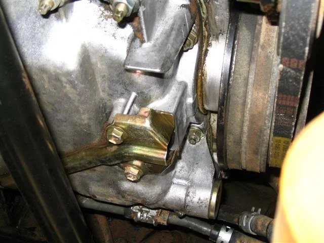

Yes definitely update as you can I’m putting money on your crank angle sensor is failing, stalling is one main symptom of a failing crank sensor. I forgot to put that in last post, but basically that Particular sensor will cause an array of issues. This is the link to the sensor I bought online , it is in fact a genuine Toyota replacement. Hence the price tag.
It’s a very easy sensor to replace, only 3 12mm bolts holding the protection plate Surrounding the sensor and then once that’s off there is just 2 10mm bolts holding the sensor, pop the old one out and bolt the new one in and connect the electrical connector on the other end.
Here is a photo of the sensor location (best photo I could find online)
Awesome!
Thanks so much.
Yes, reading around, and watching a few videos, I'd say you're on the money.
The symptoms all match.
I won't get a chance to work on it for a while, but I will update once I replace it.
Thanks also for the location of it... I was looking. :)
