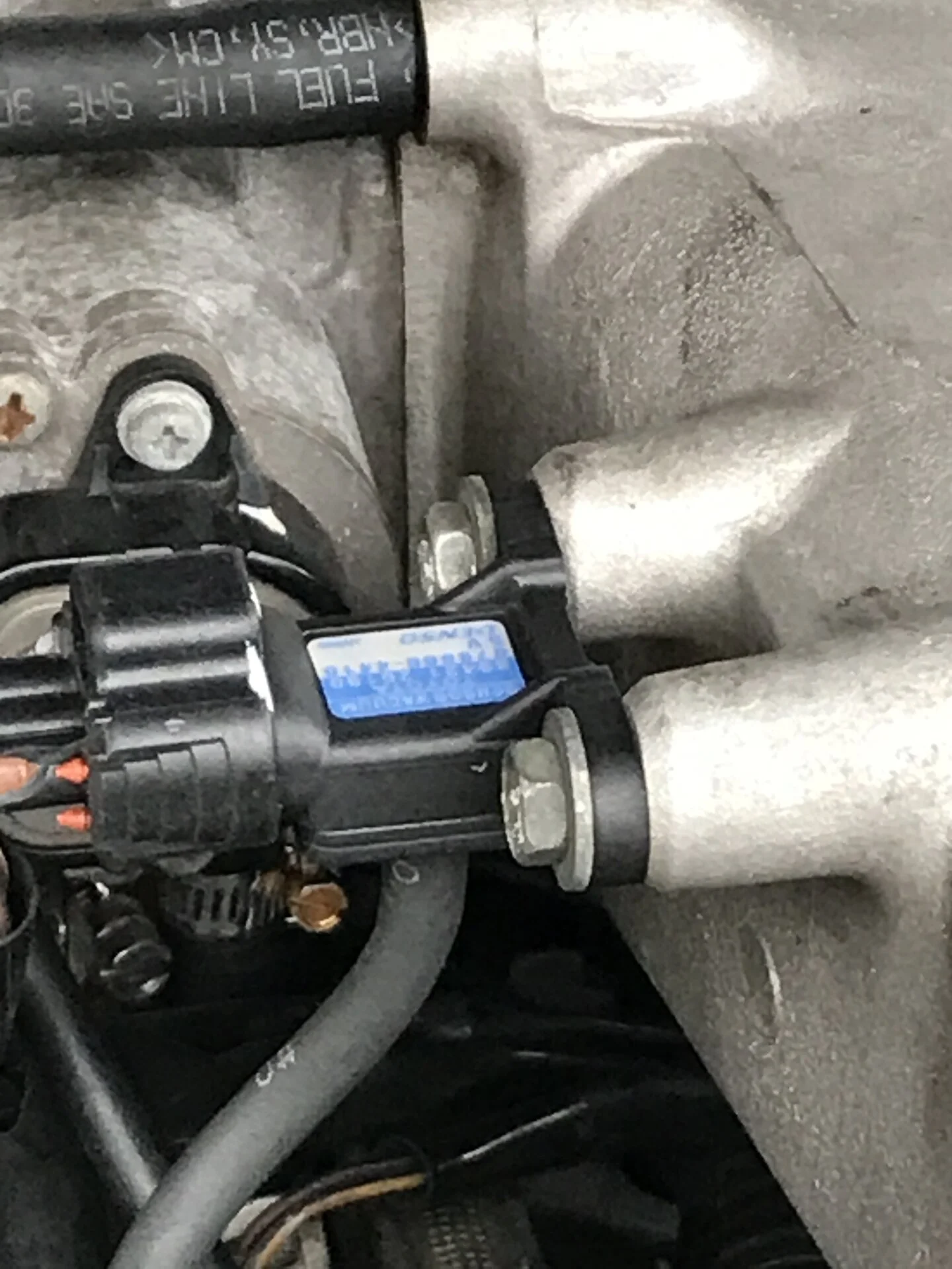

Hi mate, thanks for the update it’s good to see what your up to, I’m just gonna say it outright - our model particularly (105) that have been run on gas at some point for an extended period of time seems to be one of the main reasons we have so many issues that are not exactly straight forward. I recently spoke with an auto mechanic that had been working with Toyotas for over 40 years and I really picked his brain and tried to get as much knowledge out of him as possible, and the end result of a 2 hour conversation was that Toyota engines, especially the 1fz should never have been put on gas and should have been kept to run on petrol only. Mainly due to the higher temperatures that gas creates, in his words it basically cooks the motors over time and puts big wear and damage on all the other sub components. Which totally does make sense, he says ‘they may run well on gas for 5 to 10 years but at the end of that run your going to be faced with a variety of different issues and be more than likely chasing them until you’ve done a complete engine overhaul, they just weren’t designed to be run on gas’ so take that for what it’s worth mate, bit of advice from an old Toyota guru.
I can’t remember if you said you have checked the MAF sensor? It’s on the intake manifold right next to the TPS sensor. If it is failing or failed it will make the engine run like crap, including backfires. Also pull the lid off your air box and inspect the whole inside of the box for cracks or cracked holes, if you find anything that is cracked on the plastic box housing then it has Likely had a back fire or 2 from the gas system, which in turn can cause havoc on the sensors. Sensors getting blasted with a backfire can do significant damage. Also worth replacing your TPS. As if it’s damaged the throttle position will be all over the shop and also will run like crap.

I cant seem to find the MAF sensor. The only sensor at the air intake pipe that leads from the airbox to the mixer is a air intake temperature sensor.
Perhaps the 2002 FZJ105 doesn't have one?

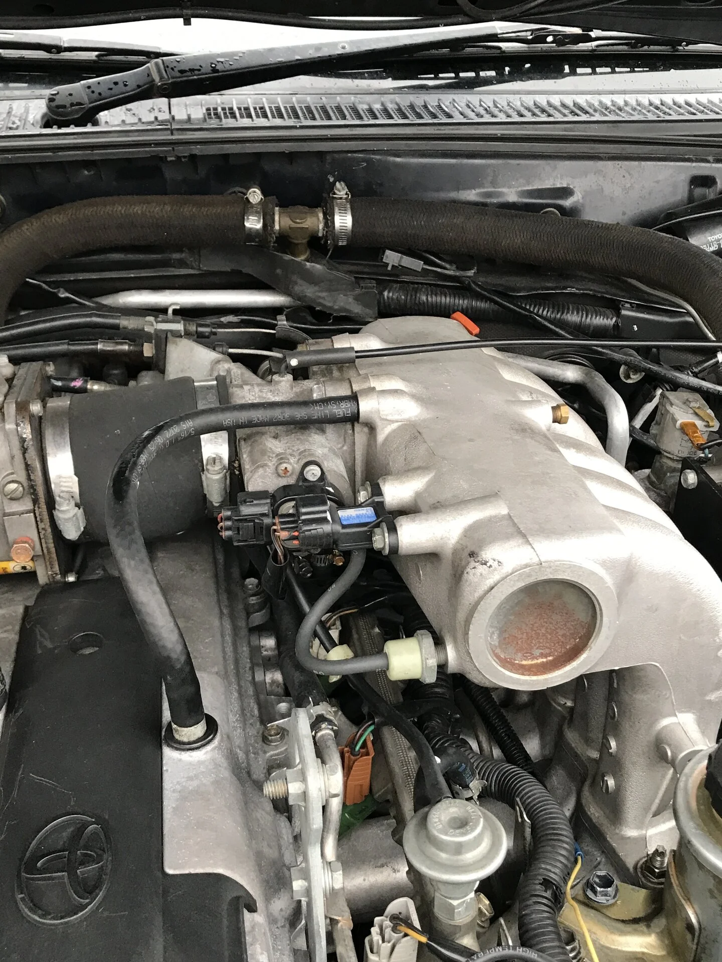

Yes mate definitely keep at it I highly doubt it’s terminal, these motors are very robust. I will take a photo of the MAF sensor for you now. Also yes could very well be fuel related issue , I.e fuel pump, bad injector, crap in the tank. I am actually in the process of replacing the fuel system and I’m starting with the pump first.
The thing with the blue and silver sticker on it is the MAF sensor. 2x 10mm bolts and 1x vacuum hose on the bottom side of it.
Your picture does not show a MAF - Mass Airflow Sensor. What is shown is a MAP sensor - Manifold Absolute Pressure sensor.

Oh haha well there you go - that’s interesting thank you for that. It’s interesting that eBay where I bought it from had it listed as a MAF sensor.

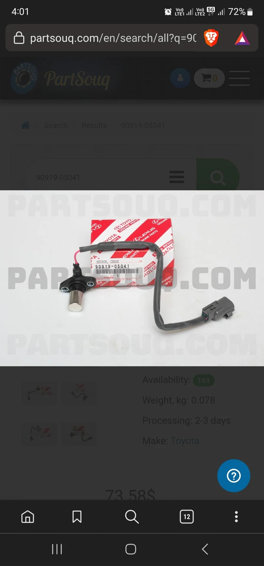

The crank sensor from eBay, why do you think it's genuine?
Nothing in the listing you linked suggests it is.
Picture doesn't match OEM
A true genuine replacement would have cost you slightly more than half that via Partsouq
Price is USD$, So about $120 AUD, plus a bit of shipping

Not sure if your talking to me or josh, although I can assure you the crank sensor I purchased off eBay for $200 AUD . It’s a denso and is the genuine replacement part.
@99fzj105, thanks for the photos... I was looking at the other end, near the air box, where my old UZJ100 had the MAF sensor.
Mine only seems to have an ambient air temperature sensor there.
I'll have to check as per your photos to see if I can see it...although if its a MAP sensor and not a MAF sensor, perhaps that may not be relevant to the question?
Although, a super quick google of MAP symptoms do list fuel starvation, lack of power, etc so that may be have something to do with it.
And, actually looking at the second photo, I must have it, as I replaced that greeny coloured gas filter or whatchamacallit that is connected to the hose from that sensor.

@ppc, thanks for clarifying which part it is.
@mudgudgeon, thanks also - yes, I normally get my parts from partsouq.com, as they are reasonably priced and seem to be all genuine.
That's good. Photos looked a bit doubtful, and their description sure didn't make it clear.

Well I'll be....
I was about to order a replacement MAP sensor, but thought I'd change the vacuum line to it first.
The one that goes to that small greenish gas filter, that I had recently replaced.
I also replaced the vacuum line that runs between the fuel regulator and the throttle body near the throttle position sensor.
The car seems to be running so much better!
Smother idle, better acceleration and power, less hesitation, no backfires...
Not 100% yet, but actually drive able now.
