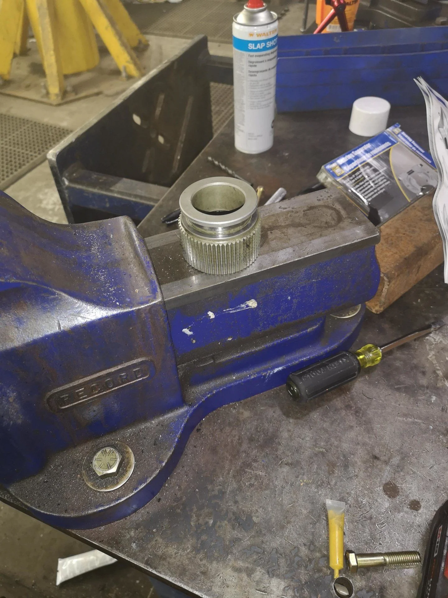

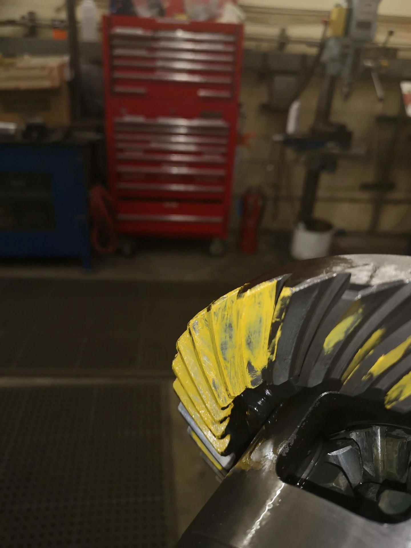

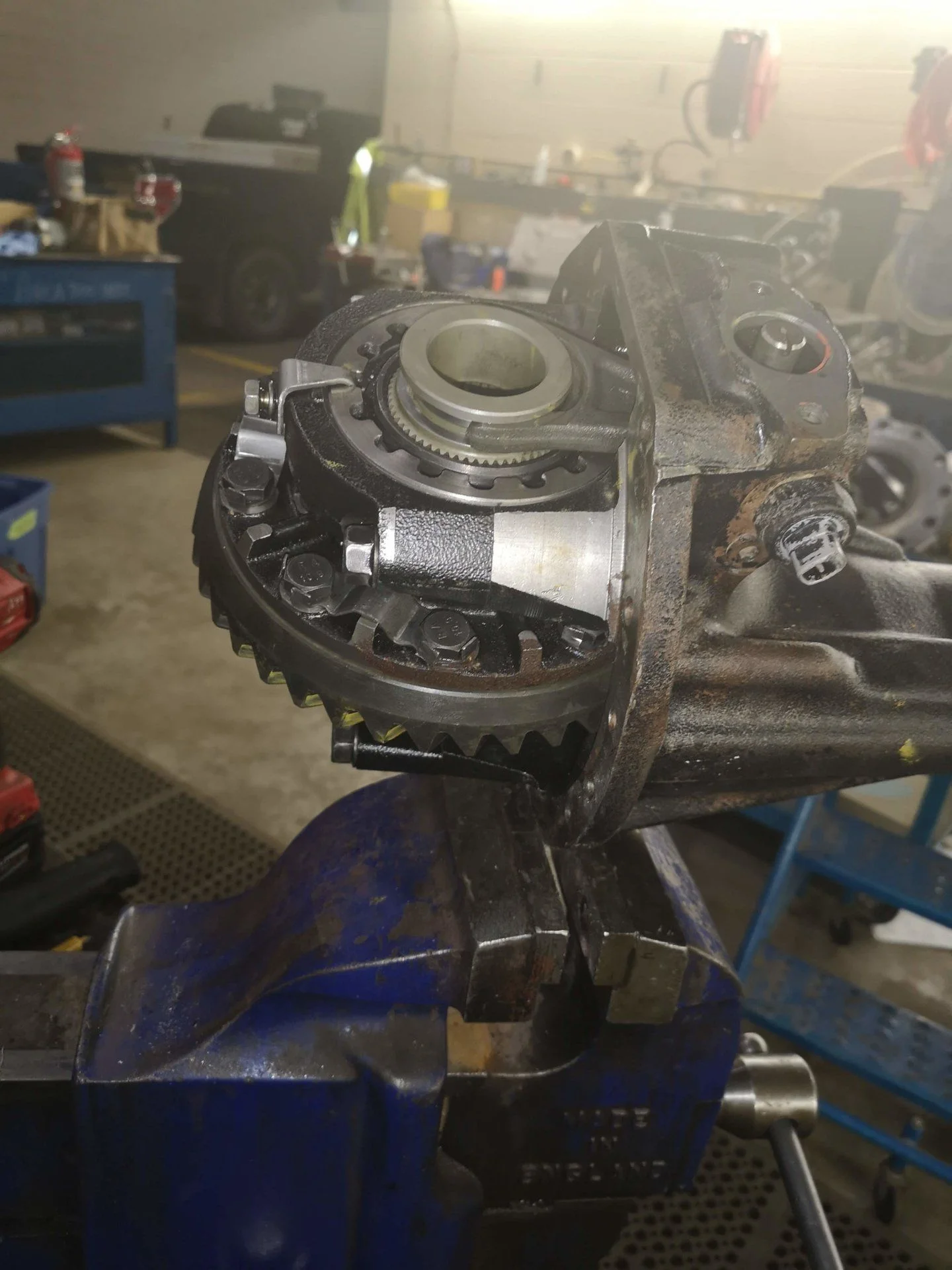

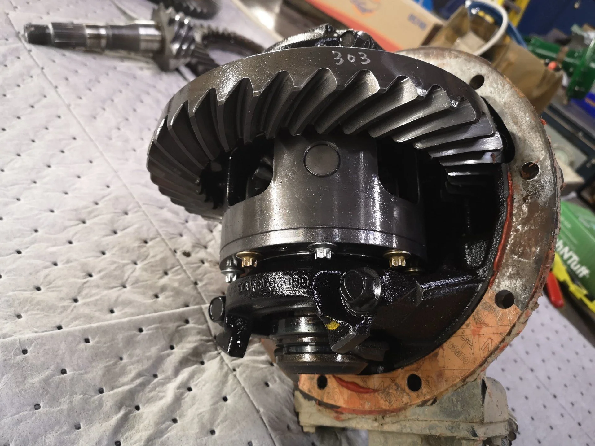

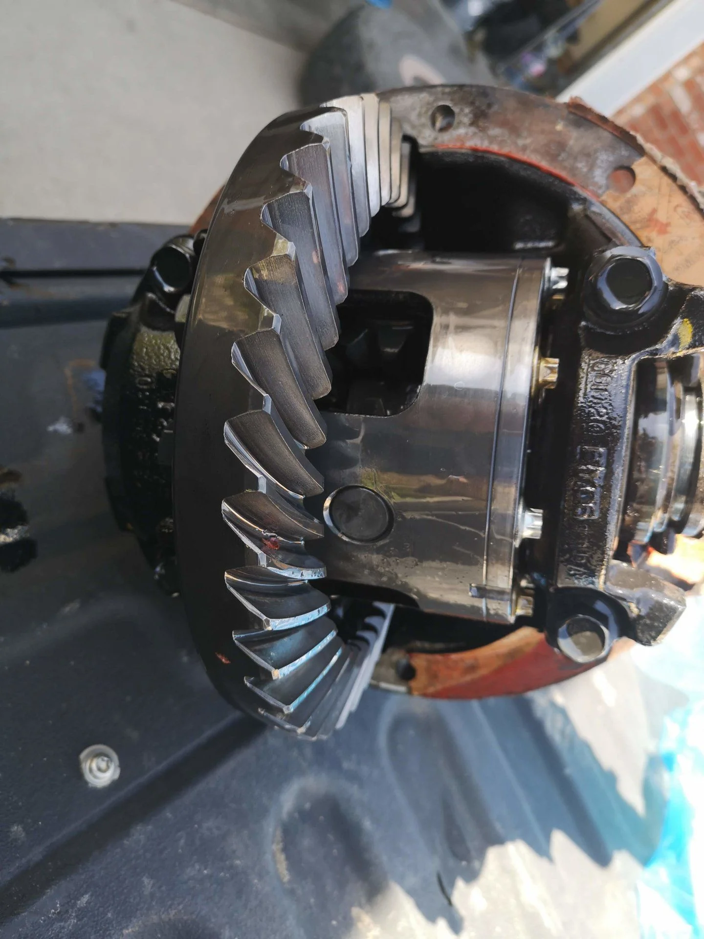

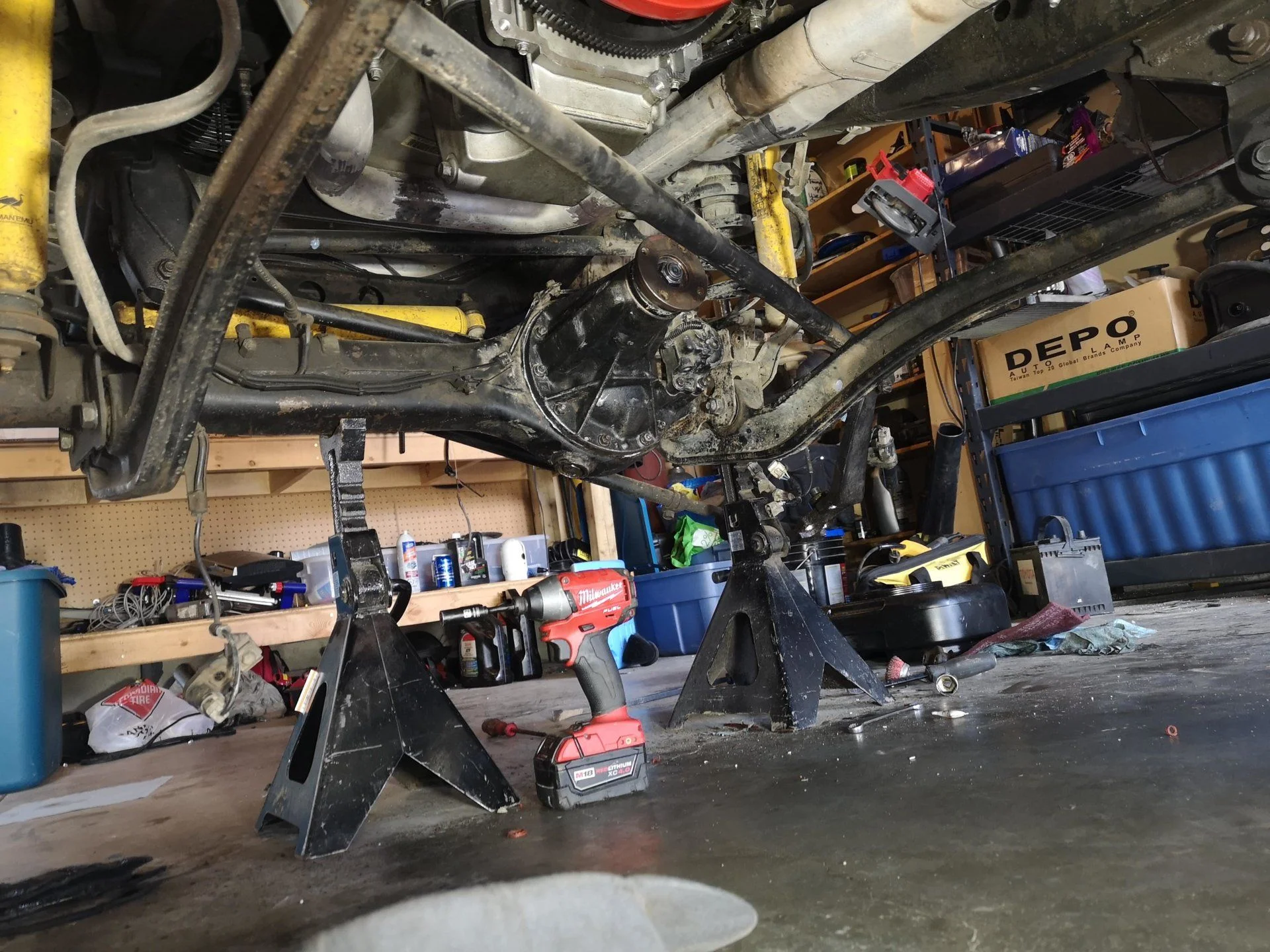

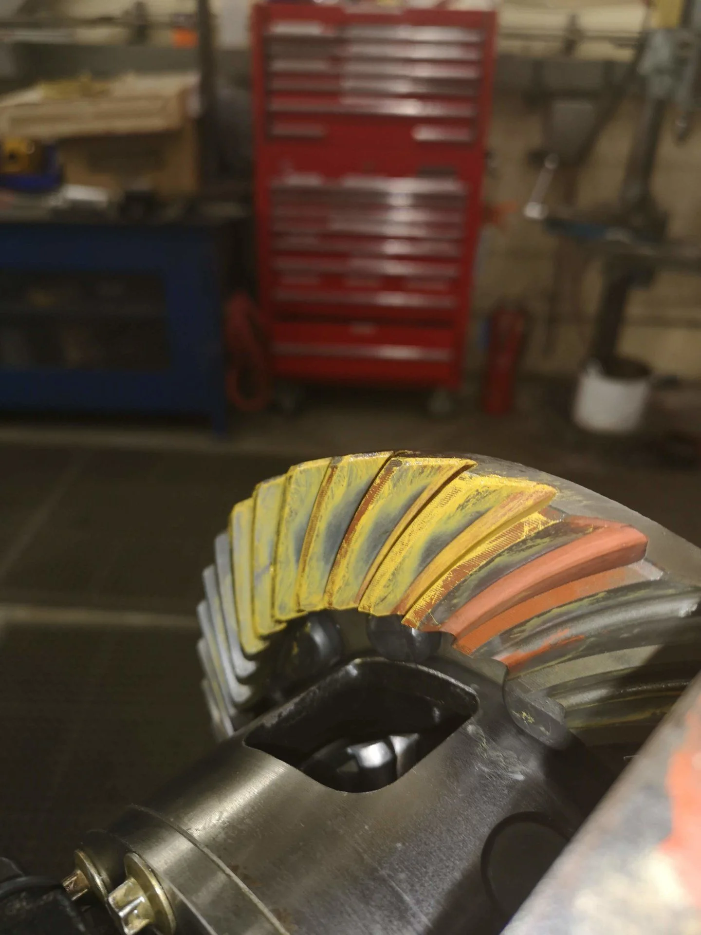

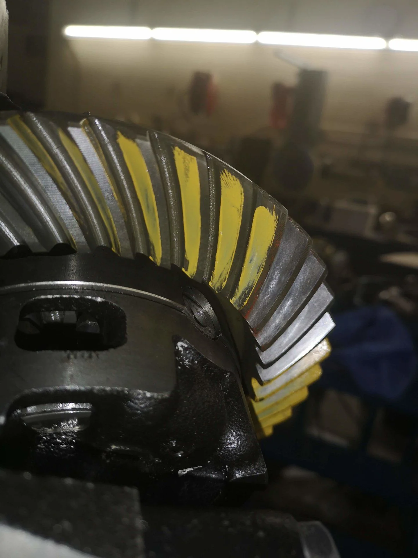

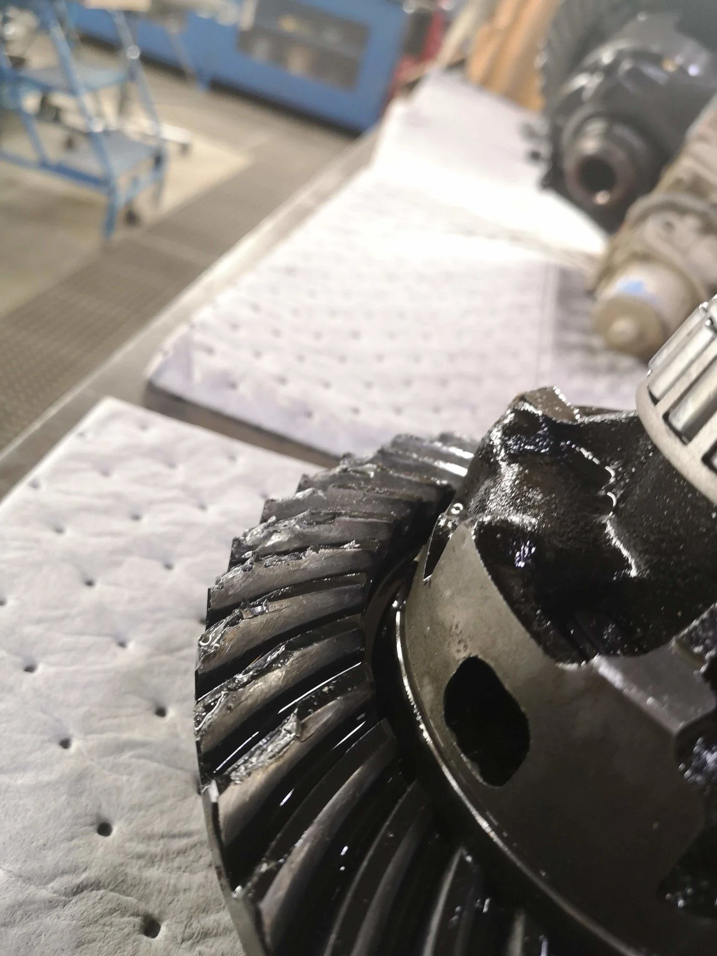

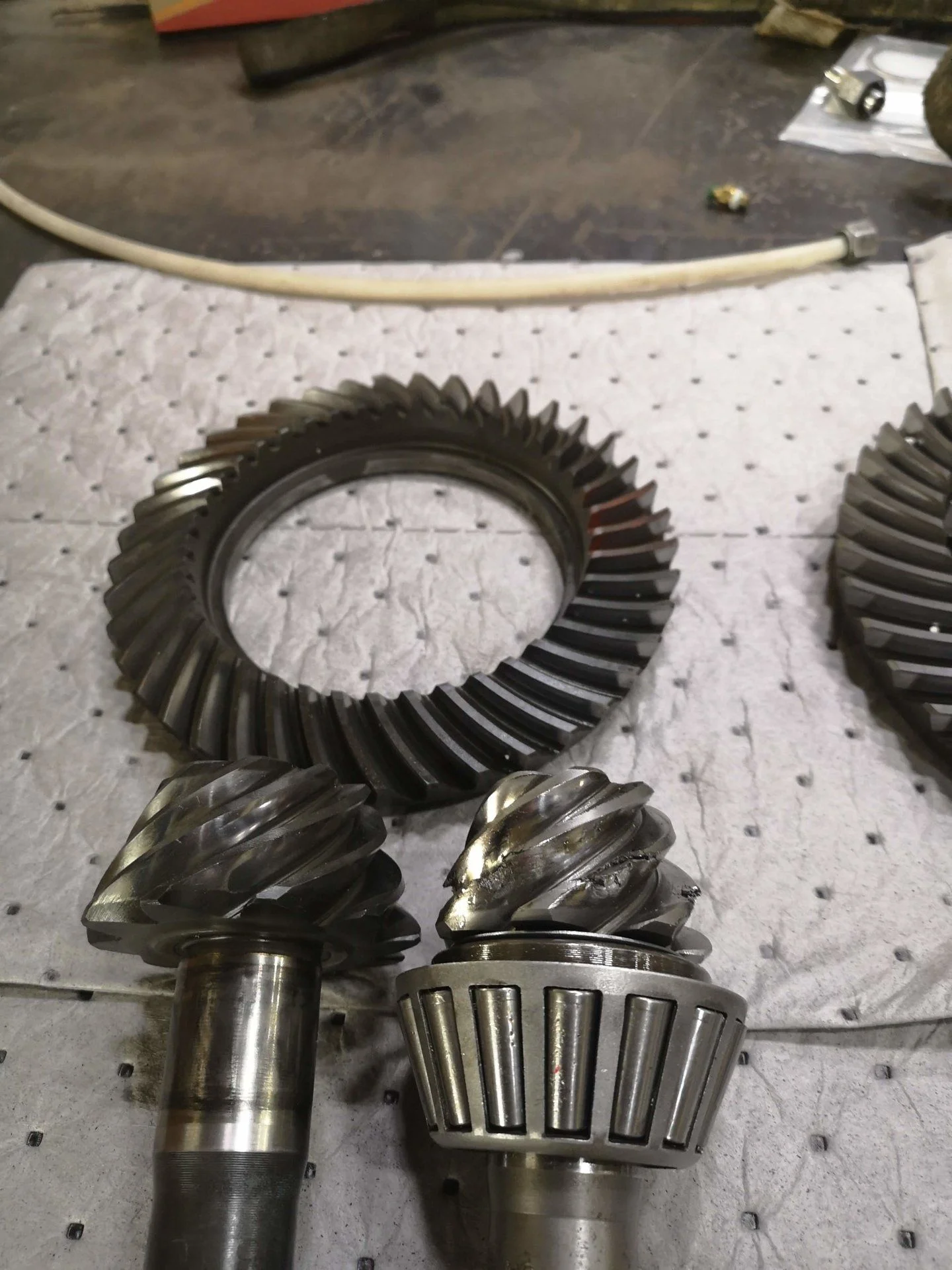

lessons learned, never trust someone else to setup you gears..... a local "Expert" company had setup my 5.29s about 3-4years ago which when I added the powerit did not last long

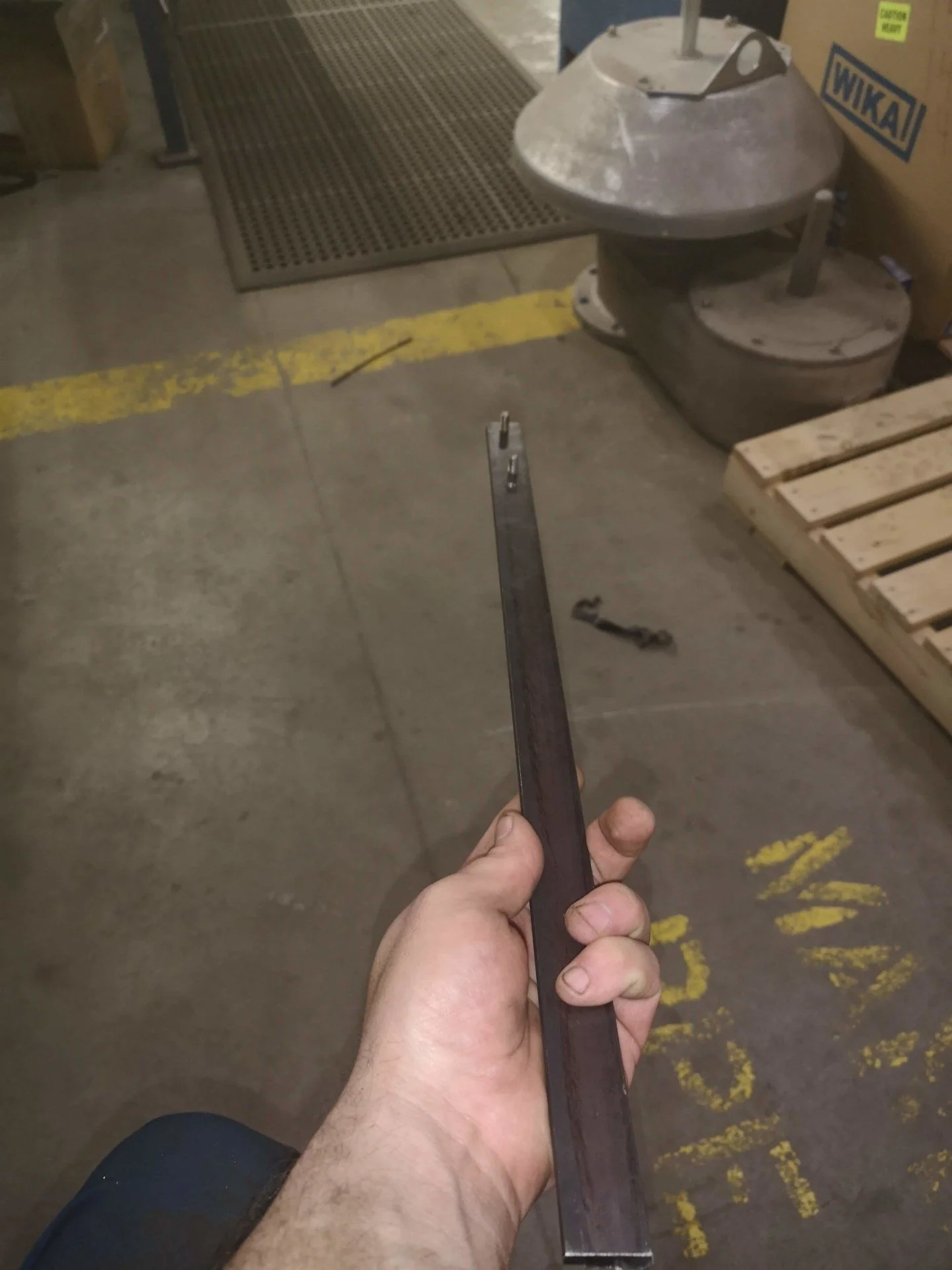

so with that said i reworked the diffs myself, had to build a couple custom tools but things went smoothly ish
the ish part..... it was 12 am and i saw what is essentially the locker of the rear front diff...... sitting on the god damned vice

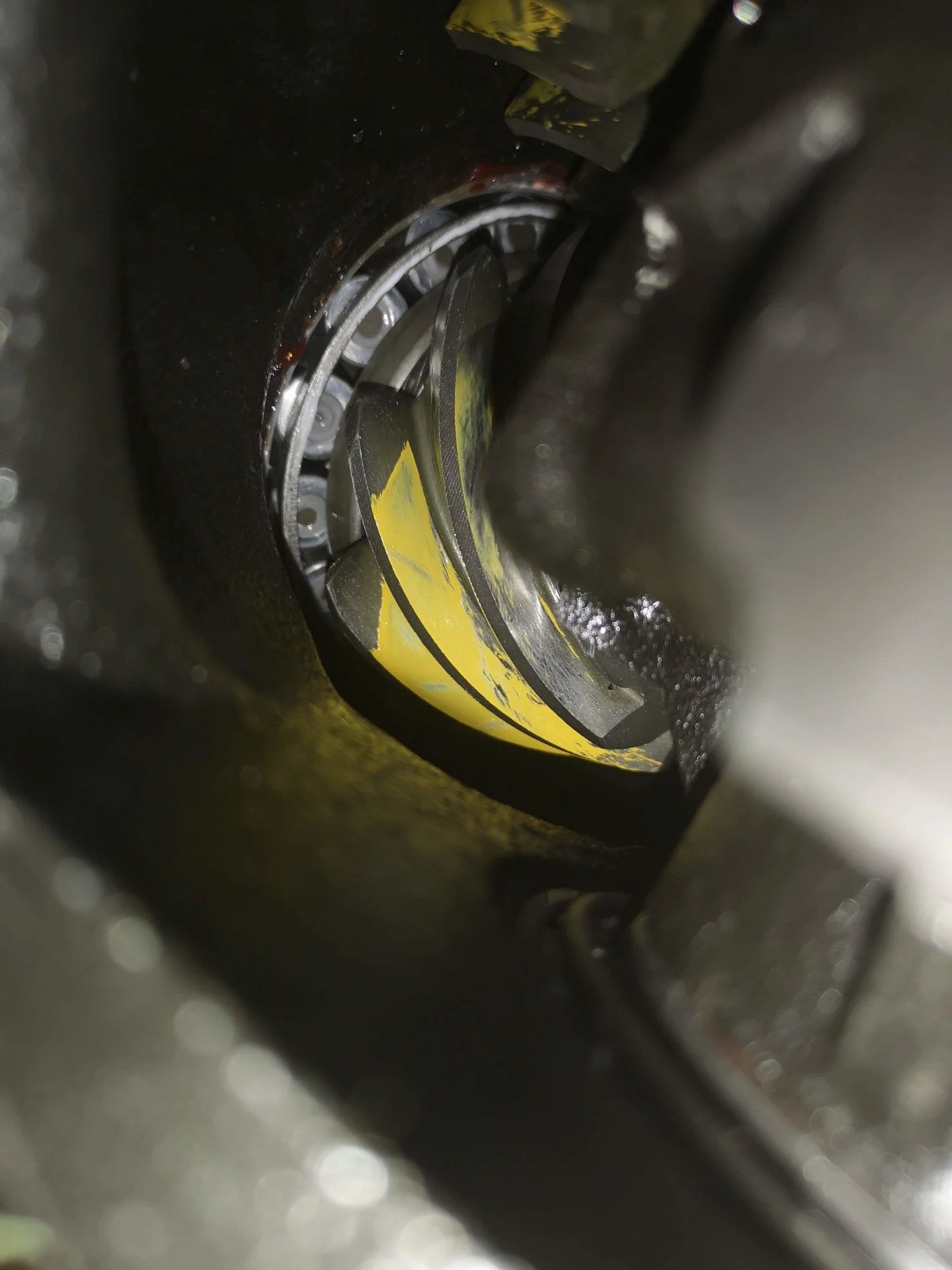

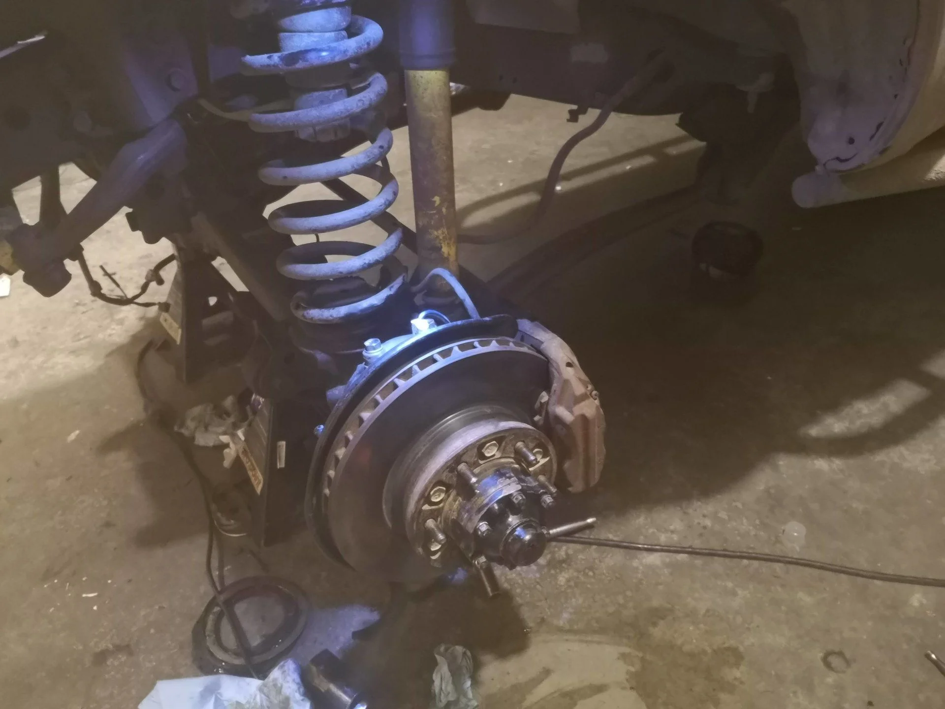

after i fixed my screw up, i regeared the rear to a 4.11 as well...... and well when in rome change all of the seals, you can see what happens to a knuckle ball when a birf explodes and you drive home, and people wonder why i carry a spare birf lol

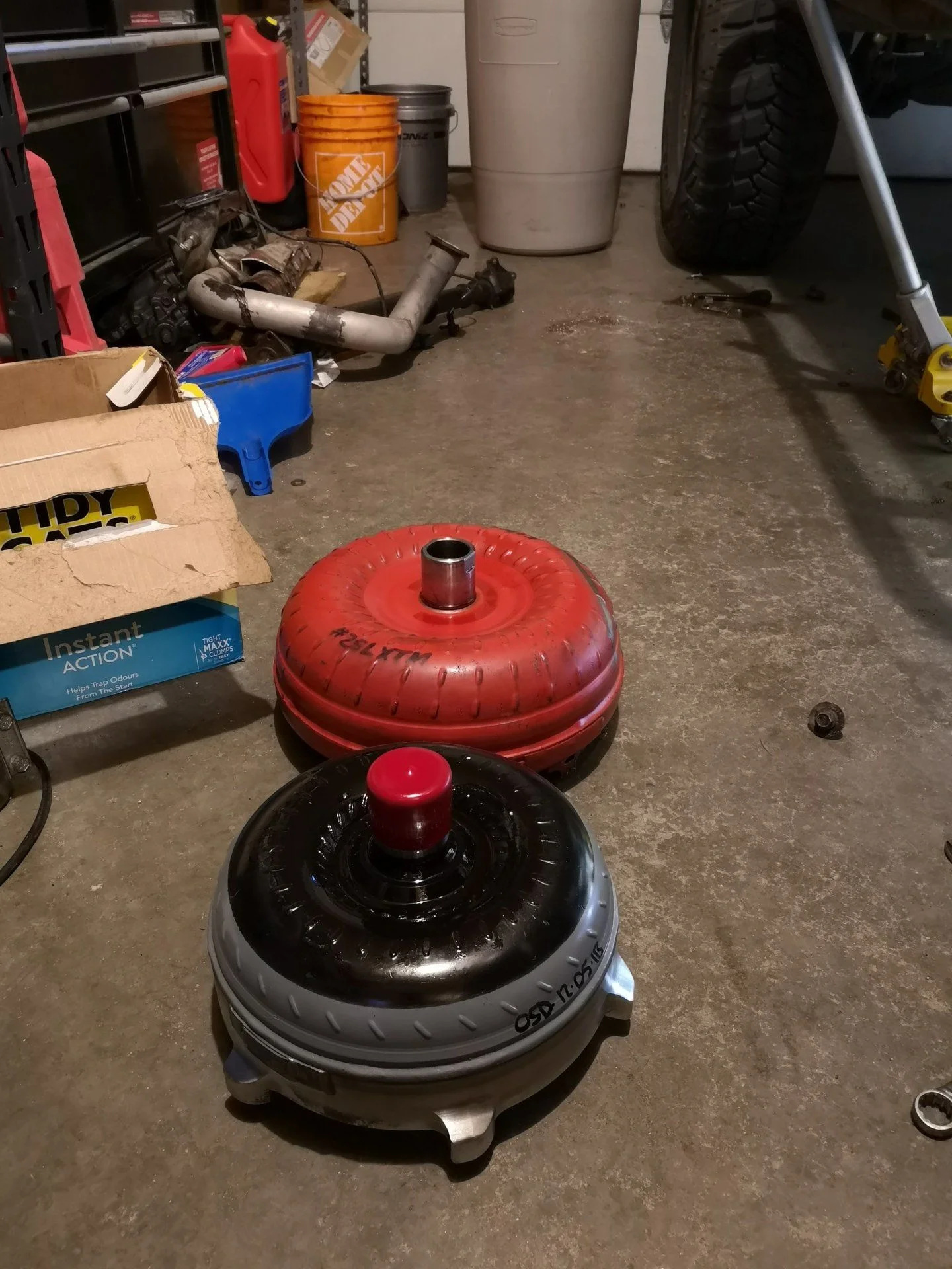

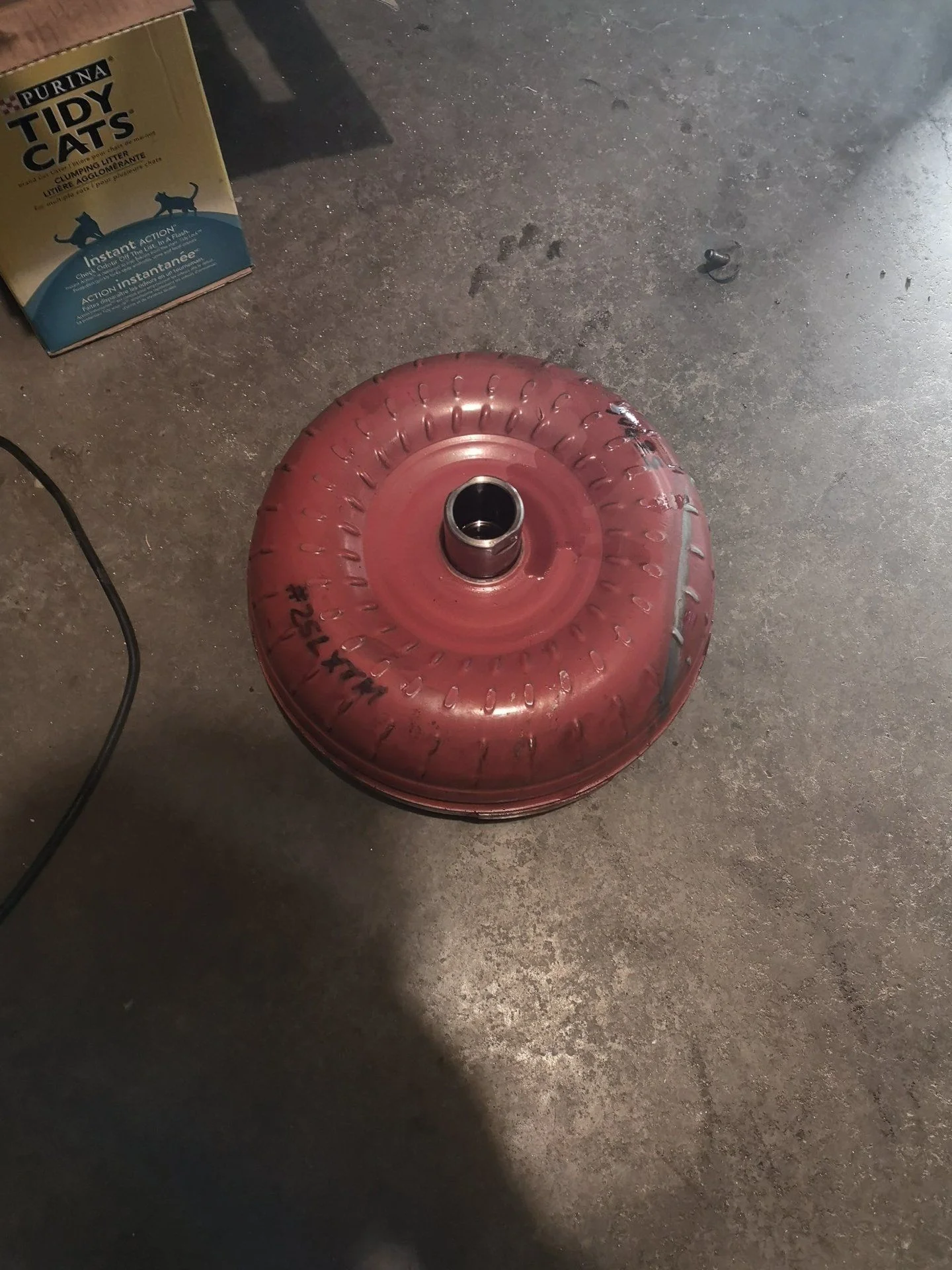

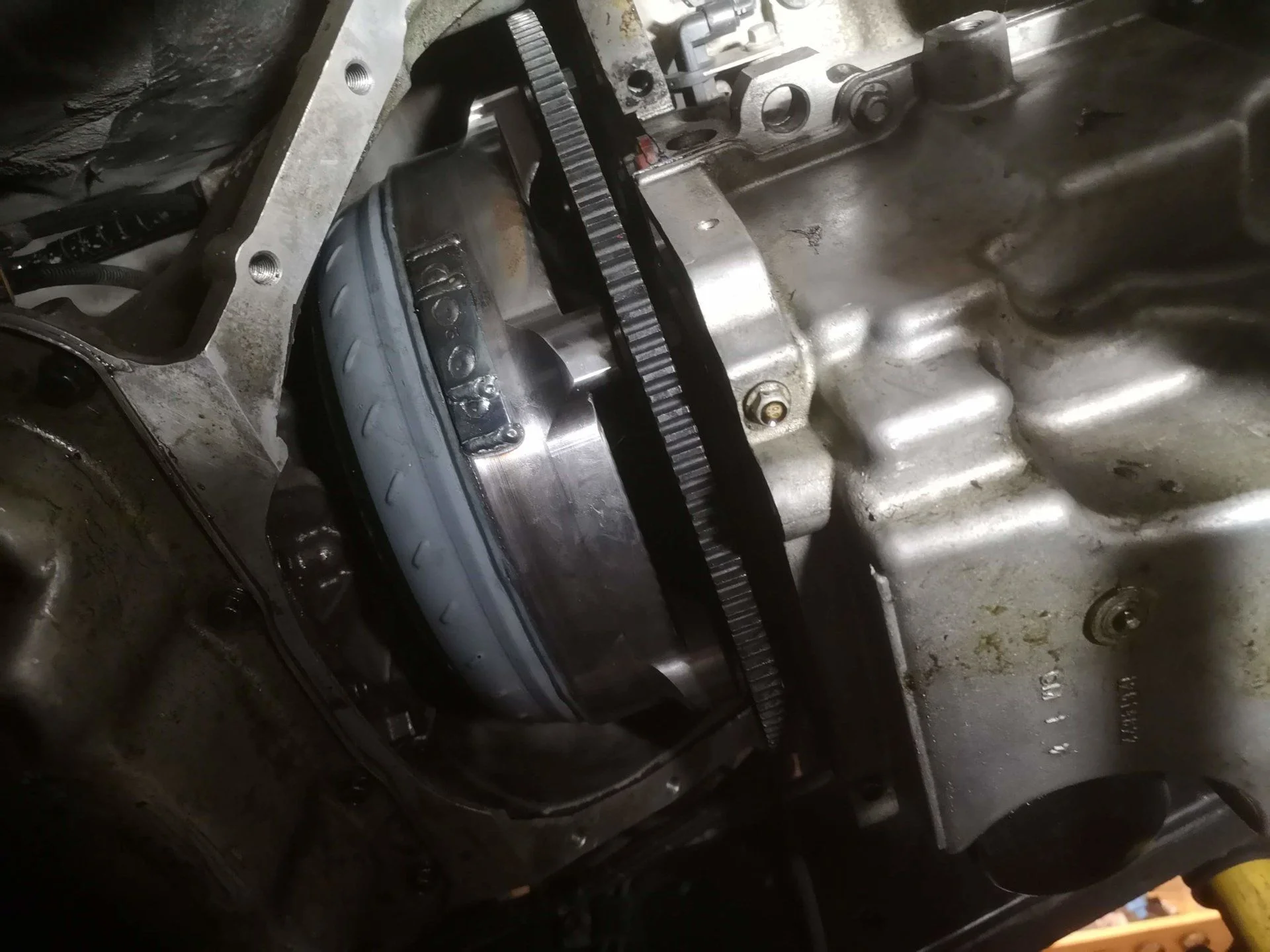

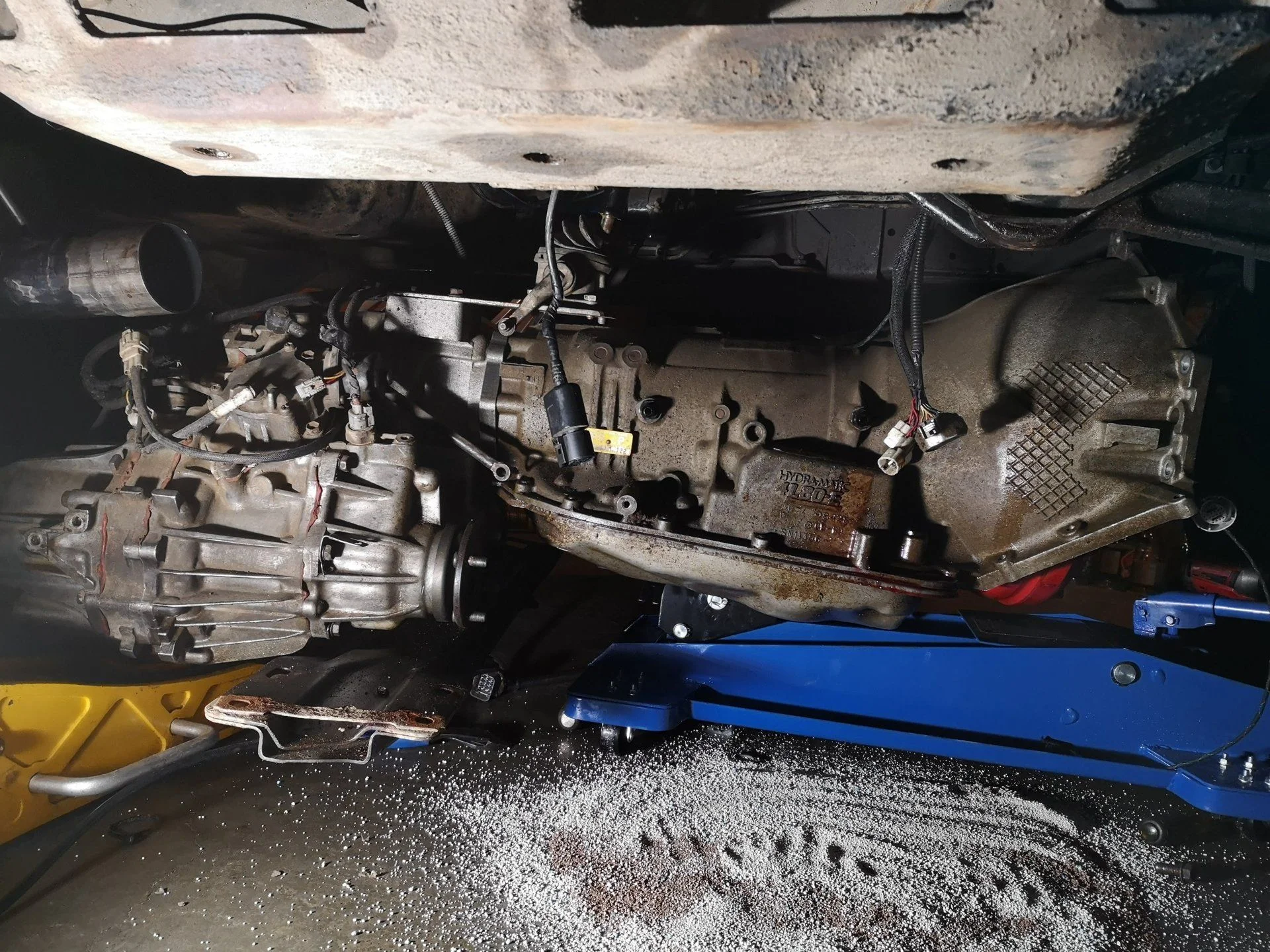

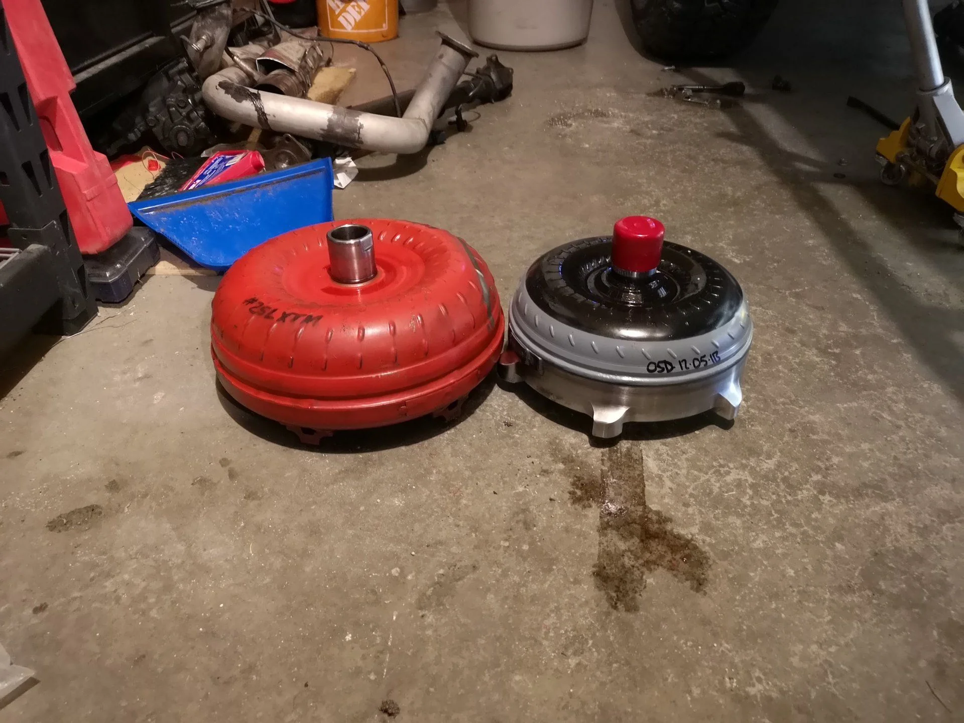

well the regear was working well put a 1000 km on the truck but the tuning now needed alot more love so i took it for a good highway drive on the new "used" gears thanks @bwakeling and i ran into some minor issues being the 5.29s masked my very very very undersized torque converter. While the highway manors were great the truck just did not leave well at all, id say it left worse than the thing did on a inline 6......... so a quick call to texas speed and performance and 1300 us dollars later the new billet converter stalled at 2800-3000 showed up
so i got to pull the trans and leave the motor in! not what i wanted to do 1 weekend before a larger wheeling event but when in doubt change it out

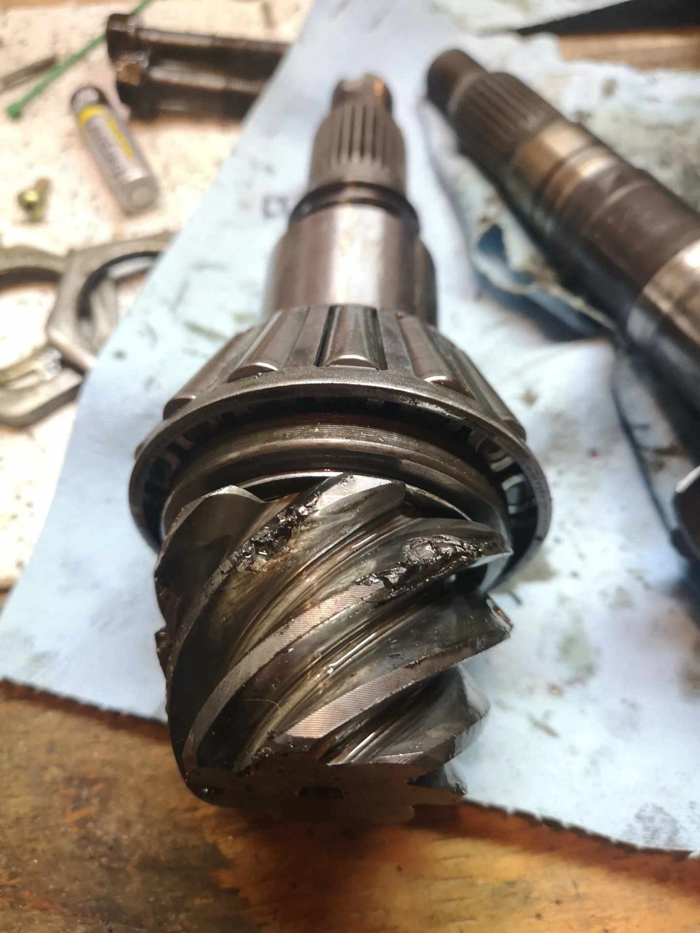

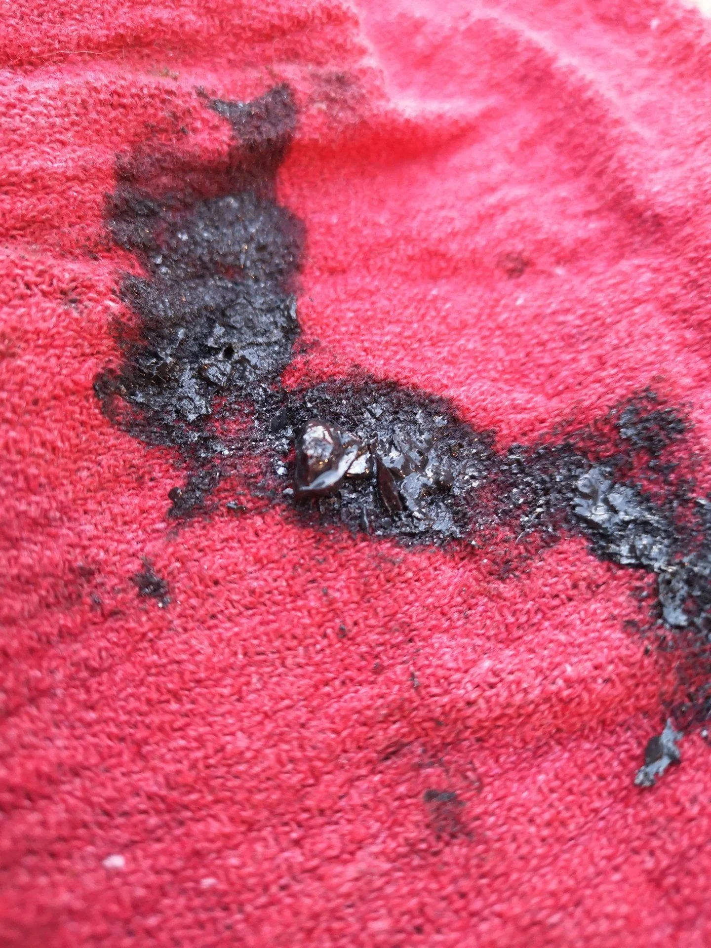

all this power has not been kind to my front pinion..... 2nd pinion feels loose already and its a 4.11 ..... time for a major change on the front axle
