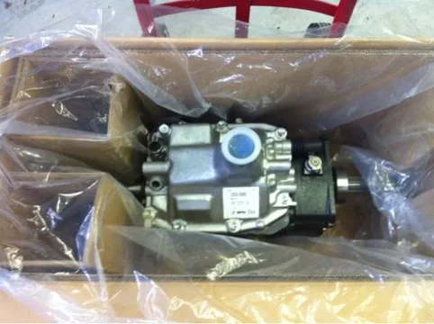

Brand new H55. Smells like candy;)

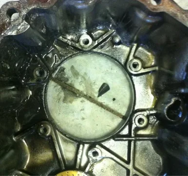

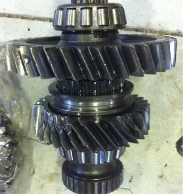

So, I finally got the split case part way broke down and got to survey the carnage. Seven teeth missing off the high output gear sub-assy:eek:
Here you can see the bolt holes where the stray teeth were chewing on the back-shell and eventually cracked it. The 10-11 o'clock was where the teeth were residing when I dropped it.

How in the heck did you break those teeth?
What are your plans for the old broken gears?
Beats me, noticed the metal in the fluid when I went to change it, plus the loose bits cracked the back shell:meh:
Gears are heading to the recycle yard if nobody wants them.
I'll have the whole gear set to include the front and rear output shafts, has the PTO gear also. Except for the hi and lo gears, everything else looks in pretty good shape. Even the lo gear isn't bad, but you can see a little wear from the loose teeth rattling around.
