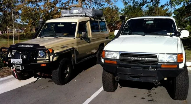

Actually back from the 'Stan and can begin the rebuild of the Troopie. Ever since I got the 4BT 80, I have been bit by the diesel bug and bought a BJ-70, and then promptly sold it when the Troopie fell in my lap.
From sunny San Diego, I poached one of TLCruiserman's imported trucks and added the troopie to the stable.
So, what we have is a 1997 HZJ-75 from Austraila. Comes with the 1HZ diesel with the Turbo Glide turbo added on to give the truck a little pep. ARB front bumper, fender tubes and ARB steps/sliders. Kaymar rear bumper with tire and gas can swing out. Inside, the stock seats have been replaced with some BJ-70 bucket seats and in the back, I still have the troop bench seats with an air ride BJ-70 bucket seat mounted behind the passenger seat.
All in all, pretty good truck, but as with all of us here, the never ending list of mods begins to grow.
The rebuild begins!
Troopie next to the Great White Buffalo

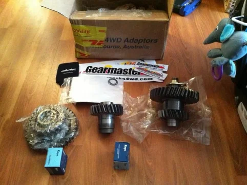

Ok, back on topic. The first bits of parts are starting to dribble in.
Got a package from Mark's 4WD and my transfer case gears came in. I got the set that gives me an 8% overdrive in Hi and a 44% reduction in Lo. And a bunch of swag came with it:cheers:
The interesting thing I had done was I had Mark's send the gear that is on the tranny output shaft over to Jack McNamara's shop to fabricate a McNamara gear for the replacement gear set. This will definitely be a great addition to the transfer case

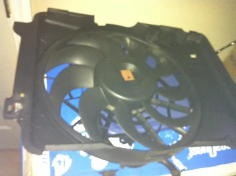

Oh yeah, taurus fan:meh: Don't know if I'm gonna use it yet, but there are some great plug and play relays for the 2-speed fans
