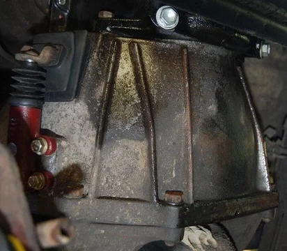

The gearbox has sprung a leak, looks like one of the front seals may have failed, thankfully it is not static, only when the truck is running. So, all my efforts not to have to drop the gearbox may have been in vain:meh: I'll probably top it off and drive it to Va. and drop the gearbox there. The good thing is, it looks like it is not the rear main seal:grinpimp:
