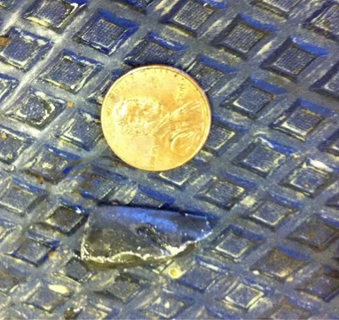

I dropped the fluids in the TC and tranny. Tranny was looking good, TC on the other hand still pewter looking and lo and behold look what I fished out of the TC.:doh:
Is this bad? :grinpimp:
Good thing I already have the rebuild kit and Marks gears already. Question will be is to I grab a new H55F as long as I'll have everything apart? I guess I'll answer that question when I take a peek at the clutch and see if I need to swap anything there:hhmm:

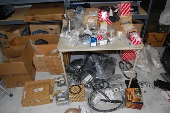

Well, got some work done on the troopie the last few weeks.

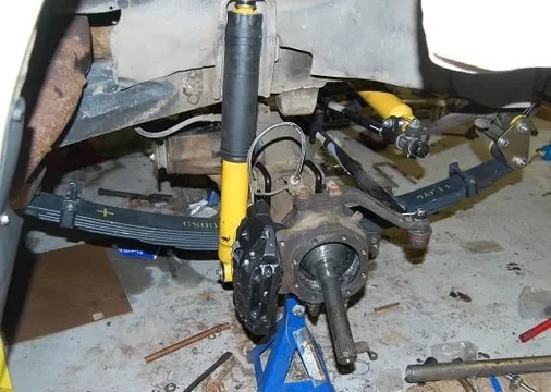

Got the front suspension swapped out, hello new, minty fresh OME among with new tie rod, relay rod and ends:D

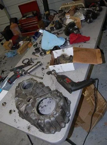

Gears, gears and more gears. Got the T-case on Greg's old A440F broken down so I can send the back shell off to Advance Adapters to get the mod dome for the overdrive gears.
Here's the pile of parts that I am slowly whittling down.:grinpimp:

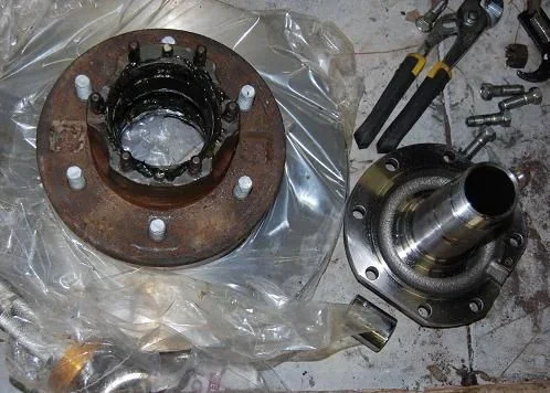

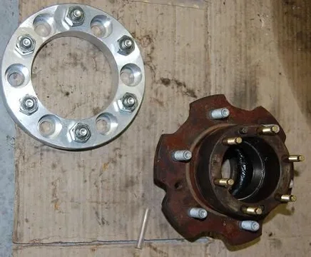

Hub refurb going on, new spindles for the front, new lugs and hub studs to go on F&R.
