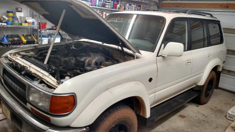

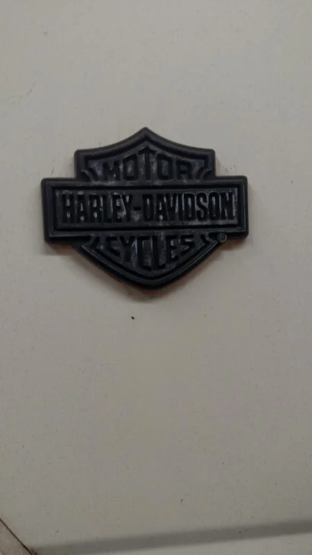

Decided to go ahead post some preliminary info on my swap. I've played with cars through the years but new to LC and 4WD work, so should be interesting experience. My goal for the truck is to restore and improve into a nice daily driver with some mild trail capabilities for the occasional trip to CO/NM. I bought it about a month ago thinking it probably had a blown head gasket and I'd get started on this swap. It has factory lockers, body and frame are in great shape but interior is pretry rough, although mostly completed. It is also the sought after Harley edition, see pic? Rear locker works but the front needs aome work. It was $1300, so i figured couldnt get hurt too bad on it. After looking things over after buying it I thought I had a stroke of luck and instead of HG it was a cracked oil cooler cover. But sprung another leak at the back of head after I replaced the cooler cover, so I'm throwing in the towel on on the 4.5 and getting back on the 5.3 swap.

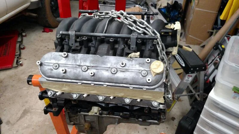

As you can see from the pics, the motor has an LS car intake on it currently. I also have the complete corvette accessory drive to go with it, in addition to the truck accessory drive. It looks like most on here have used the truck drive, but I'm going to see how it all looks and fits and make a final decision later. Regardless, will be drive by cable.

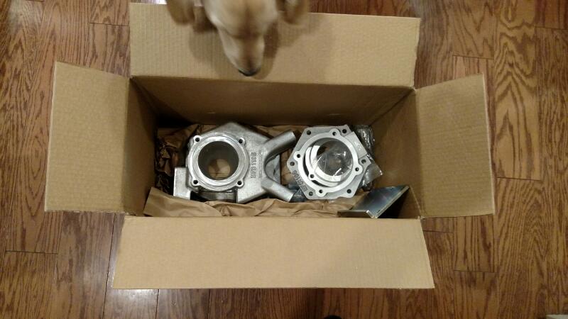

I ordered the Marks adapter about a week ago and received it yesterday- can't beat that (dog was impressed). I ordered direct and with the exchange rate it ended up being just a scratch over $1k shipped- which still makes me a little weak kneed, but better than $1500.

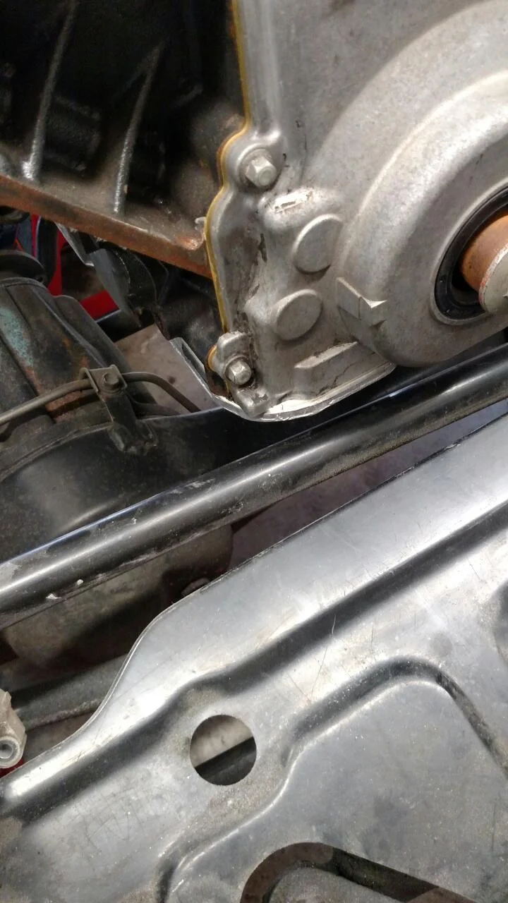

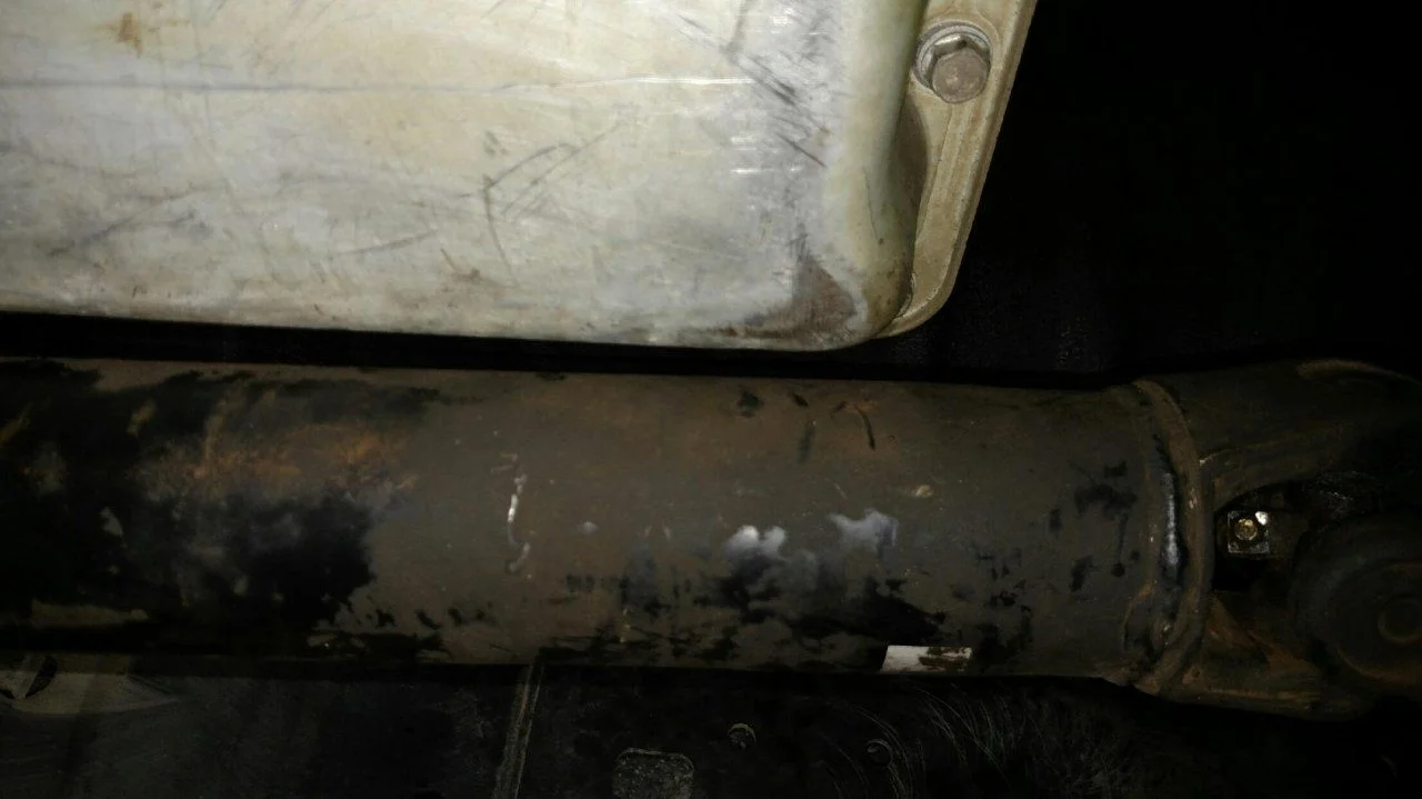

Progress has been slow, but I'm getting close to getting the engine mounts welded in. I'm going to try to use f-body mounts on the motor-- we'll see how it goes. Will take some more pictures in a while. Here is a pic, of the front driveshaft by transmission pan. I have about 3/8 inch clearance sitting on the ground. I think it will be fine with either smaller drive shaft or maybe 2" lift--or if need be, both. What do you think? What would you consider a safe clearance here? I'm going to go ahead and get the motor mounts done and then i can do a little more flexing/testing clearances here.

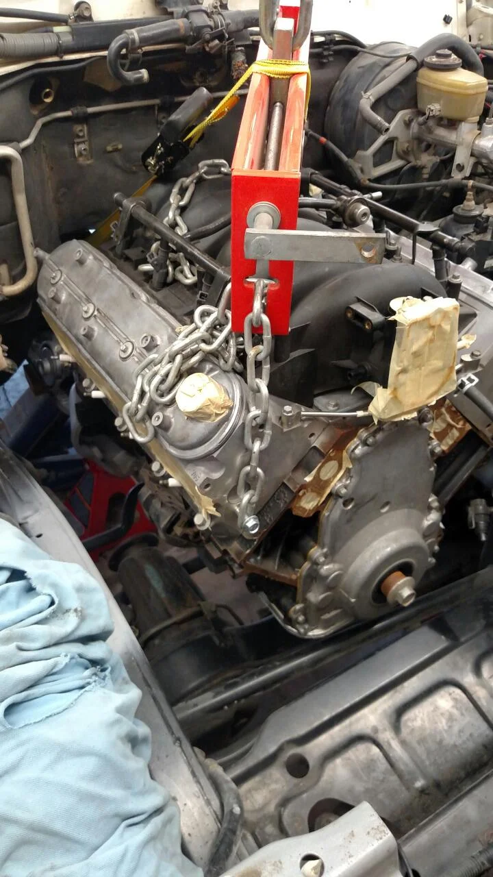

Finally got the motor mounts built and welded in. On the motor side I ended up using mounts from the F-body cars. I like the idea of being able to buy replacements or upgrades off the shelf. Will be working on getting things cleaned up under the hood and getting the motor in for good (hopefully.)
I've decided to go with the truck drive and intake. It just fit better than the corvette accessories. I picked up a returnless fuel rail on ebay and will be using the corvette filter/regulator approach to fuel.

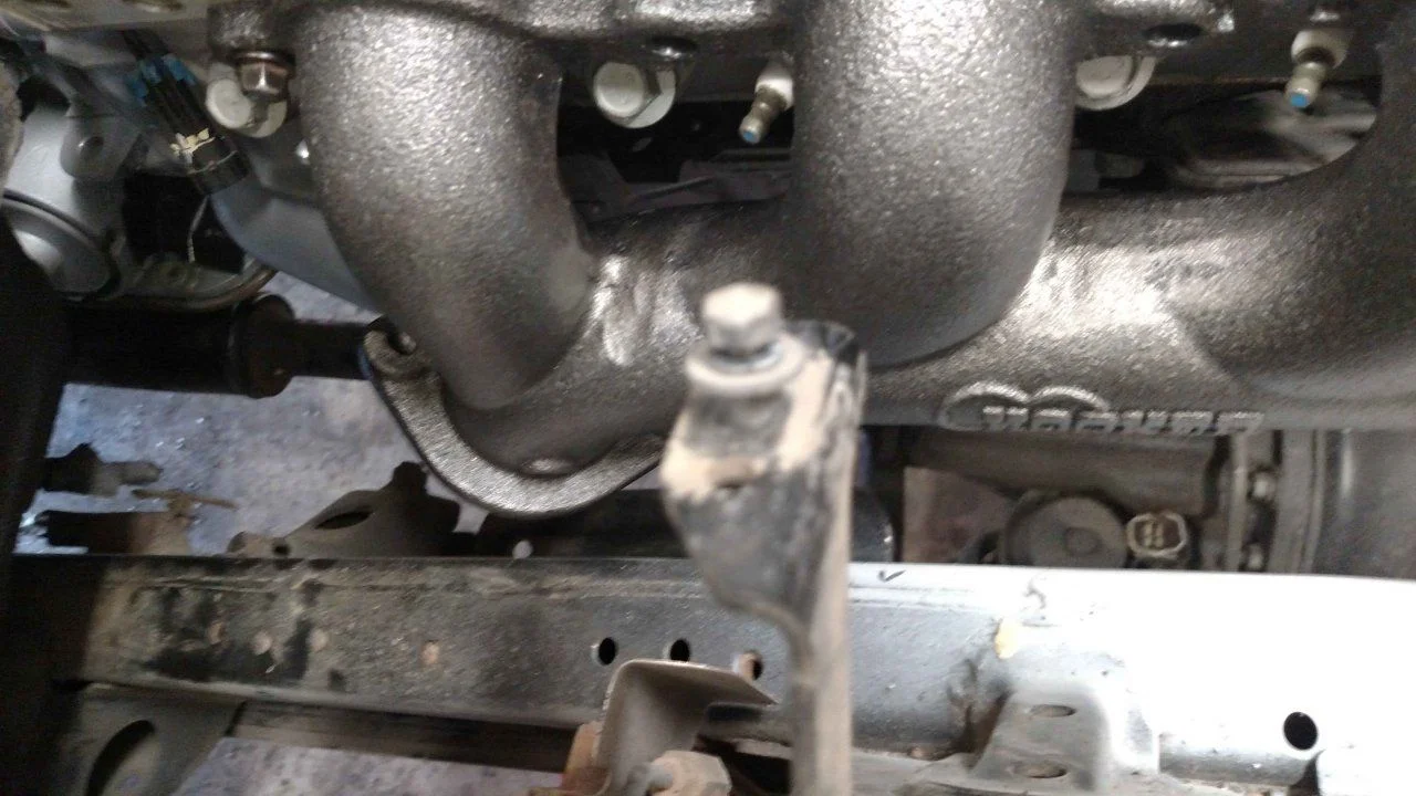

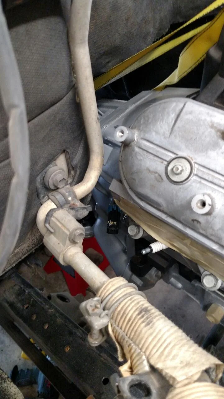

I also picked up these exhaust manifolds (Hooker #8501HKR.) I wanted to avoid headers if possible and I think these are going to work. Going to re route the brake line on the drivers side, but otherwise they should work pretty well.
