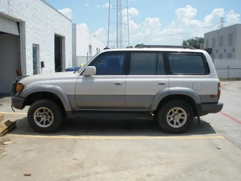

My 97' LC Build. just pics of the LC for now. im new to the LC so alot of stuff i dont know about when it comes to off road vehicle.
engine was bad and plans to do 5.3 LS motor and matched tranny.
Tcase either fj60 or fj80. most likely fj60 .
this has leather but driver seat has rip. seems to me the same in many others. headliner is real dirty so i will try to clean it if that doesnt work then it will come out.
this LC didnt have factory locking diffs F/R. so will want to add something later.
so far i have taken off the side step pieces. will also take off the fender flares. maybe get rid of 3rd row seats.
after i get it up and running i want to lift it and have bigger tires.
