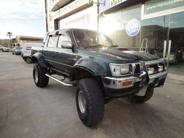

I started offloading some seven years ago after I set my eyes on a Hilux Ln109 (IMAGE 1) with some mods that I got in part ex with a new hilux since i was working at a Toyota Automotive dealership back then.

March 2010 - Still in showroom and decide to buy it. (IMAGE 1)

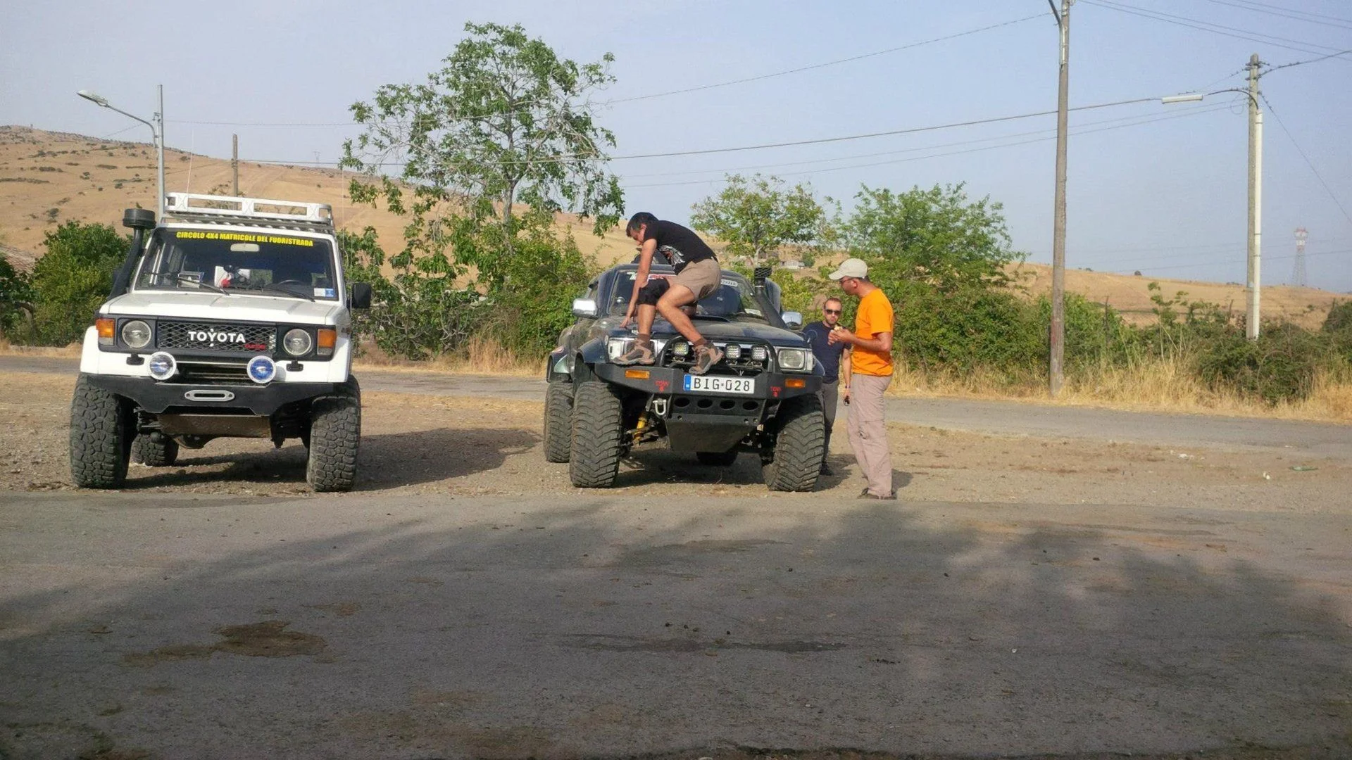

June 2010 - Purchased Mods: Replaced all ball Joints, Reworked rear suspension to accommodate a new 4 shock setup, Massive all round service, Turbo fitted, Snorkel, New Tires Maxxis 33s, New Optima Batteries x2, Sound system. (IMAGE 2,3)

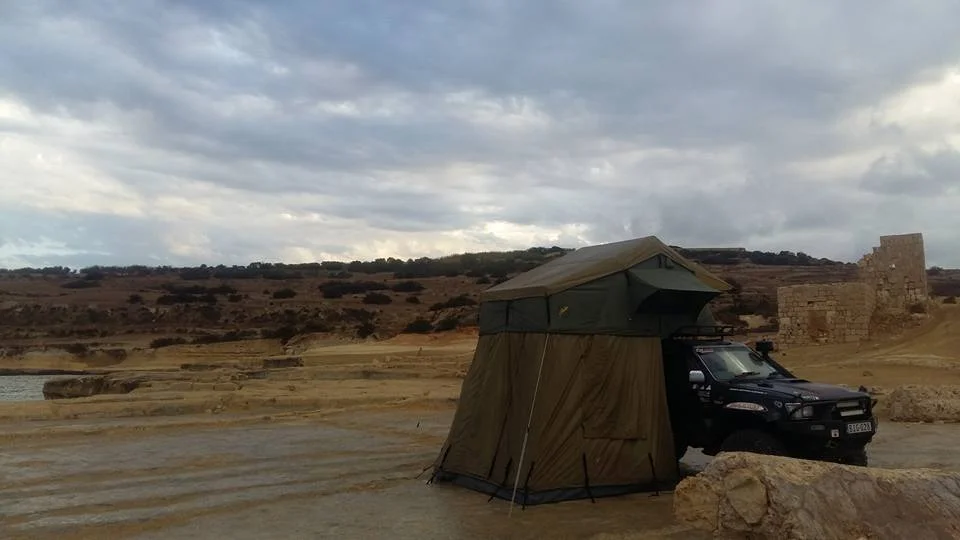

January 2011 - New mods: Front Bumper, Side Armor, Rear Bumper, New HD torsion bars, Chaos Fab steering and hud joints with King Kong steering system, Front diff with Nitro Ring and Pinion, rear Diff with Nitro Ring and Pinion, All ccrosses changed to Marlin Crwaler, New front Shock OM EMU, Chargecooled, New Aluminium Radiator, All hoses replaced with Samco.(IMAGE 6)

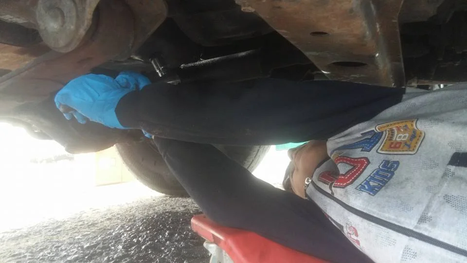

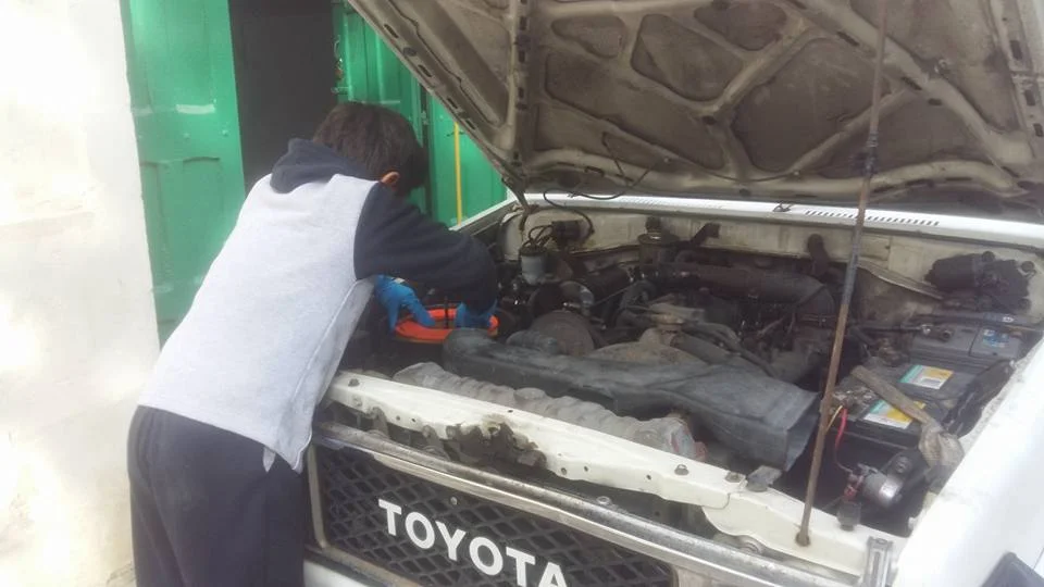

Feb 2011 - .... Locally tested. (IMAGE 4,5)

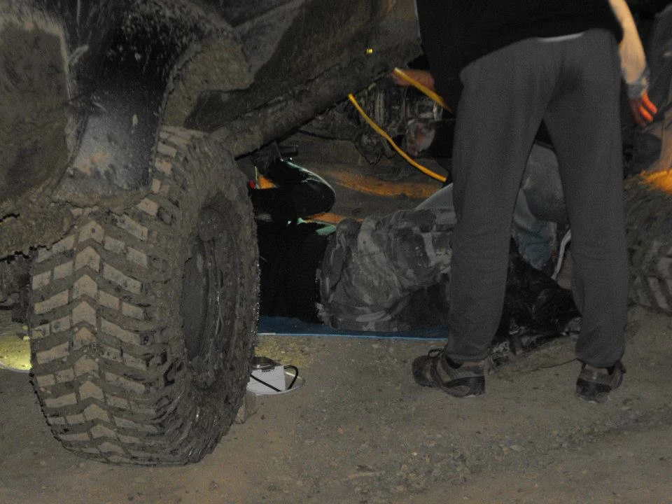

December 2011 - 5th Trip to Italy - Disaster Strikes. After 4 days of constant offroading the front upper arms tore away from the chassis. This was a major breakdown. I had to weld everything in place while having two other Trucks pulling the chassis in place with their winches. (IMAGE 3) It took all day and was really pissed. The problem was that the factory bump stop got bent upwards, thus the arms had more travel and the upper arm was pressing against the chassis. I had to drive back to port and Malta with a Truck that had its front right suspension almost solid with no travel at all and a bent chassis. I actually did more damage repairing it that day as I had did not have the proper tools with me but I had to get it home. (IMAGE 8,9,10)

Meanwhile this year I had the opportunity to get my hands on Two 1985 Bj70s. I plan to have this ready built for my son, although its another 7 years until he can drive but he did most of the work on it is doing it himself already. He serviced it completely on his own including the gearbox and axle oil, apart from assisting him and mentoring him when required. So proud of him as he is so much into offroading and toyota 4x4 but still takes care at school and gets good results. (IMAGE 19,20,21,22)
