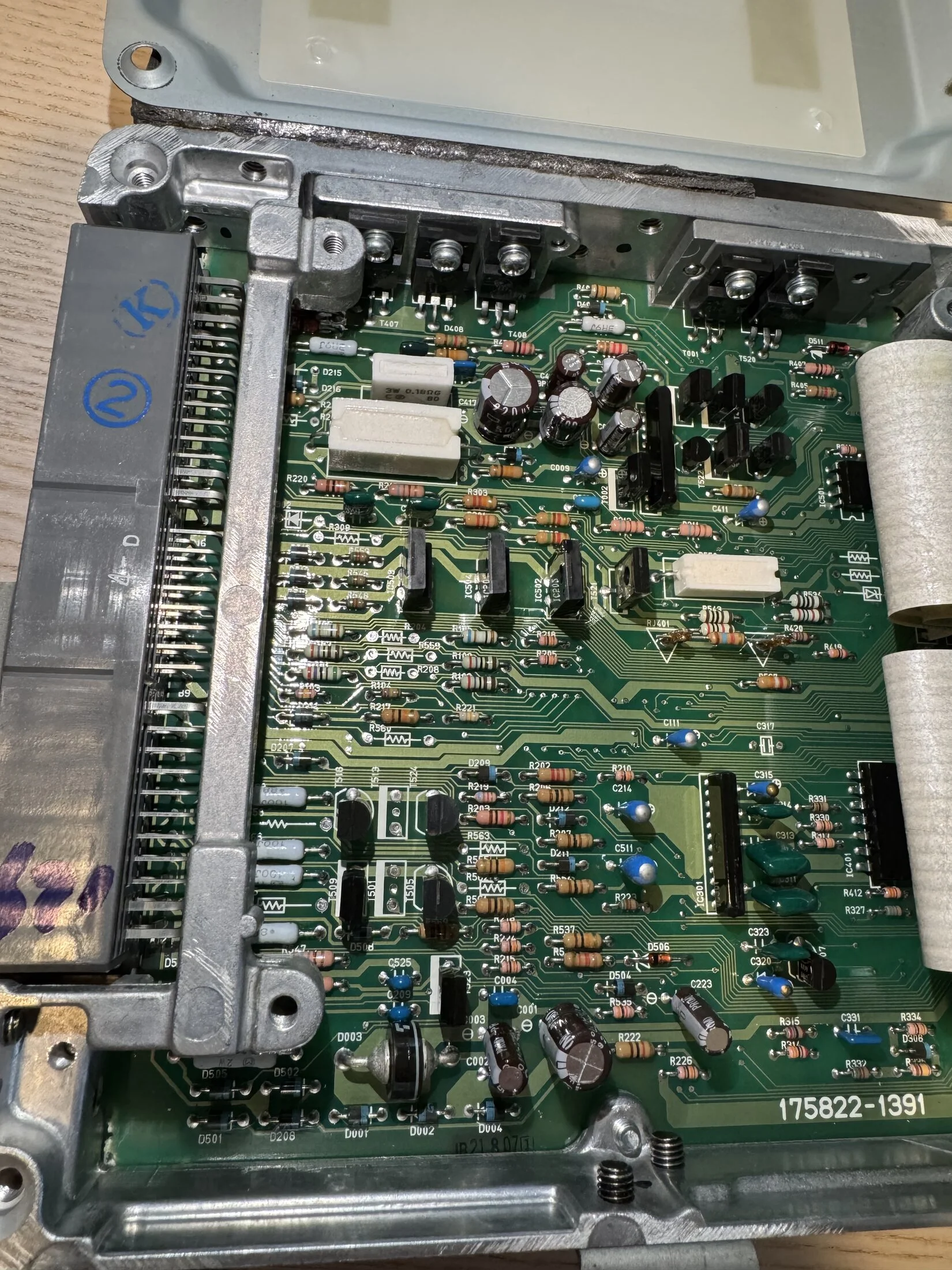

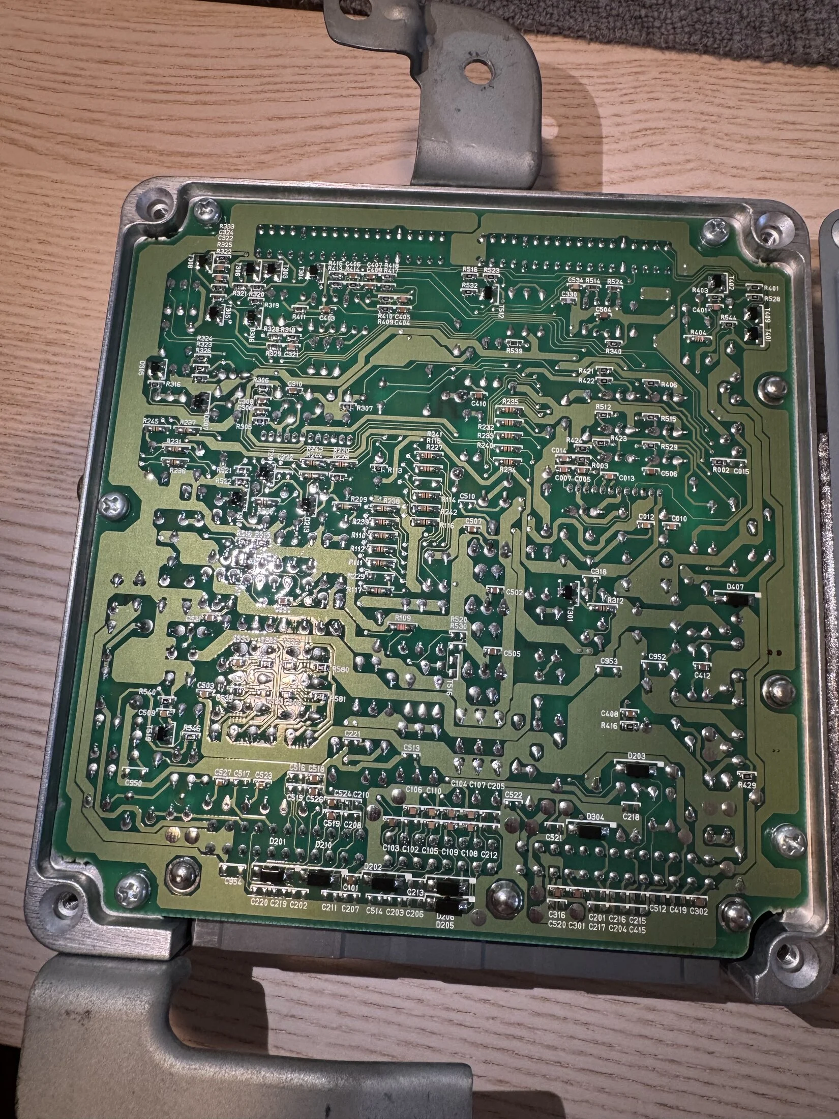

I’ve pulled the ECU multiple times (pictures attached), but overall it seems in amazing shape. Additionally I checked the wiring for the pump and I could not see any noticeable damage.
Is it worth paying for the ECU to have the capacitors replaced even if everything looks fine?

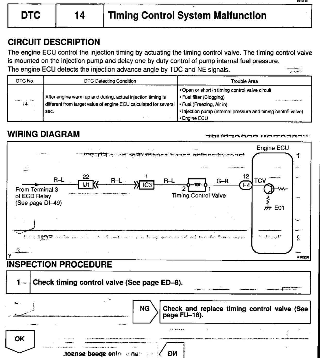

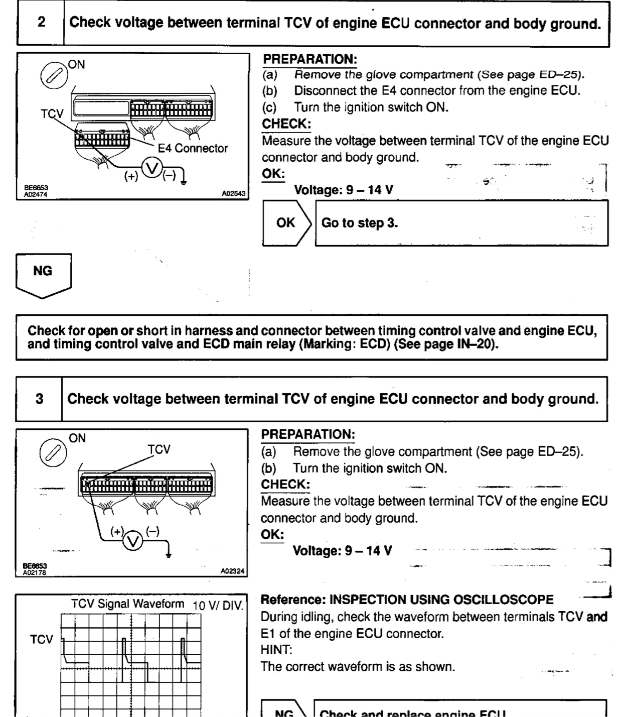

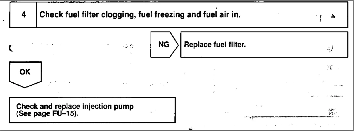

Thanks for your reply!
I absolutely agree that we probably jumped the gun replacing the injection pump; however, we were following the 1KZ-TE Technical Manual for code 14 (pics attached), and the mechanic I took it too is known as one of the only techs in the area who can work on this old engines. Even so, I did ask the mechanic who was working on it if they tested the fuel system as one of the comments above recommended and they stated that they had (most likely did not).
I will give it a shot and report back! Even if this addresses the rough idling (which is gone now after replacing the leaking plastic portion at the bottom of the fuel filter), would that still be enough to trigger limp mode at 2200 rpm?
