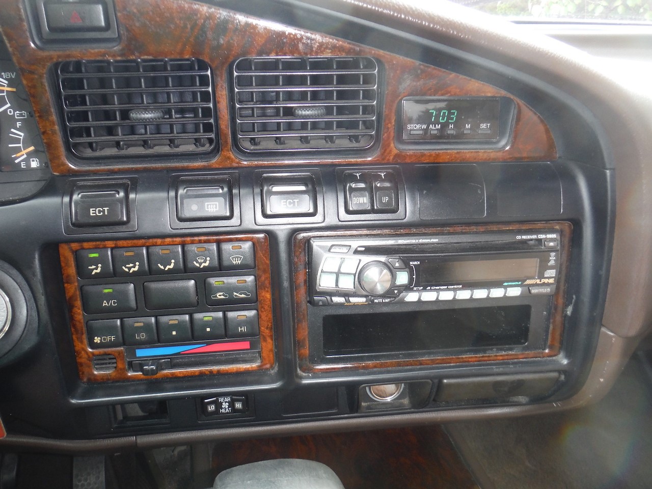

I should have mentioned, the truck already has an aftermarket Alpine HU.

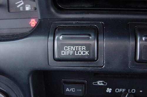

Also, the savvy observer will notice the second "ECT" switch on the left. The PO did the pin-7 mod and added the "CDL switch. I confirmed that the second ECT switch on the left actually engages the center diff, and I've already ordered the correct CDL switch (Toyota PN: 84725-60010), because I'm OCD.

Dig into the stereo threads a bit for more detail but overall the install was easy. If you plan to install a CDL switch do it at the same time since the dash will be apart. Also if you plan to install a sub do it at the same time to avoid tearing everything back apart again (like I did). Also note that the front speakers on the bottom of the dash are worthless and should be disconnected. The same goes for the top speakers in the very back. These share a signal from the door speakers and will sap power from your newly installed speakers and turn it into distortion. Also disconnect the factory amp since it will not be needed.

Oh! One more thing I know I'm going to want to fix - The faux wood paneling trim in the truck (around stereo, window switches, A/C vents, etc.) is delaminating and looks terrible. Plus I hate the way it looks even if it was in good condition. Does anyone make replacement trim in plain plastic?
You'll have to look around for kits. It doesn't seem like there are many options and the ones from Toyota are ridiculously expensive(like $750 ridiculous). Some guys just use a heat gun and remove them and there is usually writing under the laminates on the door controls that say whatever the writing says on the laminates. It's actually real wood under there though. The raised appearance has a specific name that I can't recall right now is called a "domed decal", but others have said there are ways of making new pieces that have that look.
There is "plain plastic" under the faux trim. Peel trim with hair dryer if needed, simple green, scrub with cloth to remove glue, polish it up.
Otherwise there are some carbon fiber and polished aluminum and other effects other than wood avail. Lil google should find something.
Thank you! I may look for polished aluminum and try to get them powder coated. That would be slick!
Edit: I'm going to try to use a heat gun and just remove the factory wood trim.

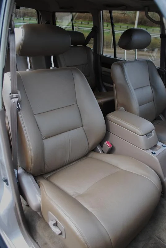

Small (but disappointing) update. I ordered a set of Specter Off Road Tuff Duck slip covers to protect my awesome port-leather seats (cloth manual seats covered in leather by Toyota at the port of entry). I had seen them before in person on a 60 series and really liked them. They were high quality, fit snugly, and were really heavy duty. Plus, the color was a perfect match for my '93 dark brown carpet. Basically - chocolate brown.
Anyway, the covers came in this afternoon and the color is terrible. Not even close to the chocolate brown I had seen on the 60 series or the "brown" advertised on their website. More of an olive drab or green color.
Needless to say, I'm returning them. If they had been the exact color I wanted, I wouldn't mind paying the exorbitant SOR prices. But for olive drab, no thanks.
I think I'll just rock my tan leather seats uncovered until they wear out. At that point I may try to get chocolate brown replacement leather.

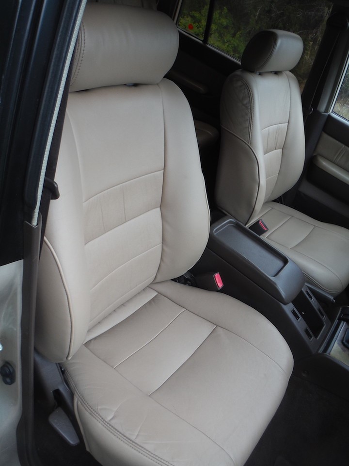

Can anyone recommend a Mud vendor for chocolate brown leather seat upholstery for a FZJ80 series with manual seats?
031-jpg.495073
The leather covers you have are protecting the real gem, which is the cloth seats beneath them. I would rock those until they wear out and then peel them off and enjoy the cloth seats. I have the cloth seats and I just use brown bath towels that I sewed little holes into that fit under the posts that the headrests fit into. I shake off the dog hair, spilled coffee and other junk that they pick up every couple of days and my cloth seats are still in mint shape because of it. The guy you bought the truck from has had full sets of the cloth seats in great shape for sale for north of $1500 on his website. They are worth every penny. Anything you cover the leather with will allow grit to work its way through and it will abrade the surface of the leather. The leather is your seat cover.
Well that makes the decision easy! Just return the SOR seat covers and put my butt in the seats!!!
