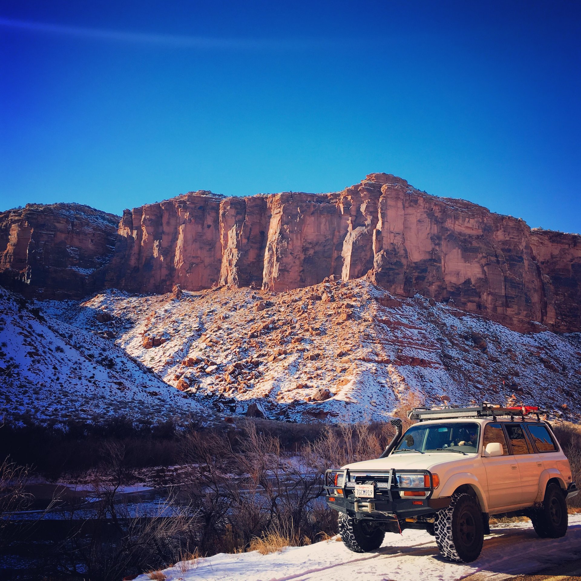

On 285 KO2’s at its second home. The gas station.

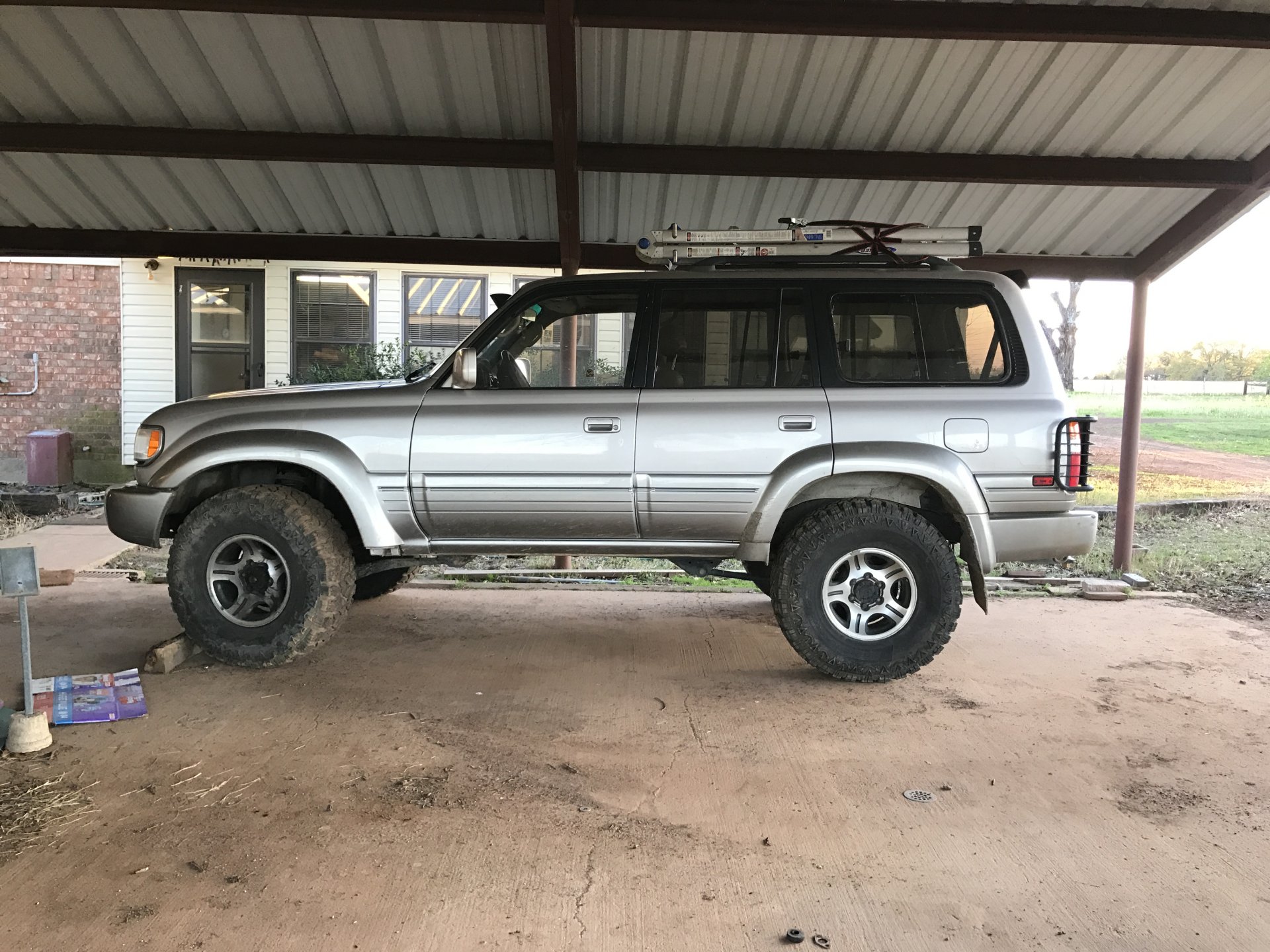

Photo gallery of my cruiser with 285/75/16 on worn out stock springs. My next upgrade will likely be a tough dog 2" lift with some sliders and I'll be set for a long time.

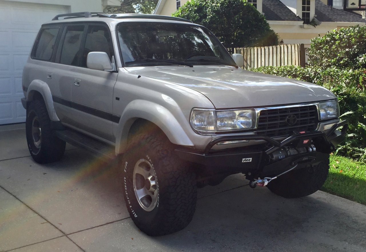

A few examples of 2.5" lift and 315/75/16 tire combo.
