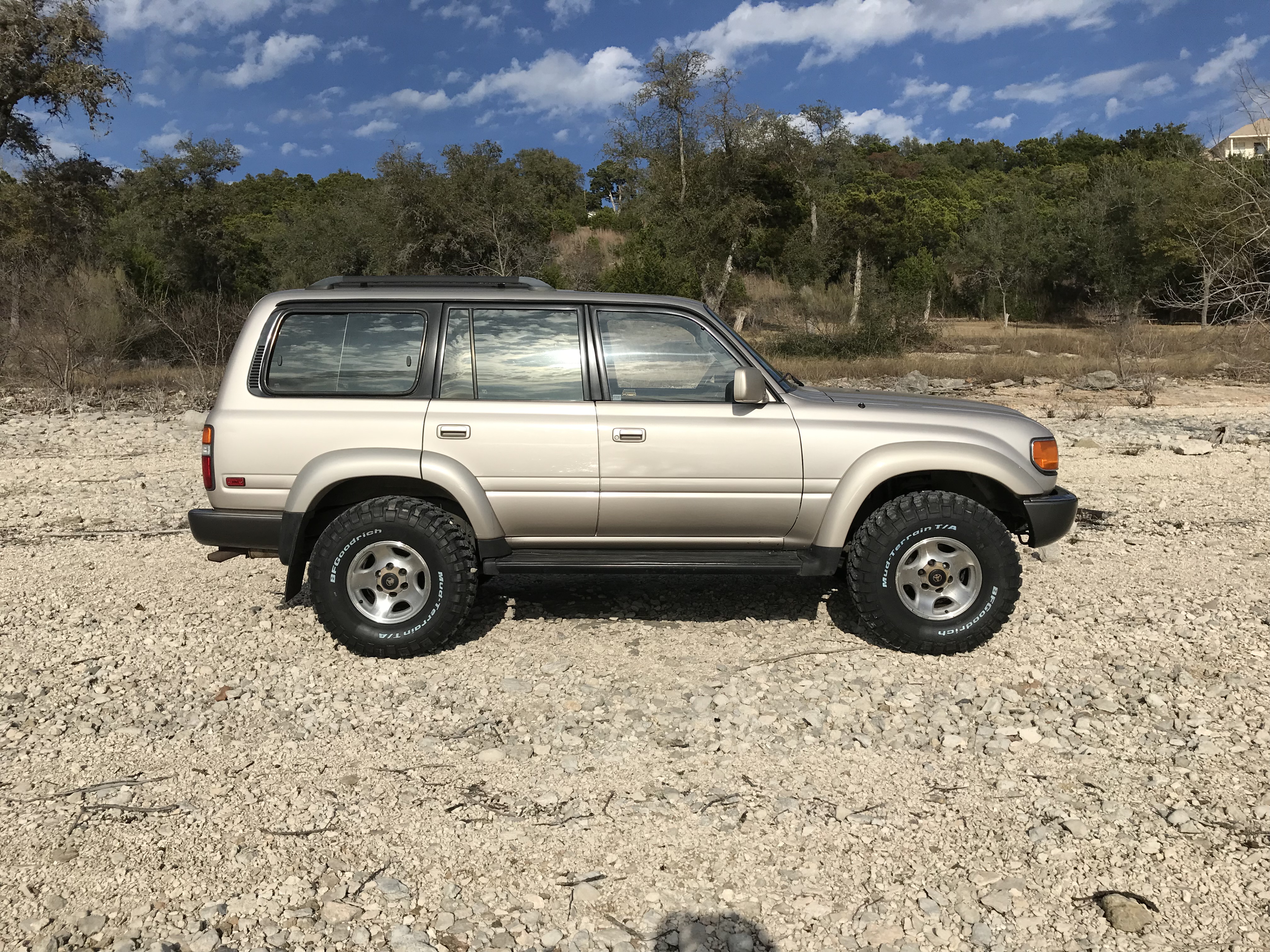

Small update. I finally got the truck back from my mechanic. They installed new tires and the lift, swapped in a new starter, rebuilt the axle seals, and changed the fluids for the diff, transmission, and brakes.
I'm a little disappointed, I asked them to change the oil and flush the power steering fluid while they had it, but they still hadn't finished it when I came to pick it up. No worries, I'll just do it myself.
I'm just happy to have the truck back! Took it out to the lake and put it through it's paces. Climbed a really steep trail that my 4WD Tacoma can't make it up. Performed flawlessly. Just engage the CDL and the lockers, and let it crawl. No drama.
Really excited to have the truck back. I should have some 'wheelin video shortly.

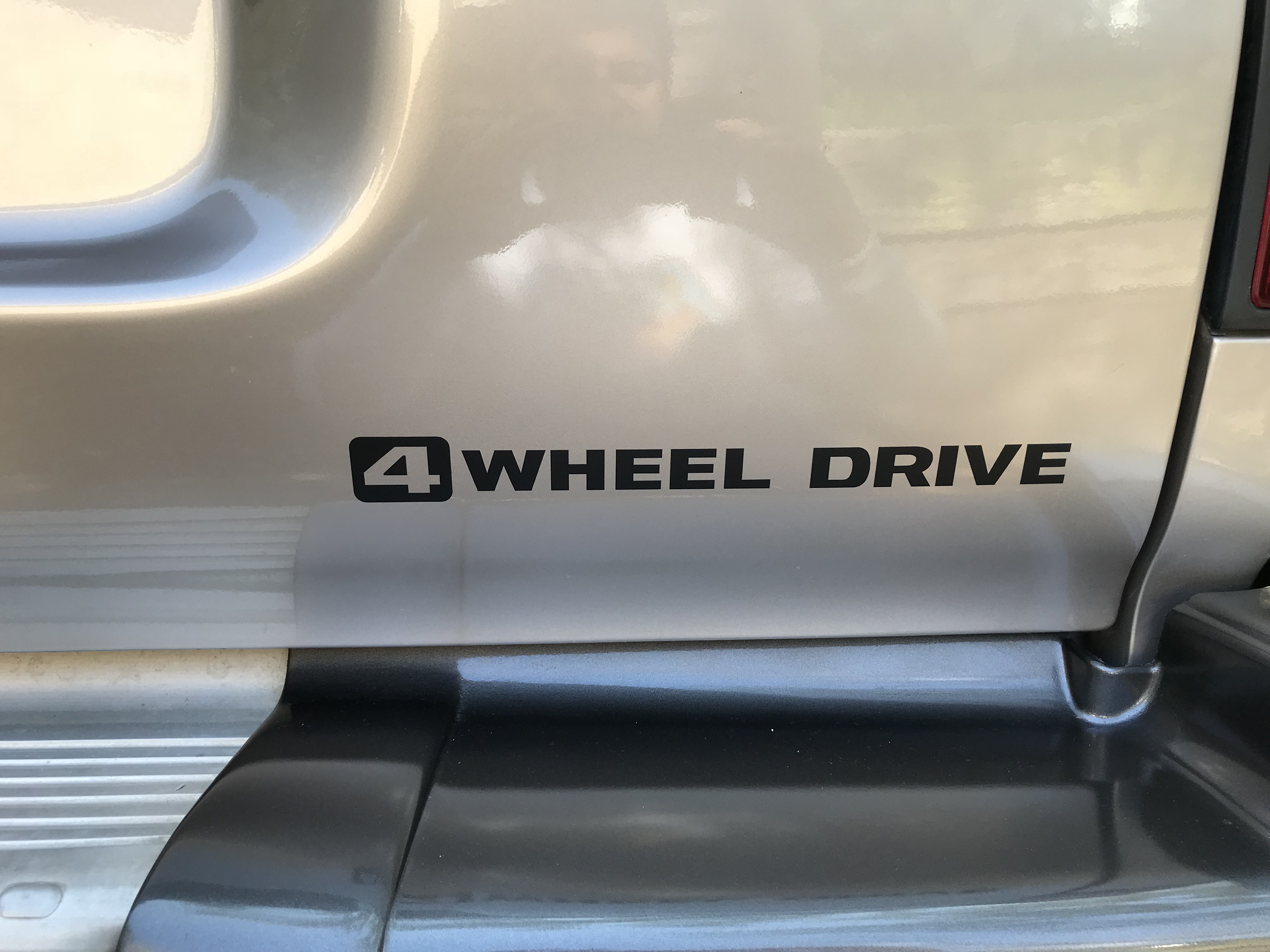

Do you guys like the "4 Wheel Drive" graphic?
Cruiser is looking sharp! Not big on the graphic since it says 4wd already on the stock badge, keep the clean look!
Yeah, I actually shaved the OEM “Full Time 4WD” badge. I’m not crazy with how the paint looks underneath. I think the graphic I added looks awesome, but I may go back to stock, just to cover the light spot.
Awe yeah buddy! Lookin better than shrimp on gritz!!!! I love it, Go big or go home with the graphics!
Thanks!

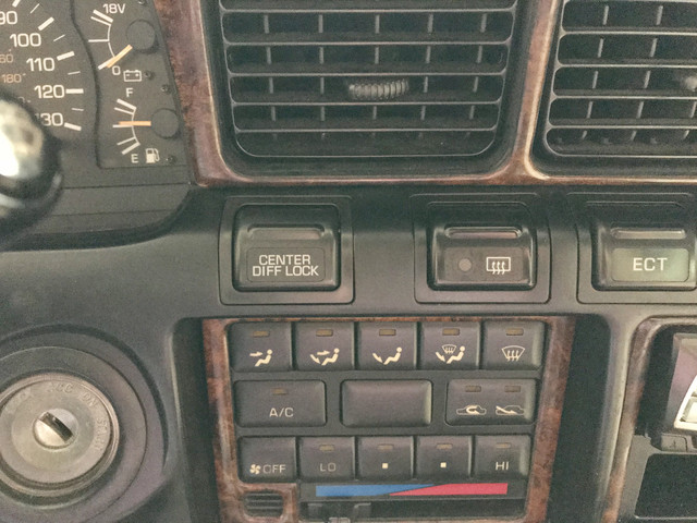

It's the little victories. No more double "ECT" for diff lock switch.
Before:
After:
Do you intend to keep the wood grain feature?
