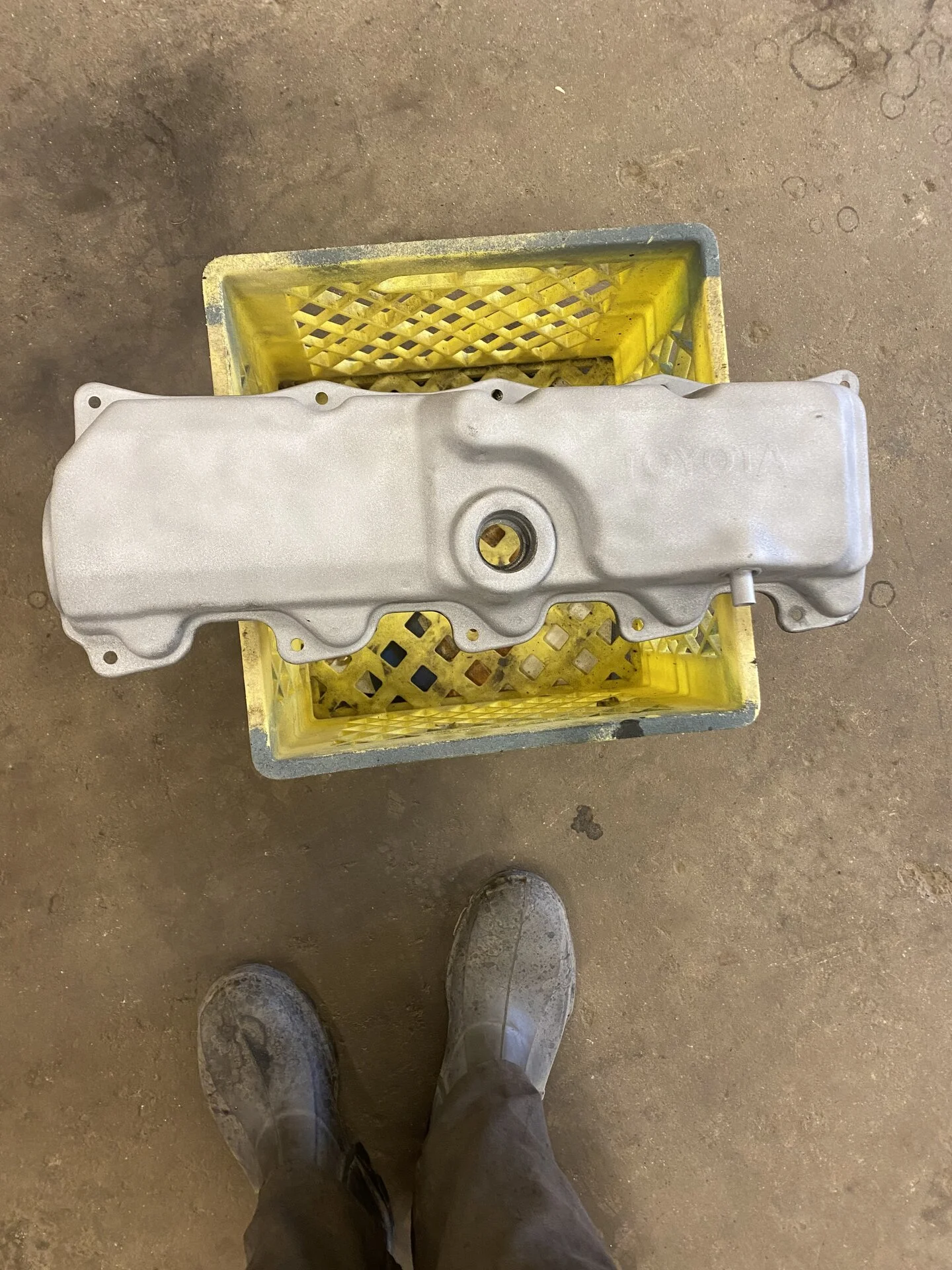

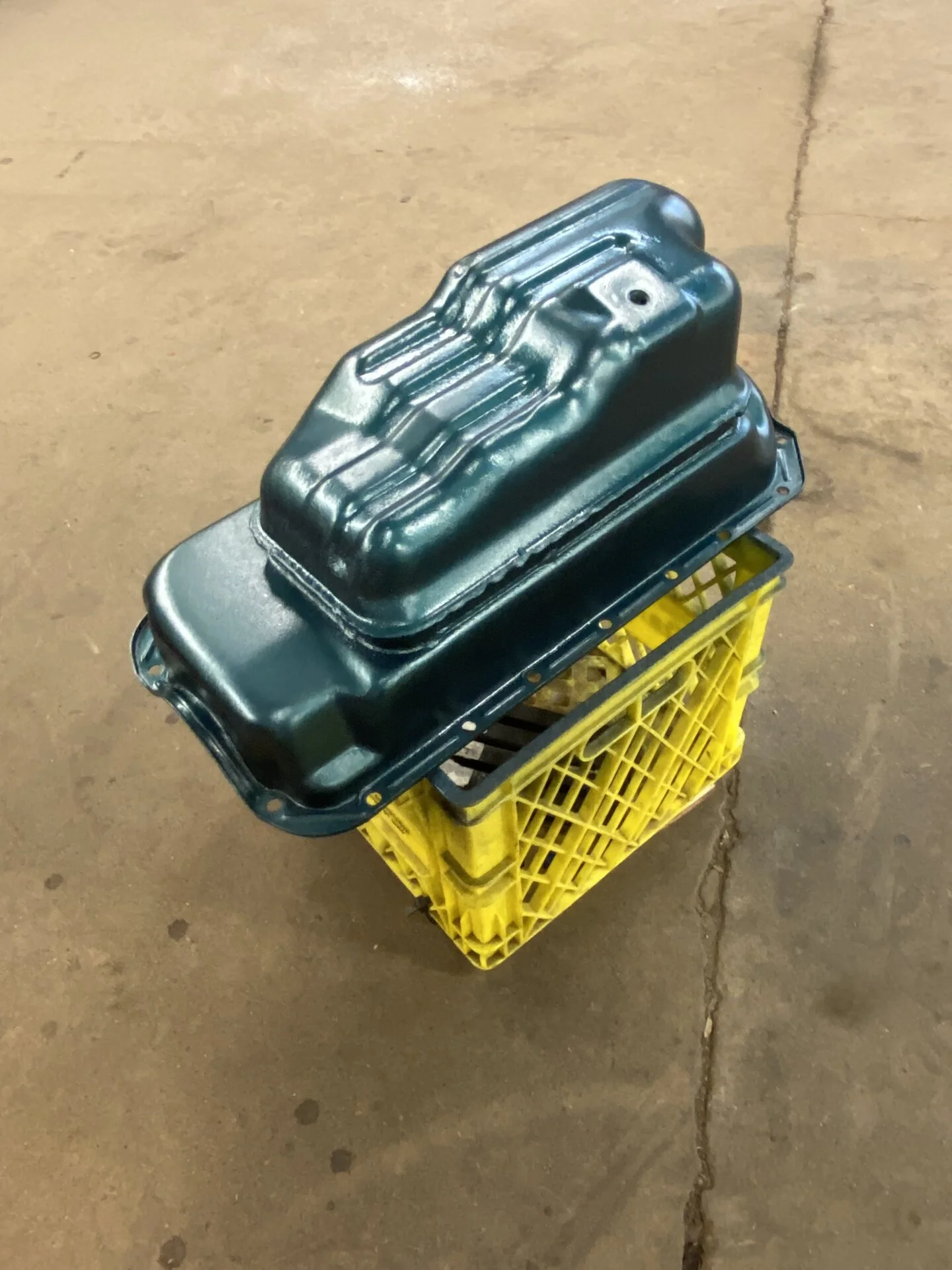

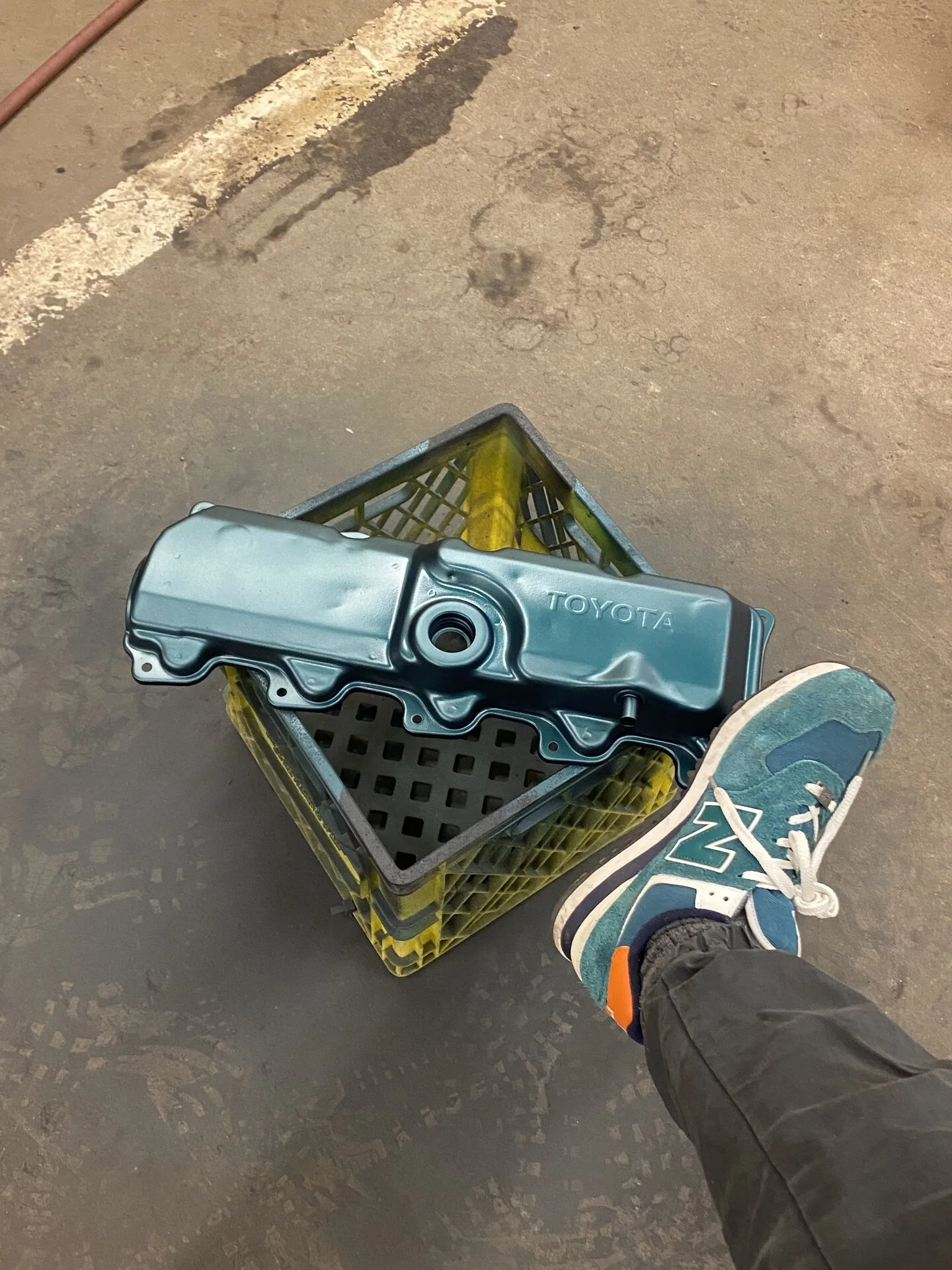

So far I've resealed my valve cover and oil pan as they were both dumping oil all over the place (sandblasted and painted too), deleted the EGR (mostly)/removed the two plates from the intake,replaced a very worn tie rod end and pressure washed the engine and trans. I have quite a list of mods i want to do but getting it running good and clean has been the most immediate goal. Two of the big problems i've been trying to nail down that have been giving me some trouble are a very rough cold start and a terrible steering wheel shake at highway speeds.

Found a old rolling sandblaster at work and decided to test it out for my rattle can paint job. Was pleasantly surprised

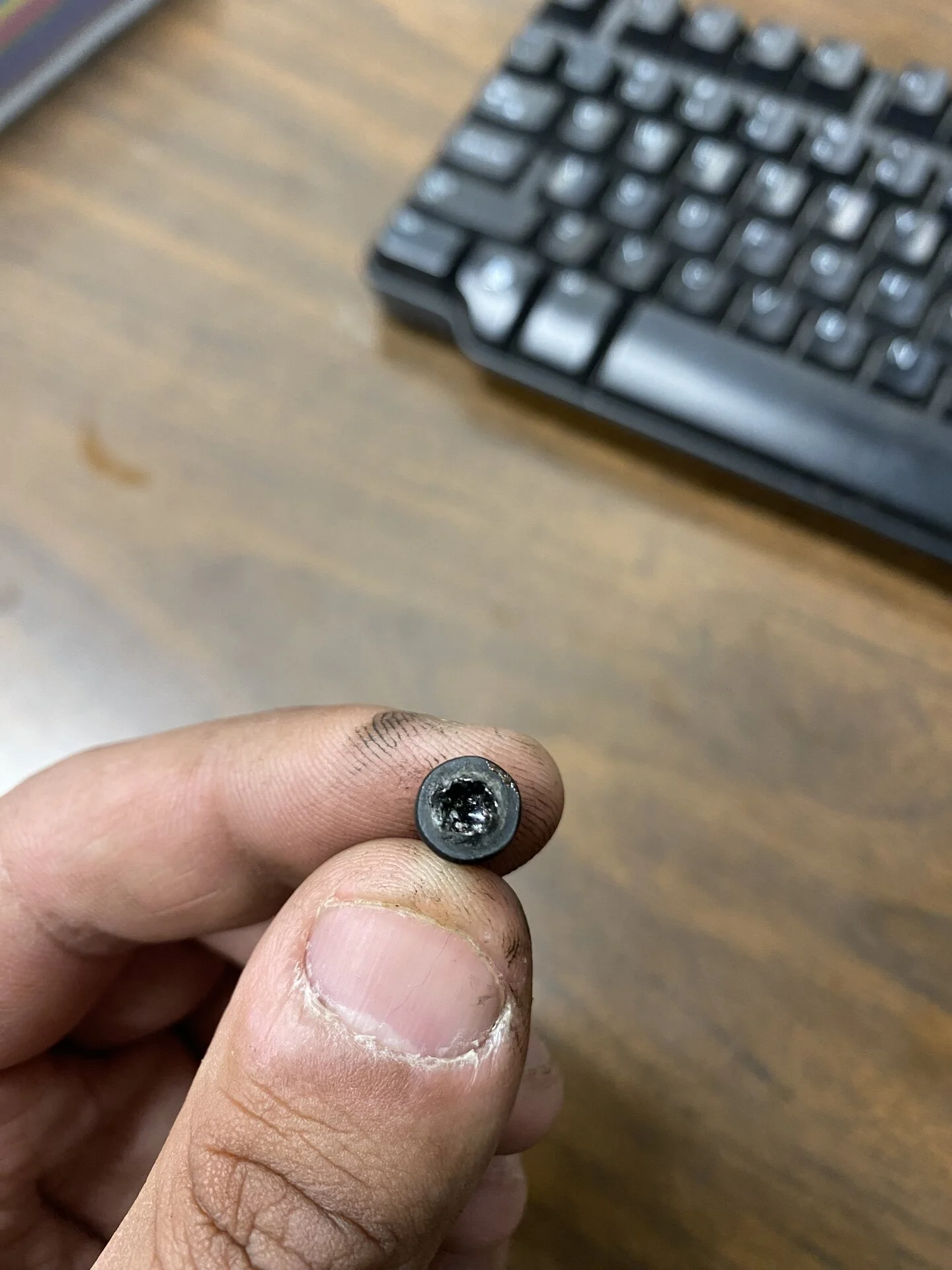

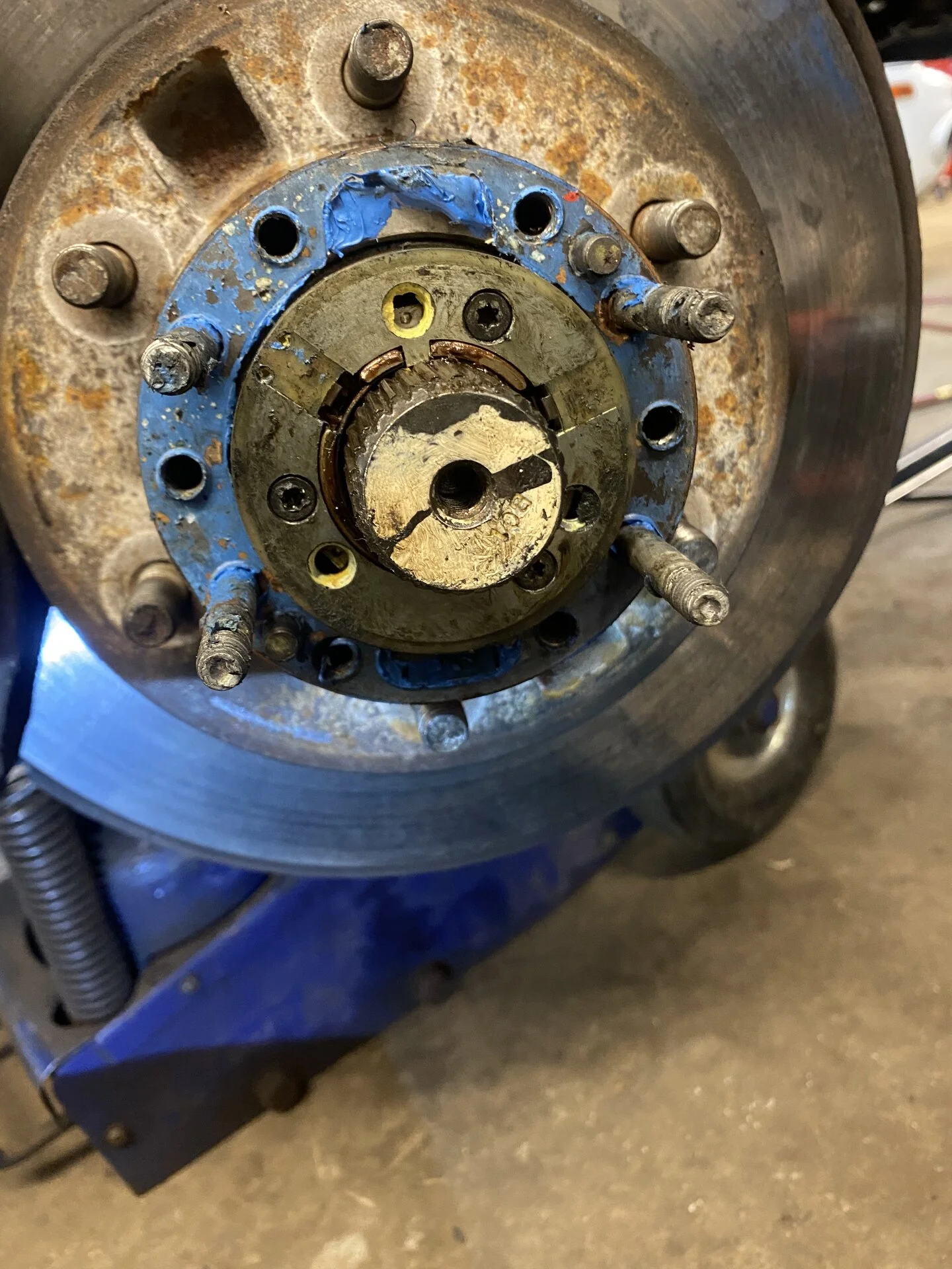

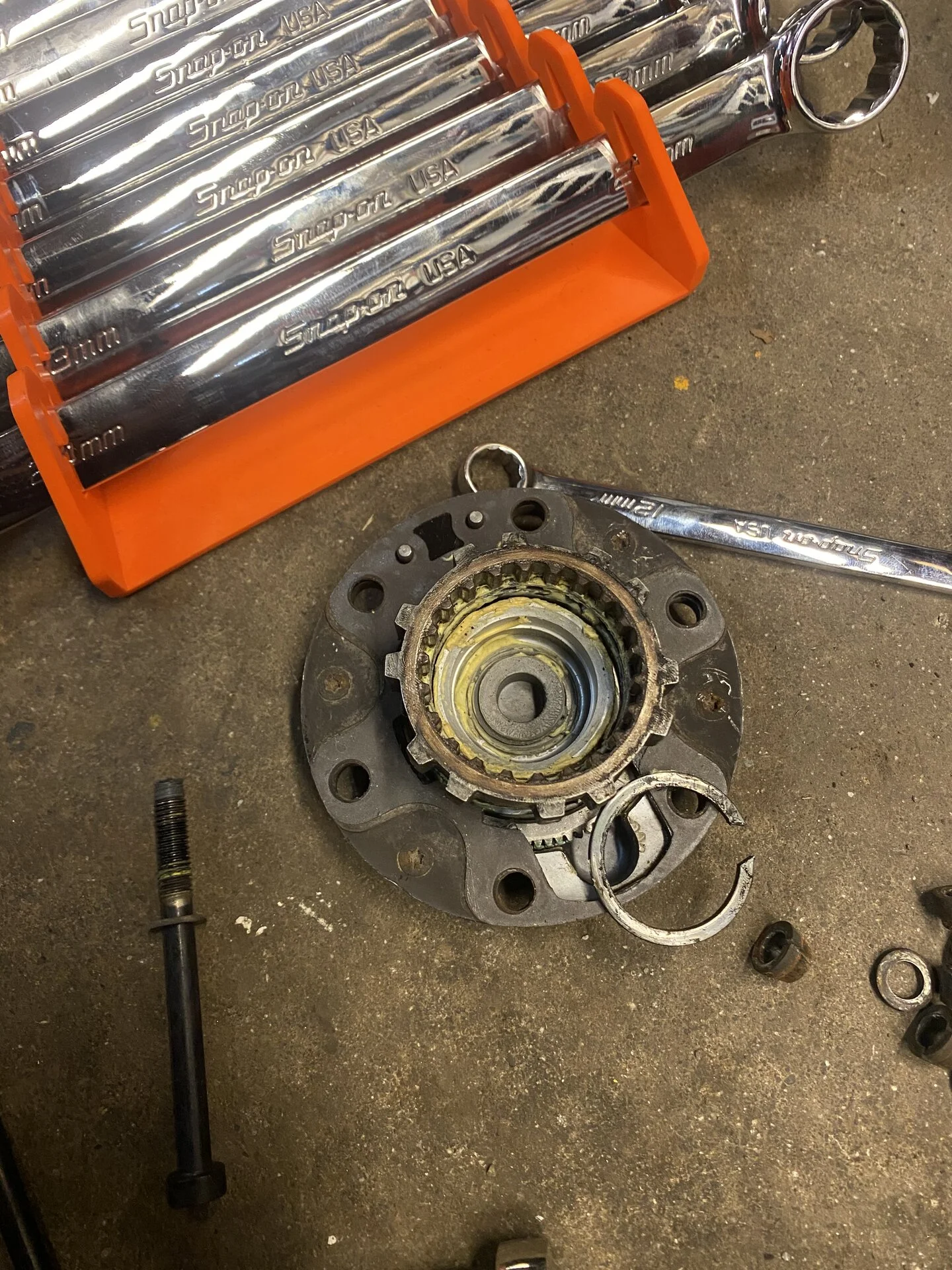

More concerning I realized my drivers side wheel bearing is loose, I found the lug nuts loose after i bought the truck and tightened them up not thinking much of it. I haven't driven it to much since then. Seems like someone tried to get in there and failed stripping one of the slip ring torx bolts in the process. I have the E-hubs and they both work well still. I'd like to convert it to the Aisin manual hubs down the line but see no reason to do it yet.
Once i saw this i slammed it back together and will re-visit tomorrow. I got the part number for the bolts but seems like they might be hard to find? Funky looking bolt anyone know if there is a alternative/cross. I'd hate to get held up by 3 bolts. Planning on getting some good time in on the truck tomorrow and will check out the glow plug circuit as well as hopefully get this bearing tightened up.

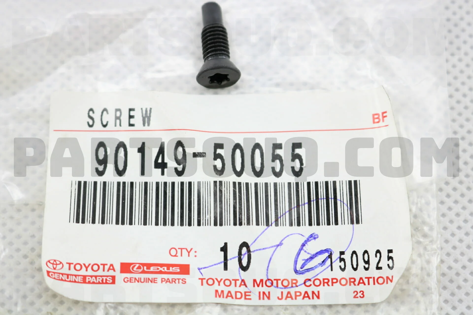

The torx bolts for the e-hubs are still available from Toyota, but not worth paying international shipping from Partsouq and the like. I ran into the same issue when rebuilding the knuckles on my LJ71 last month - someone had taken a center punch to one torx screw and left it loose inside the hub. Cruiserparts in NH had them in stock after Dad and I optimistically thought similar looking replacements from McMaster Carr would fit. They didn't and we wasted a week because of that. After ordering from Cruiserparts, all was well and the hubs are working as they should.
Forgot to mention that if your wheel bearing(s) are loose, that could be another source for your wheel wobble at highway speeds. After rebuilding the knuckles on the LJ71, it rides much nicer. Would definitely recommend rebuilding yours if you're up for the job!

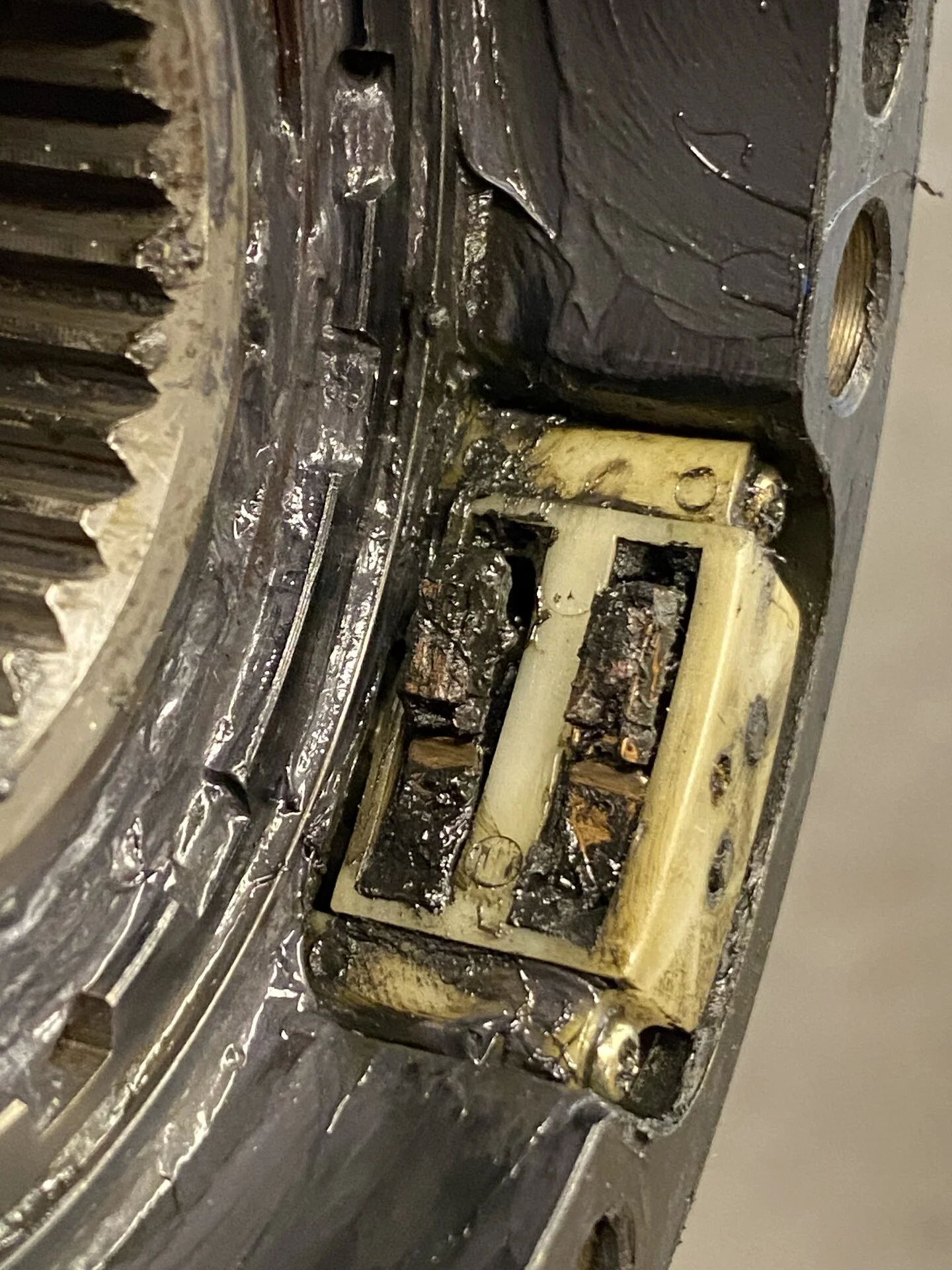

So i managed to get the bolt out, It luckily wasn't all that tight. just pounded a T25 on it. Ended up re-using it for now. I do plan on eventually cleaning up both front knuckles at some point. down the line once I have the engine running good.
Speaking of.....I made a little mistake here i think. After having my drivers side hub apart and back together. I did two things. First took my dash apart as I wanted to experiment with a few gauge mounting options. I noticed my speedo cable has been leaking so I dissembled it to clean up a bit. I assume it’s the same seal at both ends of the Speedo cable? Is it okay to pull the cable from the sleeve to clean and lube it?

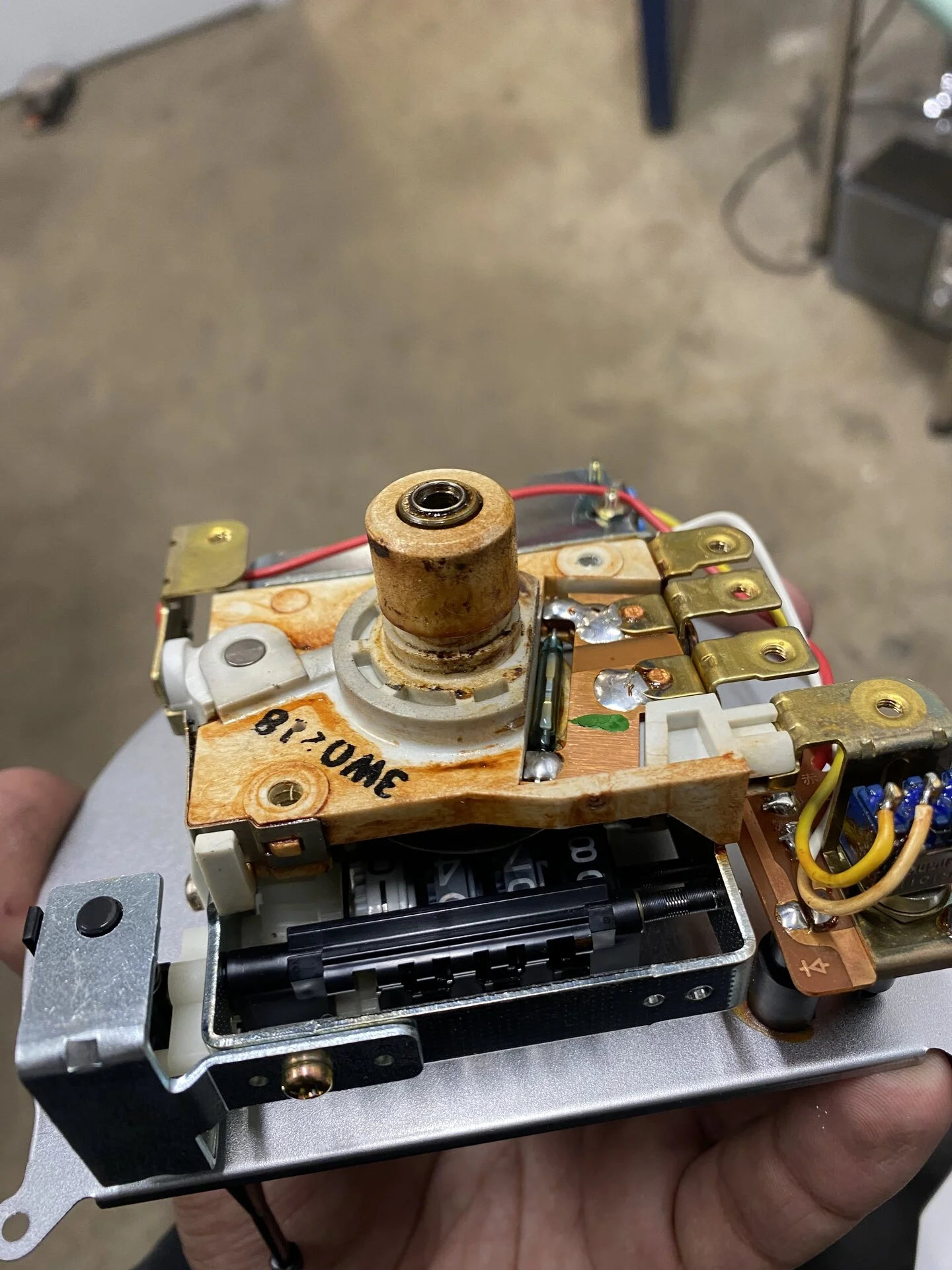

After re-assembly of that I figured I’d check out the glow plug system. Confirmed that my buzz bar was getting 11v and then the 6v after glow. Then pulled my glow plugs and replaced them as I already had a new set. I re-assembled everything but didn’t notice the buzz bar was contacting the manifold ever so slightly so I popped the fusible link at the battery. Luckily was able to get another 2.0 at my local lordco and repaired that quickly. But now I have a new issue. My transmission will not shift at all and seems to be stuck in neutral? I had shifted it into neutral during the hub disassembly as I was testing the e-hubs and 4wd engagement. At some point I put it back into park but I can’t remember if it was before or after popping the link. The O/D light is flashing as well. I assume that means there is a problem but not sure if you can pull trans codes the same way as the engine with the paper clip? I have no other light/check engine light. Truck starts right up and i can shift through everything but not able to move at all ( can push it by hand and it will move even in park). But I did hear a quick gear squeal when I went past reverse? Not sure if I fried something else with the glow plug mishap or if I did something with the Transmission when screwing around with hubs and transfer case controls. My Shifter has been “loose” since I’ve had the truck. The indicator is not correct but its always gone into gear or park without issue.

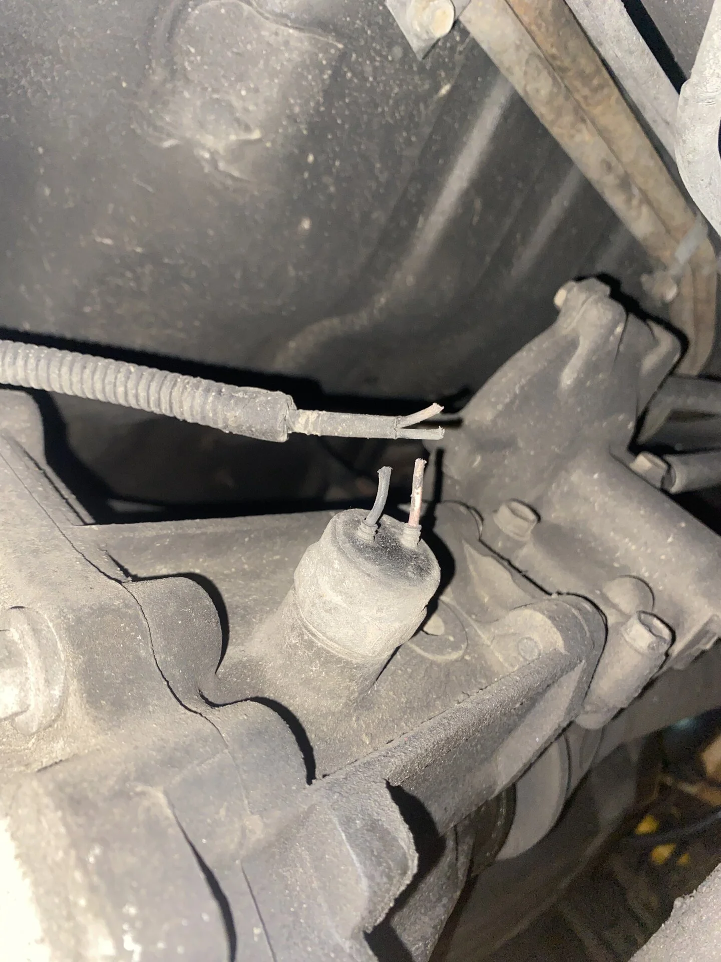

I also found this on the side of the transfer case and not sure if it could be related. I had to get going after this happened so didn’t have time to investigate but I crawled under the truck before I took off. it’s on the side of the transfer case not sure what it’s for?
I definitely have a few leads to chase. IE these mysterious broken wires but curious if anyone else has any ideas here. Wondering if whatever this sensor is has something to do with the transmission knowing whether or not the transfer case is engaged? I hadn’t put it into 4H since I bought the truck so maybe coincidence that this came up after the link popped? Or just wishful thinking :( these wires look like they’ve been broken for a while.

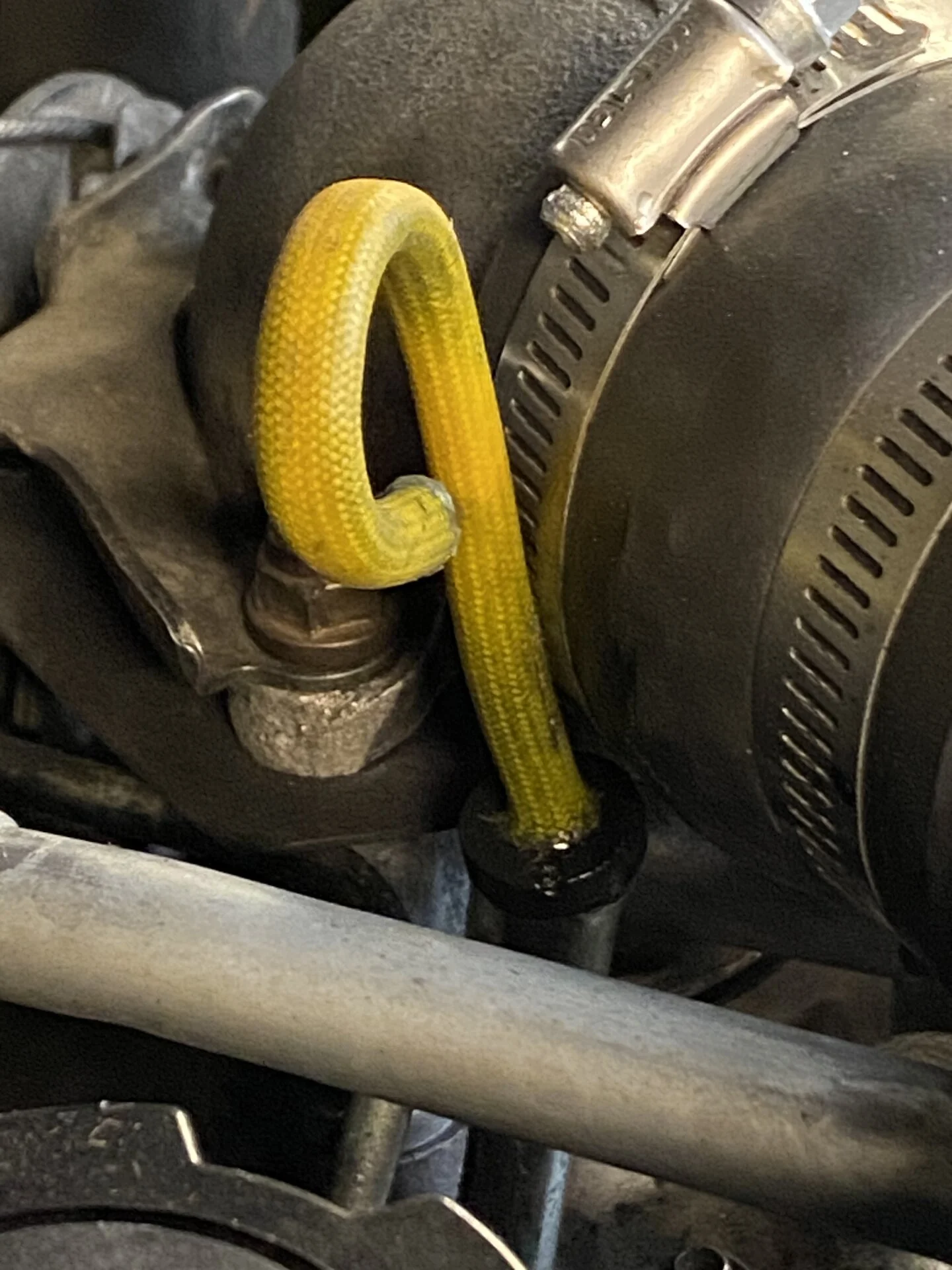

Also is this really the factory location for the oil dipstick? Can it be relocated anywhere?
It’s a pain in the ass to get too and will definitely rub through this boot. Trying to keep it positioned on the clamp for now
Hi @Chicken47
This switch is listed as a "transfer indicator switch" - Switch & Relay & Computer for 1990 - 1992 Toyota LAND CRUISER LJ78 | Japan sales region, , 17730662-910803 - https://www.megazip.net/zapchasti-dlya-avtomobilej/toyota/land-cruiser-38286/lj78-54926/lj78g-pgt-910803/switch-relay-computer-17730662#. Best to connect them up.
Regrading your speedo cable - detach from your transfer case and pull out from there. To insert, feed the cable from the bottom end up. Use DEXIII / SAE30 oil. While it is out, just check the condition :). I replaced mine a few weeks ago due to breakage.
repaired those wires and didn't notice anything change. Seems like my transfer case got stuck in neutral and wouldn't come out? I grabbed the linkage and gave it a good tug from underneath and heard a big clunk. All is good now and haven't been able to replicate the issue again. Call that a win i suppose!
