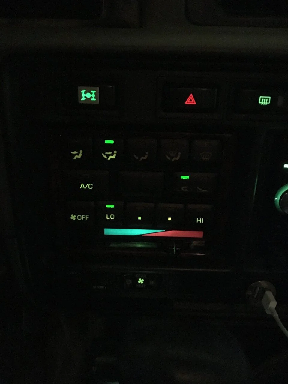

Just checked and my AC lights will be in today as well. I ordered green and blue to see which I liked better.
I replaced the AC lights with green...I decided against blue since the cluster was going to be blue. I like the green in the AC bc it isn't super bright....looks good.

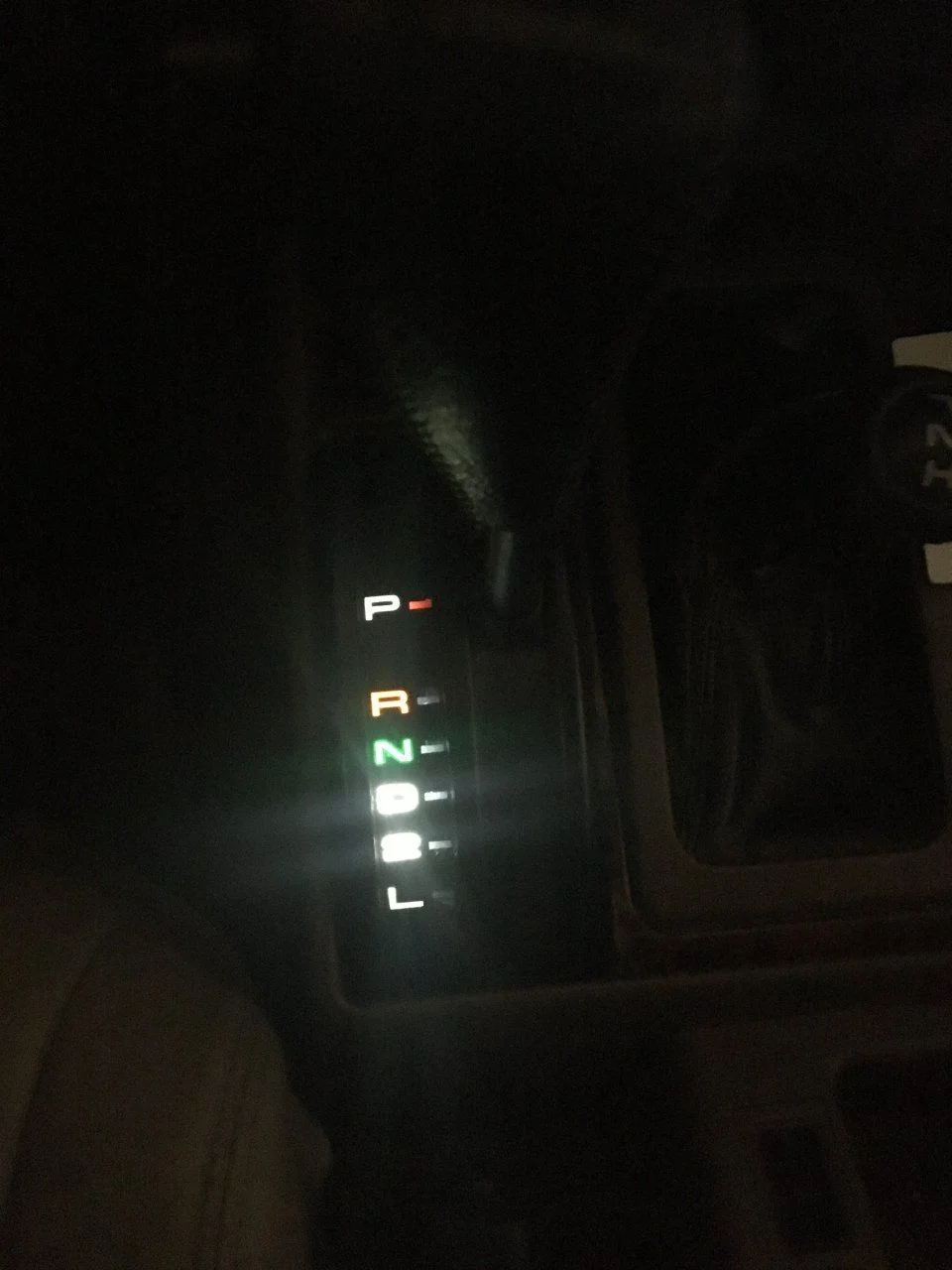

In the instrument cluster? No. they all work so I just left them. I think I have the correct bulbs for them but I just didn't get into it tonight. I tried to replace the key ring bulb with a 74 but I could not get a new bulb to seat at all. Might try it again some other time. I did replace the floor shifter bulb bc mine was out.

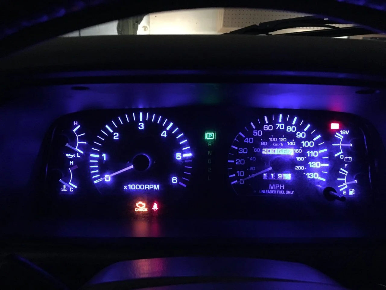

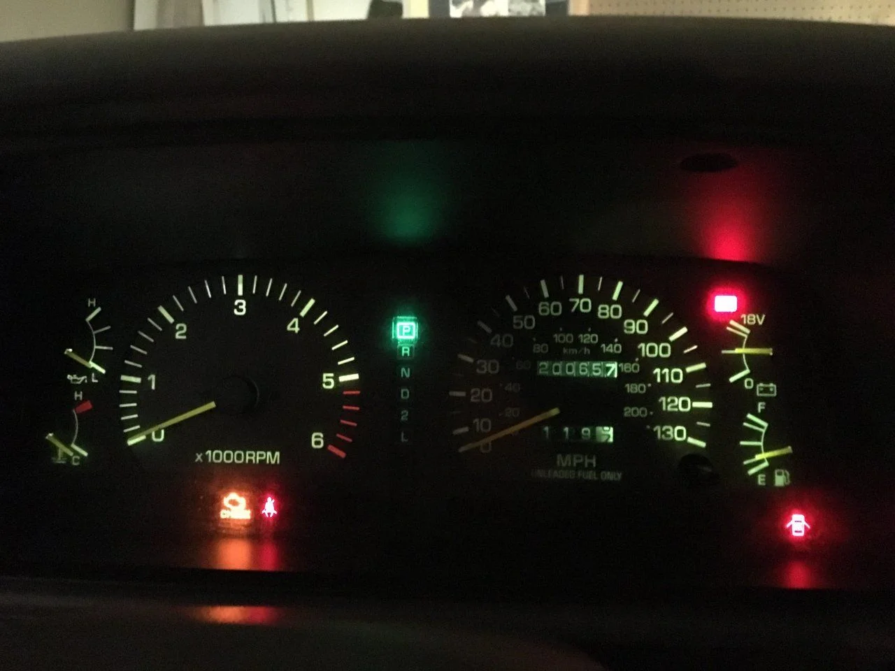

These are the blues for the cluster....only need 4 of them:
194 LED Light Amazon.com: 194 LED Light bulb, Yorkim 2015 Newest, 5th Generation, Interior Lights for W5W 194 168 2825 T10 Wedge 5-smd 5050, Replacement and Reverse T10 White Bulbs(Pack of 10)-Blue: Automotive
These are the white 74s for the shifter, glove box and several other things....I would buy 2 packs...I am going to order another pack.
Amazon.com: Cutequeen 20PCS White T5 5050 1-SMD 1smd LED Car Lights Bulb 17 18 27 37 58 70 73 74 79 85 86 2721 (pack of 20): Automotive
These are the lights I bought for the AC unit....just the main bulbs....you need 3 of them. I ordered blue and green but only used the green. I ordered from Autolumination.
Neowedge
Item# Incandescent , Color: Green , Lens: Type B (T4) $1.99
Neowedge
Item# Incandescent , Color: Blue , Lens: Type B (T4)
