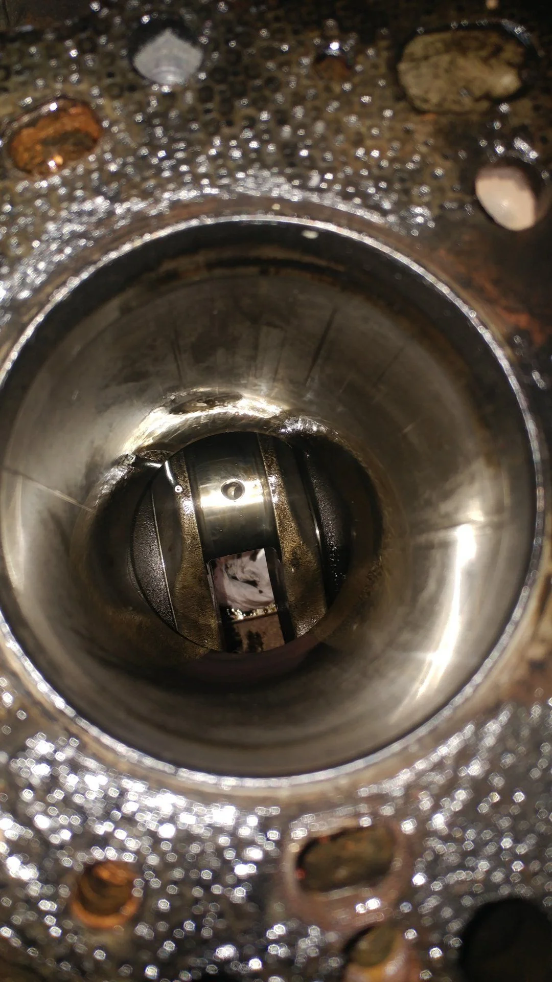

Not sure how to gauge if I need to have standard or oversized pistons but will be looking into that and the measurements associated to making that determination. From my limited experience the sleeves don't appear to damaged from the ring issues.
The following cylinders are the three worst looking.

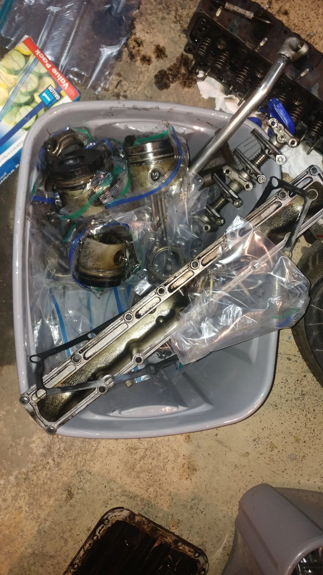

Here is a pic if the head fresh off the 12HT. I will go through this with the service manual and check everything is up to snuff. Polish it up and re assemble.
Once you tear an engine down, bag and lable parts and put the bags and parts in different tote, a freaking engine takes up some space!!

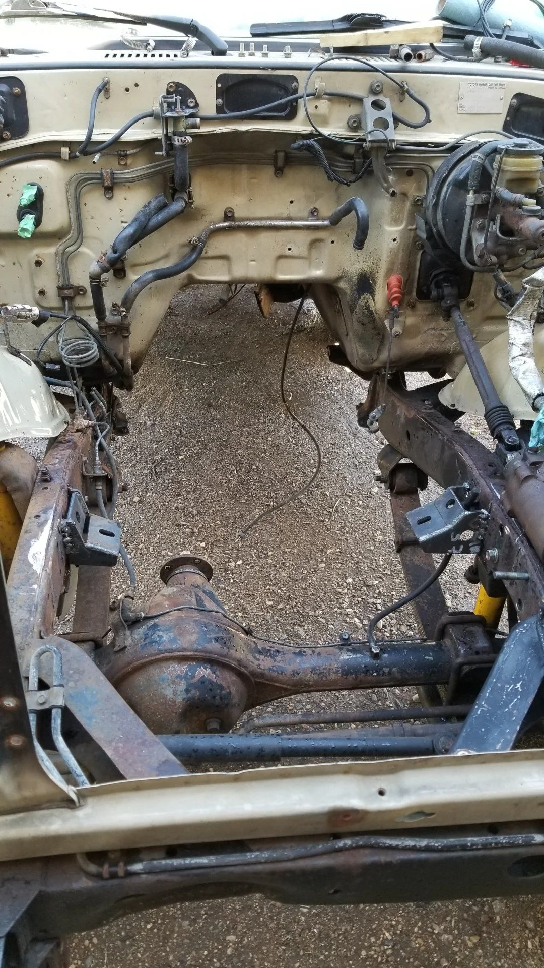

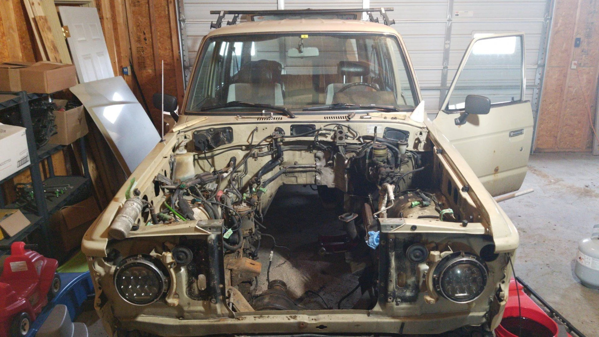

Pulled the 2F, 4spd and tcase out. Started removing all non-essential petrol parts.

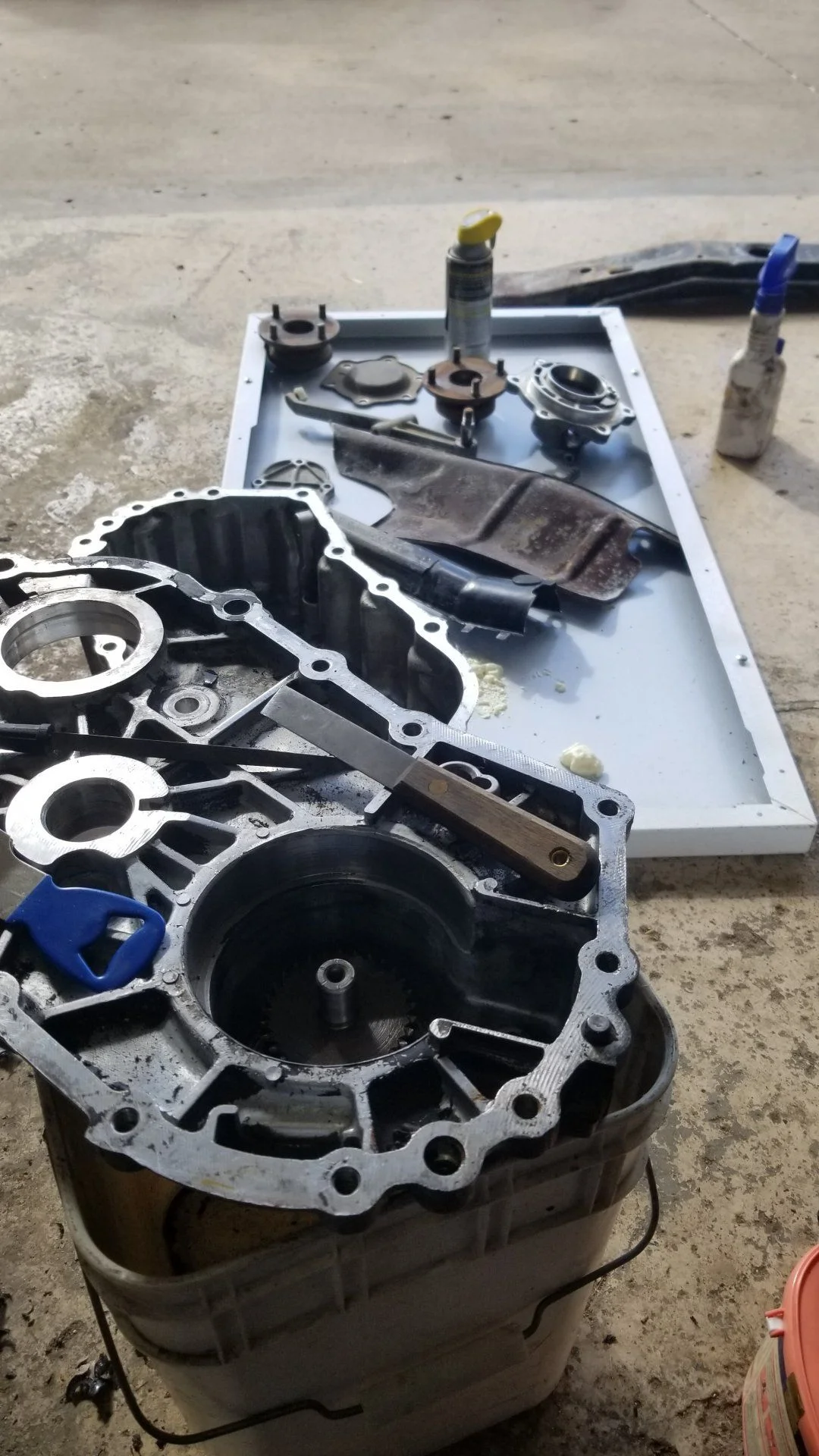

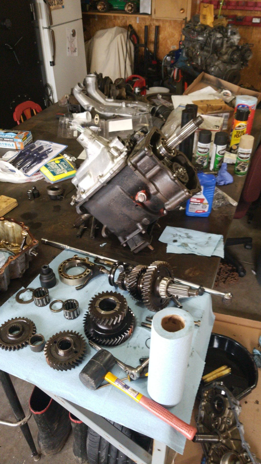

Currently have the tcase about done.

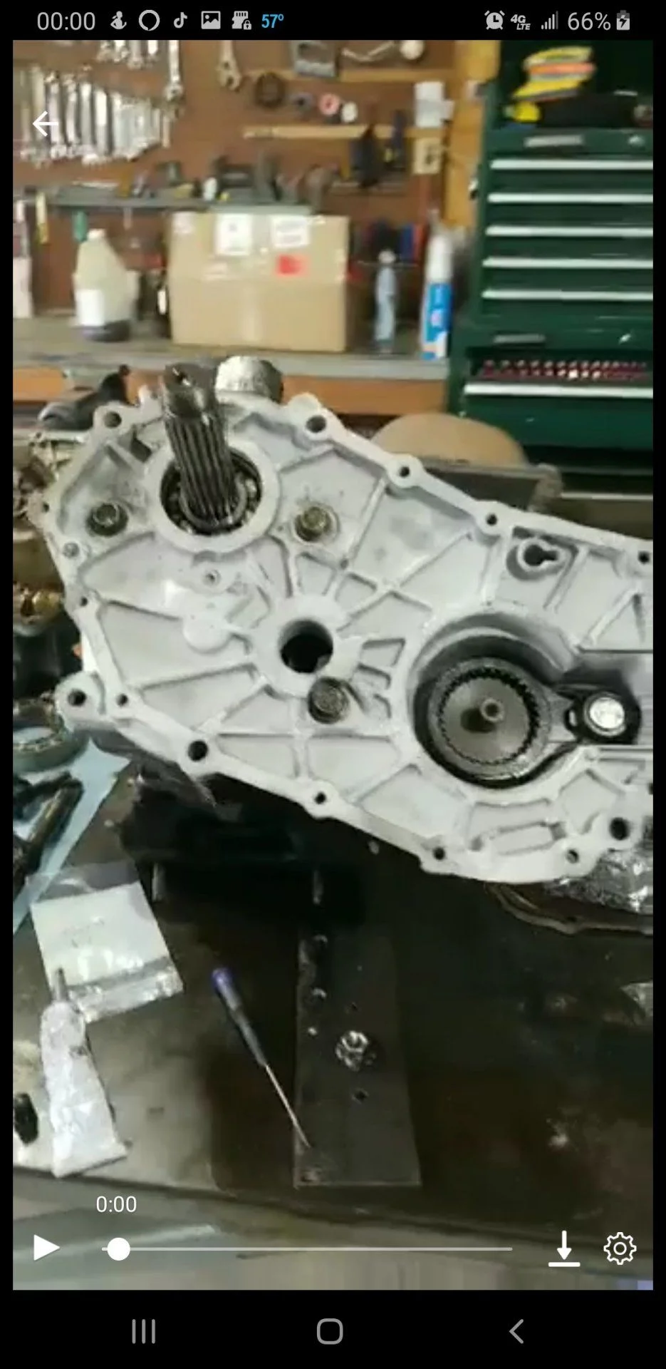

I ended up converting my 4spd tcase to adapt to the H55F . The drive train I got together had the vacuum 4 wheel engage and I decided I'd rather trust a lever in the middle of nowhere.
Hoping to get all the petrol parts out to storage and out of my friends garage.
Tcase mod to plug bolt hole not needed on the 5spd.

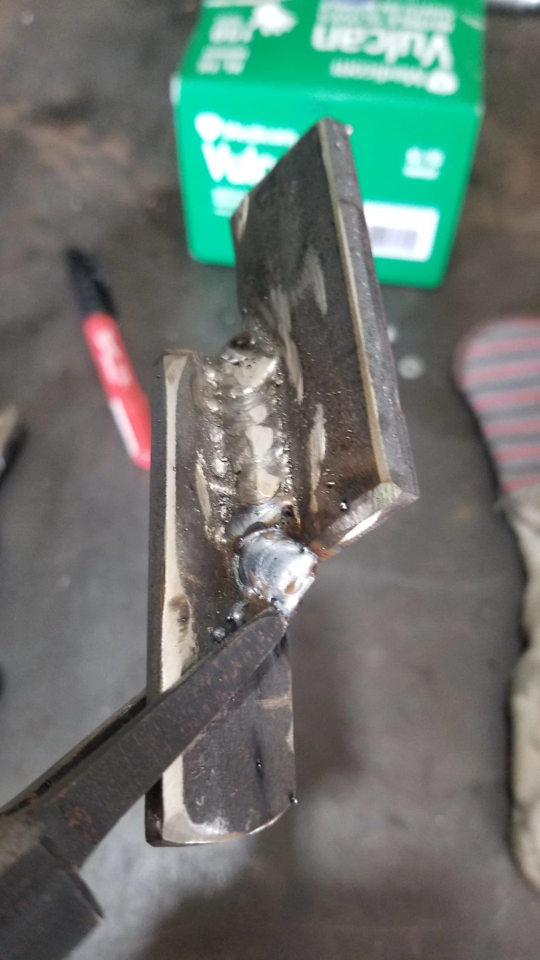

I also had to make lifting points, guess the factory ones were taken by a previous owner of this engine.
Welded some 1/4" steel flat bar pieces together to fit on the front left and rear right lift points of the 12HT. Drilled two holes for the mount and on for a shackle at the point for lifting.

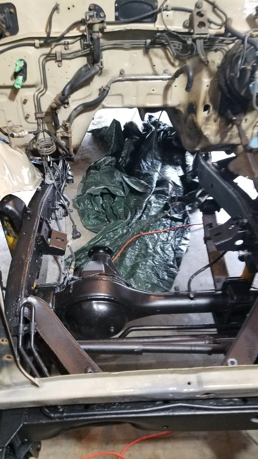

Frame got acid washed with metal ready then POR-15. Top coats are John Deere blitz black implement and frame paint.

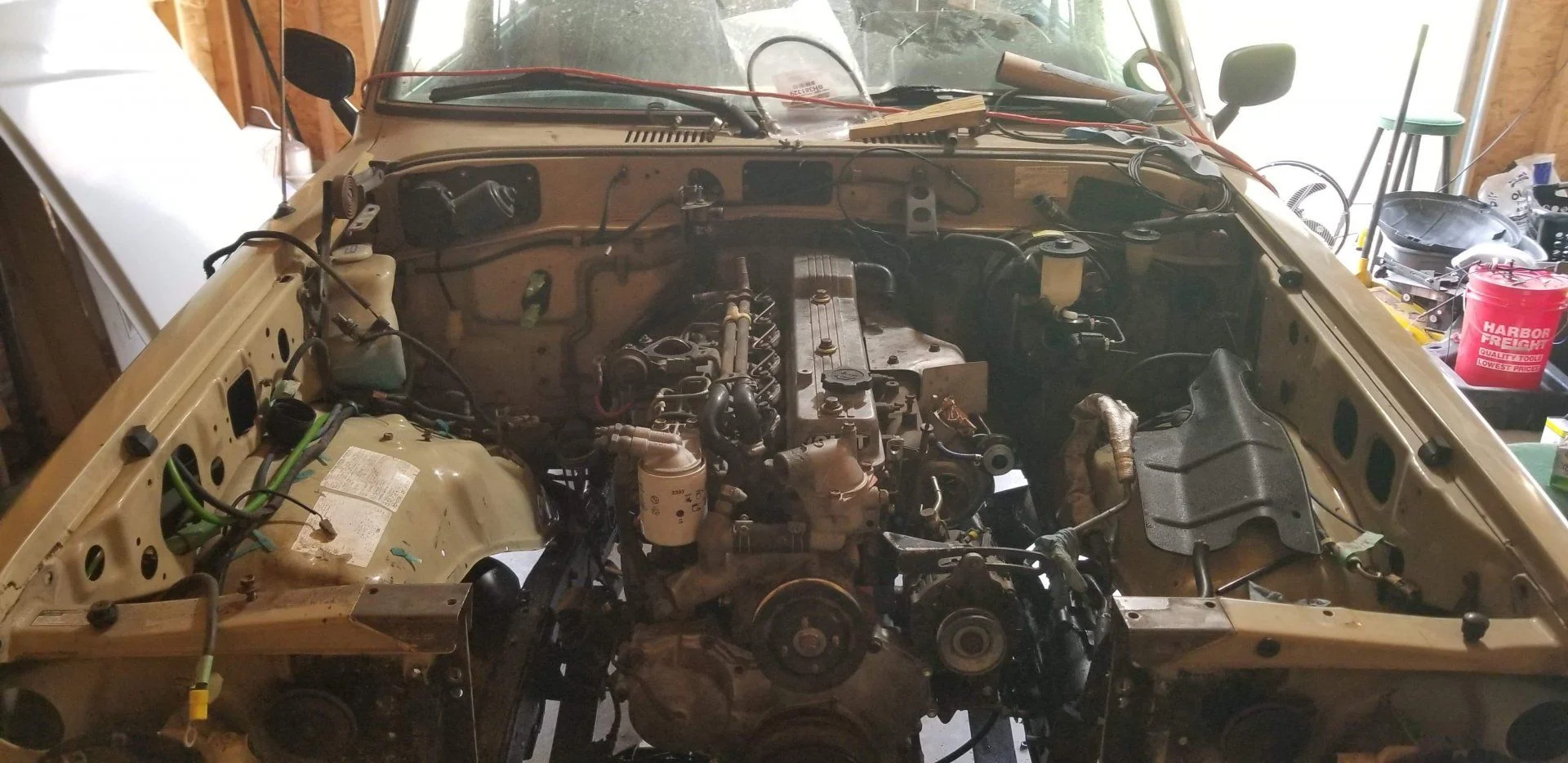

12HT is in!!
Everything lined up and she's home.

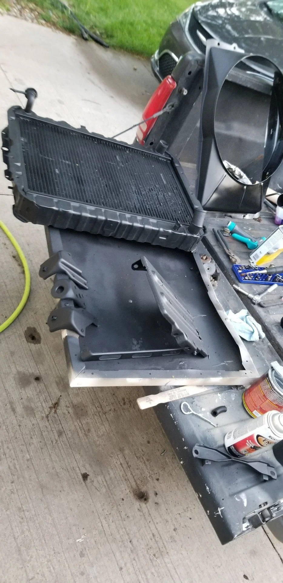

Cleaned up and repainted 12HT radiator, mounts and battery tray. Ordered PS hoses should be done tomorrow.

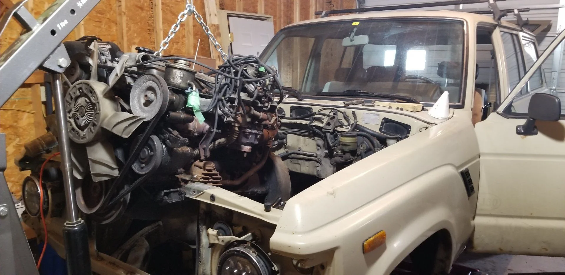

Got the 12HT installed. ( Pic of 2F coming out)
