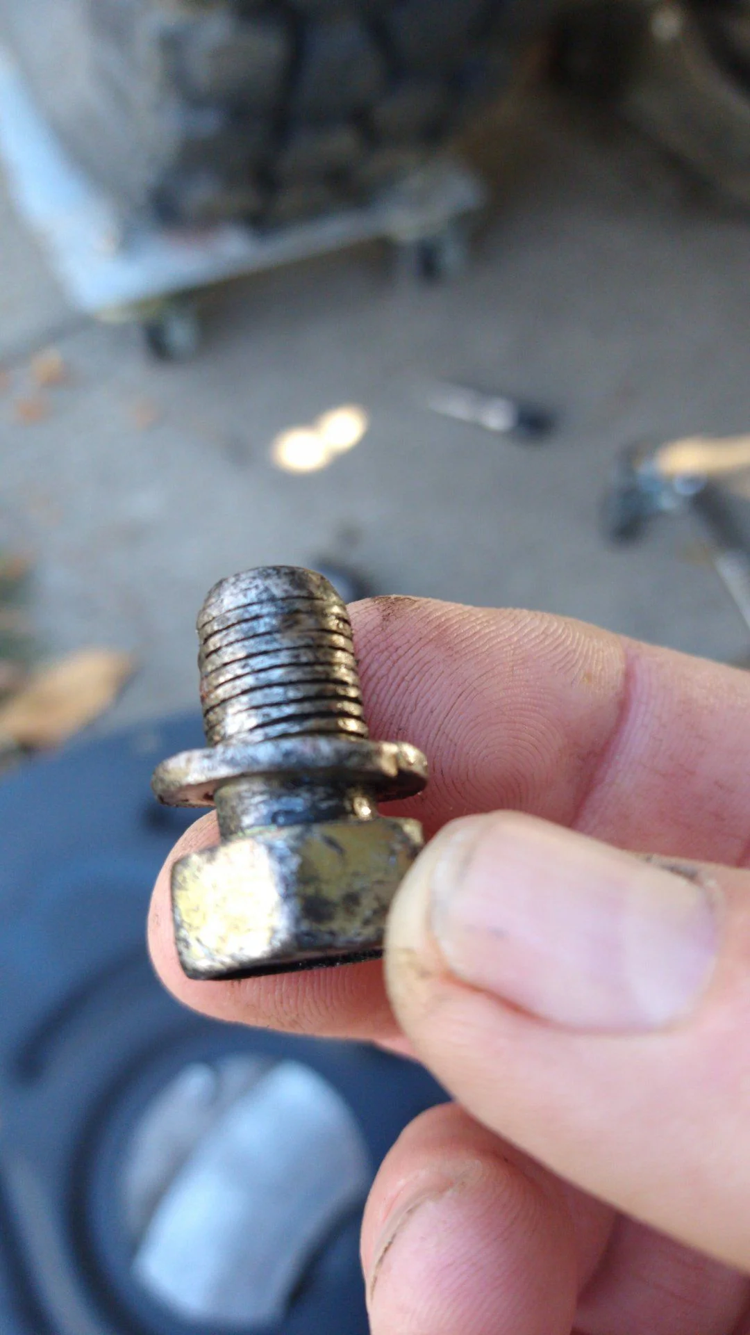

I started loosening bolts on the bell housing and immediately found the issue........
See that bolt that looks longer than the rest in the above picture? That is not supposed to be there. That, my friends is one of the engine back plate retaining bolts that came undone and was bouncing around between the fly wheel and the back plate. It sounded horrible. The moment I saw it, it flashed in my mind, I only used blue locktite on those bolts. :bang:

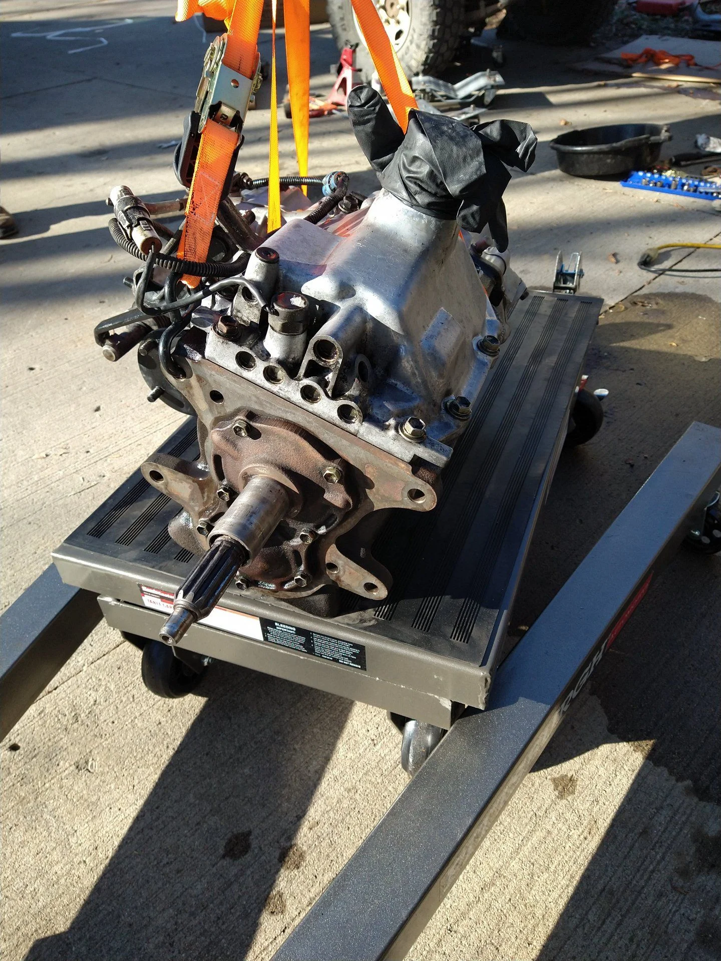

I could not be more let down over a simple thing. I got the trans out on to jack stands then pulled the flywheel and the bolt fell right out.

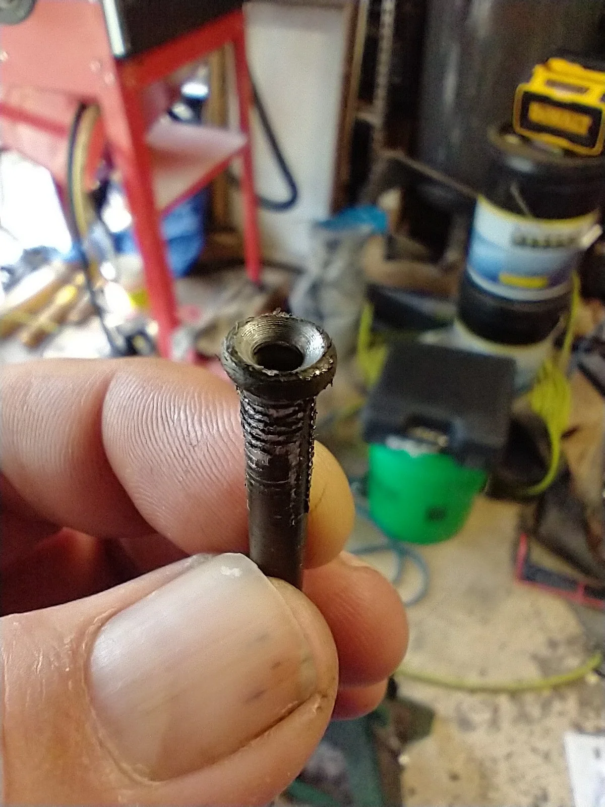

The culprit.
I went a head and removed the remaining bolts from the back plate and reinstalled and torqued them to spec with RED locktite.
I figured while I have the trans out I might as well clean all the oil and nasty off it and from the leaking engine on the trip.

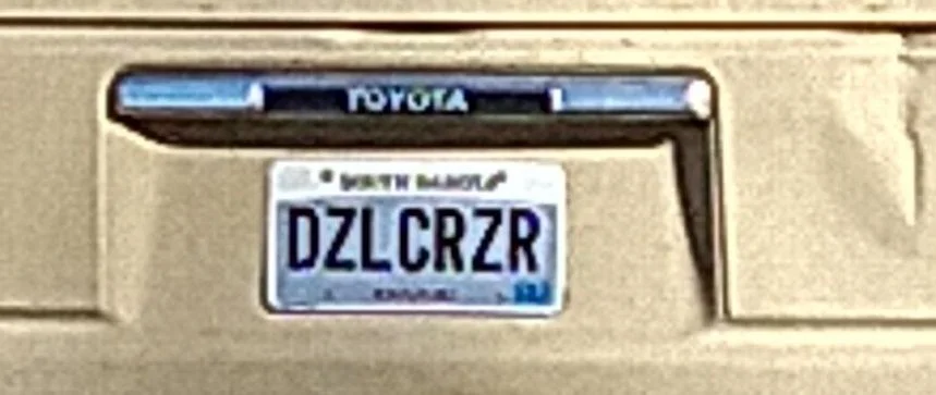

While she was getting finished up I got my custom plate in the mail. :cool:
Side note, first test drive after I got the rig all back together, I was pumping fuel at the diesel section of the gas station, and this lady pulls up next to me and she screams out "I love your plate, Dazzle Cruzer is such a cool name" :confused: I said mam, "its short for Diesel Cruiser" she said, oh ok. and drove off. LOL.

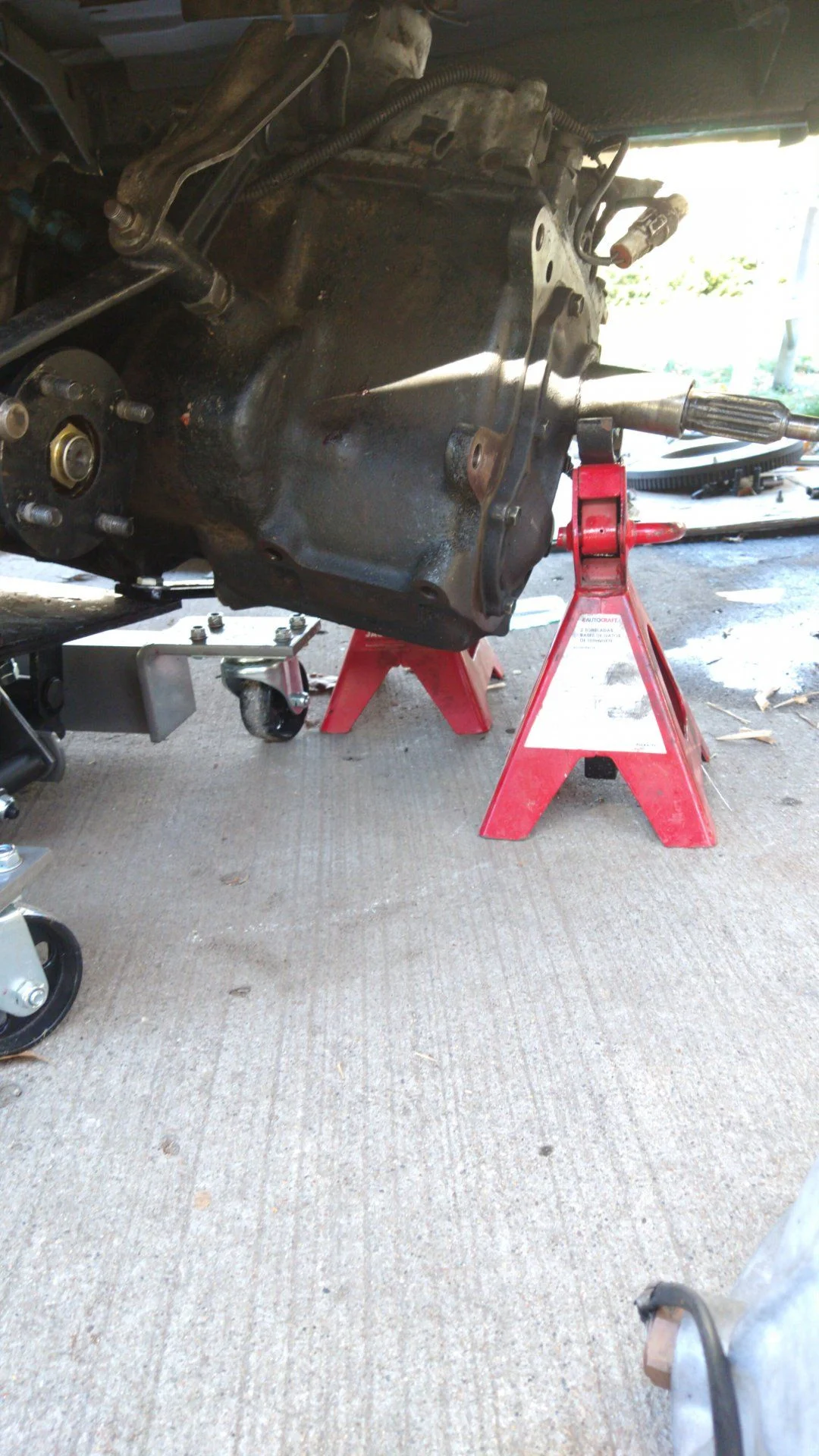

That afternoon I started digging into the truck noises that stopped the trip. My neighbor came by and suggested I get a mechanics stethoscope to investigate further I took that good idea and found it was indeed coming from the tranny.

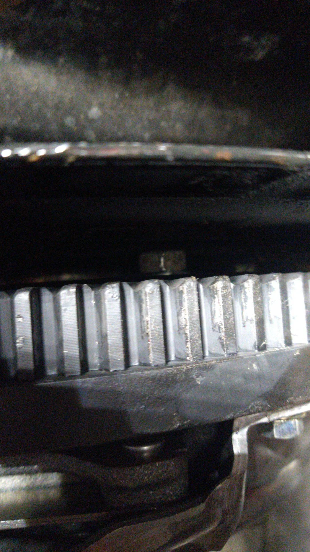

The culprit.

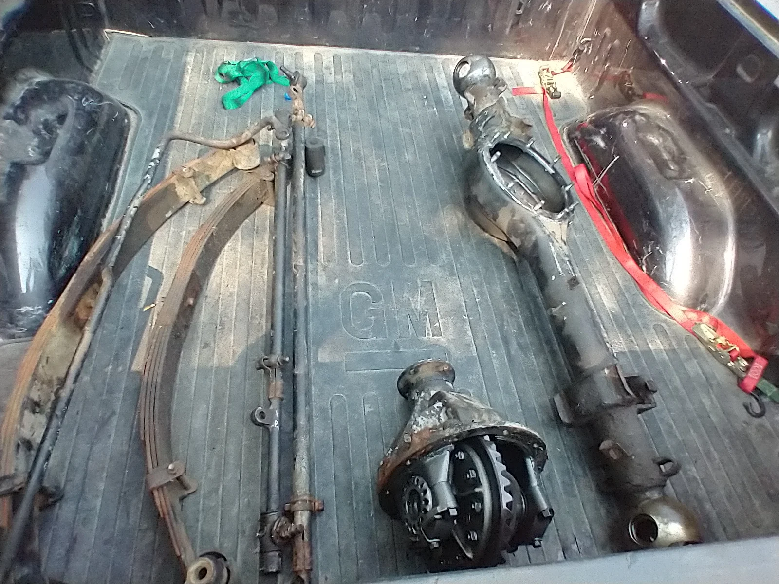

Put the old lass up on jack stands and began removing her worn bits for replacement.
Pulled the whole lot off and sent it to the local machine shop for a hot wash, to get the bits I need back into a reasonable shape.

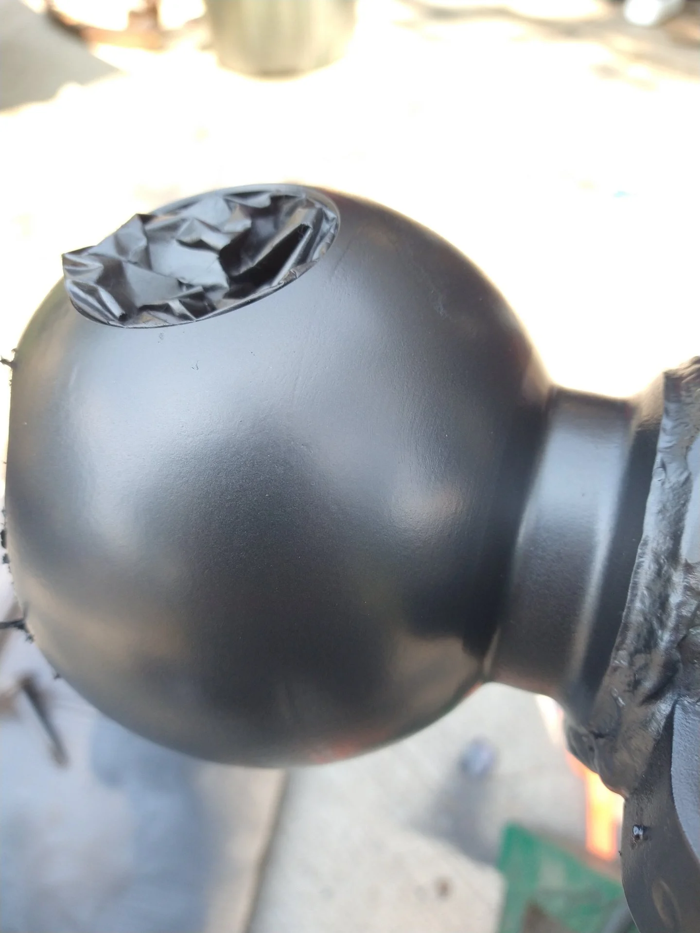

After a proper hot wash and clean up, rust remove and paint. Replace ball joints, paint interconnection bars, Axel housing and all the bits with Steel-it. pretty slick stuff.
Steel-it, applied a few coats thick on some of the bits and bobs on the front axel:
