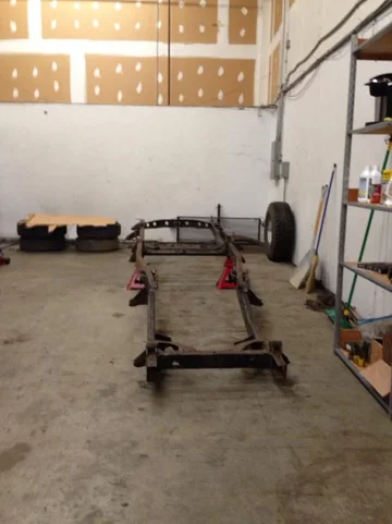

I noticed you used something to slow the rust inside the frame rails. What was it? I am getting ready to POR 15 my new frame and am not sure what the best method to slow inside rail rust is. Looks great. I hope mine goes this well and smooth.
We used the internal frame coating from Eastwood:
http://www.eastwood.com/internal-frame-coating-w-spray-nozzle-qt.html
We bought 3 bottles but only used one because it's a really thin liquid, so it spreads pretty far. I would say do the internal coating first becuase it's super messy, and it actually started to eat away paint on our suspension and leaf springs. It has a tube that you put inside the frame and it sprays all sides, but that also means it sprays out of all the holes. I'm not sure what type of chemical it is but be very careful not to let it spray on everything! Once it dried it seemed like it was on there for good, so a coating of POR 15 afterwards should be perfect.
