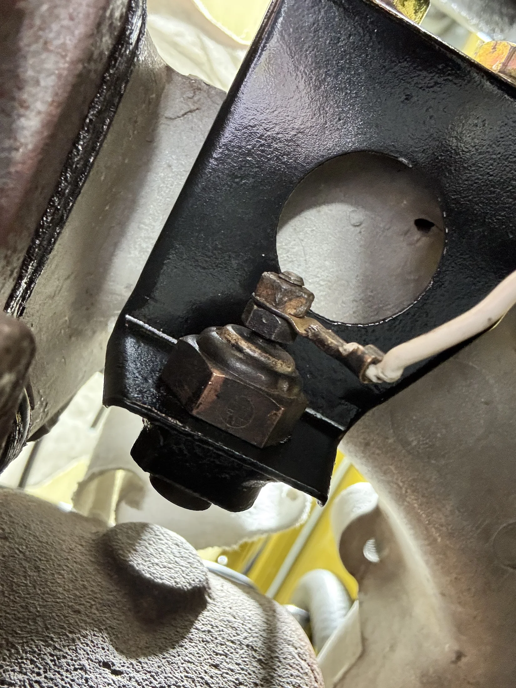

Ok… back on my temp gauge. I noticed it wasn’t working so I grounded it at the sensor and the gauge moved to hot. I replaced the sensor with a new factory one but I’m still not getting and movement on the gauge during operation.

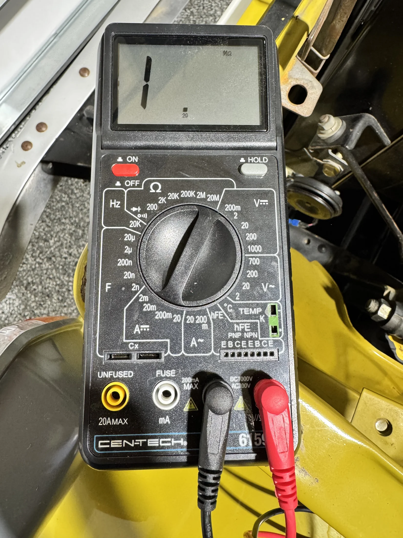

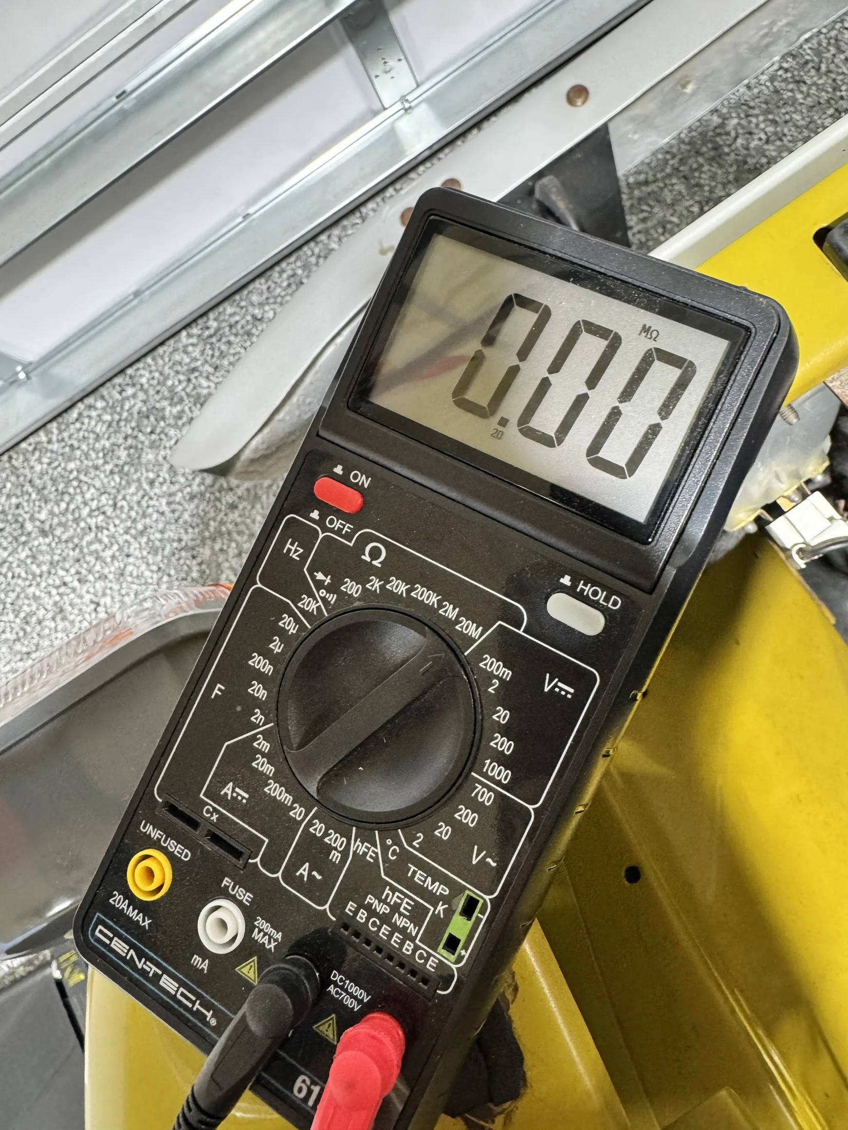

Check the sensor is not insulated with thread sealant - teflon tape is bad. Use a multimeter and check resistance from thread on sensor to engine head. The early pre 72 sensors won't work with your gauge - they're 12volt, yours works off 5. Or power a test light from your battery and see if it lights when you earth it to the sensor body.
Ok… with key on and black touching threads and red touching thermostat housing or the engine block I get 0.00

Looks like your earth is ok. That low light flashing is the 5 volt regulator doing its thing - your temp gauge is powered by a 5 volt regulator built into your fuel gauge. My guess would still be its the temp sender - new position may sort it, but would check why original did not work. Is water gallery full of gunk?

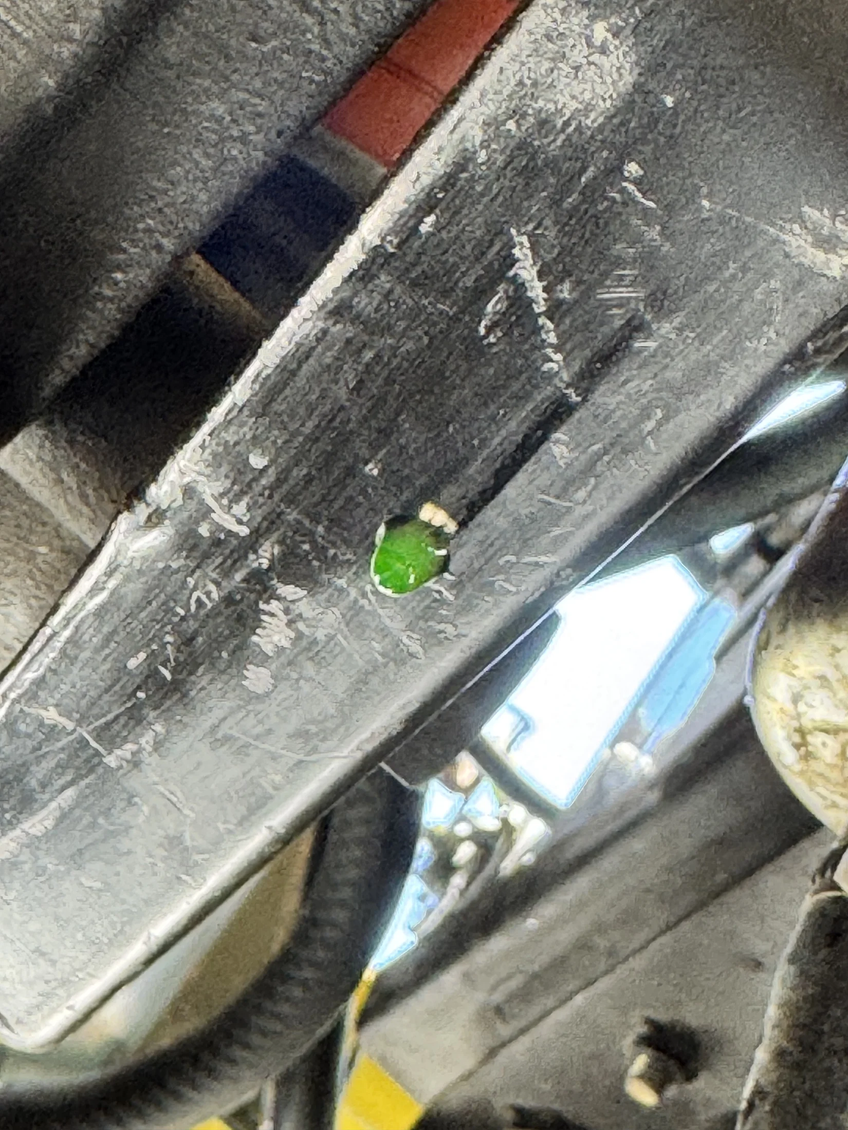

No I flushed it pretty good prior and it was amazingly clean. When I pulled the plug to put in the current sensor it was green and clean …. Not gunk or residue floating

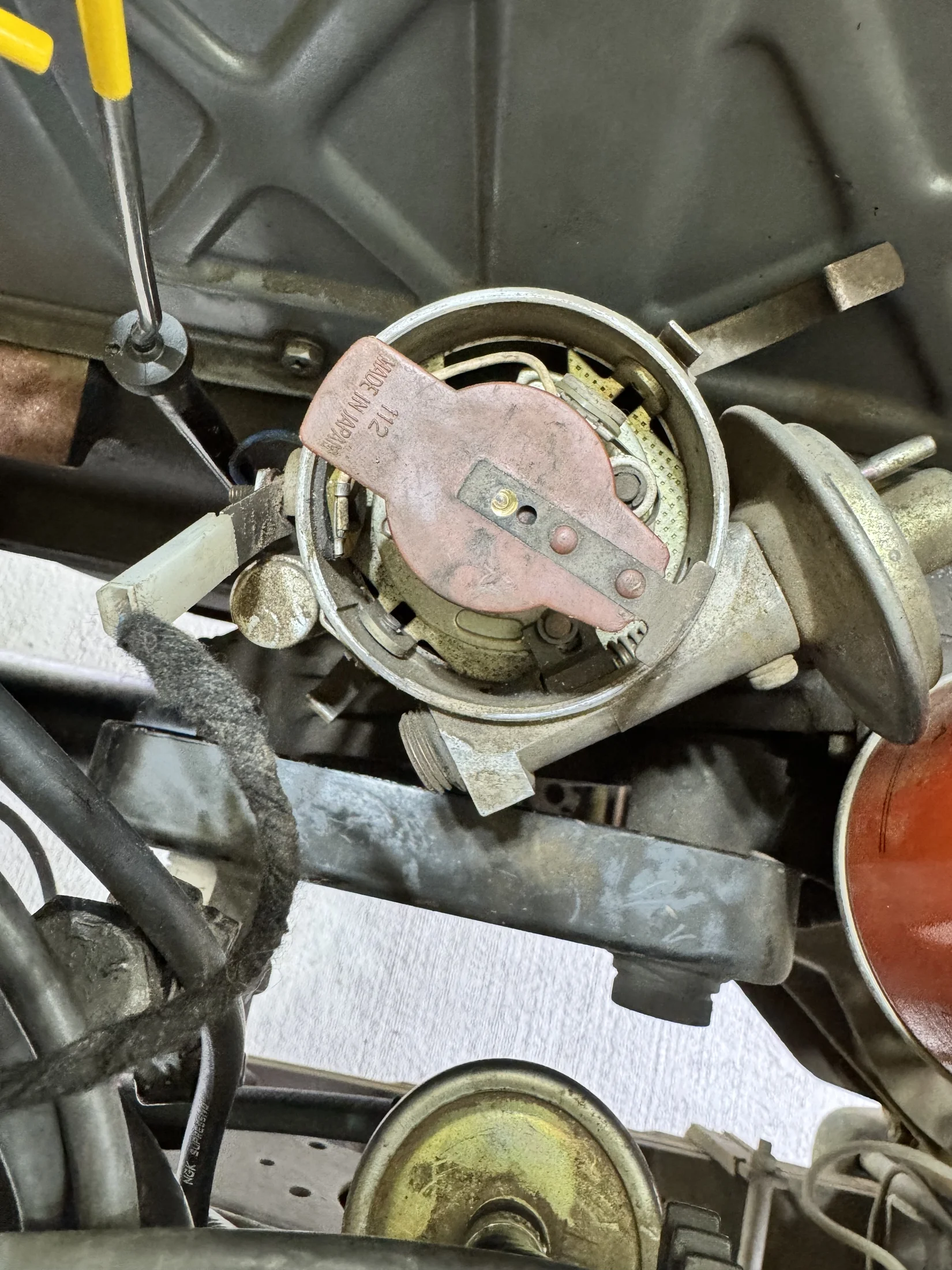

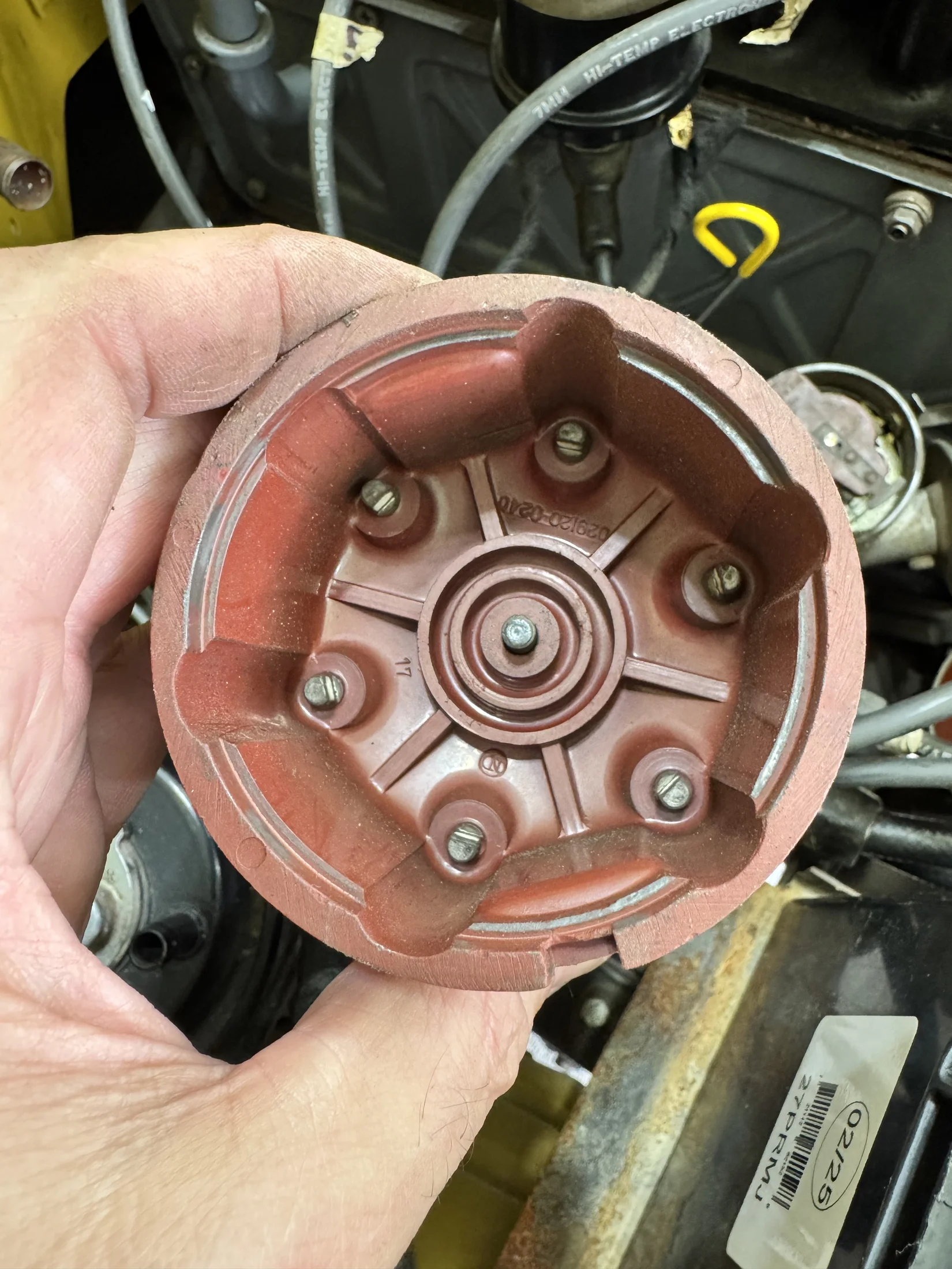

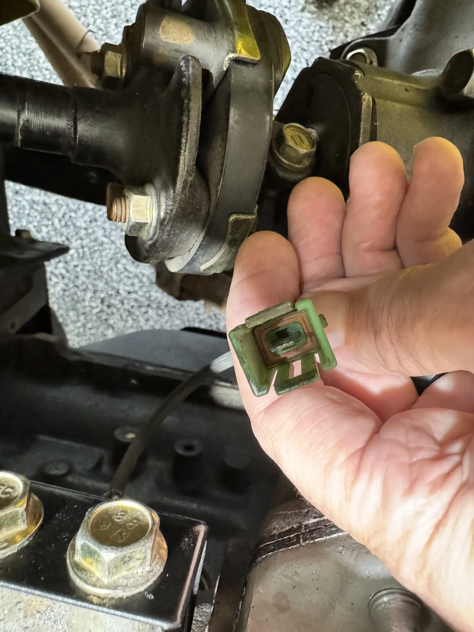

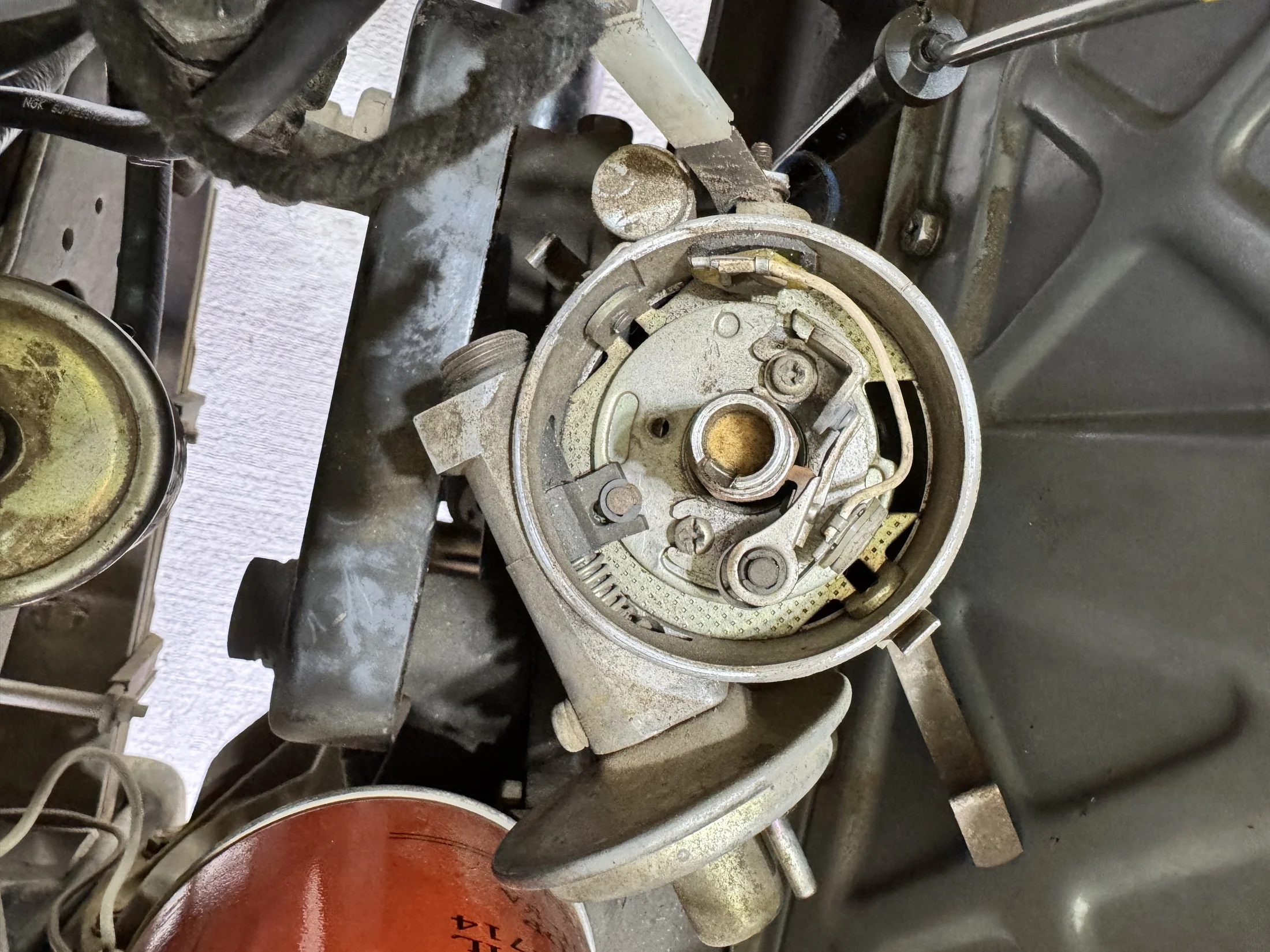

Pics of your dizzy, inside and outside, please.

I found my fabricated throttle linkage isn’t quite doing its job and I’ve got reservations on the whole distributor setup as it’s not the original 1980 model. Working on replacements for both. Here are current dizzy pics

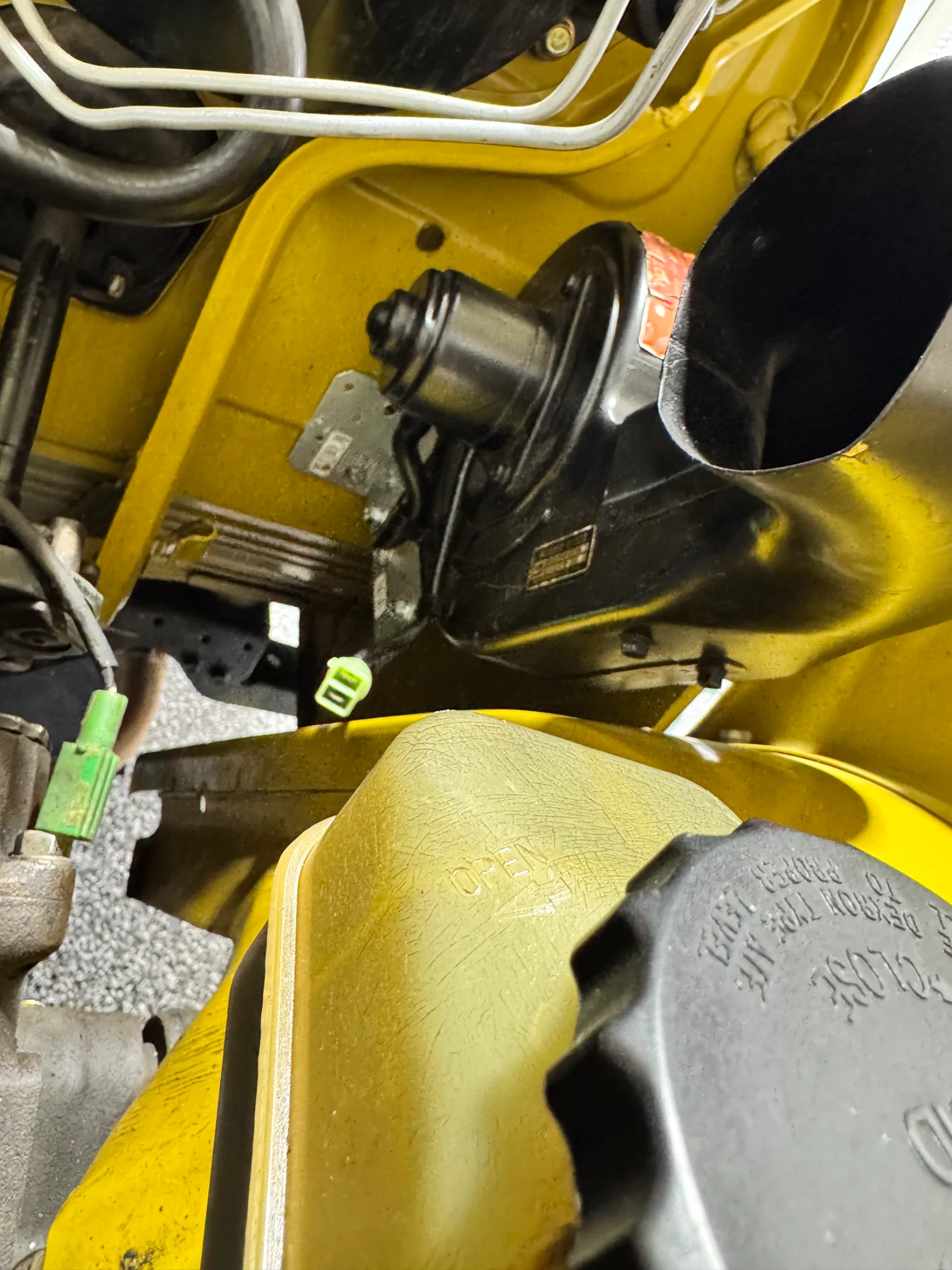

While waiting on replacements for the above parts… gonna start on the install of the carb cooling fan setup.

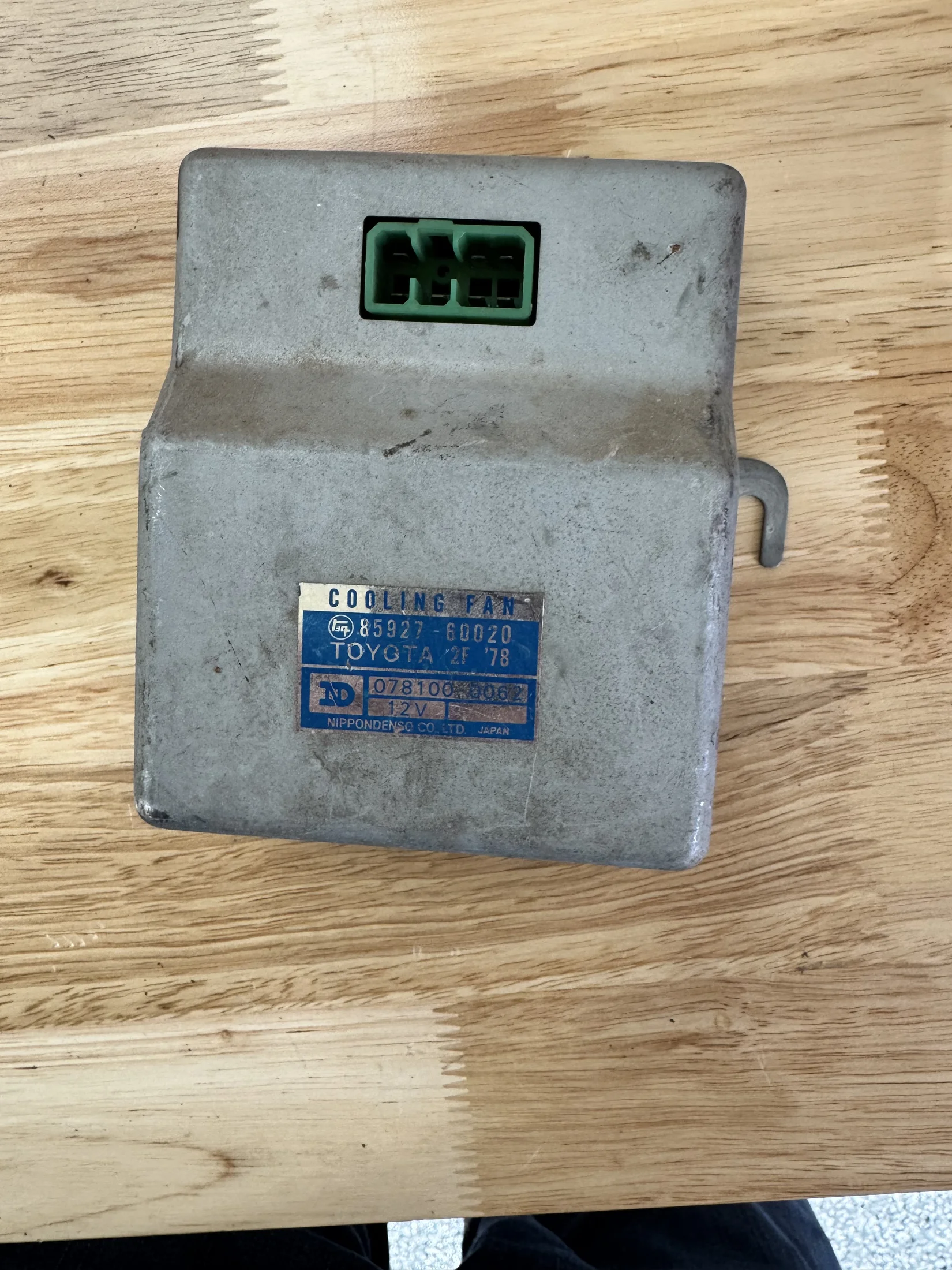

Now the PO removed it and it wasn’t wired in the current wiring harness so it looks like I’ll have to add all the needed wiring.
1. I have a carb fan that checking out with 12v power.
2. The computer relay checks out to be good and operational
Not 100% sure if the sensor is still good, betting it is, but will see once setup is properly installed. If not will replace with a compatible one.

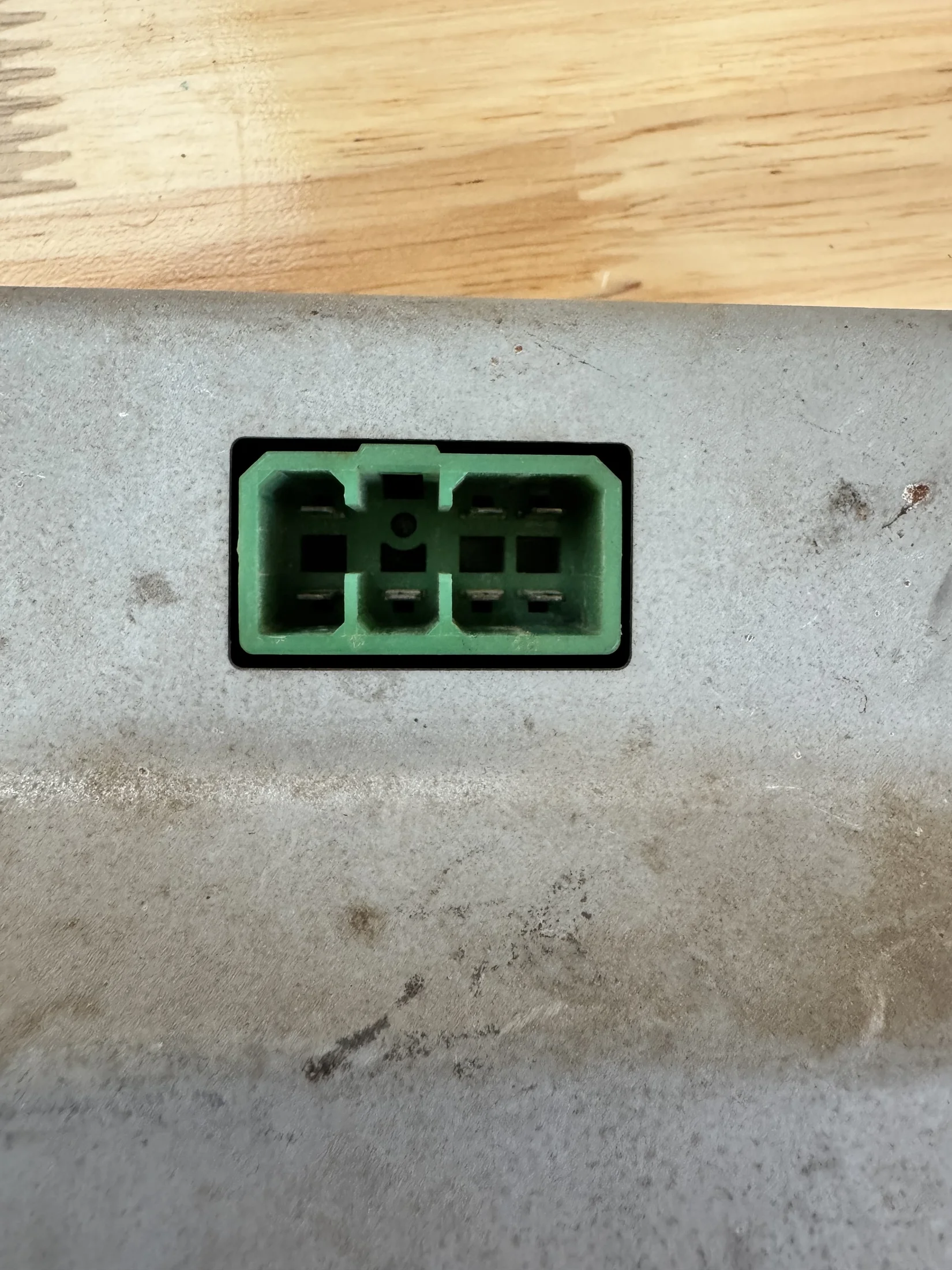

Now I just need some help to build the proper wiring / connectors for each component and the proper way to wire each of them together .
I think I need 12v constant and 12v ignition wire and a 5 amp fuse in there as well to protect the computer.
Any other help or corrected info will help greatly appreciated.

1. Got the Carb Fan properly hooked up and it runs properly when the ignition cuts off. I grounded the sensor and It runs for 23 minutes. Have to test the sensor once I get her fired back up . Thanks to @Engineer8000 for all the help on this.

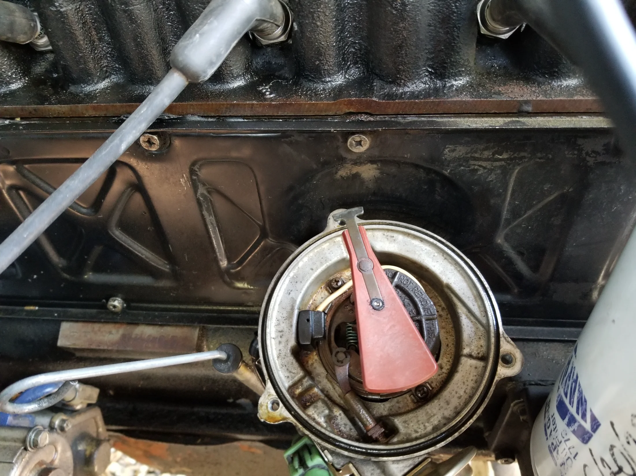

Thanks to @cruisermatt for the throttle linkage and FJ60 Large Dizzy, Coil Setup, and Dented Cover
Hopefully I got the dizzy in correctly and will try and get her timed and the mixture set this week. Ran out of time today !!!
