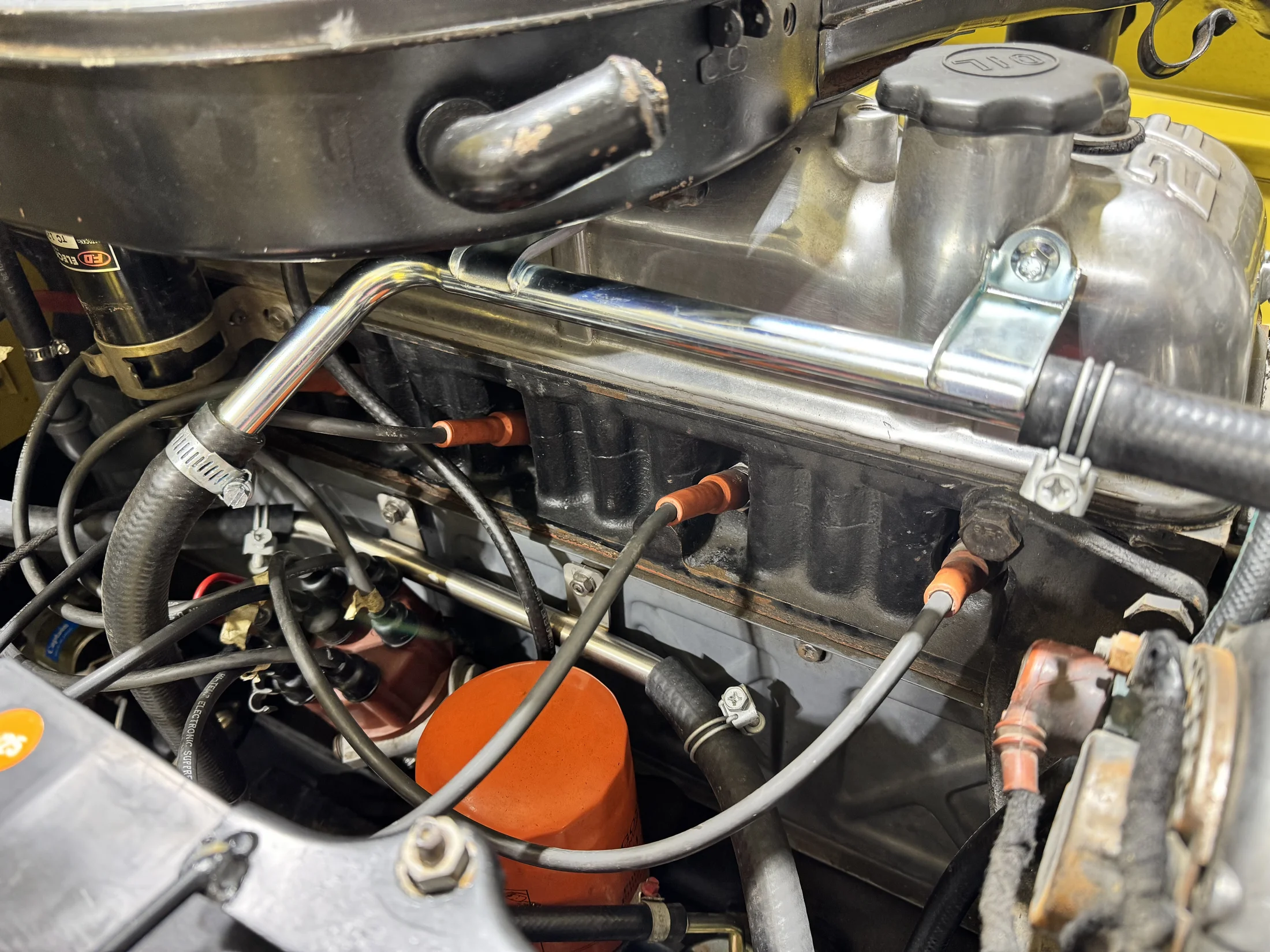

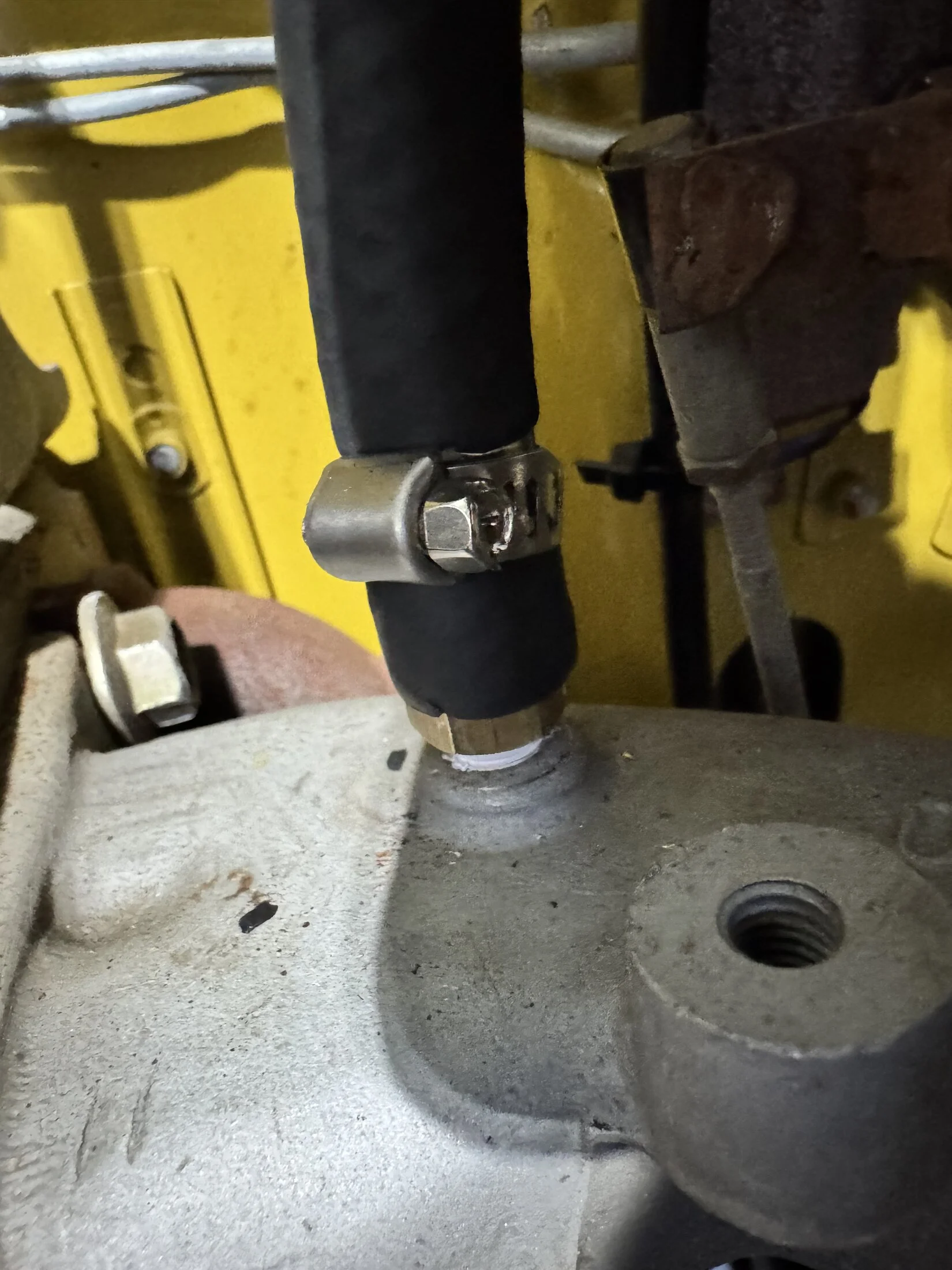

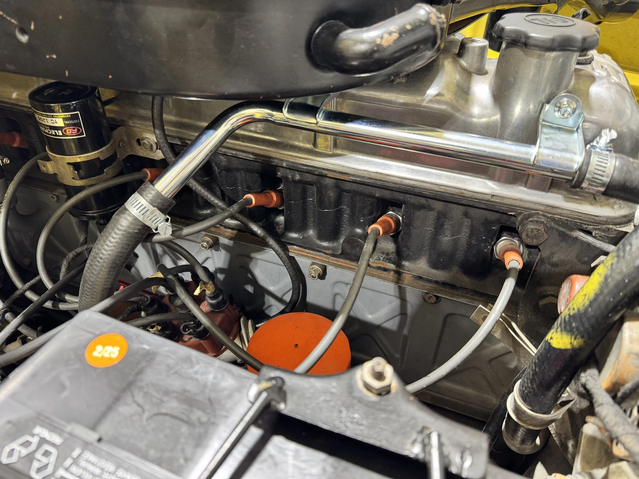

Ok… got to work on her this past week. I ended up chasing all the threads in the head and clean the bolt threads really good prior to gasket install. I started with 23ftlbs, then went to 24 ftlbs , and finished with 25 ftlbs. I went against advice and installed the City Racer carb my buddy used and got everything tightened down and vacuum lines properly run….along with the choke cable as well.
Added a little choke and after a few turn to get the gas flowing she started right up!!! After a brief warm up and running my hands along the exhaust manifold I didn’t feel nor detected any leaks.
I then installed the vacuum gauge and tweaked the mixture and idle. Ended up at 700 rpms with 19-20 psi of vacuum.
I was getting some smelly smoke from around the exhaust manifold but I couldn’t feel any leaks and it was hard to see where it was coming from exactly. Wonder if it was from the new gasket ???
I took her for a ride… drives and runs great and idles perfect. Best yet….zero dying issues under braking !!! When I got back and shut her down, it still had some smoke from around the exhaust manifold area when I turned it off but it was much less the earlier. I recheck the torque on exhaust / intake manifold bolts and all was fine at 25 ftlbs.

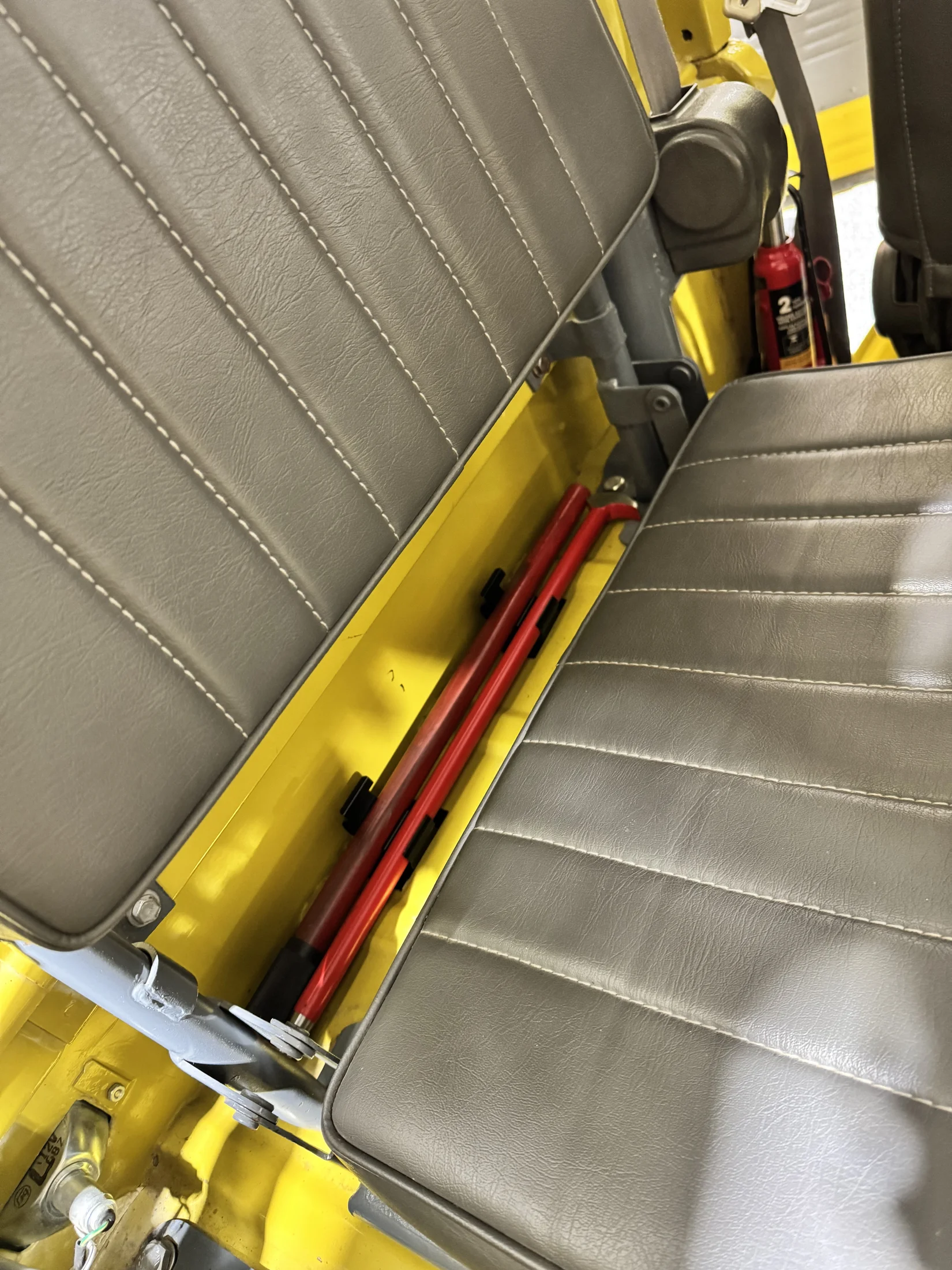

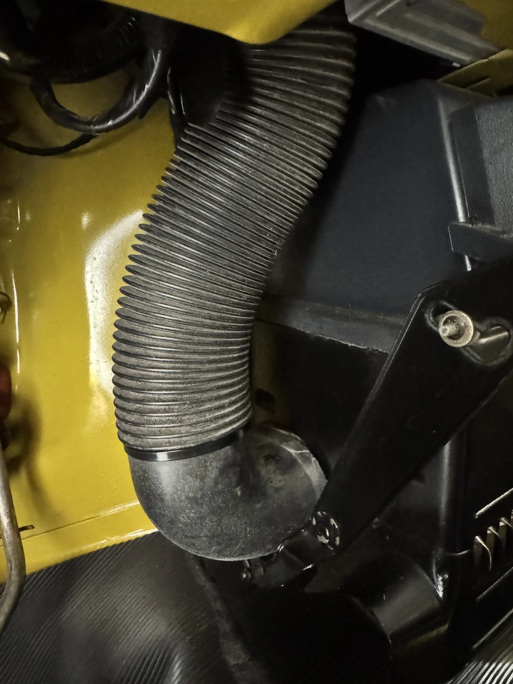

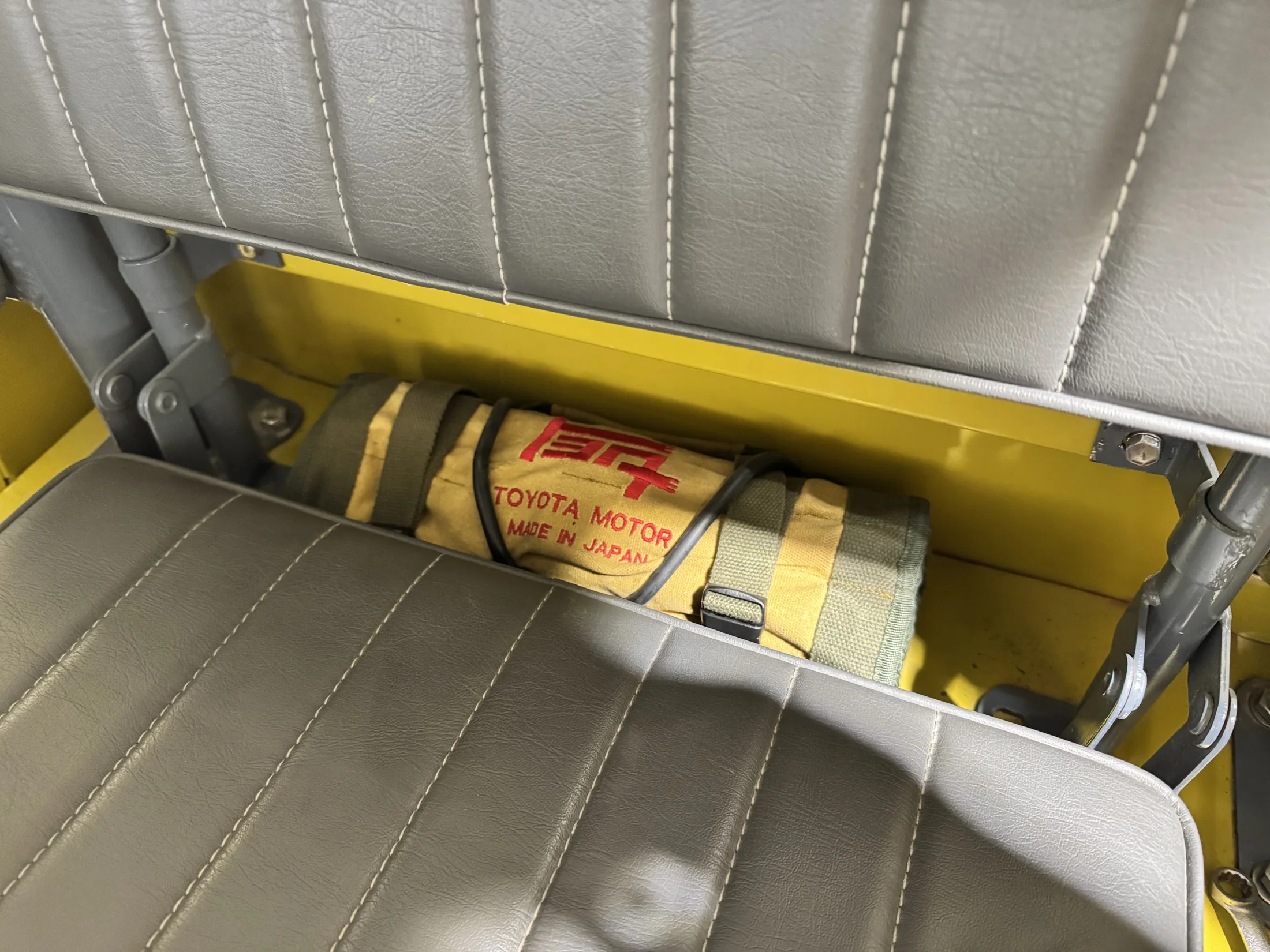

Did some more tidying up today. I fixed my fresh air cable and got it attached to the door properly. Found 2 bolts missing from the bottom of the blower motor and replaced them. I made a tool bag and mounted it … also going to install a set of mounts for the jack / tool as well.

So does the distributor looked to be installed correctly ? The button seems to be pointing at #4 spark plug at TDC
that's about where it(the rotor) should be--

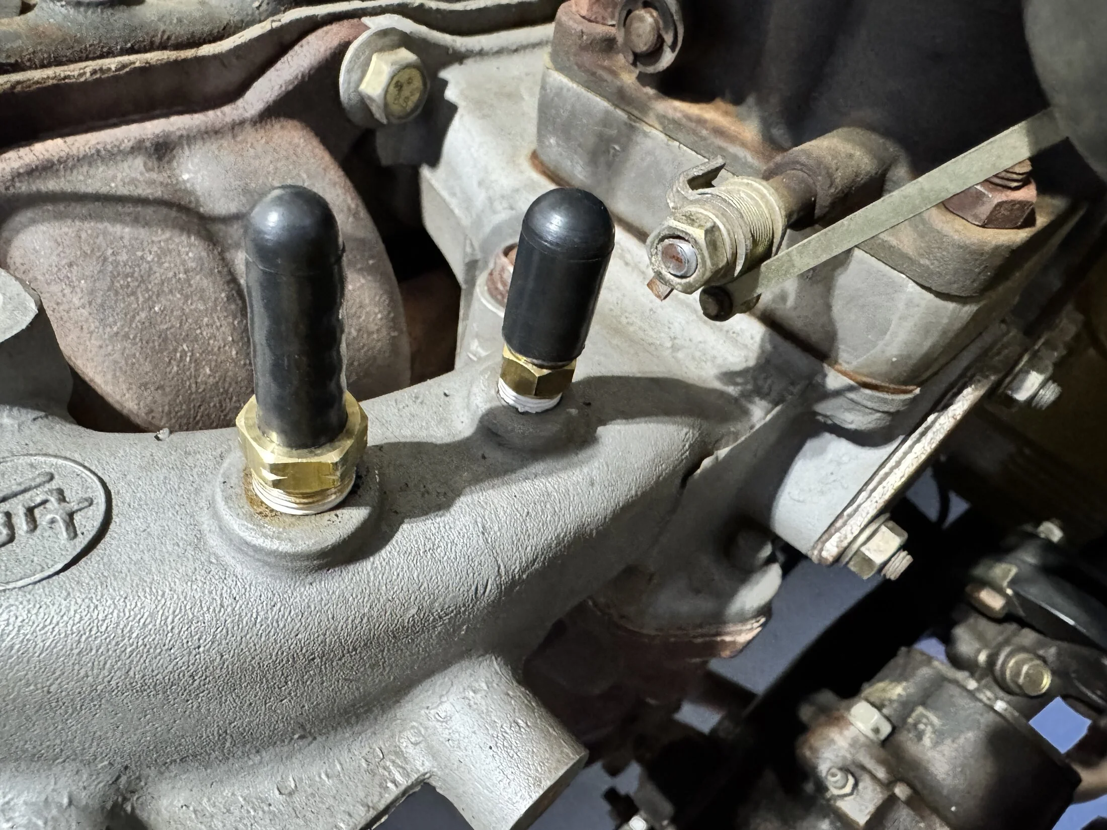

One a side note… I cleaned up the intake vaccum ports and did locate an exhaust leak by the #4 cylinder. Gaskets on order!!!

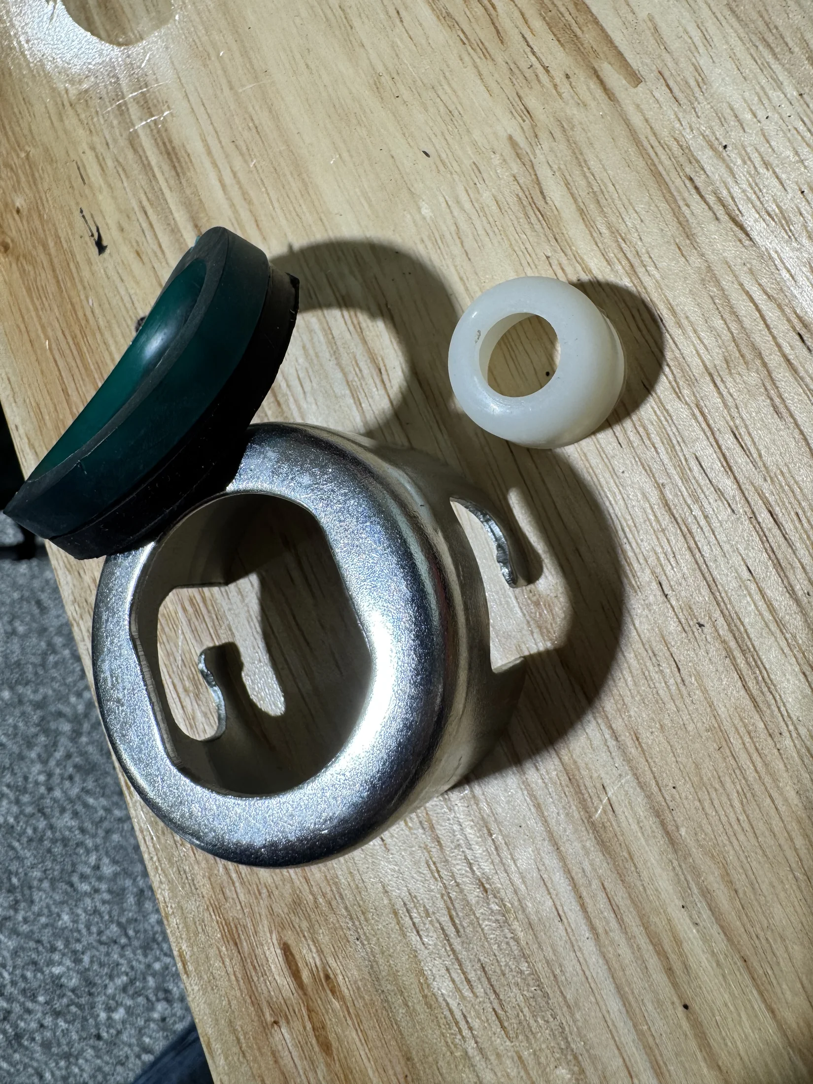

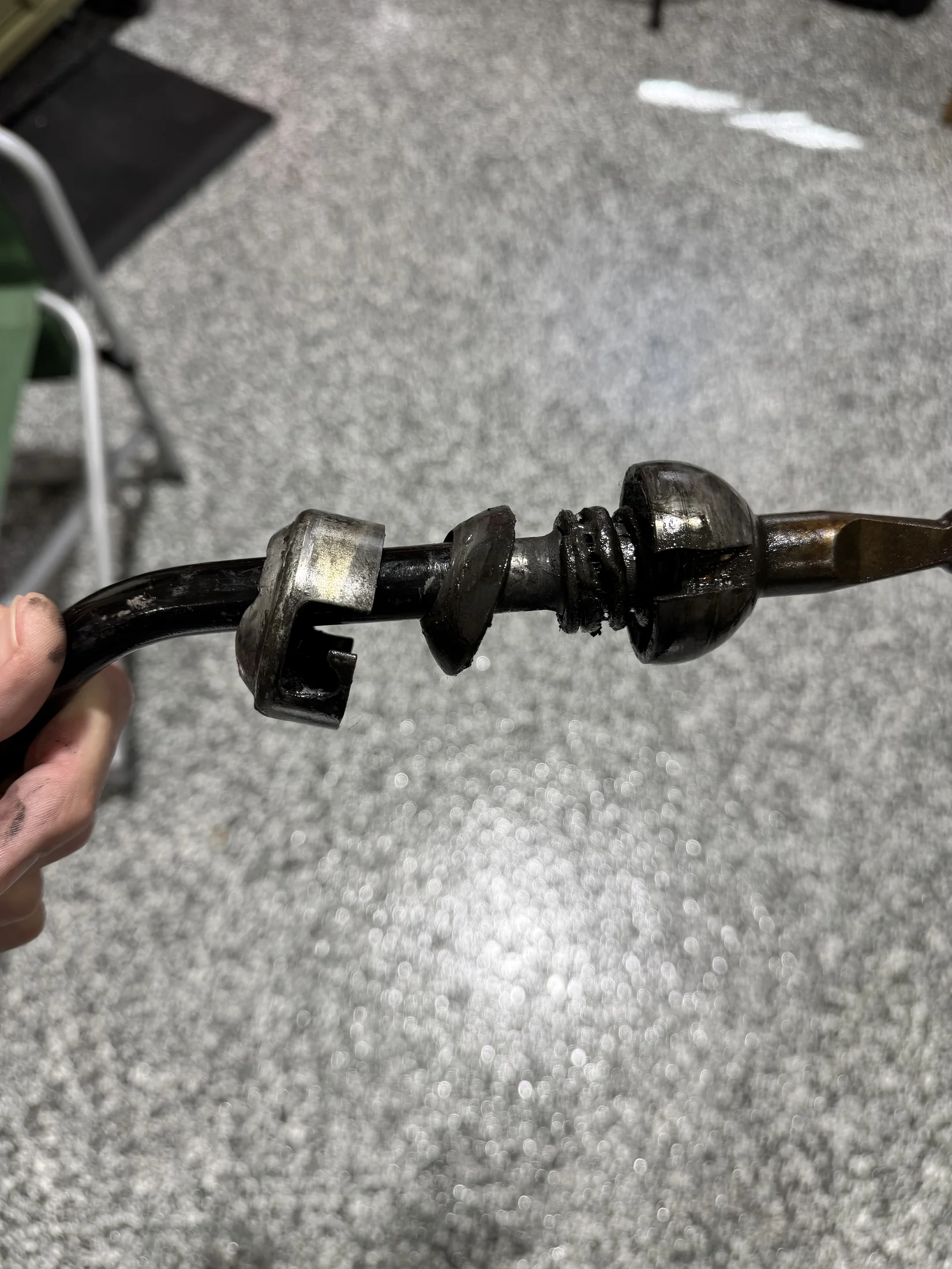

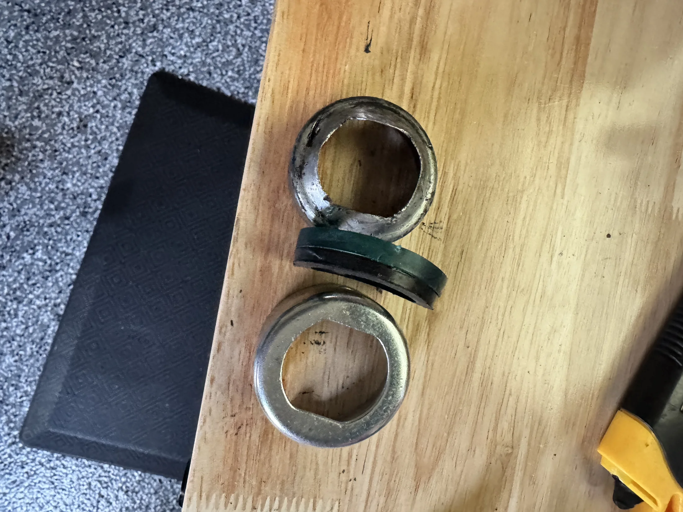

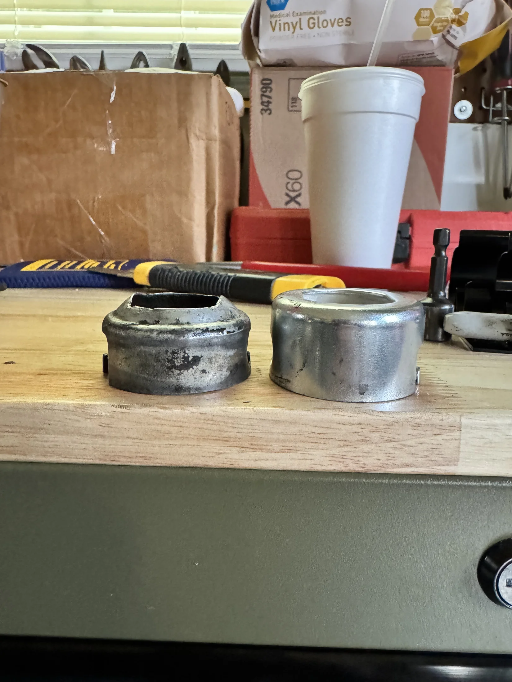

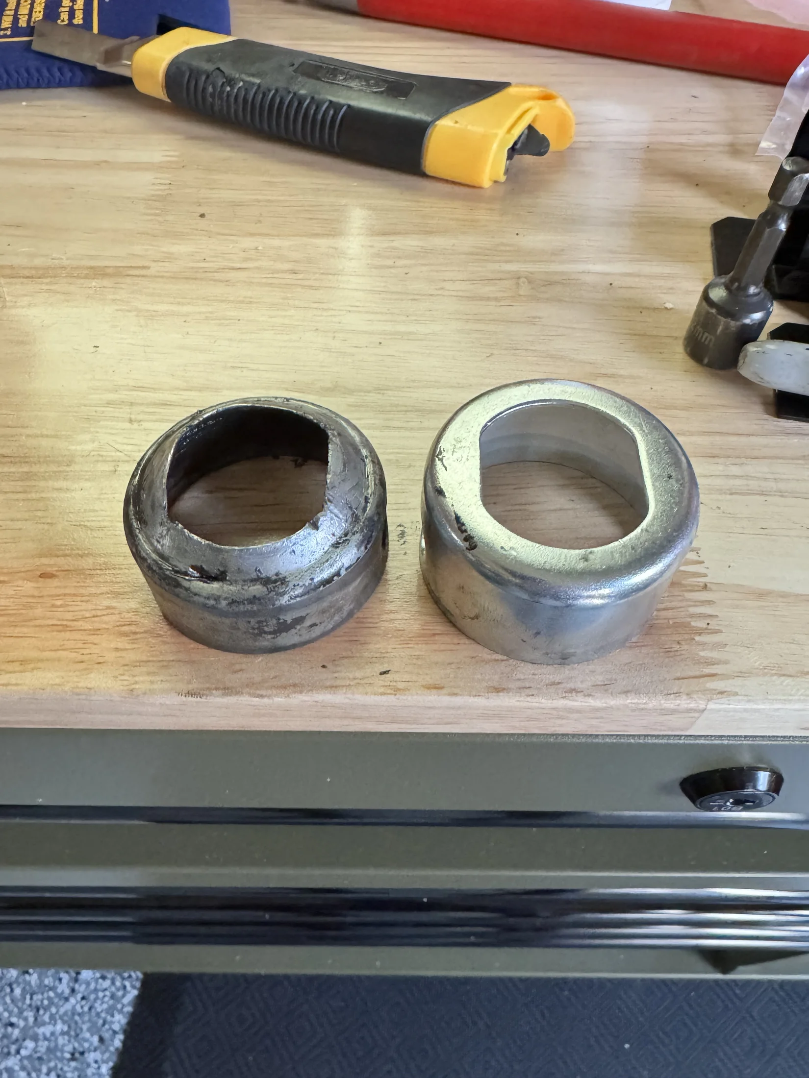

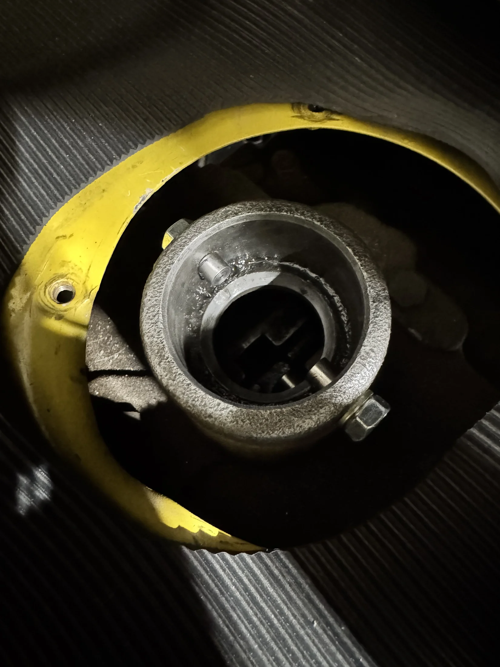

Got my shifter off and have new parts to install ( seems like some may not apply) but I noticed that I might be missing the cylinder shaped sim on the left side down inside or is that gap normal ?
What’s the best grease to use for re-install.
This is the aftermarket part that came with 2 rubber spacers. Not sure it’s correct though

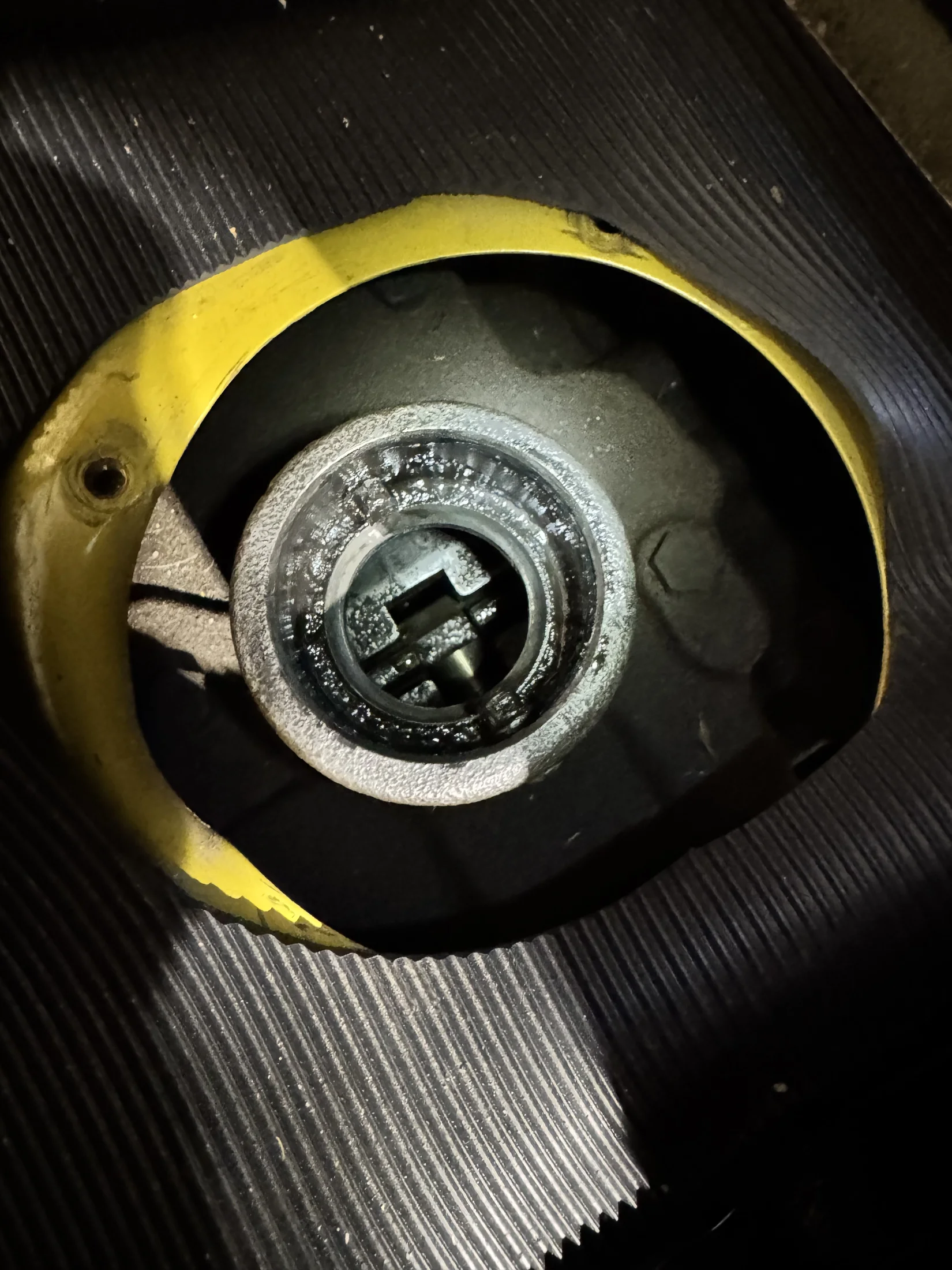

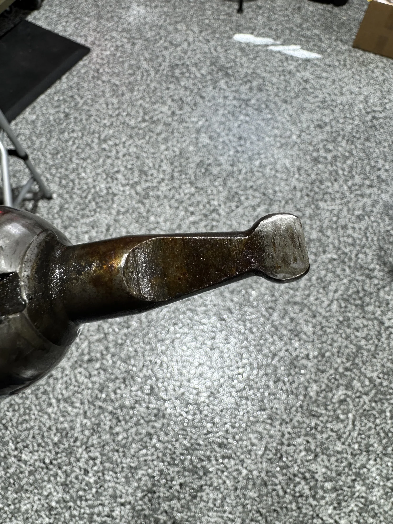

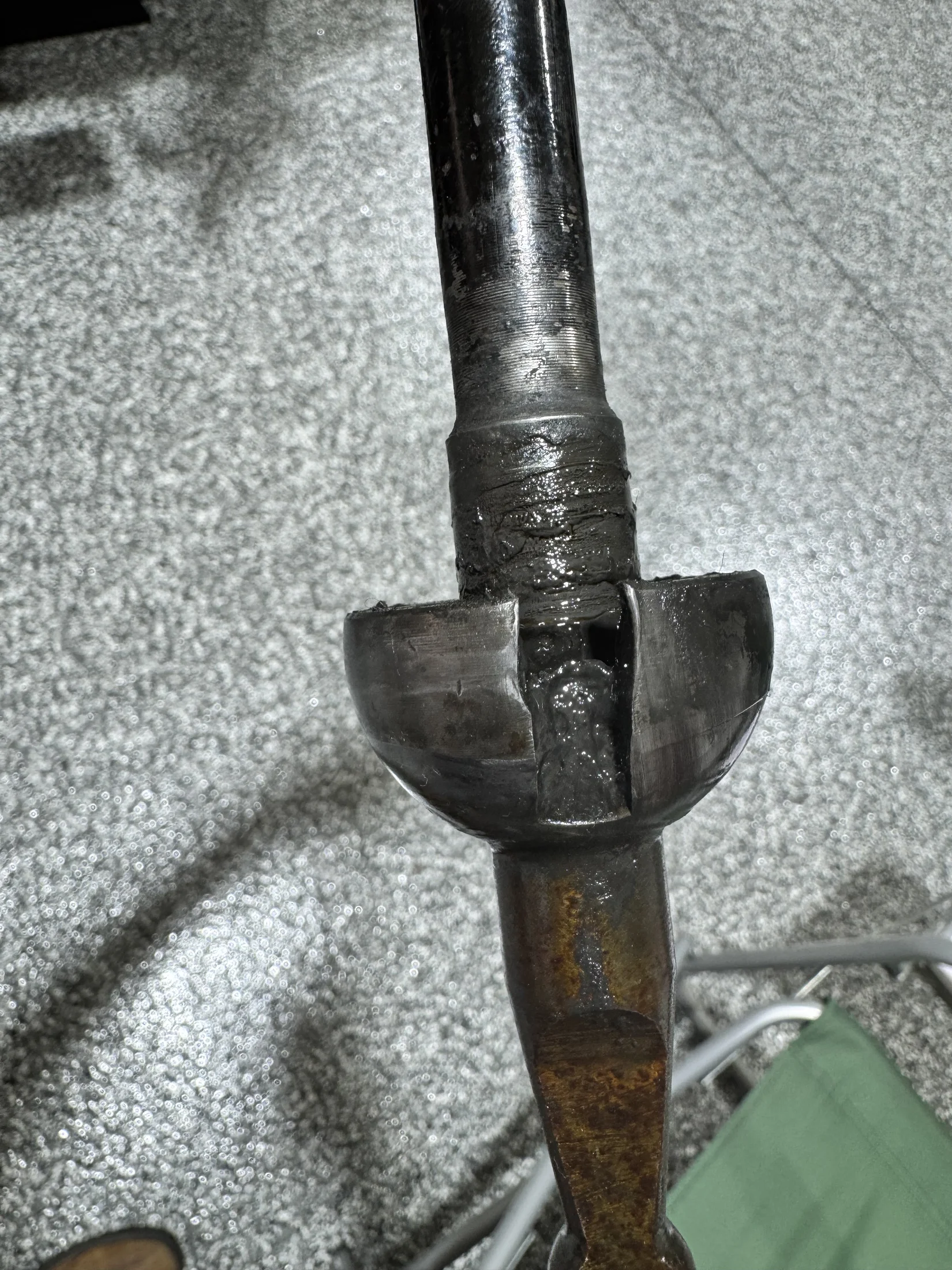

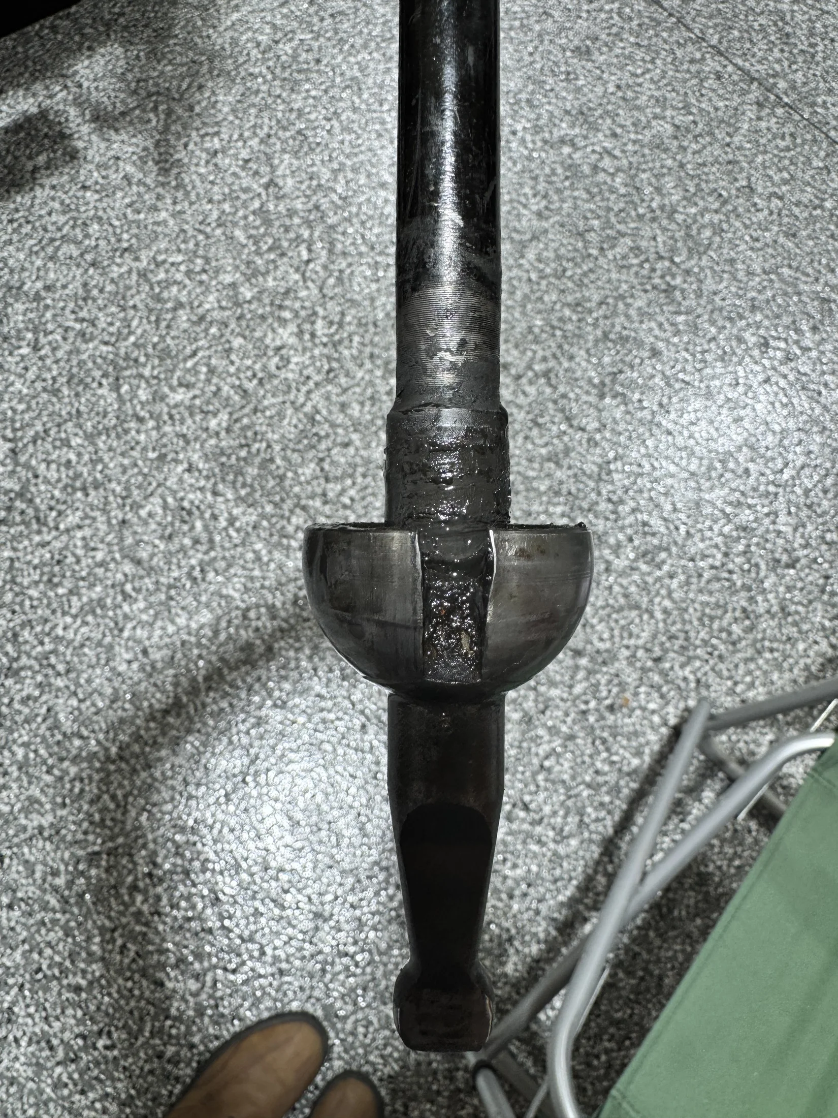

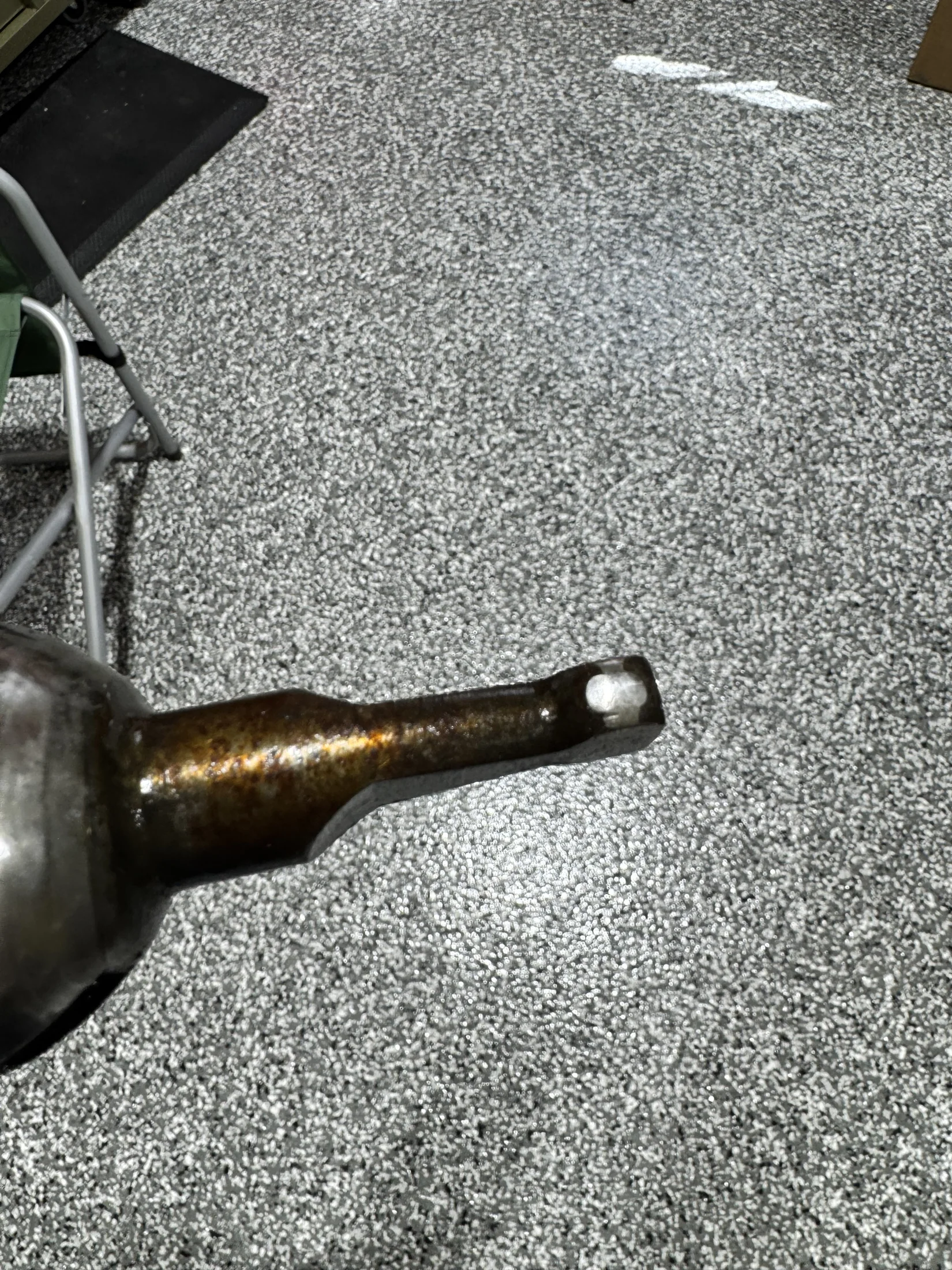

Think I found my issue… 45 years of wear. Seems the lever isn’t available (3/80 build). So are there any good fixes ?
Video of play in shifter…..
Shifter play
Are you or got any friends that are welders? Those slots are worn - try to build up with weld and then file them back out with flat sides. does not need to be perfect A milling machine would make short work of the task. The pins are worn too - maybe you can buy them or just make new ones. Some one did a replacement thread.

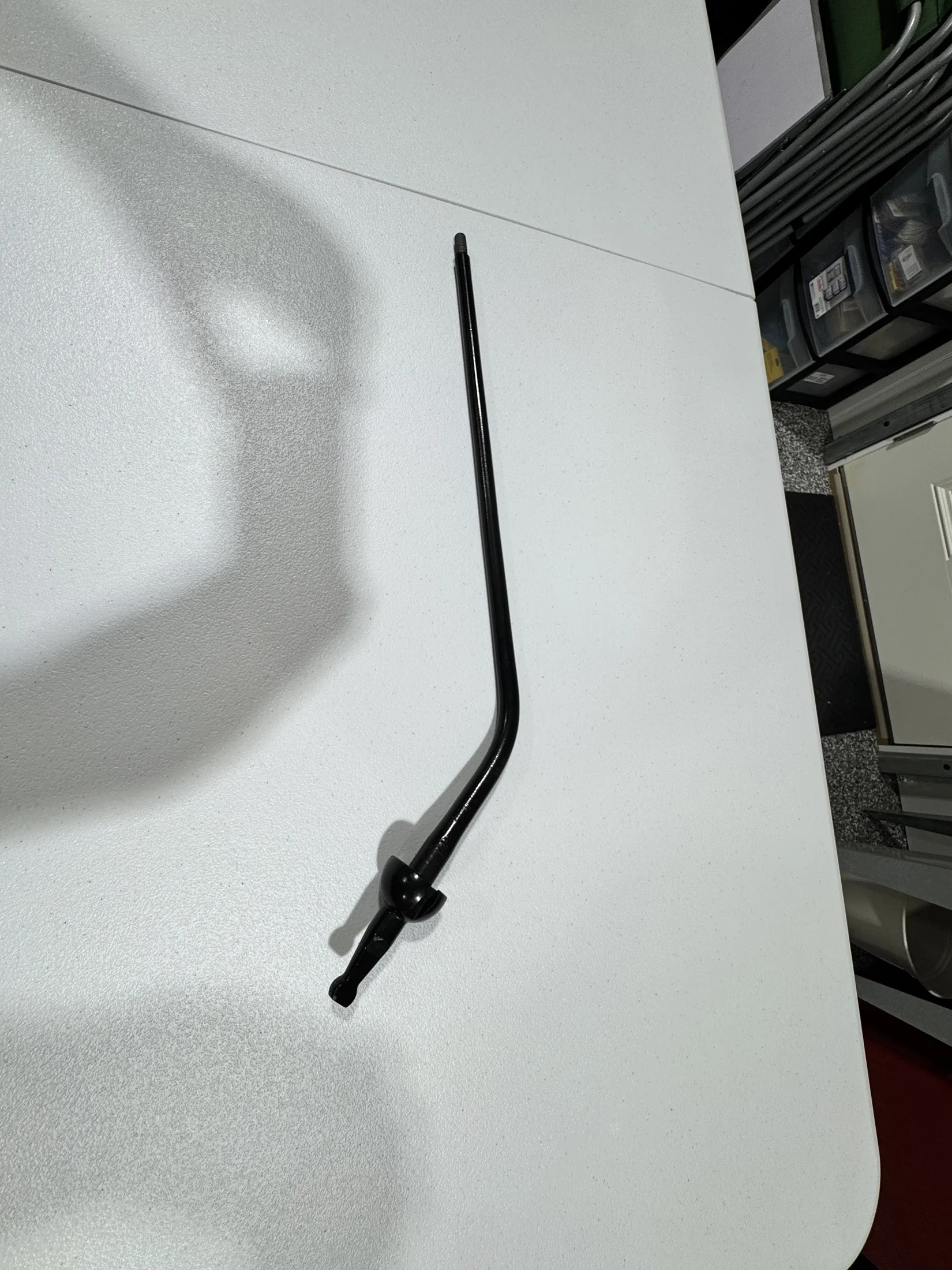

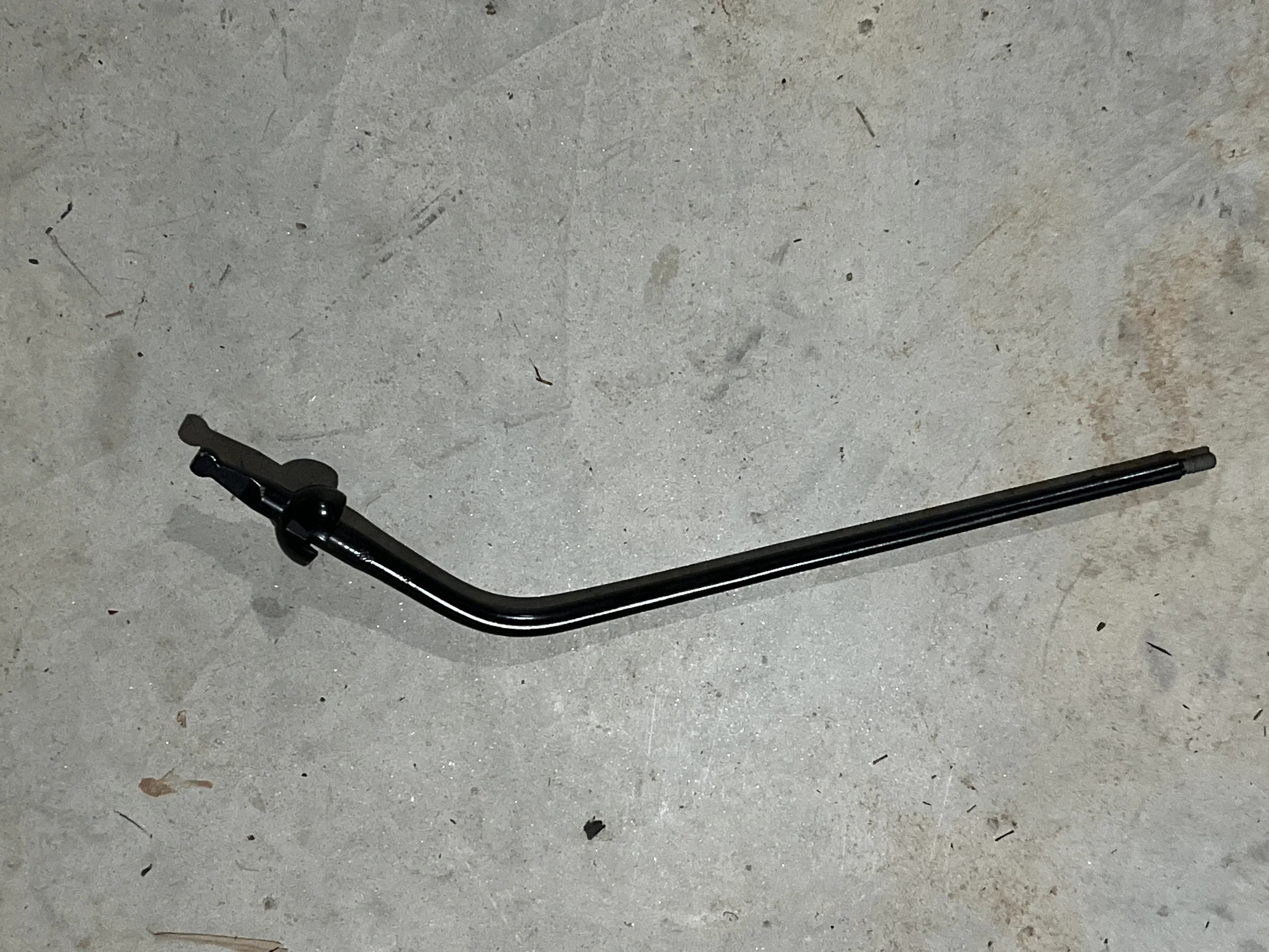

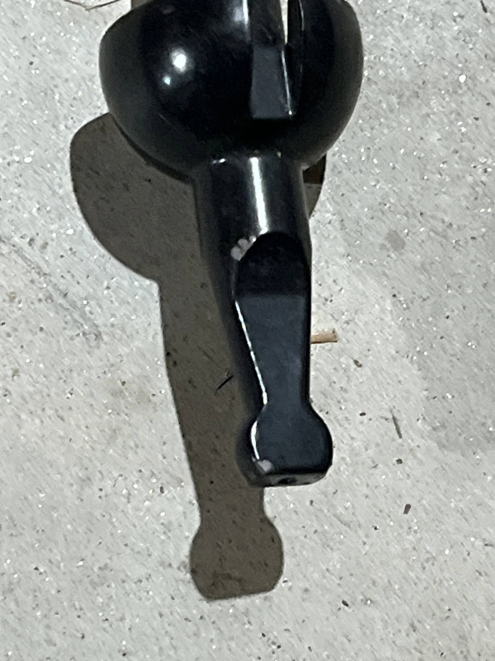

I actually found a shift lever in excellent shape. I’ll see how tight it is and if I need to also replace the retaining pins on the neck as well to eliminate the play/wiggle.

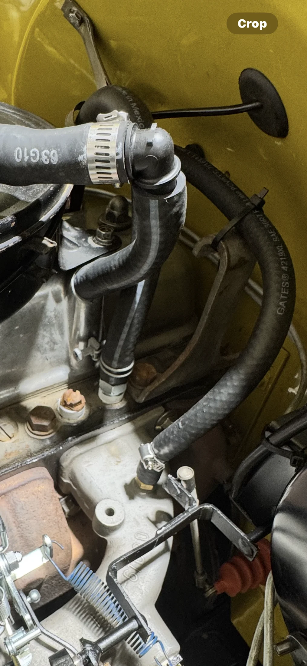

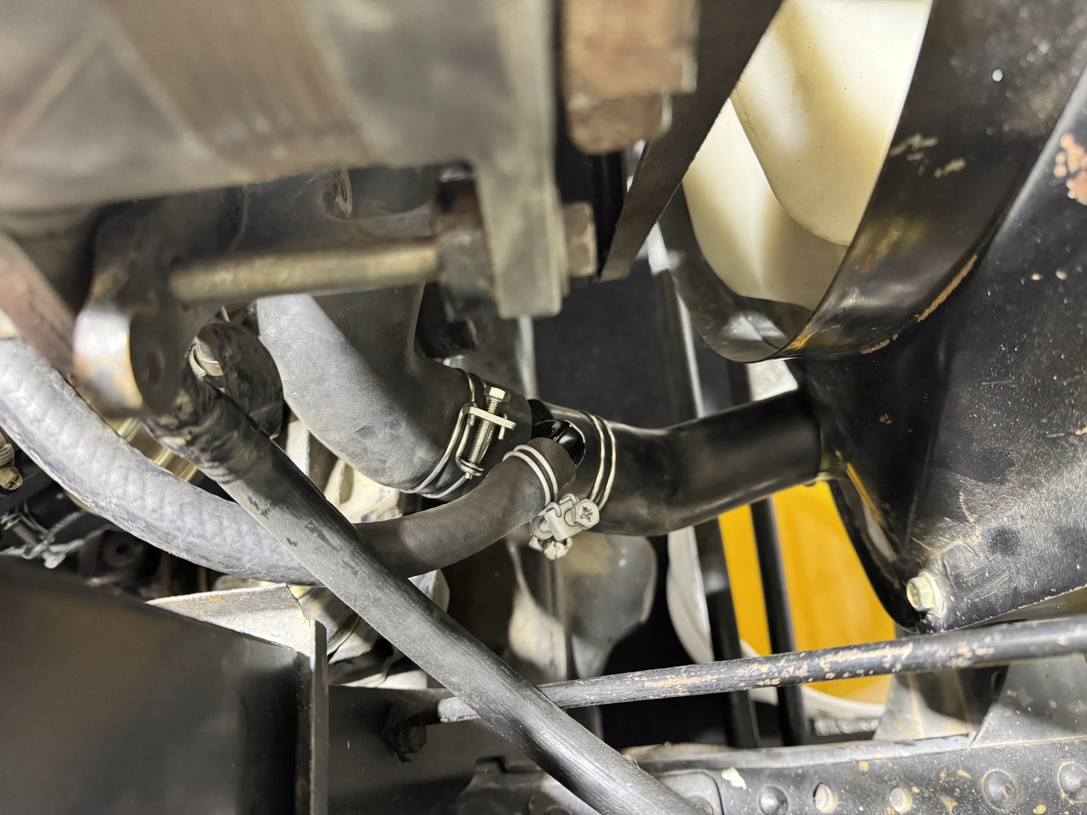

Got both the heater and the oil cooler plumbed. I had to place the metal heater line upside down to clear the coil.
I also added the defroster hoses on both sides as well.
More heater lines
I also drilled out and replaced my 4sp tranny divots and got a much better shape shifter plus the correct inner boot.

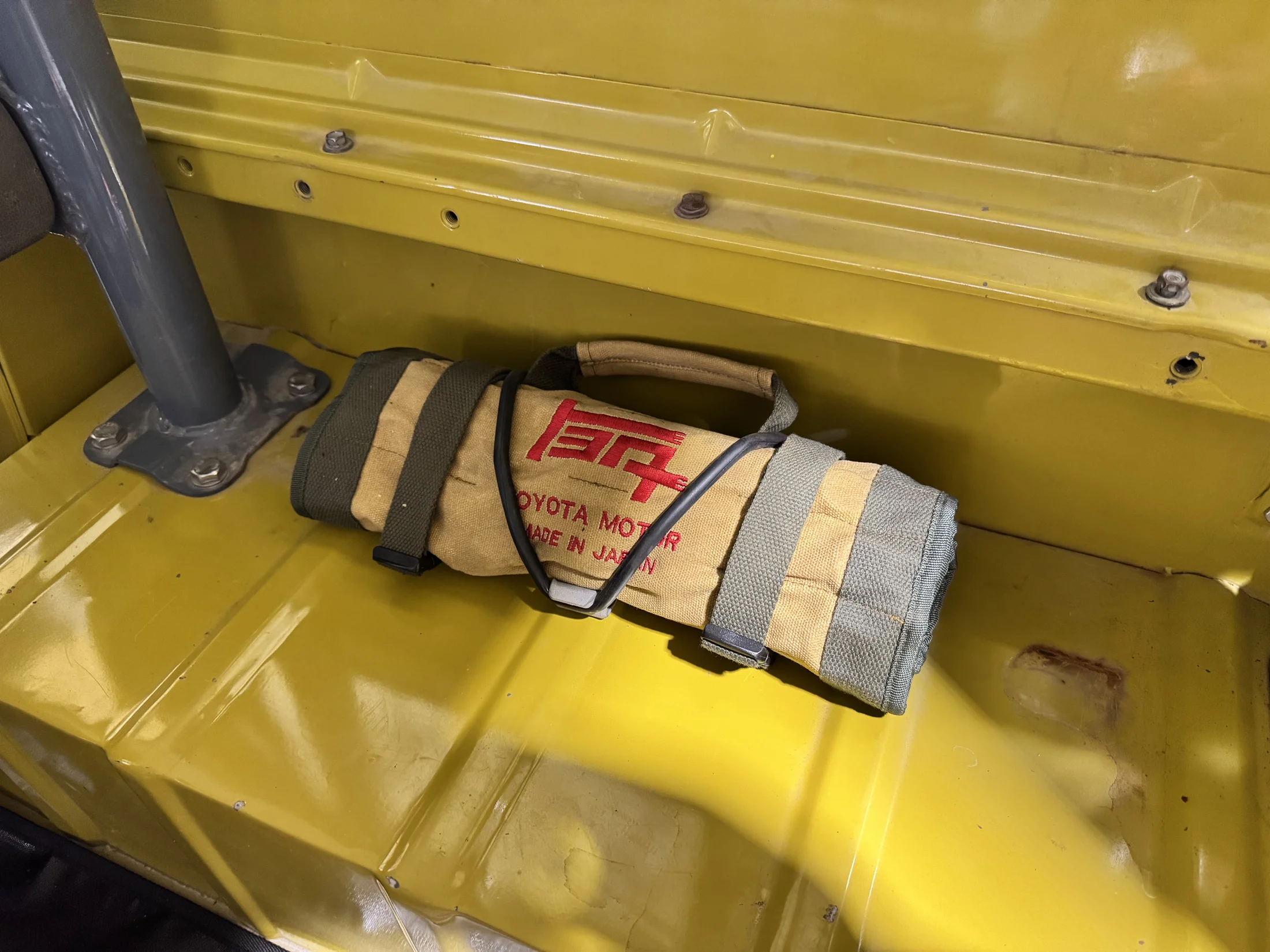

Had a tool kit bag and tool mounts made just for the heck of it !!!

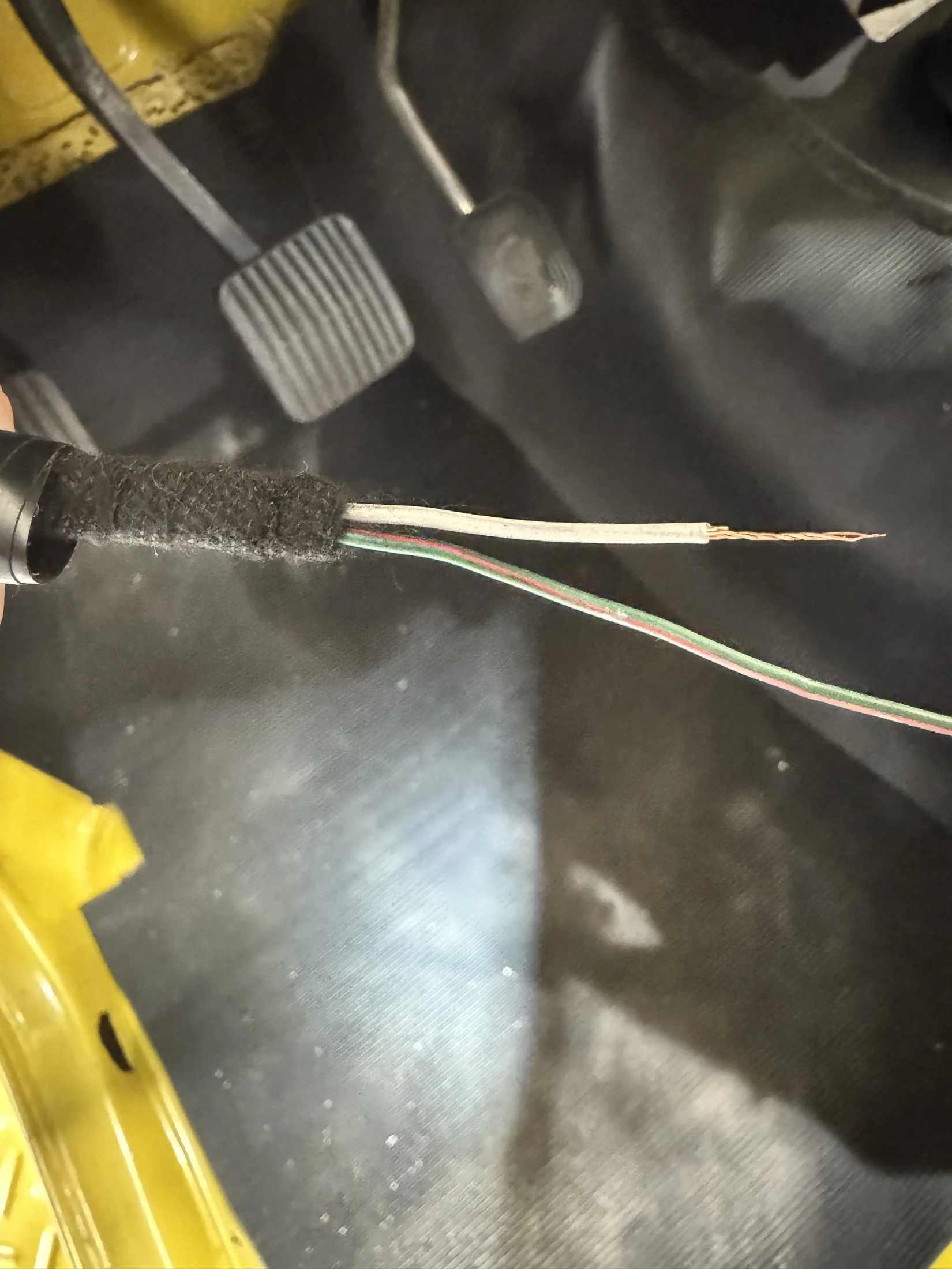

So under my dash on the driver’s side I found these 2 wires coming out of the harness but not connected to anything. One is a green with red stripe and the other is whiteish gray color.
Any ideas what it might go to? Can’t really find anything not working or if it isn’t I haven’t found it yet.
the coil should be mounted on the fender on a 1980. Looks good Mac! I have all the connectors and terminals for repair that stuff if you need.
I think it was a crappy carb and vaccum leak issue. The carb wasn’t OEM and not worth rebuilding but I definitely had a vaccum leak around the intake. Once I replaced the gasket and properly torque the intake/manifold that sealed it up nice. I also replaced and sealed the removed EGR plates under the carb and on the exhaust manifold.
