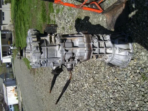

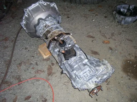

I cleaned up the tranny and chain tcase the best I could or am willing and mounted the bell housing. The package is the same length within a 1/2" of my current bellhousing/tranny/tcase. So if I am able to get away with not modifying my rear driveline (again) I am going to go ahead and run the chain case for now until I want to dish out the 400. I am not sure that is going to happen because I am not going with a body lift and it appears as though I may need to move the motor 2" forward to be clear of the distributor.
