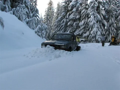

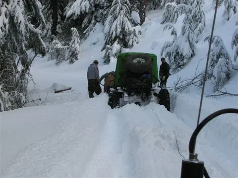

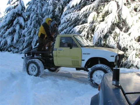

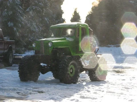

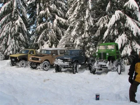

I claimed I finally took it out for a test run on a snow run. Since I finally slowed down enough to buy a star here are some pics. My yota did fairly well thanks to the other guys plowing!! I screwed around and they had to jump on the back once for weight (the least amount of snow we were in all day but I have no weight back there as of now) and I had to be nudged once. The next set of pictures will show the green jeep plowing fresh snow that is as high as his 47s. The unfortunate part is I didn't really get to try anything out other than bouncing between ruts on what I would call non articulating ground. But it was a good test run since I haven't been behind the wheel (in this regard) in 10 years. Most of all my co-pilot was able to go who has been watching what he calls mud trucks on u-tube for anywhere from 1-2 hours a night!!! He loved it which made the work all the more worth it.

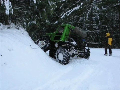

Again I wouldn't dare try to take the credit as my friends were plowing for me however you can see they were able to plow just under the height of the 47s (small tree in the road stopped him and he tried to back up to ram it and went straight down) which every time I opened my door I made snow angels.. :D

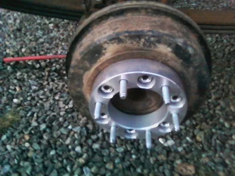

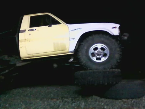

Here is why I had to order spacers. This is my 1.5" of tire clearance in the rear non flexed. I put one on tonight (no spacer) and the front hit the springs hard at turn and my set up does not turn sharp as to try and make the stock axles live longer than a day with the diff welded.... Also chopshop thanks for the advice on the round tube as you can see I take constructive criticism well those suckers are gone!

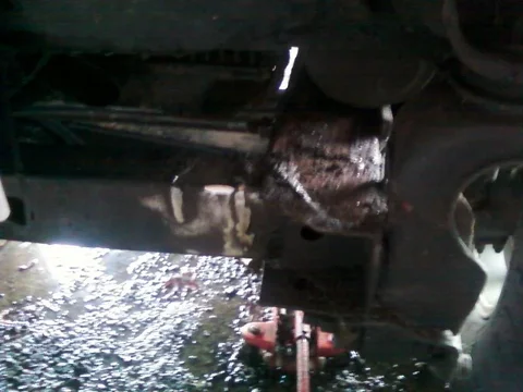

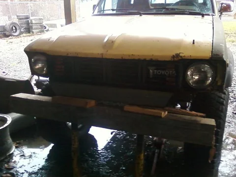

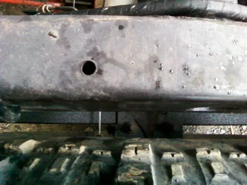

Here is where I cut out the bracket with a sawzall to allow 2.5" x2.5" tubing which was the female receiver size tubing to slide in and be welded to the frame as a bumper mount

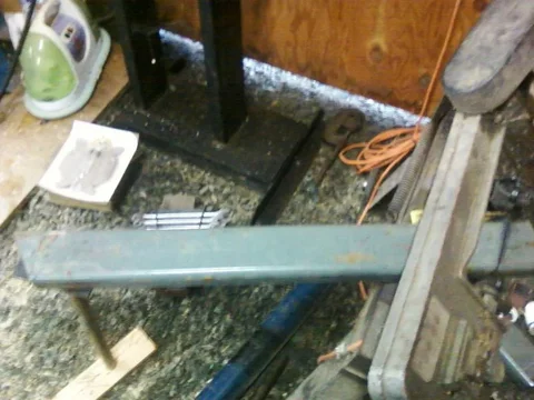

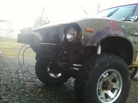

I had some left over rectangular tube I think its about 4x2 and heavy wall which is why I chose to only go approx. 36" wide and tube the rest under the headlights which I plan to do tomorrow now that I know where we are going Saturday and I am going to need it!
My spotter for the weekend was a lot of help as he put in a few hours and we mocked up the bumper
Once we figured out that we liked the placement we mounted it

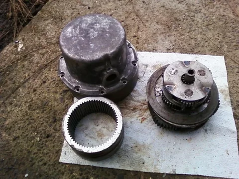

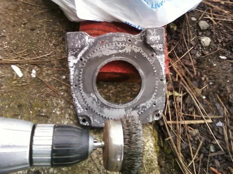

I had made up a receiver style winch for a jeep Cherokee I had recently (good rigs :flipoff2:) and I went ahead and modified it by cutting off as much excess metal as I could and making it fit as close as possible for the weekend. I intend to make a simple lighter weight unit out of tubing in the near future which will not be super solid but will allow me to use it front or rear. I actually plan to make a new mount in the rear that allows it to store away higher (approach angle) but will allow for additional weight in the rear where I want it rather than the front when not in direct use

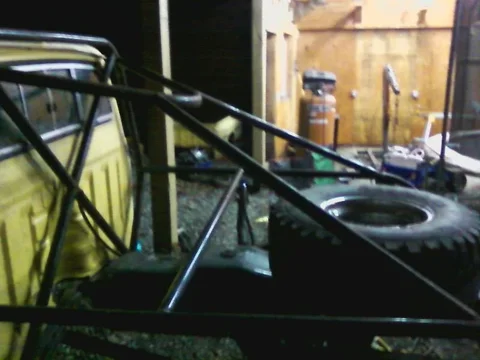

I cant remember if I mentioned it but I had a husky diamond plate bed box for my power-stroke that I was going to sell and try and find a thin width mid size tool box for my yota to hold parts and chains etc. however I am lucky enough to have a crazy talented friend that specializes in aluminum welding and for a small fee he is going to narrow my box. I believe this is the best option as it will allow me to make it small enough that it can set in from the tube far enough to never take abuse as well as utilized the width!! I am looking forward to getting it back. As you can see in the pic that allowed me to know where to put the tool bar protector bar that ended up about half way and will add a lot of support as I rub down trees oops sorry enviros :D

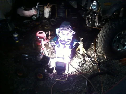

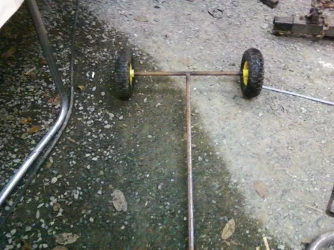

Last but totally not least I would have made it further tonight but my 3 year old son is huge on using his little trailer to haul his black little mud truck that is seen in some of the earlier pics that he ties on behind his jeep powerwheels..... anyway my wife was nice enough to back over his trailer :rolleyes: so we have joined up to build a new (better) one! He bosses me around for 10 minutes and then retires and jumps on his 14 foot trampoline that happens to be inside my shop.... I know :princess: I cut his old bent up axle off and threw the spindles in my lathe to clean them up just shy of the pipe ID spec. I then spot welded the spindles in and added a tongue. Now for the deck supports, tie downs points, lumber for decking, What???? Every three year old has a reputation to withhold right?? :meh:

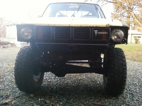

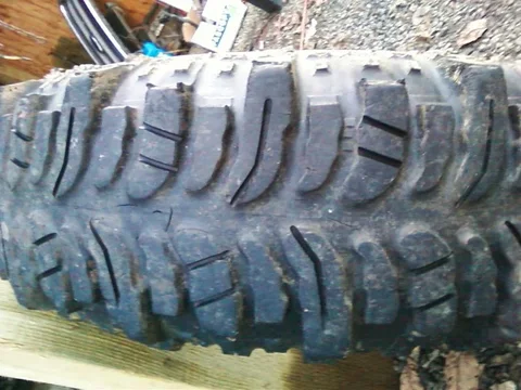

Here is the cut I went with on the boggers. I know there are a lot of pattern options out there but this one was quick and simple and should offer a bit extra bite as well as some lateral traction.

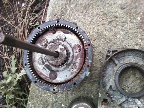

I bent up the tube to protect the front clip. I still need to come up with another bar and strengthen it but I really do not see that happening until after the trip. If worse comes to worse and I bend it I will cut it off and bend another. We found that my winch is not free spooling so we get to tear it apart tomorrow night rather than finish up a few loose ends such as the bumper.
