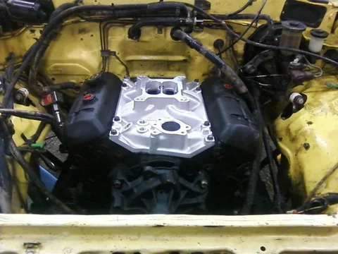

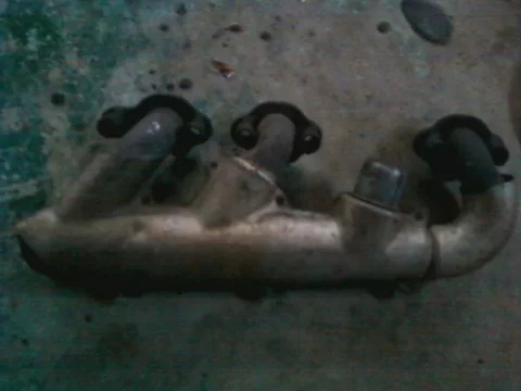

The 4.3 is now mated to the tranny with the centerforce pressure plate and disc. The motor has new mains and rod bearings as well as I pulled the stock manifold off and an edelbrock performer is on its way. The stock manifold was a TANK so I dont mind shedding a few pounds up there. I had already found a passenger side tubular exhaust manifold but was having a heck of a time finding a driver side and finally found that they came for sure on 1986 1/2 ton pickups. My mini no nose cone starter showed up a couple days ago and I am getting closer to buttoning this up. I know words suck so I will try and get a few more pics tomorrow:
Passenger side tubular manifold which allows easy modifications for clearance

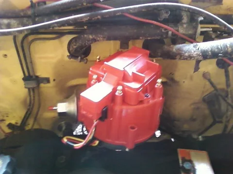

I am very happy with the engine placement. Overall it screwed me and my rear modified tacoma cv driveline is about 2" too short now (atleast until I get the doublers in way down the road) but, the distributor will come out without having to remove all of the heater hoses etc. and has room to breath as well as I didnt have to go to the true short water pump making pulleys a pain in the arse to find. I will still have just enough room to run a 3 core factory radiator without cutting my core support. I honestly would never do a v8 in a minitruck unless it was a pavement queen... no offense to those who have I applaud you on making it fit without placing the radiator in the back or that didnt and it actually cools. I have a wicked vertical tanked alluminum radiator but yep it wont fit because in a yota it really needs to be narrow enough to fit between the frame rails.... :mad:
Here is a pic of the hei distributor location
A pic of the new edelbrock performer intake which I am guessing to be 20lbs lighter....

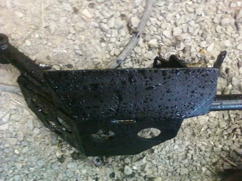

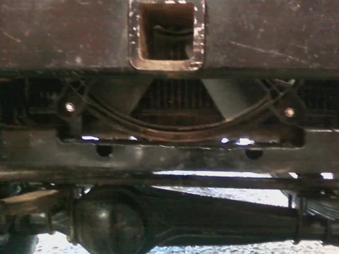

and I have a local rock crawl comp I am trying to get done in time for (in a couple weeks) that I figured we had better build some skids on the crossmember for the t-case. I completely realize the frame side mounting is my weak link and this was originally only temp for mud and wasn't an issue.

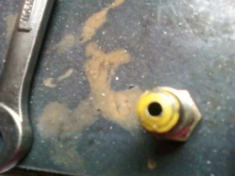

I had given my fj40 3/4 bore slave to my friend when we were trying to get ready for TTC as well as my brake line adapter because we could not find a 3/4 they kept ordering us 13/16 bores (most common). Come to find out my old adapter really wasnt the right one although it worked, the threads bottomed out before the bubble flare seated. I had to lathe down some of the head of the new brake line adapter to make it seat further. I threw some yellow paint on it and you can see where it finally made contact. Also I went to three towns and 7 parts stores trying to find the right one..... Also I had already cut off my 10mm stock brake line end and replaced it with a 1/4

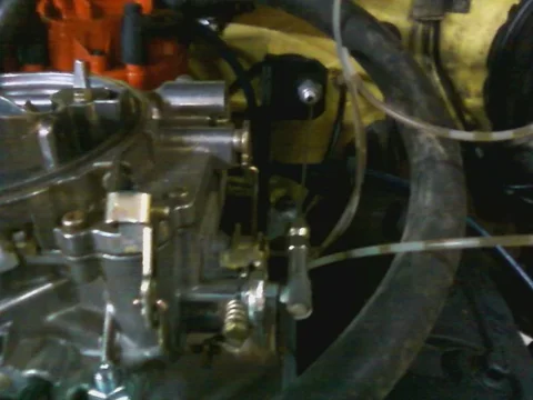

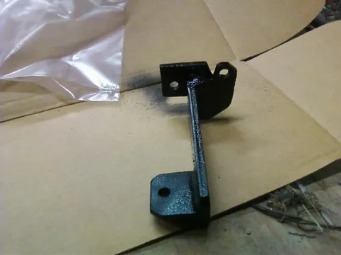

I am haulin the yota to my exhaust guy tomorrow so I had to make a throttle cable bracket for the lokar cable.
I still need a throttle return spring

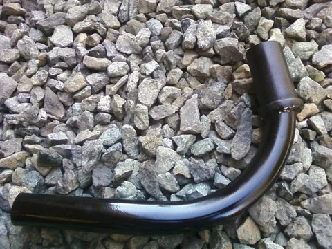

I made a quick crossover pipe for the water as the sbc comes out on the passenger side and the yota lower hose is on the right. This is all temp as the stock radiator isnt going to stay in here....
We notched this crossover and plated it back in to clear the iroc electric fan. We had to trim the back of the grille a little to clear the motor of the iroc fan but it worked out well and is mounted solid. I am going to plate the crossover incase it sees a rock but the bumper is welded and serves as a crossover.

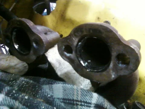

I dropped the heads off today at the machine shop and it sounds like they do have hardened seats but not the type that is required for propane. He was impressed at how bad the exhuast valves had sank. He is going to tank them, check them for cracks, install hardened exhaust seats, mill them if needed (already appears to be 9.2:1 so thats about where I wanted to be). He is going to do a full vavle job when done. I am going to miss the rock crawl comp this saturday but what do you do........ :rolleyes:

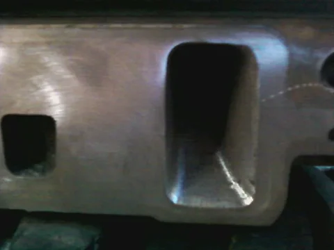

I matched the exhaust ports the best i could on the tube manifold style. They are welded on the inside not the outside and I sure as heck do not want to go too thin and end up with a leak. I was happy it is really close.

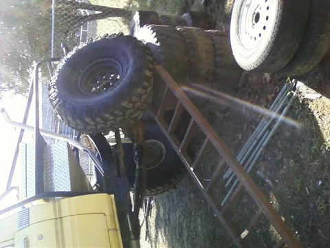

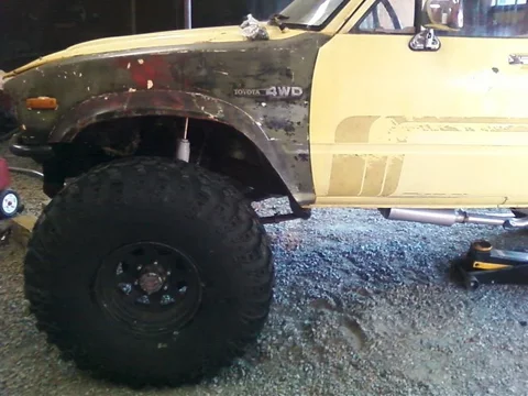

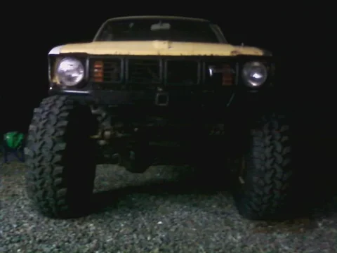

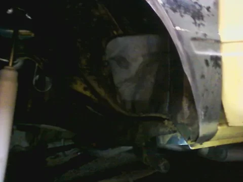

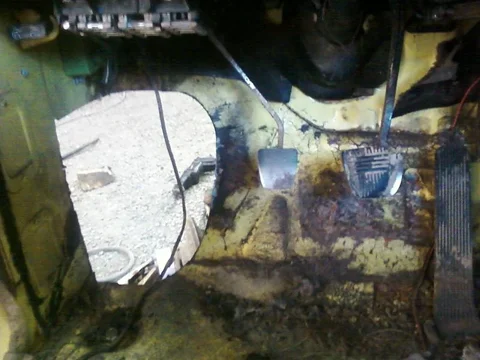

So I went with 39.5s and even though my front end is forward I still rub with my 38.5s in the corner of the cab. I refuse to go more lift (other than I want 1" more) so here is my next option:
It allowed me to really open the fender up. I just need to plate it back in now.
We were able to spend a bit of time today on the cab corners. We cut a card board template and then plazzed out the fillers. It took a bit of hand work bending and hammering them into shape but we were very pleased with the results. I sure wish it was easier to weld that thin dirty crap.... Spent most of our time with a chizel trying to scrape under coating.
well I will soon find out how the golf balls for balancing the tires works. (the exhaust is obviously unhooked and laying there waiting for my heads to get back from the machine shop)
I went from the 38.5 skinny boggers on 7" 3.5 backspacing wheels to the 13.5 on 8" with 3" backspacing and I have about the exact same clearance between the frame and tire. It is plenty and most would say run it since I have ground the round tire cutter off from the cross member but I believe it limits flex in rare cases and if I am going to run those skis for springs I am at least going to make sure they do their job as well as possible..... I am contemplating inboarding or narrowing the frame since it is boxed anyway I am assuming I can't make it too rigid especially since the tube rear cage is welded to it stiffining it even more. I was hoping to find a forum just basically to see how others have done it but can not find squat. I might not be using the right terminology. Has anyone seen a thread of such??? It looks like I could plaz out the top bottom and outside of the frame in an angle leaving the back of the frame, box out the angles on the front and reinforce the back side with some equal sized box tubing at a greater length than the cut section and be fine.... The only thing I have to contend with is the fuel tank but I might just be able to squeek something. Worse comes to worse I would ditch the stock tank cuz it already irritates me every time I look under there thinking about links. Any thoughts or links to thoughts would be appreciated.

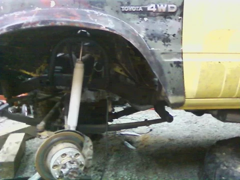

we moved the front axle another inch forward to clear the cab corners tonight. I do not necessarily like where the axle sits on the springs (rear springs flipped) with the extra inch but its a give and take. I will try and snap a decent pic this week. I will say the approach angle is sick now. I think the issue now may be spring wrap. I am sure we can minimize that fairly easily if needed.

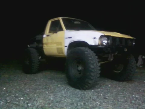

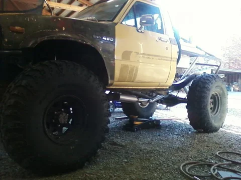

Here is how it sits now. The rear flex is limited by the tires eventually rubbing on frame (not bad), and the front tucks the tires and droops fairly decent. The approach angle is pretty sick.
Daggum looks good to me! And yes, sadly it is dying... Around here you pretty much have to stick to wheeling on private land, and access to such is dwindleing quickly... And how are you liking the 4.3?
I really dont know yet. I havent played with it enough yet due to hunting season but it didnt seem to weight the front down too bad and it seems to have a pile of power even with the stock gearing. I also have plenty of room to keep it cool in the future and once i slap the 4.88s in there it might not be too bad. But I will say if I had it to do all over again I wouldnt have done it. I would have built another 22r and geared it along with my doublers and been done.
