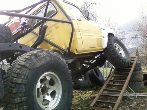

I had these laying around so we mounted one up for a spare.

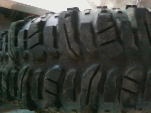

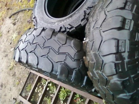

Here is a better pic of the tires than I posted earlier. These are nothing special but I picked them up for 400 with wheels

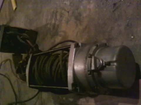

We also got the high lift jack mounted but it was too late for pics

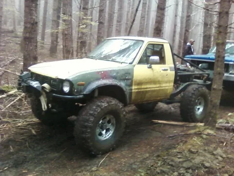

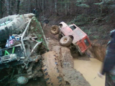

So the run I have been getting ready for is over.... I must say it was awesome!!! I was so suprised at how hard my yota pulled. It has been 8 or maybe 9 years since I wheeled at this caliber which at that time bald 36s on a yota was big!!! Now bald 36s were an ancor. We started things off with one of the worse of the worst spots that was a wicked steep big articulation huge rocky hill climb. A couple rigs made it after some wicked attempts along with my friend with 47s however the rest had to winch. I credited myself to a lucky bounce but worked my way right up it :eek: After that it was on to tight trails and wicked ruts/mud/holes. I talked a bit of crap on this forum about not knowing if the 63" springs were going to be skis without 40 inch tires and although I still stand true about the need of large tires to offset the cons I eat total crow they were wicked (one of many vetical 3-4' to straight up incline drop I hit about 3"of the rear springs but cut right through and barely noticed)!!! I am not totally sure about the double shackle and at this point may ditch them as they unloaded once that made me decide to let off the brake and hammer throttle but all the rest of the time I didnt notice them and do not know if the crazy articulation should be credited to them or just the spring :meh:. I admit we hit one particular spot first before the croud and I think I was three rigs back but I pulled a spot that I saw at minimum 10 rigs break axles/hubs trying to get up (again they had the tree roots more exposed etc). I didnt have time to take pictures as I was white knuckled 25% of the time and trying to help others the other 50%...... Uhhhh ya I left 25% open for my shear lazyness. I had to winch one time (winch rebuild worked great!) My springs settled I bet I only have 3" of uptravel in front now.... I plan to gain 1.5" of front lift by refabbing the front pack soon. I rubbed in areas of the front that I thought I was 100% for sure clear which cut the tires up a bit but not so bad to :frown: (Nothing a sledge hammer wont fix!) Even though I rated on what I believe to be 250% of my expectations my friend with his wicked creation and 47s pulled 2wd broke down vehicles up the stuff I accomplished...... that dude is sick. My other good friend that has not taken the 9 year wheelin vacation stated "ok screw it I will weld my front end up too"

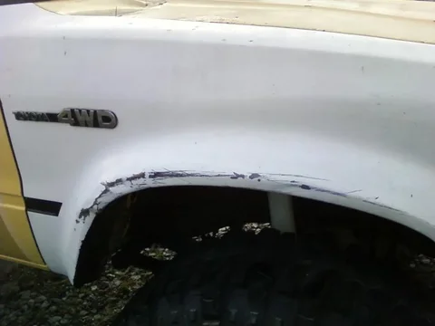

I did however put it on its side a few times through some nutzo ruts and scratched/banged a fender/door/cab up. :D Shoot I am happy the cab still holds glass

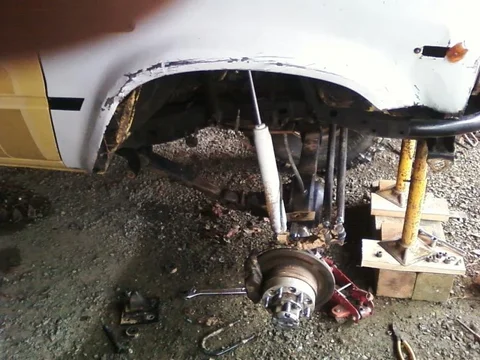

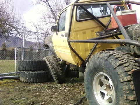

I dropped the front leafs (stock rears) back out and added another leaf out of the trail gear lift springs I had. I also added a very short maybe 8" overload to the driver side just to make up the small difference in perch heights. So far it definately feels stiffer :frown: but i think its the best choice and it gives me just over 4" of space between the bumpstop and pad (springs flat) and obviously didnt mess with the droop. I really dug the soft suspension but it didnt take much led foot to bounce it off the bump stops after adding the bumper and winch! Once the 4.3 is added I think it would have been rediculous. I suppose thats why everyone else I read adds more than 1 spring to the stock rears.... :rolleyes:

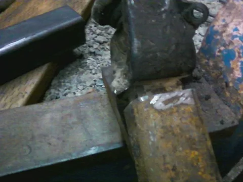

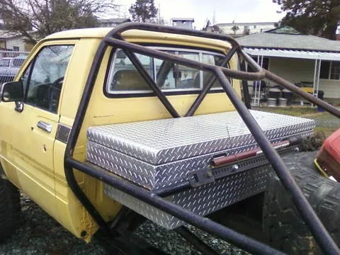

So i needed a place to put chains, my lunch, tools (so they don't fly around in the cab and hit my 3 year old), straps, spare parts, etc. I was trying to figure out what to do since a truck box even for a mid size truck was going to stick out just enough to get killed since my tubes are slightly dovetailed. I had a full size box laying around from when I bought my power stroke so....:hhmm:
Luckily I have a talented friend that was able to cut it down and weld it back together including reinforcing the inside where it is cut plus I placed a piece of plywood in it to distribute the load as well as the beating it will take.

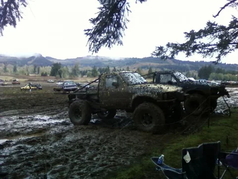

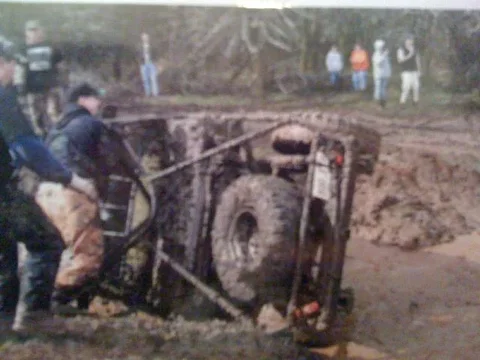

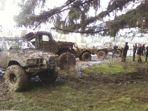

We just got back from Mudfest here in Oregon. It was as usual a wild time. I didn't take very many pictures but here are a couple. It went well except obviously in that kind of environment (farmers field that is totally destroyed with the occasional huge hole dug with an excavator I needed way more wheel speed yet I was happy with the way things went. There is one spot that you wind up a very wicked articulating rivine that I eventually screwed around enough to force my self into tipping over on my side. I am trying to find a pic of that and if I do I will post it as well.

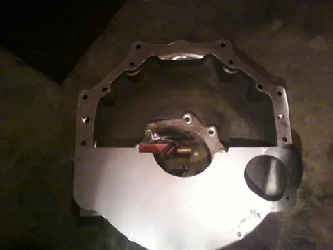

So again I can't blame anything for this other than me purposely tipping it over for something to do since I had a soft landing... :meh: (I just dont want anyone to start blaming the double shackles, the ride height, the price of tea in china, etc.) However as a result of the lack of power I just ordered the AA adapter for my 4.3 vortec to go behind my R150. I will throw the chain drive case behind it for now until I can afford the next adapter word to put my dual gear cases back there.

AA adapter arrived so I am running out of excuses why the 4.3 is not in.....

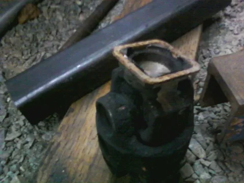

Tonight I sold the turbo 350 to 21 spline tcase adapter I picked up from a guy while searching for a 4.3 to R150 adapter. Dont ask he found me and needed money quick as he was headed to alaska and I was happy to make 60 bucks and a spare gear drive tcase even if its a foward shift. Regardless I want to put my 60 bucks towards something yota ish and have spent an hour searching my self stupid as usual. I give up I dont even care at this point if you call me lazy I am totally confused when you throw the r150 into the mix on if i have to convert my forward shift or not here is what I have: I have a R150 with a chain box on it now. I have a 21 spline top shift gear box as the reduction box hooked to my adapter for the doubler. Then I have two forward shift 21 spline complete tcases sitting here. WTF do I need??? I am ?? a twin stick since I am welded in the front and turning sharp is not exactly possible. I am not sure its necessary though as I plan for an E-locker or ARB in the future. I have 60 bucks to blow to put towards the cost of something lessening the blow. Should I just buy the stub shaft to go to the 21 spline case or ??? Honestly I have become stupider tonight after searching (off of this site) and one saying you have to and one saying BS he has and .......
Any help is appreciated.
You need to convert one of your forward shift boxes to top shift. :cheers:
The dual case adapter will only take a top shift as the rear case. You can cut and weld to turn a forward shift into a top shift, but I think Marlin also sells the parts to do so...
