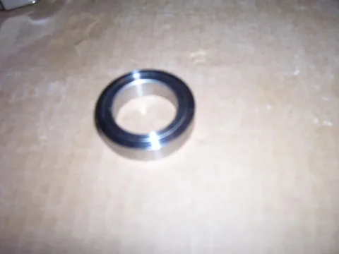

It appears now that it is listed as a different part number now and is a 1.090 EXT. BUSHING(.670 X GM CRANK) where as the old ones are Pilot Bushing 1.090 X .471

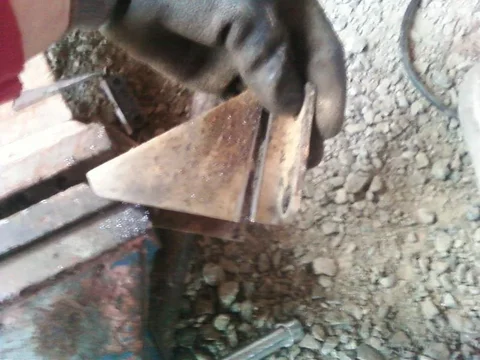

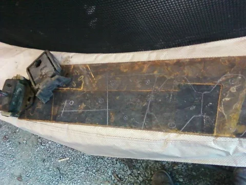

The 4.3 motor mounts line up with the factory toyota mounts. I think I am going to be able to adapt to the factory mounts with out it being oakie.

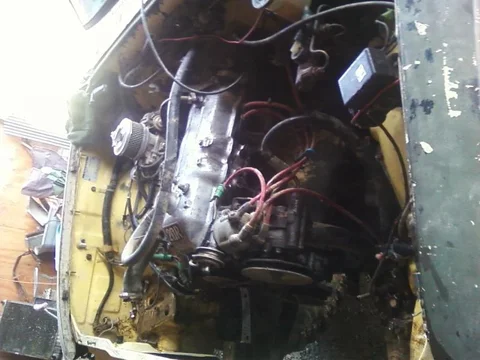

. Since he purchased the yota it would start up and run fine but soon would idle terrible and in the mountains on steep hills (just typical logging gravel roads) at times we would wonder if it was going to pull first gear to the top.... He has had it looked at by a few back yard yota gurus of which one de smogged it. I have given it a tune up for him a couple months ago but still no luck. It runs and drives fine on the street but any steep gravel hill in the mountains and you think you are going to have to pull over and put it in 4 low. He has been asking me to look at it but I have been tied up with TTC. He dropped it off tonight and I checked the obvious... Cam timing yep, distributor at 11 oclock at TDC yep, plug wires right yep,
I have been trying to avoid a compression check as a last ditch effort because the PO advised it had a questionable heli coil in one of the spark plug holes. I got to looking at it and
all of the exhaust valves were tight! as in way tight (full turn). I called the neighbor over to ensure I wasnt crazy and we adjusted them up. We took it out for a test drive, got it warm, and pulled up our steepest local hill lugging in second gear high or spinning on demand in 1st which is where a 4 cylinder yota with 31s should be. How did it not burn valves since it has been this way for a couple of years???????????
