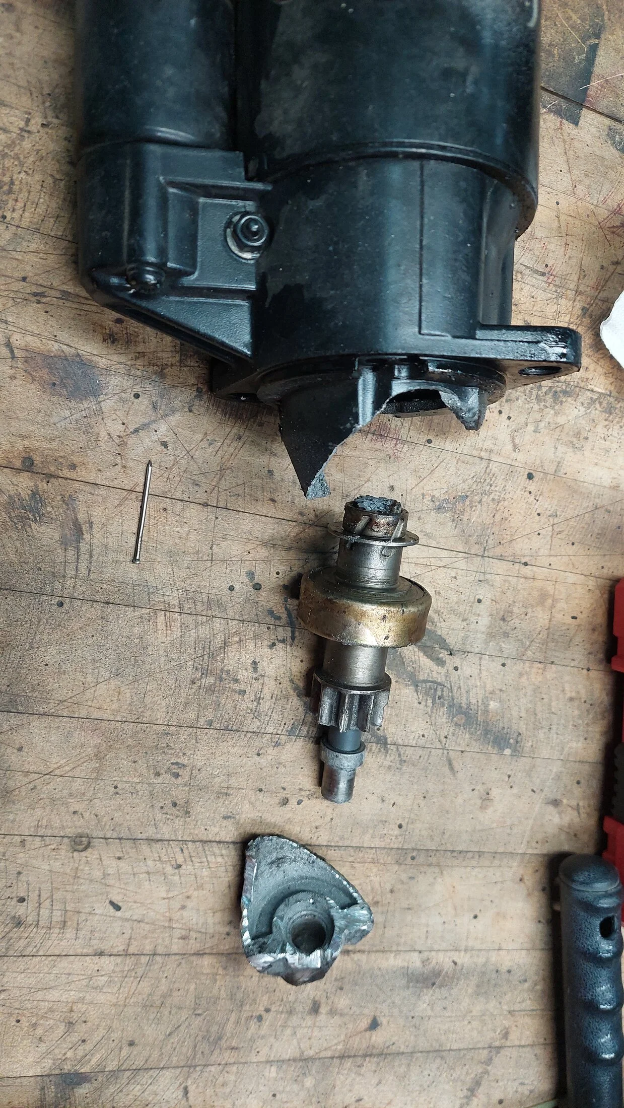

Had a starter blowup into 4 pieces. see attached pic. I have never seen or heard of a starter blowing up before. I could not source an OEM starter prior to my son heading back to college.

your starters' gear got caught up on the flywheel, i would iron out that possibility then go with a gear reduction as Paul mentioned

could have been something as silly as the starter loosened up from the bellhousing, but more often than not its a worn pinion gear and or spent pinion gear bearing.
your solenoid could have issues as well. like contacts seizing and the solenoid staying stuck out.
you could/should dissect the broken starter to see if there is evidence of anything abnormal(other than the broken shaft and destroyed teeth
I would also use a flashlight to check the flywheel. sorry if I've stacked tasks, just thinking of possibilities that might help you out.

Mine failed, as well. A chunk of the starter got stuck between the flywheel and bellhousing, seizing the motor, during the time before I owned it. Then, I bought the truck not knowing where to look. It was hard removing the bellhousing because the crank was seized, and I couldn't remove the clutch pressure plate with the crank in one position.
