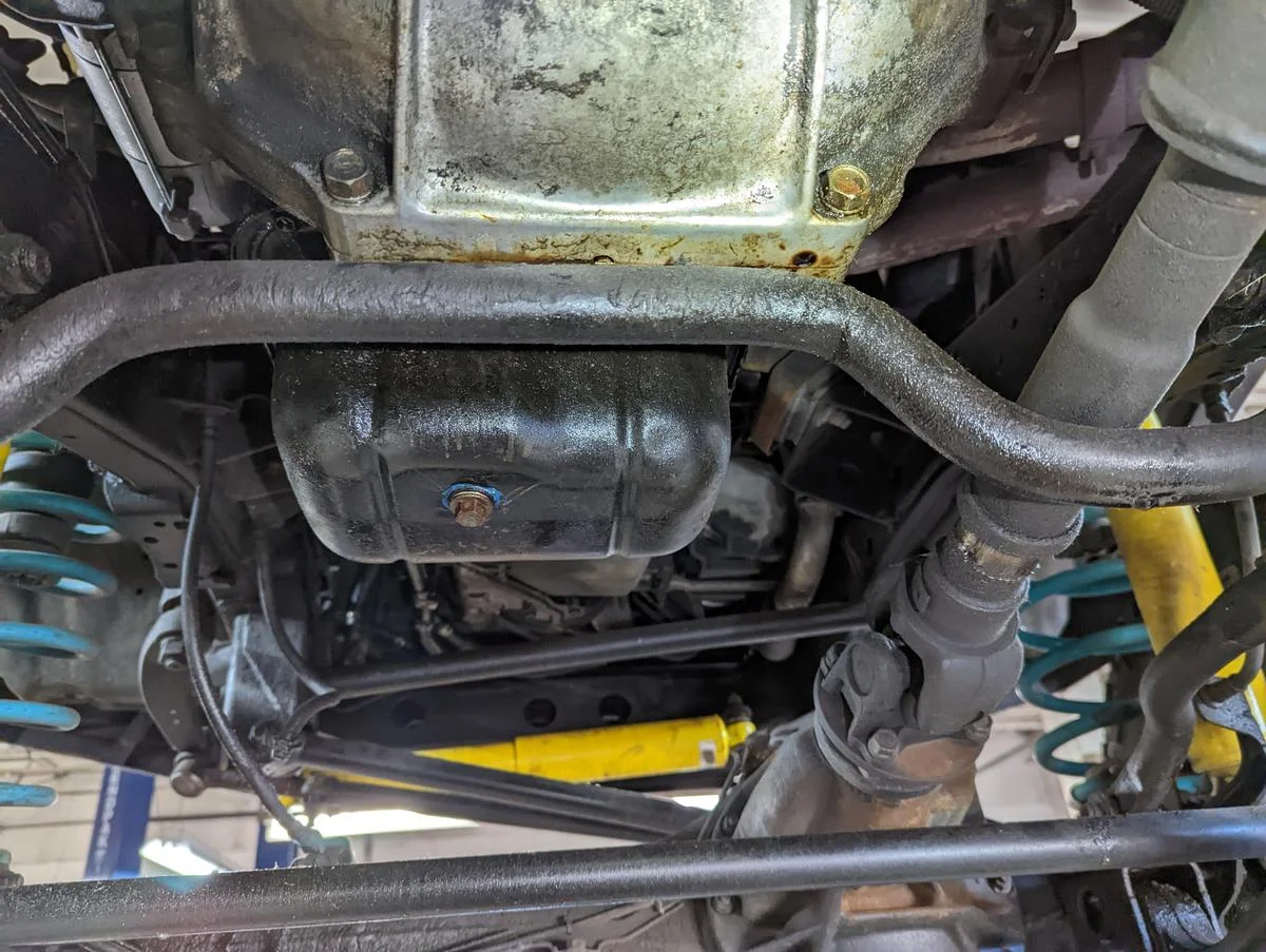

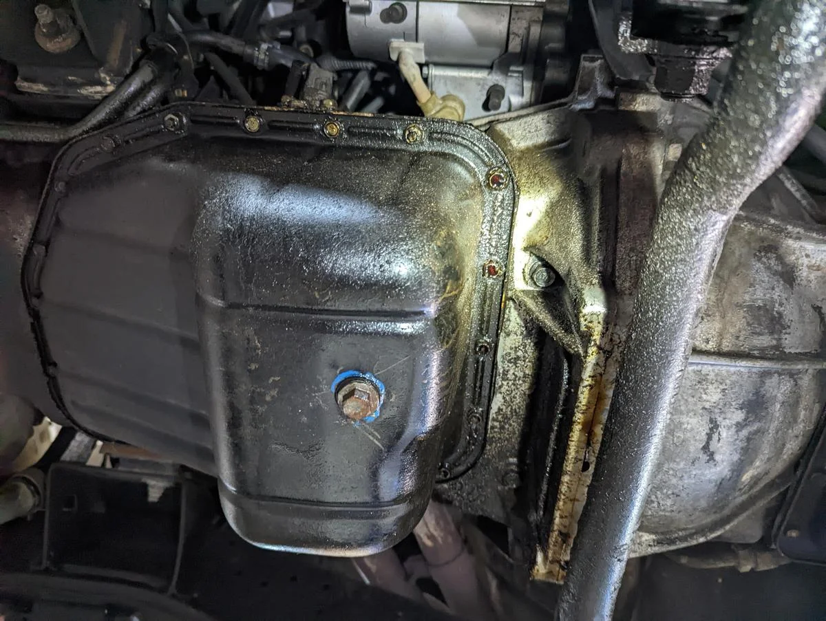

The most common leak at the rear of the engine, drips coming off the bellhousing, is from the upper oil pan but both pans need to be removed then resealed. So that appears to be a correct diagnosis. The leak is usually from the rear arch area of the upper oil pan.

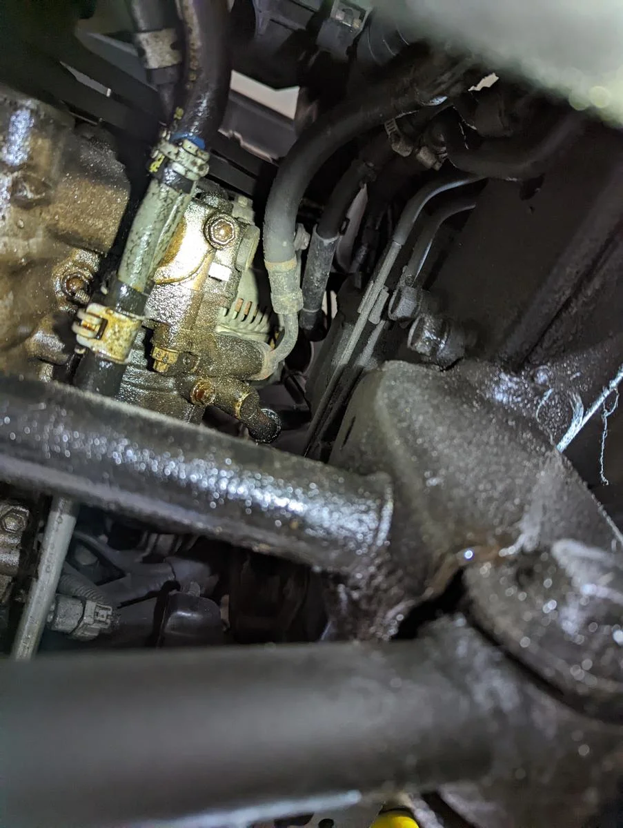

The most common leak at the front of the engine is from the Oil Pump Cover, that is of course also engine oil (not power steering fluid).
Can't tell from the photos what the fluid(s) are but from the pattern and amount, best guess is at least some of the mess up front is from the oil pump cover.
I would clean the areas in the photos well working from the top and bottom then watch closely. Take more photos after it's been cleaned off.
Were you losing power steering fluid?
I don't know of any way to remove the oil pans without pulling the engine, so consider that in your assessment of the quote. You could, conceivably, unbolt the engine mounts and lift the engine on the harmonic balancer, but I wouldn't let someone do that on my engine. The quote doesn't surprise me, but IMO it's too much for the job.
FWIW, you can fix the power steering leaks yourself for the cost of parts and two hours of your time. I'd really clean the oil pan and see exactly where the leak(s) is/are, before I let someone pull the pans. @Kernal is correct, the seal between the pans is a known problem area, and it's a PITA to fix. The good news is it keep the rust demons at bay. If you're not losing a significant amount of oil, I'd leave it. Fix the power steering problem, though.

Oil pan removal is full on PITA if done in situ.
And you need to think about the other intangibles:
1. Waiting for FIPG to cure before putting oil in.
2. Bleeding PS system.
3. Possibility of it being rear main seal.
4. Good portion of front end of vehicle needs to be removed.

What are they doing to the power steering pump, resealing or replacing?
What power steering lines are they replacing? The supply and return coming from reservoir is easy, high pressure line not as much but with pump coming out makes it easier.

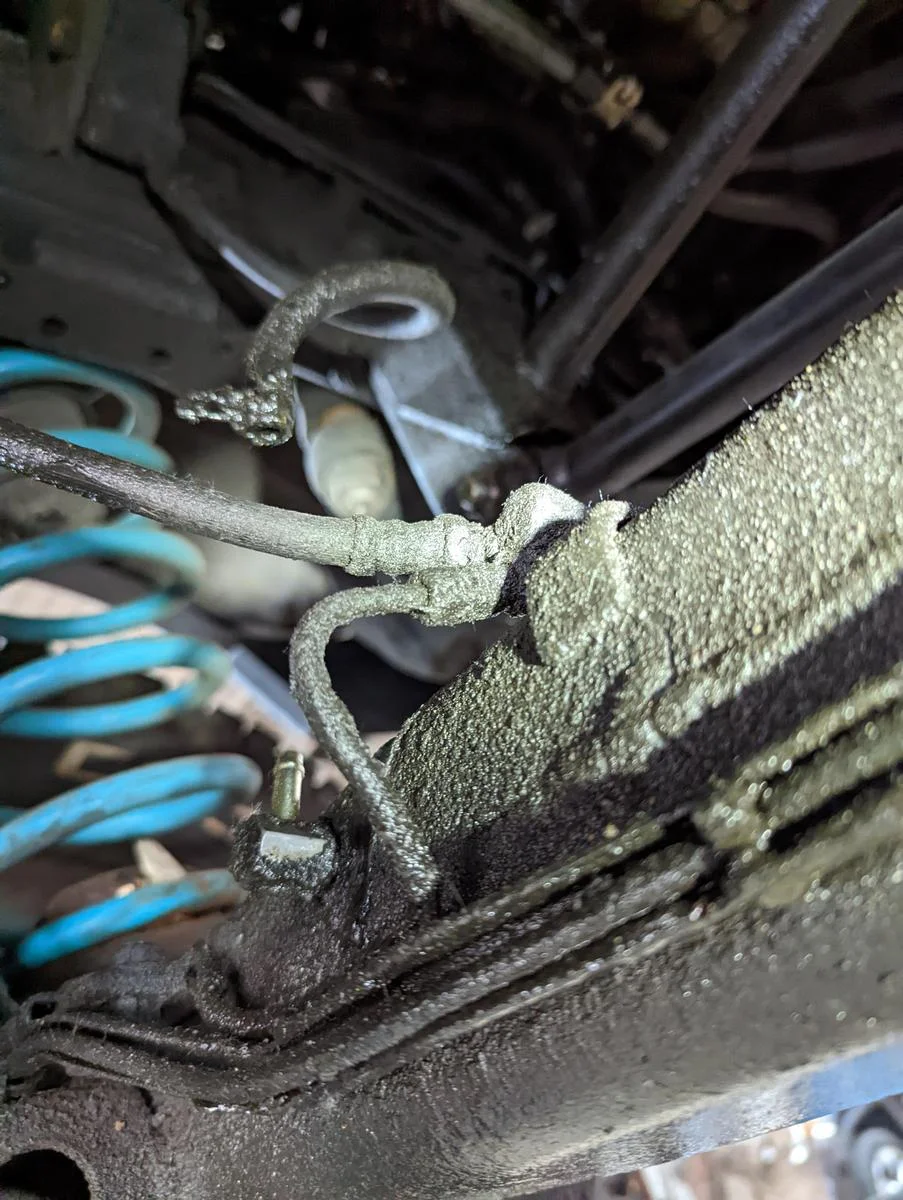

My guess is most of it coming from more common leaks and not the oil pan
Most of the oil on the axle is most likely coming from the axle breather as the hose has come disconnected

As mentioned above, be sure to reconnect the hose to the short pipe nipple on the axle housing (has it been that way or did the mechanic pull it off to check out the valve then forget to put the hose back on or??)
That could add to the mess if gear oil is blowing out, but also you don't want to get water into the diff/axle housing if you wash it off.
Kernal could you specifically point that out to me? Please and thank you very much.
