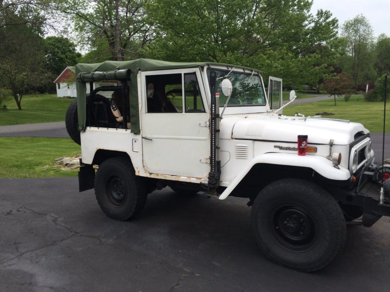

Hello all and Happy Holidays,
I have a 79 FJ43 with the original 16' split wheels and need some nice looking tires and sizes recommendations.
I have seen that a few people are saying 235/80/16 is the perfect size and a few are additionally that BFG All Terrain tires look the best. Currently the FJ has 235/60/16 tires and they seem small and crappy.
Also, did the 1979 FJ43 not come with Center Caps? I see pictures with them... My wheels dont have the holes to rivet the cap clips. So, no?
Thank all!!

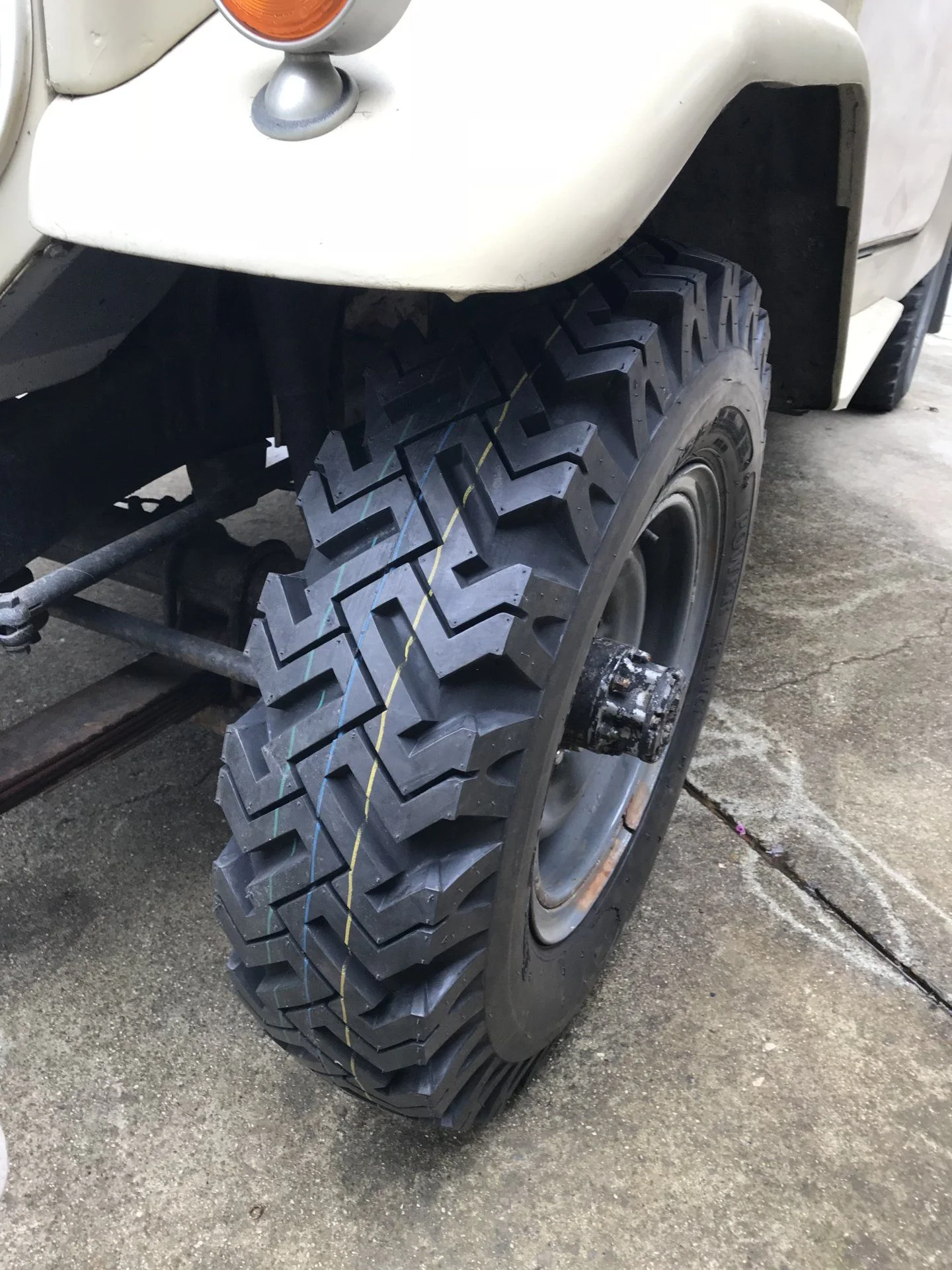

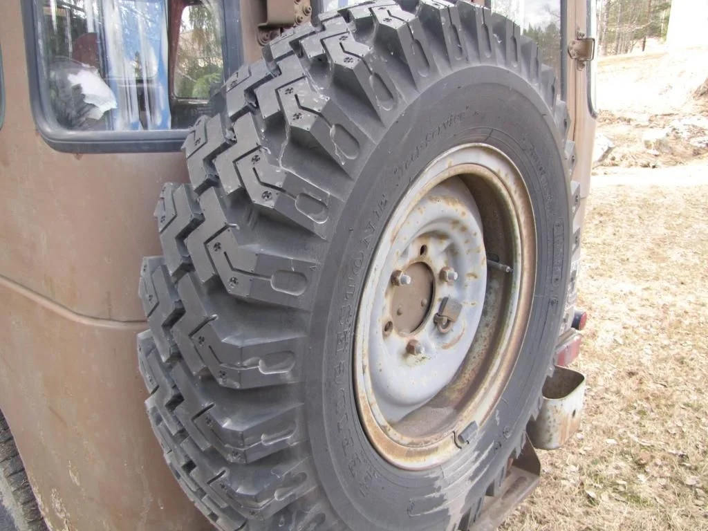

Take a look at the Traxion 7.50-16. I think they're bias , but if you're looking for old school look they're nice.
Dont forget you can now get a quality modern radial in the old 7.50r16 size meant for those narrow rims with the BFG KM3.

That's entirely up to you - the 235/70R16 size is going to be smaller, and is a P rated tire, for "passenger" vehicles. Thats totally fine for road driving or gravel and dirt roads. They will be lighter weight, quieter, and should ride smoother. The 7.50R16 BFG's I chose are an LT "light truck" tire, and in load range E which is what is typically found on a 1-ton pickup. Overkill for road driving, but will be a tougher tire off road.
