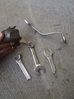

New sender from amayama trading from Japan was about 60 AUD. My gauge was reading low pressure but still responsive to rev changes, only it was reading very low. Changed the sender all good now on the factory gauge. It is a bit of a prick to change but doable! Couple of tools I used because I didn't have a claw socket
Thanks Carpet.
Quite an arsenal there.
Can't wait to wade into that.
