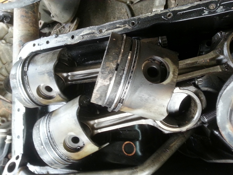

Looks like it was a squirter failure from the discussion with another mechanic proably the squirter broke off.

Picks of the damage.

1) you install china made piston? Look at fatiqui on bust piston. Why use china piston in tune up engine?
2) bust piston break off oil sqwirter and cause heat

cicak, the squirter is use to cool the piston , so you are probably right . But , just in case, i would suggest to make sure the oil passage through the con-rod is clear, also... it would be good to check the corresponding injector for opening pressure (very bad leaking?) good luck

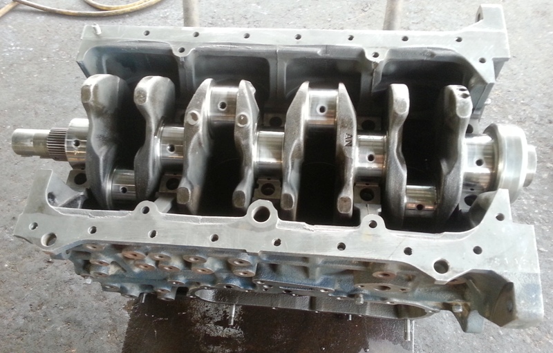

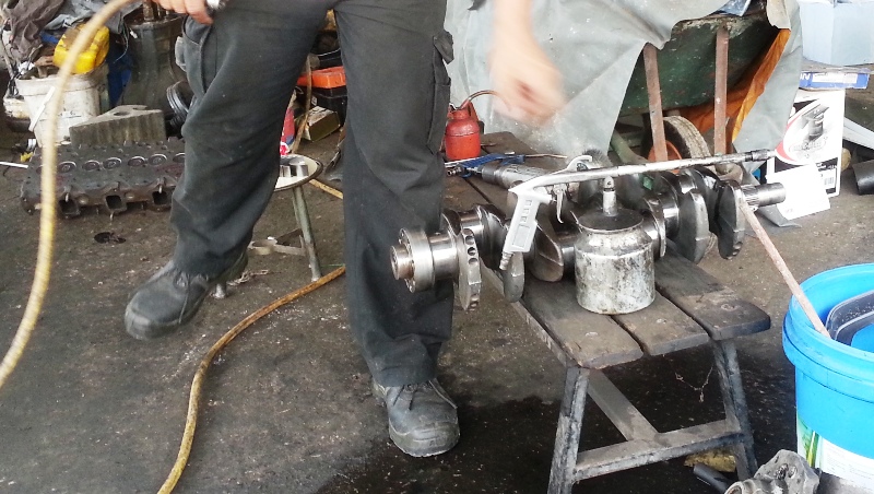

The crank being prepared
Crank sitting in the block

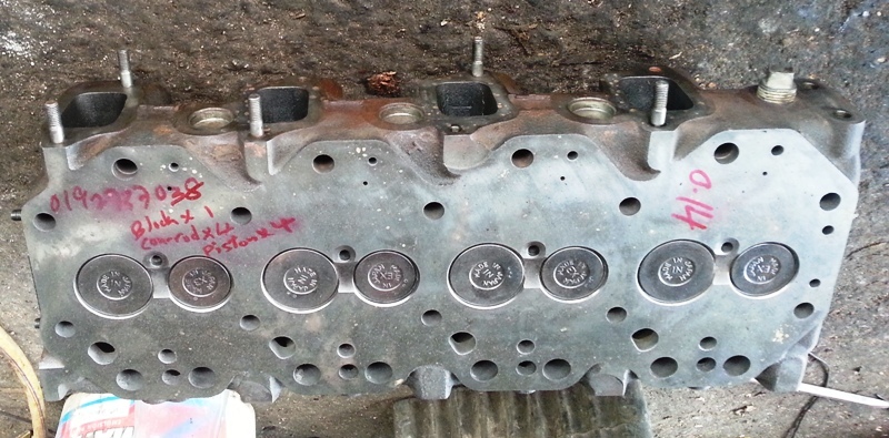

The Head ready to install

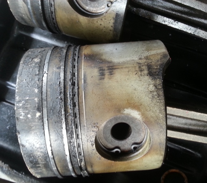

The old remaining pistons some small signed of oil being a little hot at some stage.

Then the issue the bearing shells for the crank despite them being standard will not let the crank rotate. We untorqued it redo it and just tap the bearings down only two and then it will not turn again. Inspection of the shells shows they slightly different shape to old ones despite them both being STD and different brands sigh.
