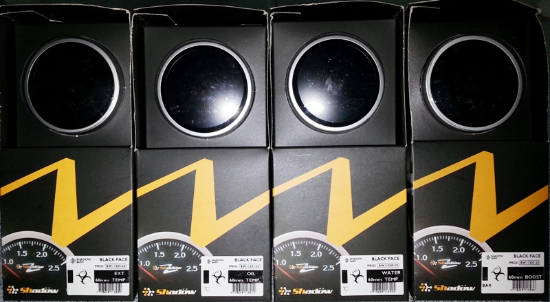

New gauges finally purchased for RED today. EGT, Oil TEmp, Water Temp and Boost. Ended up costing me $1200rm or $360USD. for www.shadowmotor.com.tw gauges.

Yah and easily readible even with or without my reading glasses on which these days is very important.

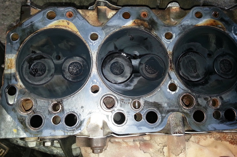

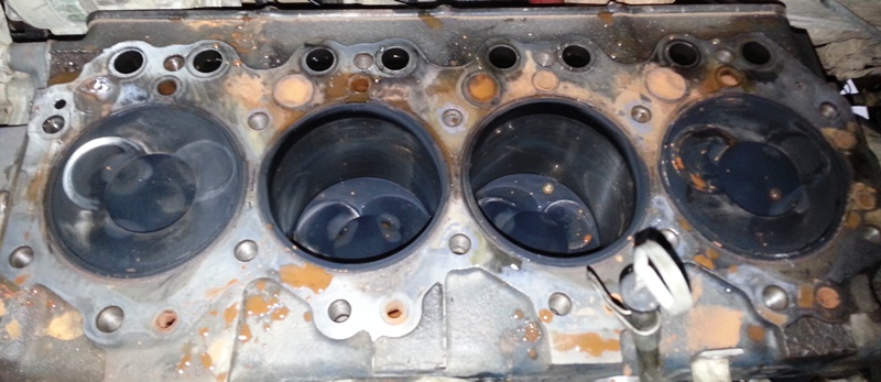

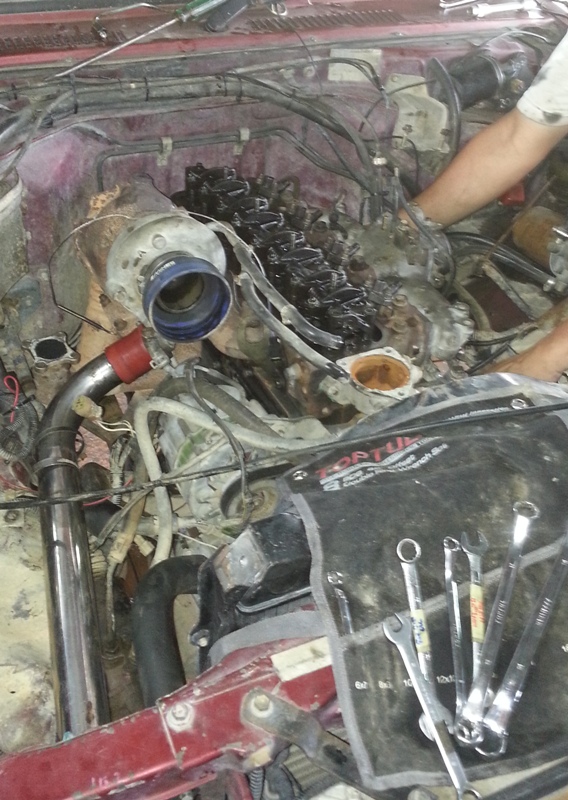

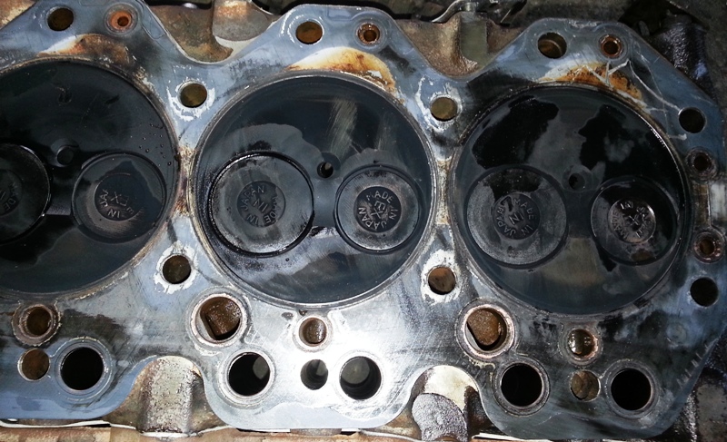

7. After lunch started stripping REDs 13B-T down slowly stripped around the head and fianlly lifted it. BINGO we could see the noise. YEs the valves had touched the pistons on pistons 1 and 4 mainly. WE measured the head gasket and the old one was 1.65mm and the new one was 1.35mm. Monday we will know what we can buy here to provide a solution.
Pictures of the damage
Two of us dismantling the engine.
The head after removal
The Damage on piston no 1 can be seen the shiny ring - oops all the pistons have a little ring on them

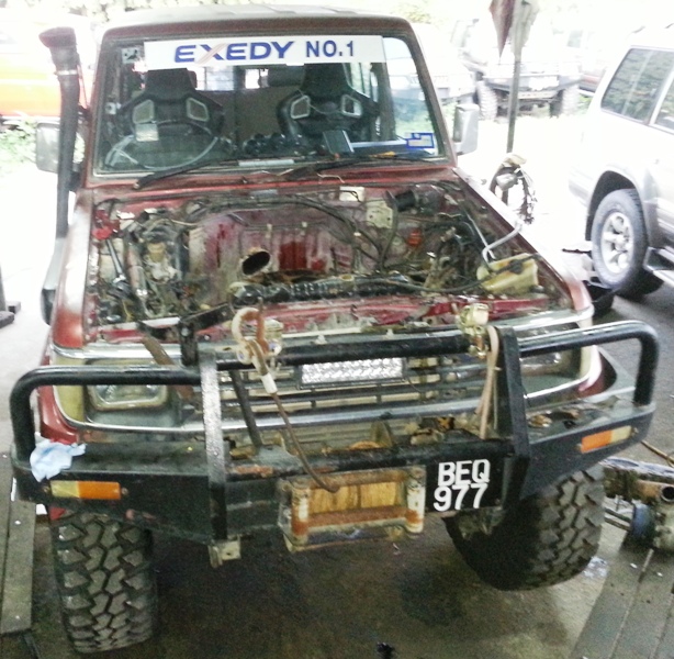

All alone in the workshop poor RED. It has to be mobile sunday for a 3 day trip monday morning 7am 300k away.
Worse I know its going to be heading to RC 2013 in December as Mean Mr MEtcalfe asked me for a vehicle to BORROW.
No offence to you, but thats just bloody sloppy workman ship and i'd be looking for blood. If you get it going for your trip, after the trip I would open the motor up again and give it a good check. That kind of issue can damage over things deeper in the motor, especially since it is a fresh rebuild.
Not looking for blood no blame nothing just getting it running is priority.
I kinda hoping no other damage long term
