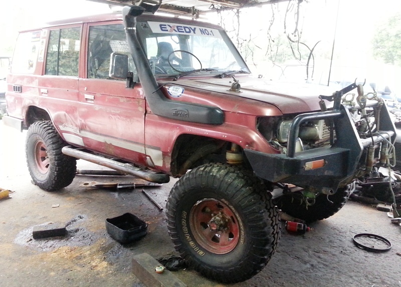

The gearbox was a decision I made based on it being put into RED 5+ years ago and it was never rebuilt and it was second hand from JAPAN so no idea of the K's on it then its always had a SNICK going into 3rd now its getting worse and sometimes has trouble going into 1st unless you double clutch and 2nd so I decided to puill it out and rebuild it now. Since I drive this truck hard it has to be rebuilt. Unfortunately its digging into the Volvo restore funds.

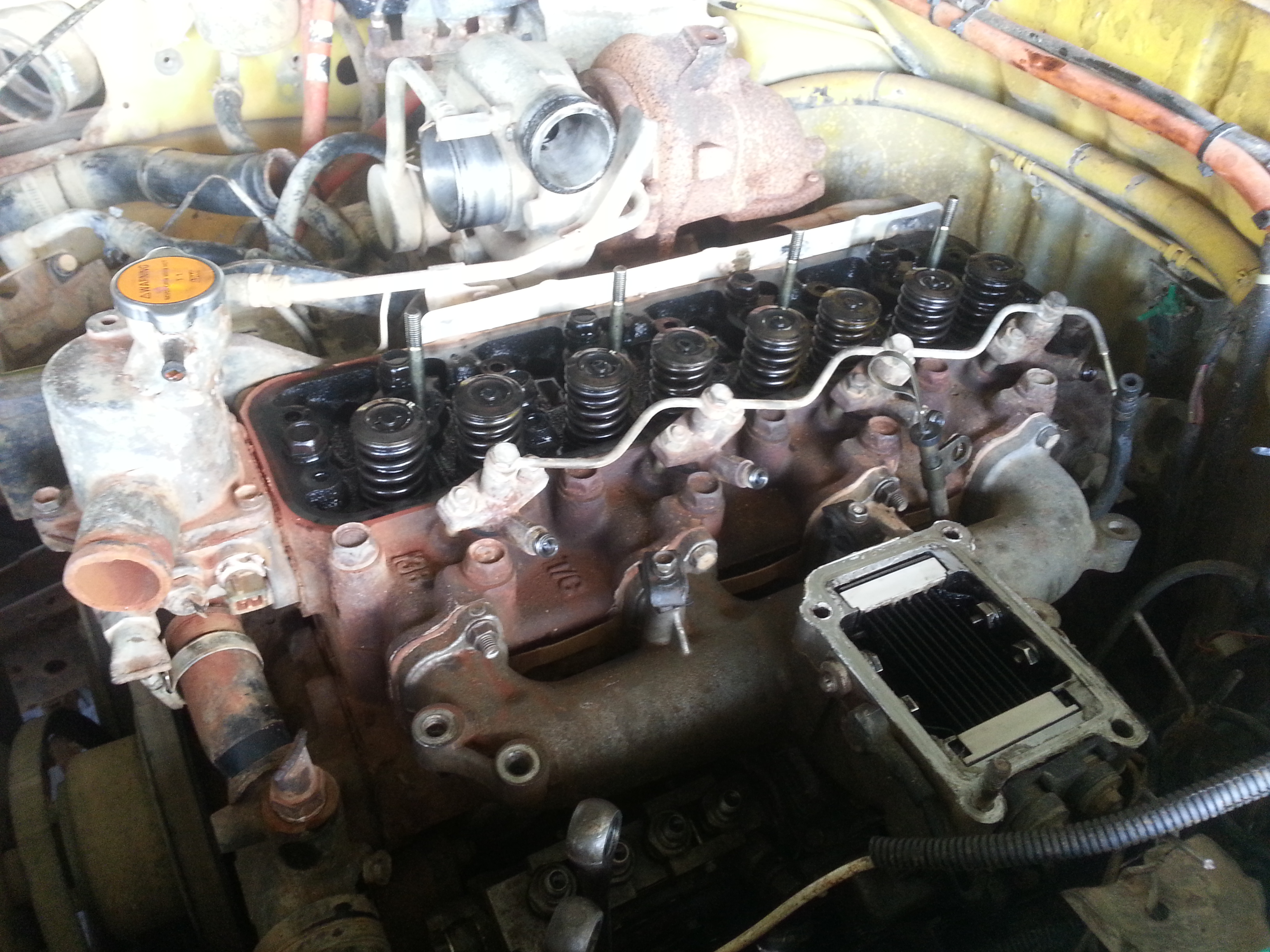

Gave the Rawang Hospital a ring saturday lunchtime - got room for another YELLOW needs a head gasket or more its going through 2 liters coolant per 50k - I will come out and strip it for you also. OK
Park the truck at RAWANG hospital and then time for LUNCH GOTOY paid as he was collecting his 15B-T Shorty - Thanks gotoy nice lunch.

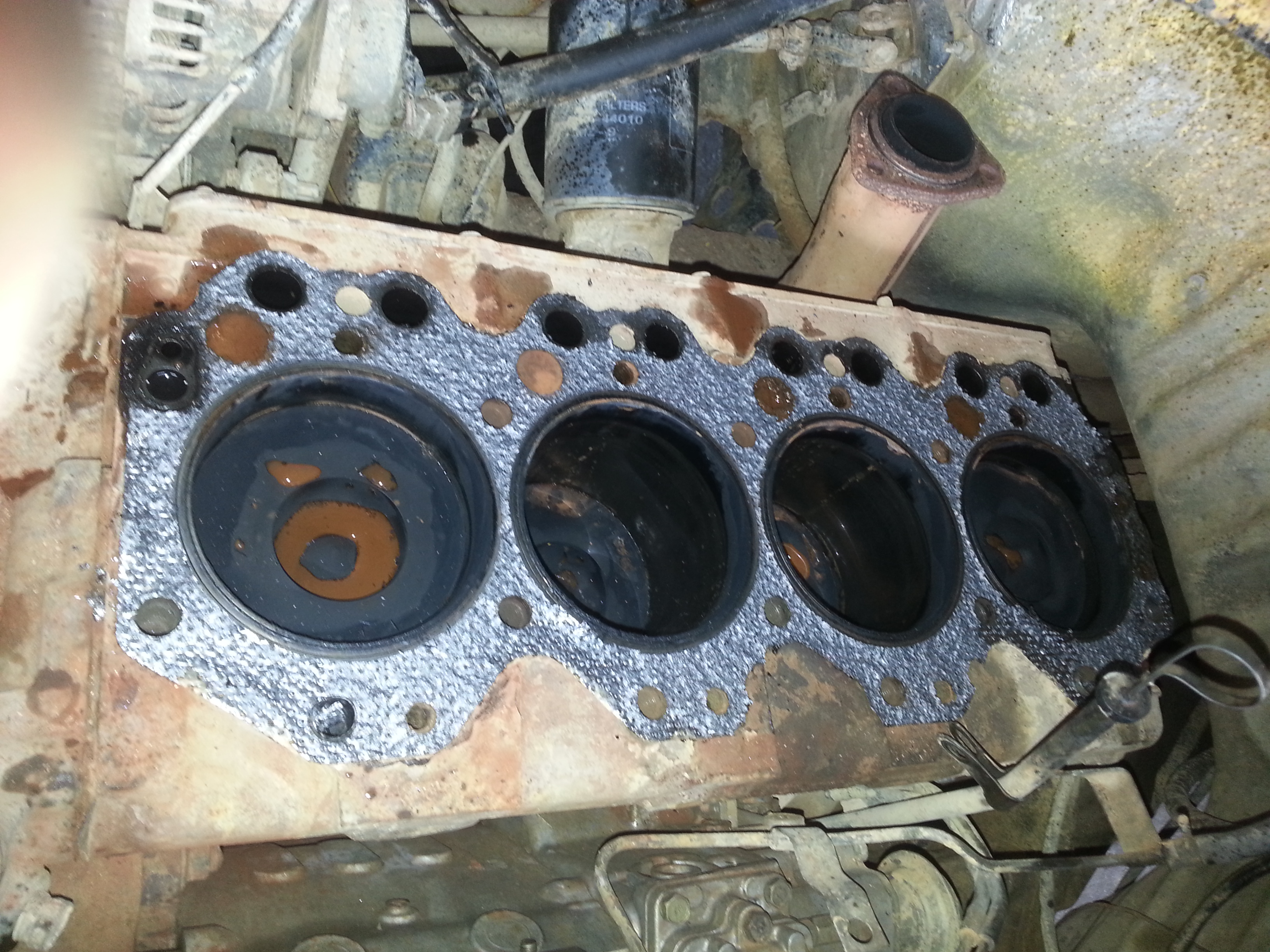

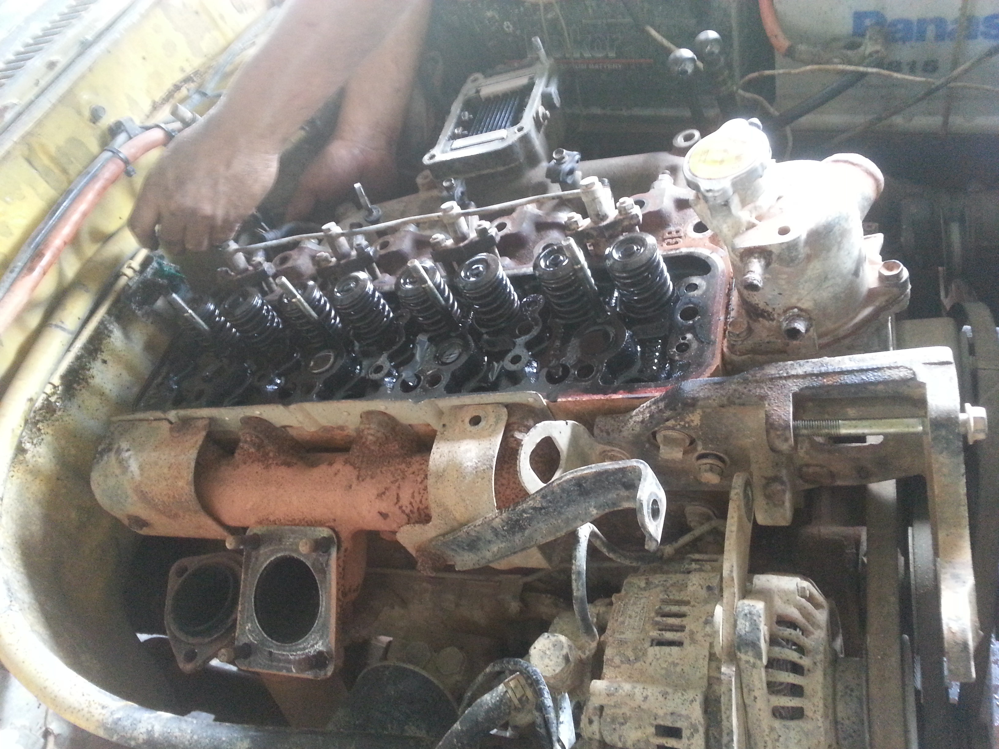

Once back from lunch time for strip to commence on the still hot engine

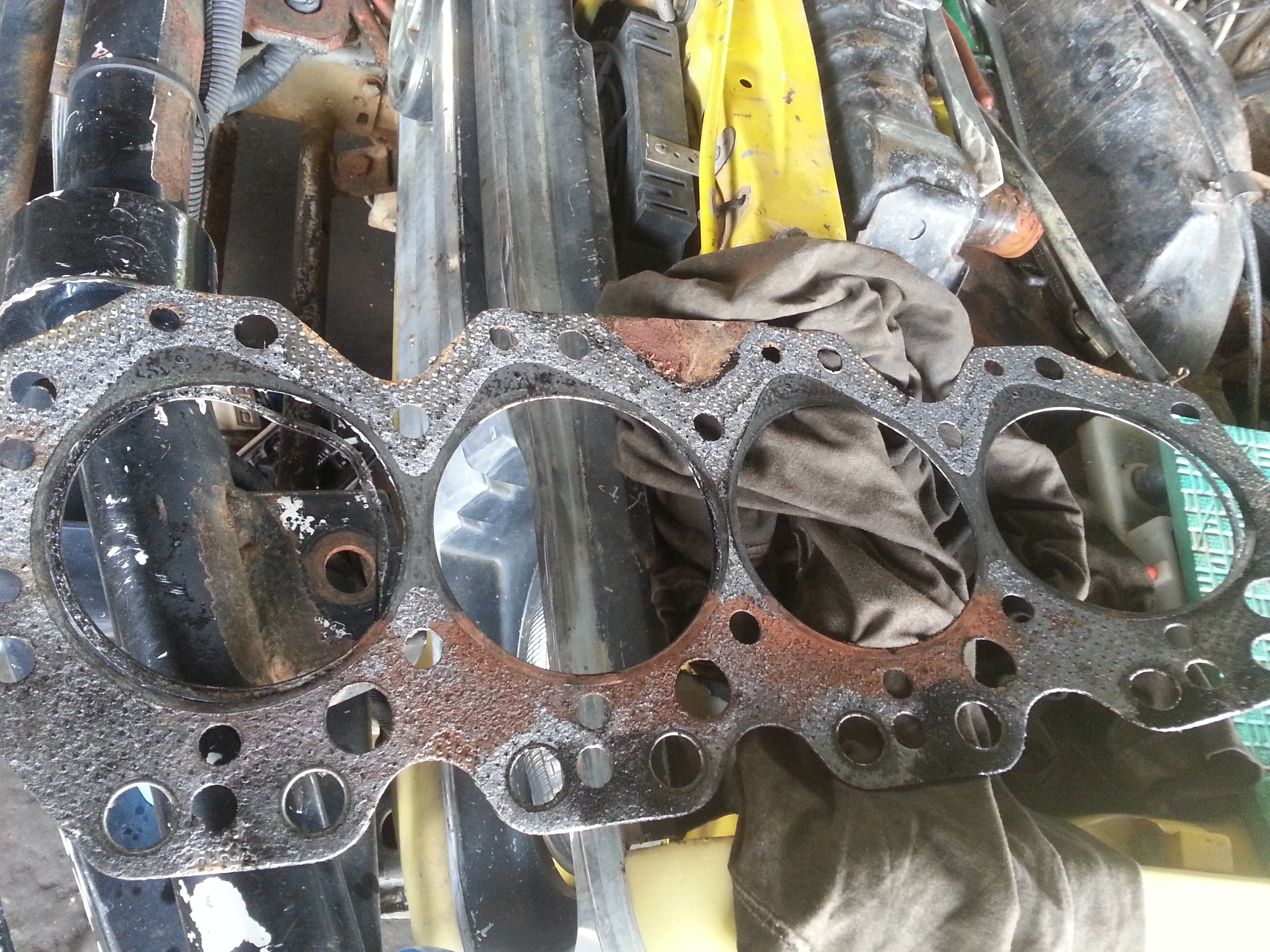

then the head off and the issue was found a PAPER gasket looks like from a 3B was installed last year when the head gasket was replaced
The Paper Gasket with water damage in it.

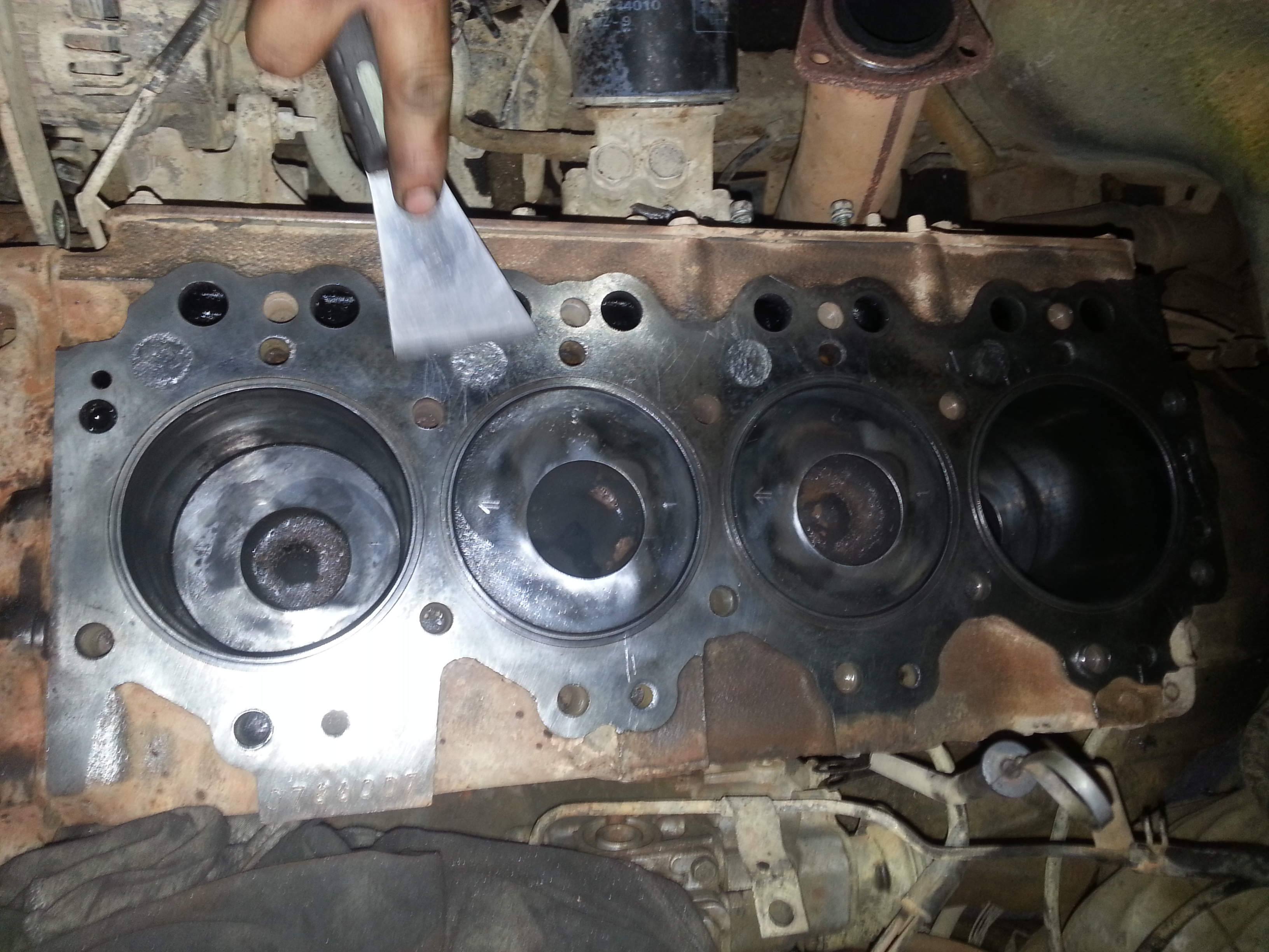

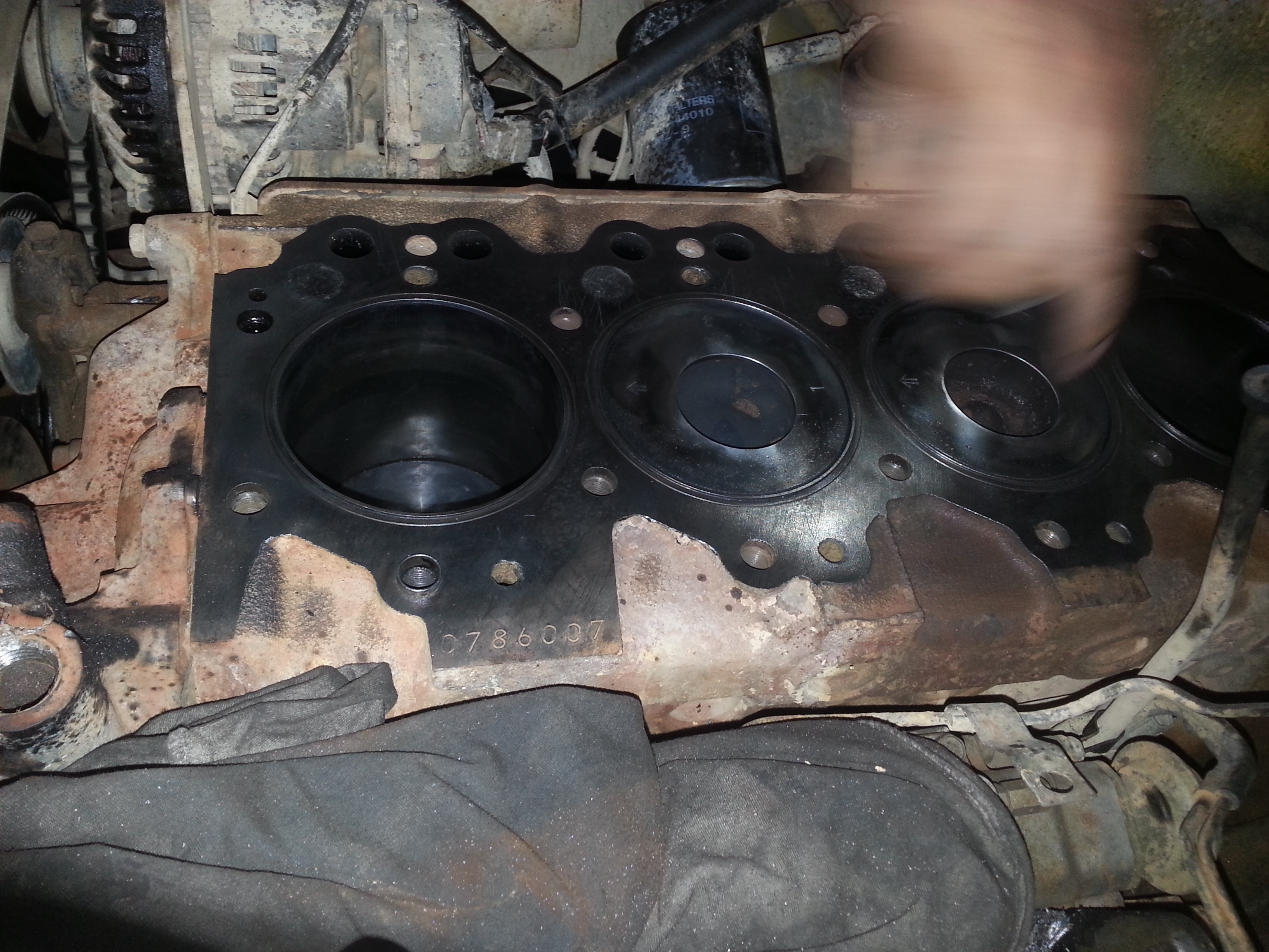

Then time to polish it up ready fro the head to go back on next Saturday
Signs of water pitting the piston on the piston tops looks like we got it in time.
Turbo is fine, Valve guides are gone, HEAD Presure test to be done and new guides fitted then it can be installed next saturday along with a 13B-T STEEL head gasket this time - this might help anyone else with a 13B-T - I do not know if parts shop or workshop fault doesn't matter it will be fixed better this time.
