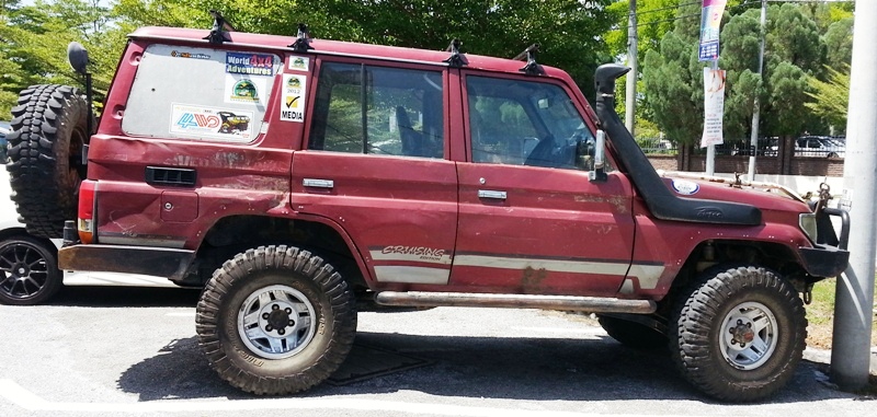

Then I happened to ask the doctor have you any rims i need 4-5 as the current Steelies cannot be balanced anymore one needs 2.95kg and 3.05kg on it to balance it and the car shakes still 60-80k even after the balancing and swapping around of rims. Wow he had a set of original toyota rims. Bargin price was offered.
So I fitted them (the old steelies in bad shape bent and dents all over them) and wow what a transformation. RED now steers nicely and appears to be lighter on the steering to drive.
Here it is looking "nice" and regal with its new sneakers
