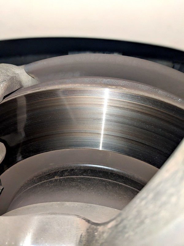

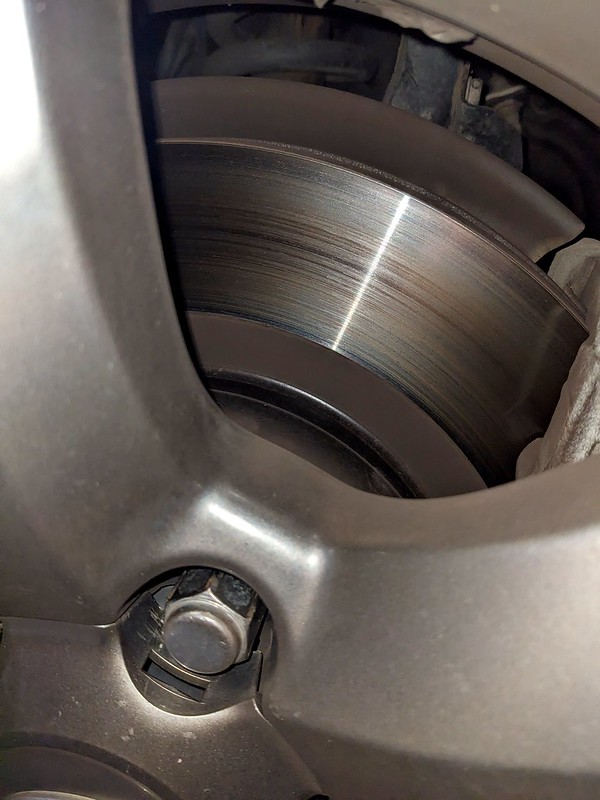

Busy couple of weeks but I'm getting back to this thing now. No real improvement, my stready-state HWY vibration is noticeable but not severe since I switched from the Coopers to the Michelins. My brake pulsation is just as bad as ever, big vibrations when going to the brakes on the HWY and severe pulsation at low speeds, you can feel the brakes grabbing/releasing when coming to a stop. While doing an oil change today, I did take a closer look at the brakes and front suspension and think I have a path forward, but would love to hear some more feedback from others.
Brakes:
  • Some interesting deposits here, more on the front than rear. The pads / rotors have <5k miles on them, they were EBC Greenstuff pads with the EBC rotors. I think the deposits could be contributing to or causing my pulsation issues. The EBC pads supposedly don't require bedding because they have a friction coating of some sort, I'm wondering if something went wrong there and that coating is cooked onto my rotors, causing the big pulsation
  • I haven't had a chance to put a infrared thermometer on the brakes, but don't have any real reason to think I'm having a caliper drag issue- I can get 18.5 mpg on the hwy, which seems to be pretty good from my experience. I'm not opposed to changing calipers, but I need to see some indication of drag before throwing parts at it.
  • Next steps on the brakes will be: Machine the rotors and replace the pads with something more conventional. I still think these are under-braked (and under-powered, and under-engineered, and economically coated) and I'm not convinced that stock pads are the right call for the long run, because I do think they are at risk of being overheated easily. Anyone have any input on replacement pads for these rotors once I machine them?

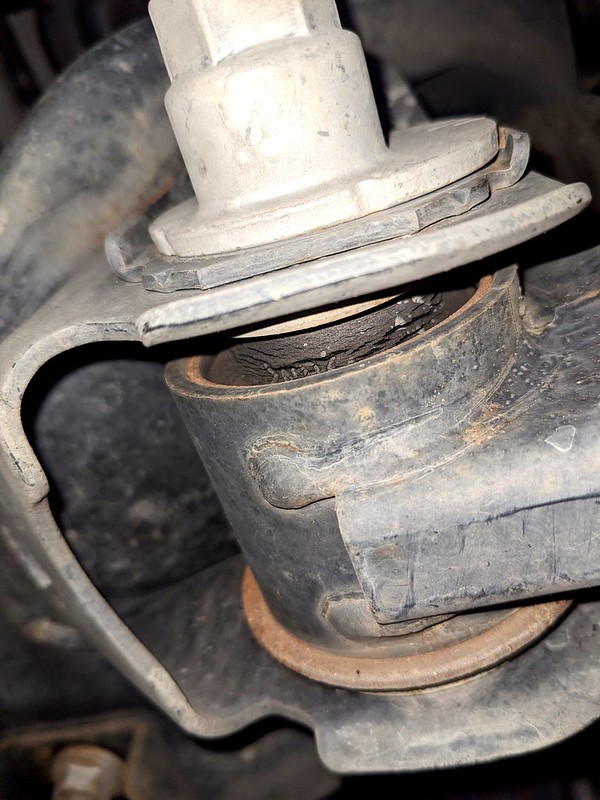

Suspension:
  • Can't feel any suspension play @ 12/6 or 9/3
  • I do have a slight clunk when turning into parking lots or driveways, in addition to the vibration @ speed
  • LCA bushings have some visible cracks, ball joint boots all look pretty old and cracked. All bushings look pretty similar to the picture
  • Next Steps on the suspension will be: Upper/Lower control arm replacement, inner and outer tie rod replacement. Not going to do hubs unless something feels really rough or scratchy when I pull it apart. Hubs and steering rack bushings are on the radar but not going to spring for that until I replace the previously mentioned items. Anything else I should replace while I'm in there doing the arms and TRE's?

I replaced my pulsing brakes with stock rotors and pads. The parts on there were 1/4 worn stock parts. I carefully bedded the pads in, taking care to not stop with the brakes on while the rotors were hot. Bedding in made a noticeable difference. While the brakes are not as good as the brakes on my Golf R, they're not bad for a truck. I live on a steep twisty road and the brakes do fine on it.
I ended up putting new OE rotors and OE Akebono pads on the GX and it fixed the pulsation. I think the ceramic pads were the issue, leaving an uneven film on the rotors. Listing this thing for sale now that it's vibration free!
