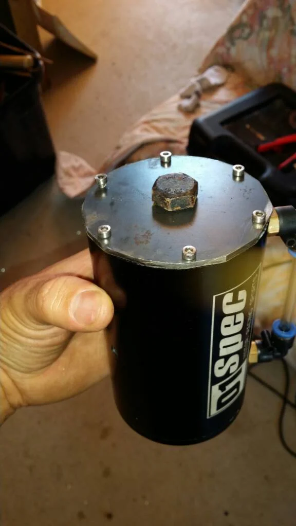

I'm going to have to bore out the can to take bigger fittings, I'll take some pics, I meant to take some as I was going fitting the parts but I got carried away, you guys know know what I mean :)

Some pics of my modified catch can, I made a new top plate with bigger fittings (brazed some 3/4 copper pipe) will have it all plumbed up when I get some heater hose Monday

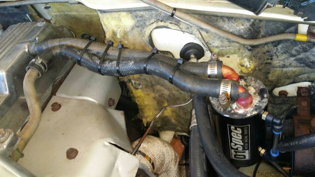

Catch can Fitted.
back hose is straight, front hose is off a Hyundai (rubbish tip custom)
the can is just hanging there resting on ac hoses, it's not going anywhere, I'll just cable tie it in place, too much mucking about for the bracket (read: I'm too lazy to fit it properly...)
