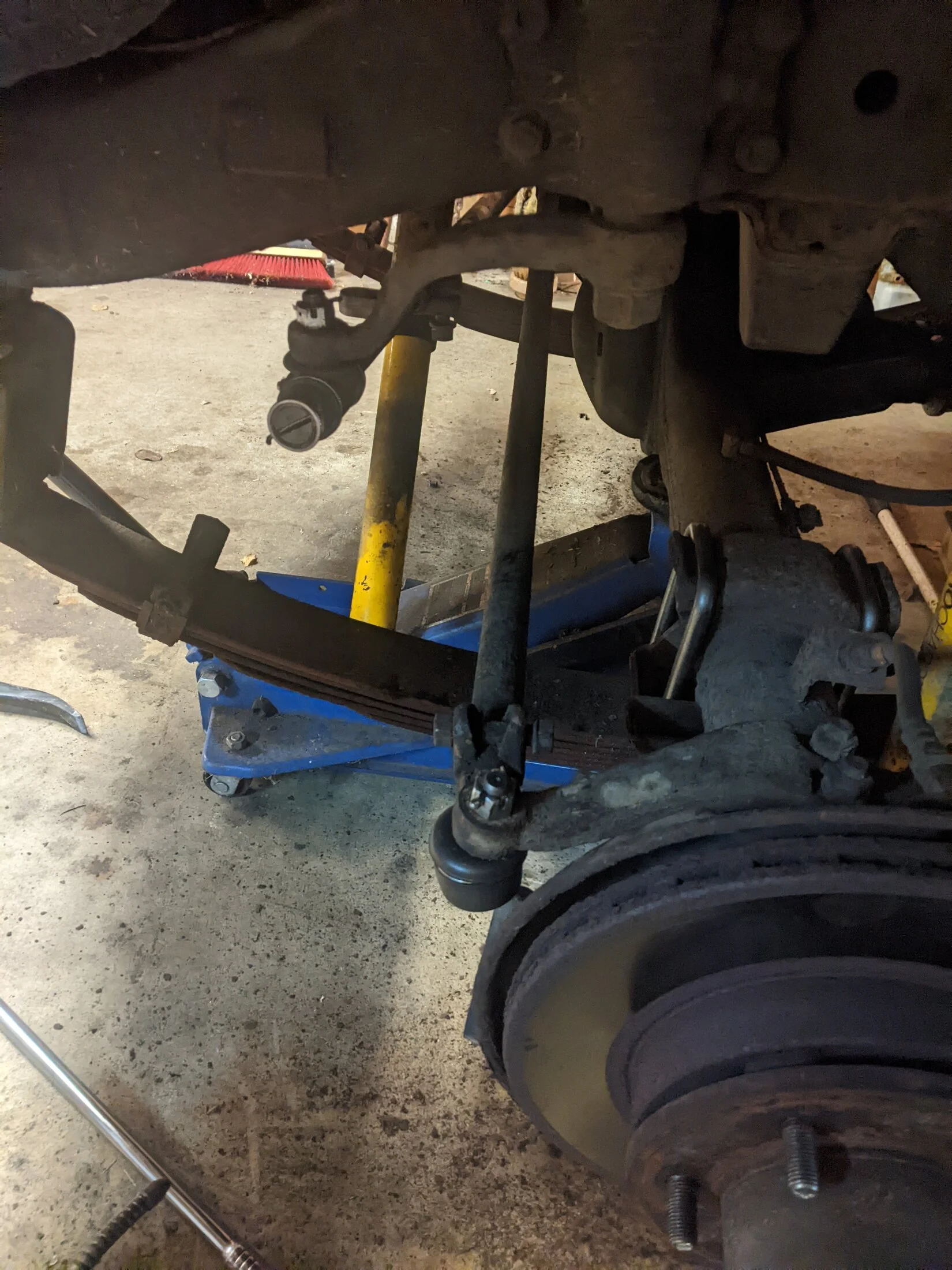

Looking at rotors , driver's side is good enough to just bang in new pads, but passenger side is pretty ****ed. So I'll just do a full brake job and replace them next week .

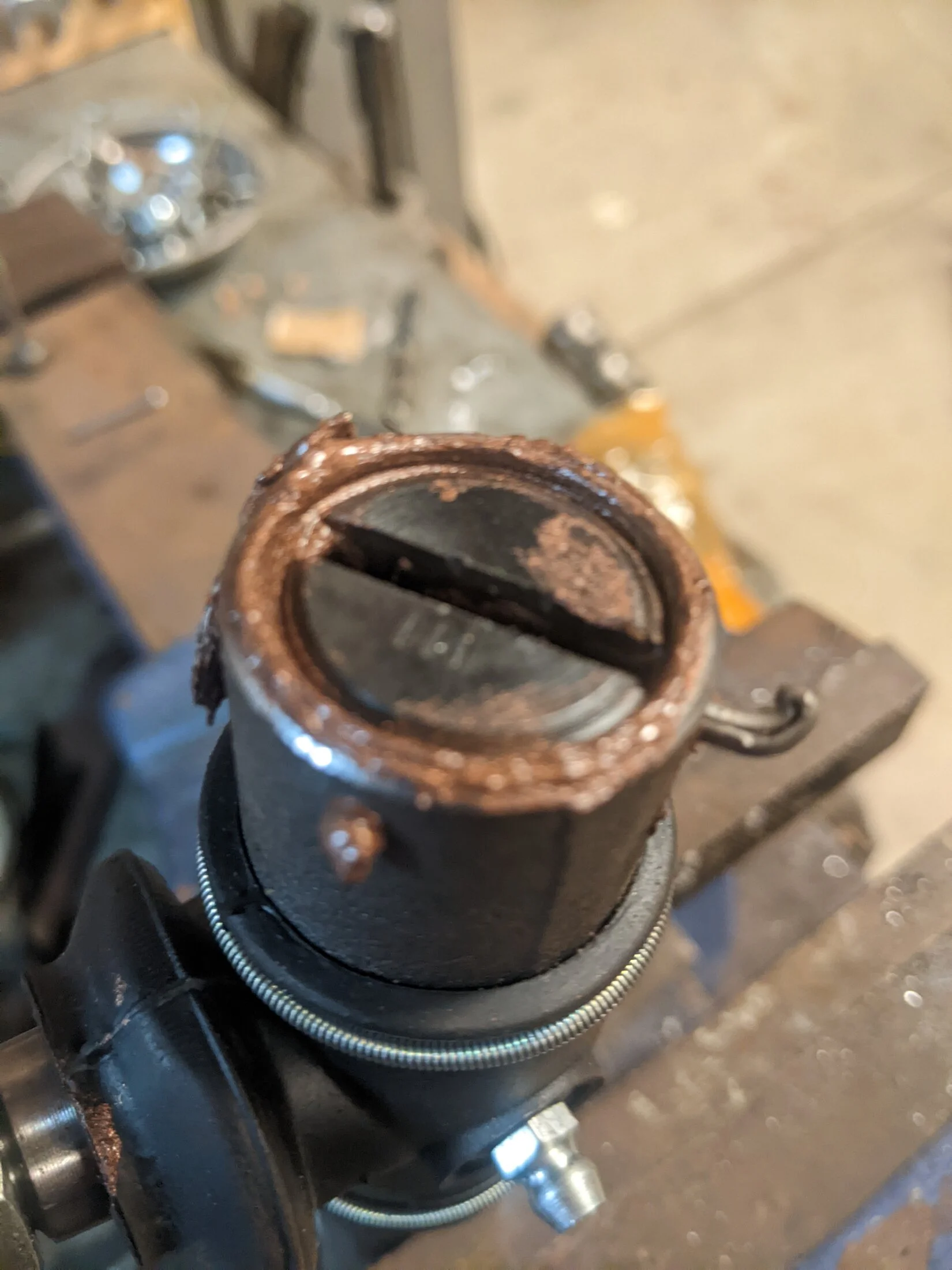

Might throw these in today tho. Mine aren't terrible but the one on the steering box is pretty loose and the adjuster is seized, so ****it.
No sense saving them.
Always a slight worry when buying steering parts from aus they'll be upside down, but apparently I got the right ones. 🤣
The tres that were in there were off the blue parts truck, so mileage unknown, but they seemed pretty fresh at the time I did the LHD swap.
I did this to the adjustable links so that they hopefully don't seize up like the old ones did.
And now just an alignment and see how far off the steering wheel is.

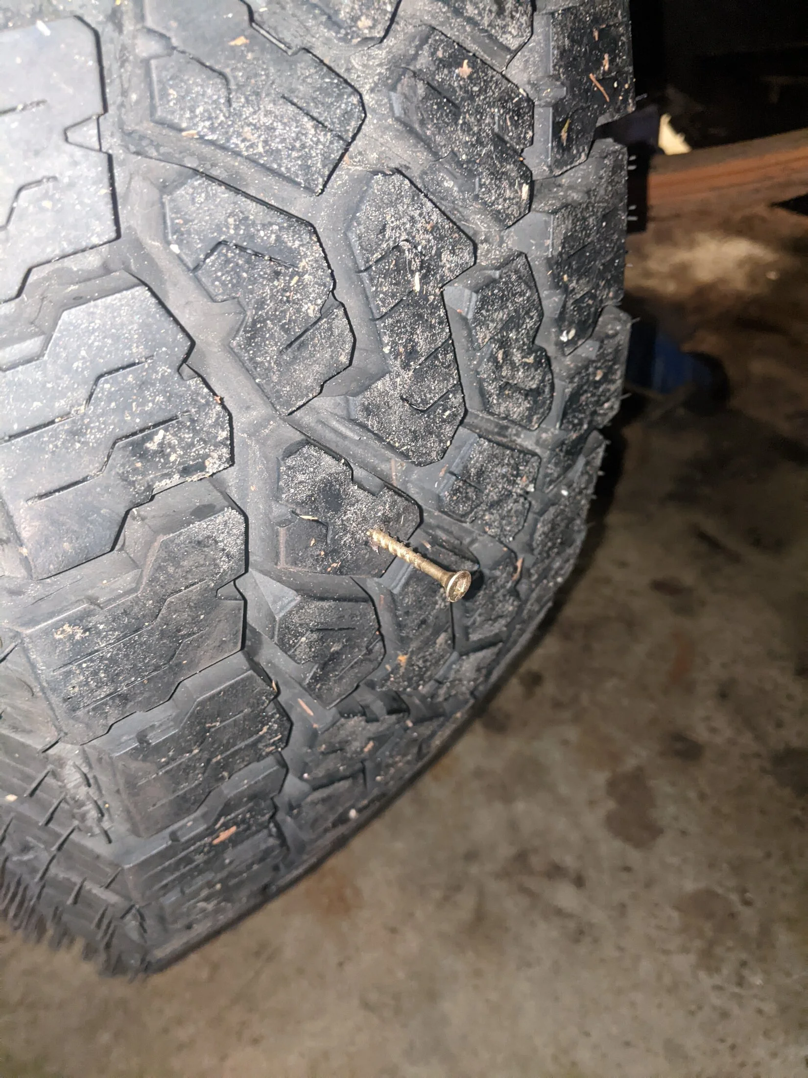

Siping is useful...just don't forget to take the screw out a****** 🤣

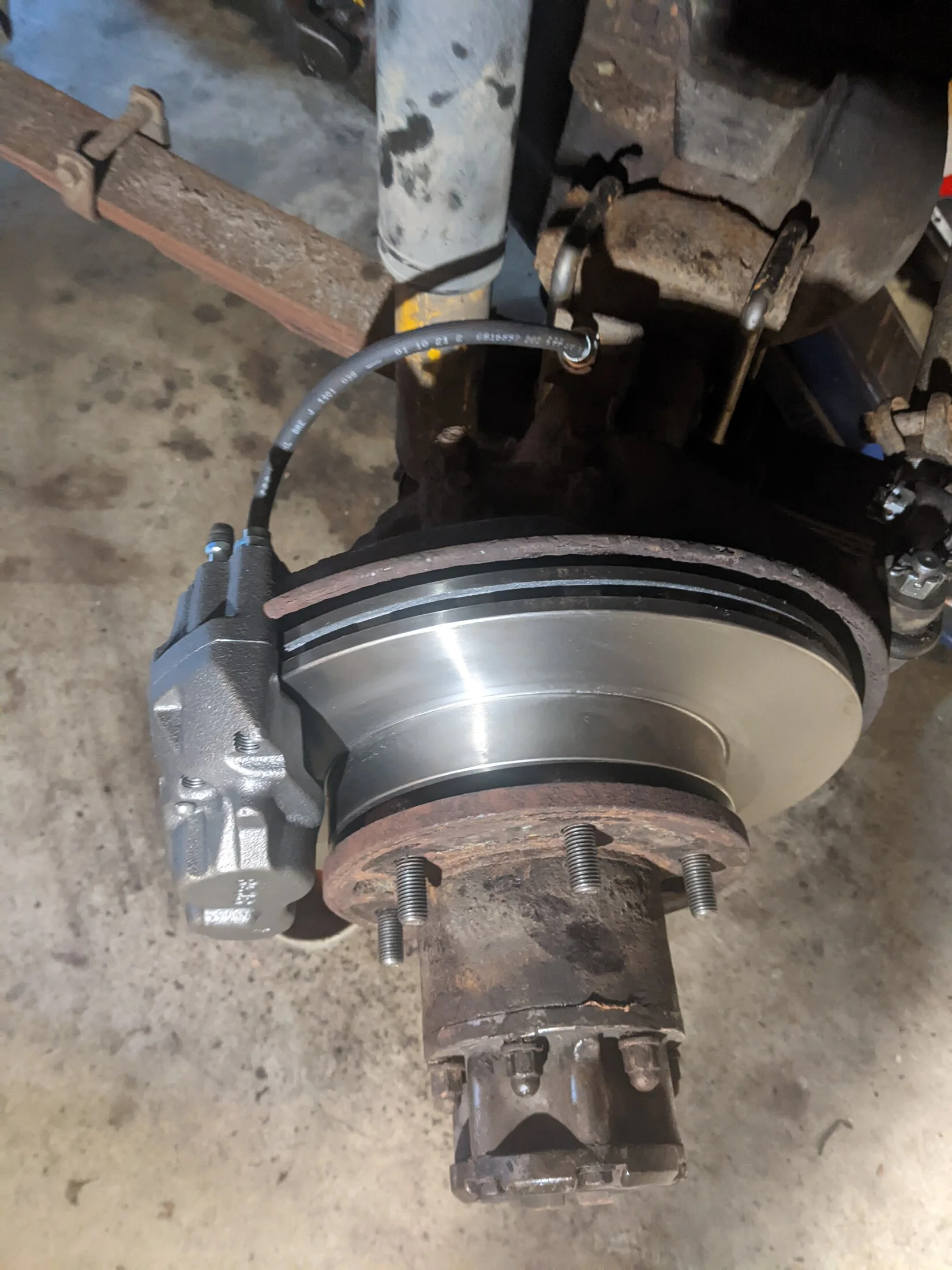

After several visits and even more phone calls I managed to finally get my rotors from lordco. Fecking morons. 🙄
Anyways. Half done. Hose straight to caliper seems to work. I'll have to make a new axle hard line. Probably for the other side too...but they're probably overdue. :meh:
Apparently the last time I did brakes was June 3, 2017.
So 7.5 years and about 110k km. Not bad I guess.
Probably could get away without replacing the other side, but feels wrong to no do both . Not bad to freshen up the wheel bearing grease if nothing else.
New rotors are 20mm, and they say minimum is 19mm... I wonder if they used to be thicker or if there was always just 1mm of wear (allegedly) allowed

Measuring the "good" rotor, it's about 19.5mm if I don't measure in the divot. So yep, it was ****ed too.
