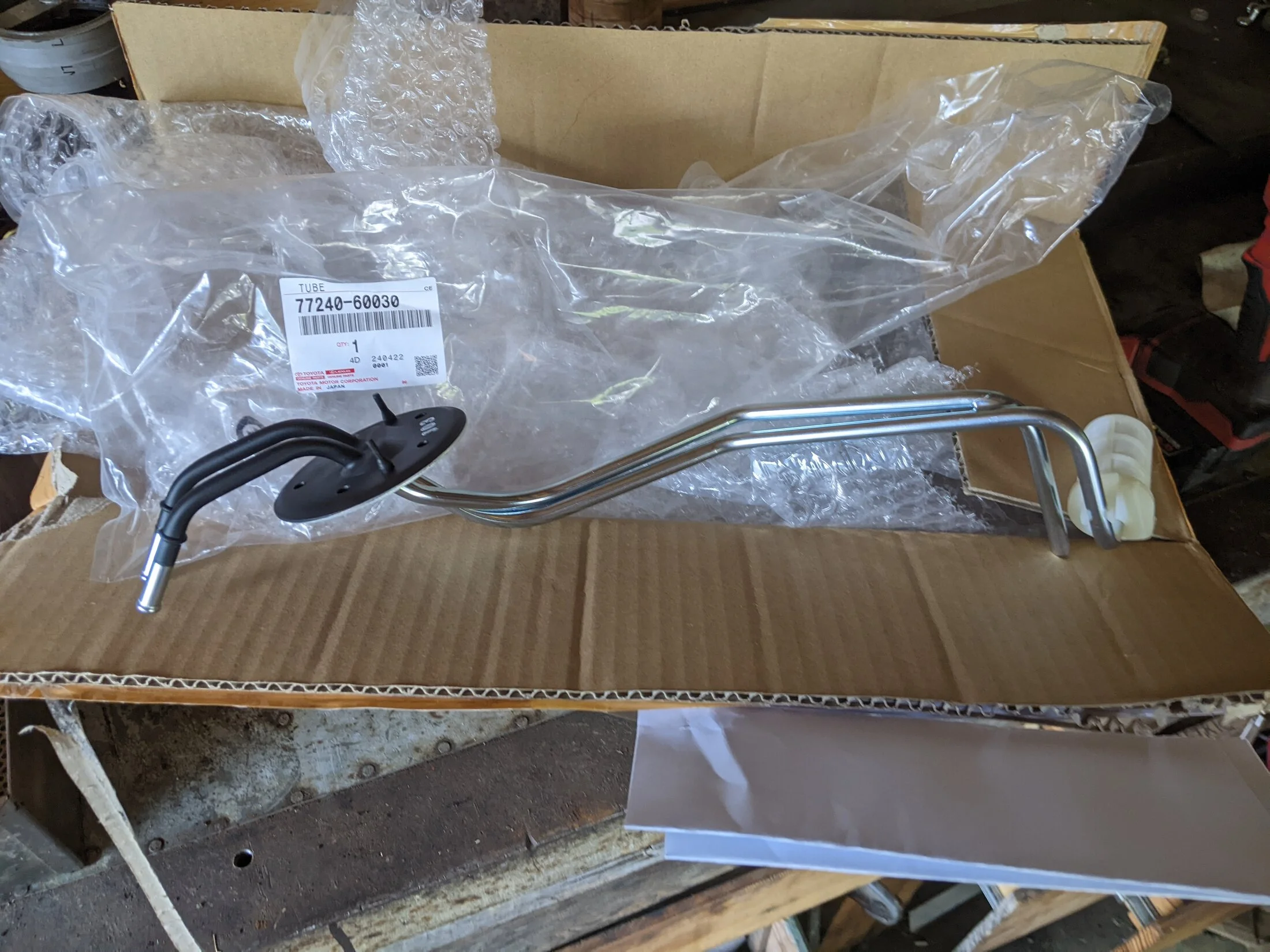

I ordered a new supply/return fitting just now from partsouq.
Seems like everyone who owns a 60 has had the supply rot off, so I'd prefer to avoid my time in the barrel 🤣

The part was weirdly cheap on partsouq
Like 1/3 of megazip....so I'm waiting to see what actually shows up. Could be a gasket and a whiff of fresh desert air 😂
Well, 23 bucks for the part, 17 shipping from Dubai and I didn't even get dinged for duty. Not too shabby.
Tubes are way more horizontal than I anticipated. Does make me wonder if it's the right one, but I guess it is a pretty flat tank.
We'll see. Can always bend to tubes if it comes to that.
