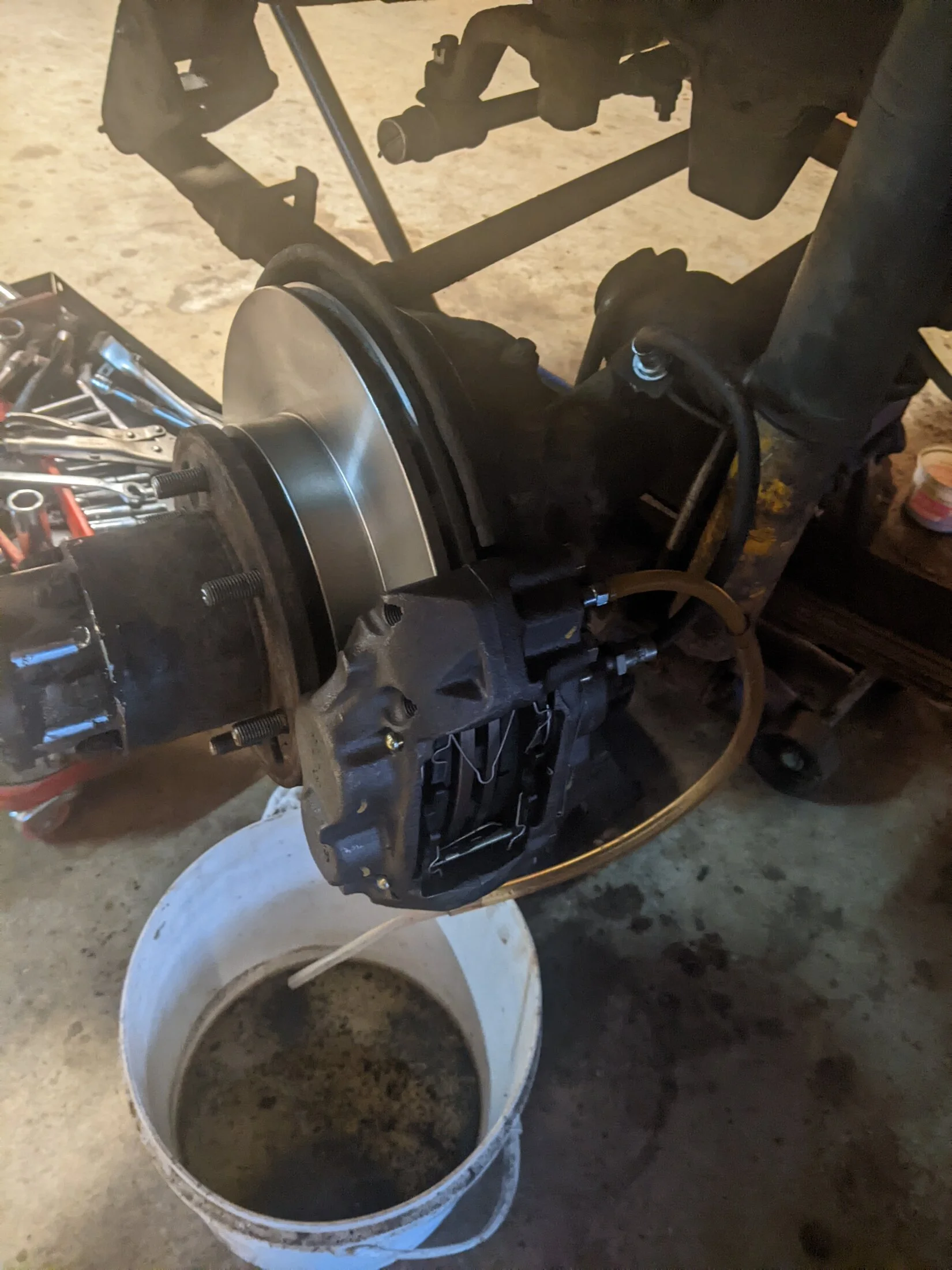

And that's enough of that bull**** for today. Bent up new hard lines so hopefully they seal.
Tomorrow some bleeding and I'll recheck the toe. The wonky rotor made it hard to tell if I had it right.
Always felt like that hard brake line to the calliper might be there to keep the rubber line from lighting on fire in the rare event of a stuck calliper or over loaded downhill braking situation.
Im not sure it’s that relevent but the degrees of flex the rubber line has to do is much much more without the hard line terminating at the centre pivot point of the hub. Maybe more wear?
Also my personal experience is loose snow chains are much more likely to damage brake lines not tucked in tight to the hub.
It doesn't move much more than stock, but at this point I'm not really worried about getting another 35 years out of it.
As for snow chains, I have some. I hope to never use them. 🤣
I was thinking about this last night, and I'm pretty sure every other vehicle species I've worked on has had a flex hose right to the calipers. Hondas, Toyota cars etc. maybe even the big old Ford tho I can't 100% remember...
Usually with a banjo bolt tho, and it actually would be nicer if this hose had one too.
So I'm thinking the way they did it was just to keep it lowest profile possible, but chains on the front is a pretty unlikely scenario for me.

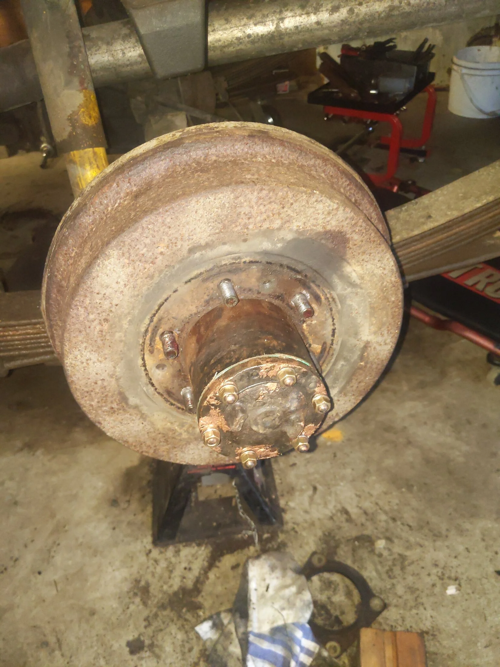

I've never touched the rear wheel bearings, but seemed like I should have a look after a decade and 100k + kms
Bought the kit 8 years ago I think 🤣
One side almost done. Gawd I hate drum brakes. Those ****ing springs....🤬

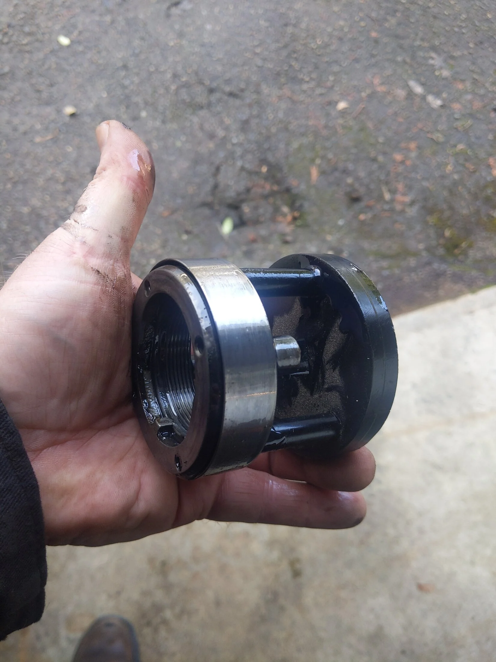

I'd almost forgotten I'd made these. Old bearing races with a skim taken off on the lathe. Awesome for putting the new races in.

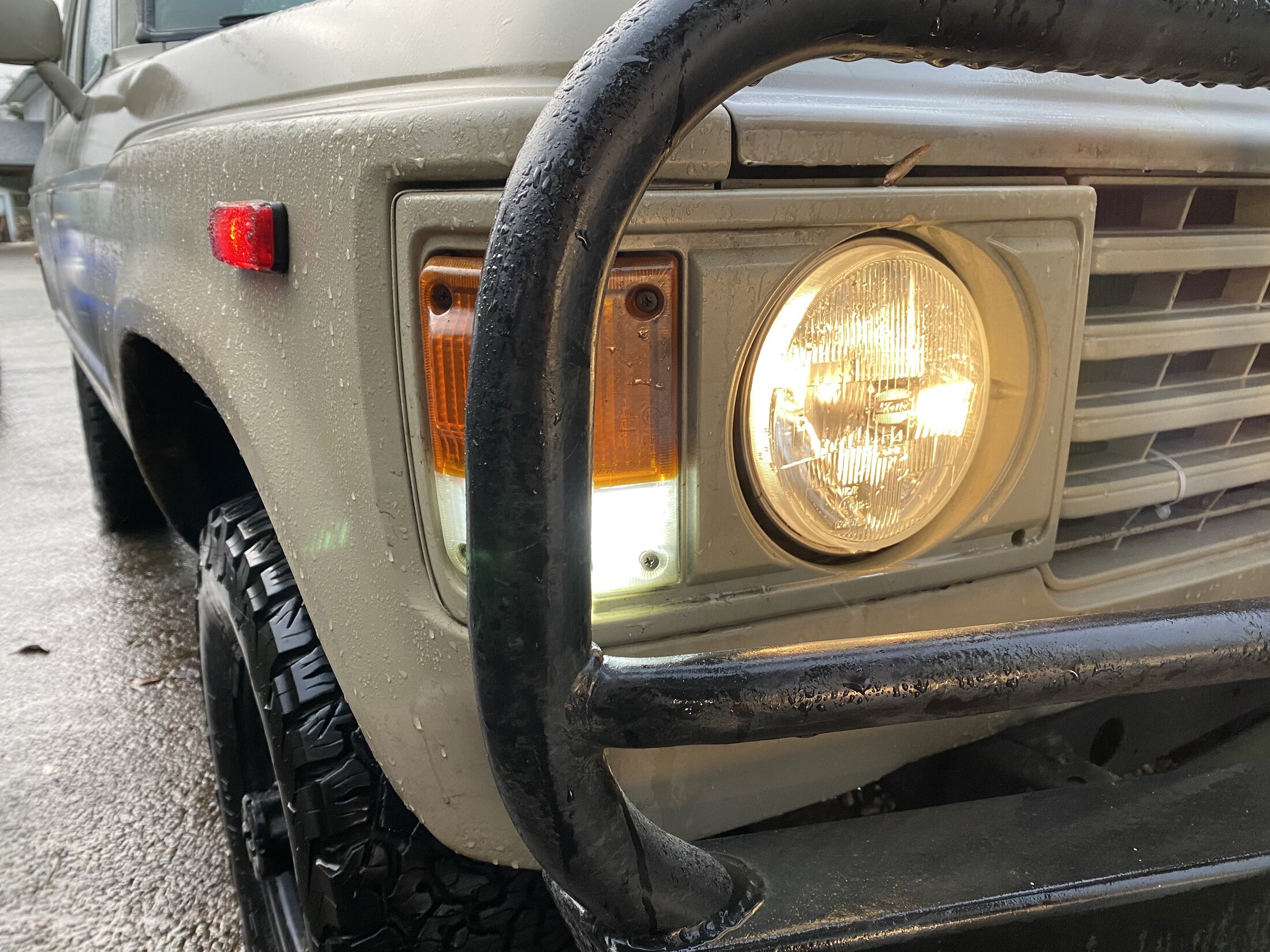

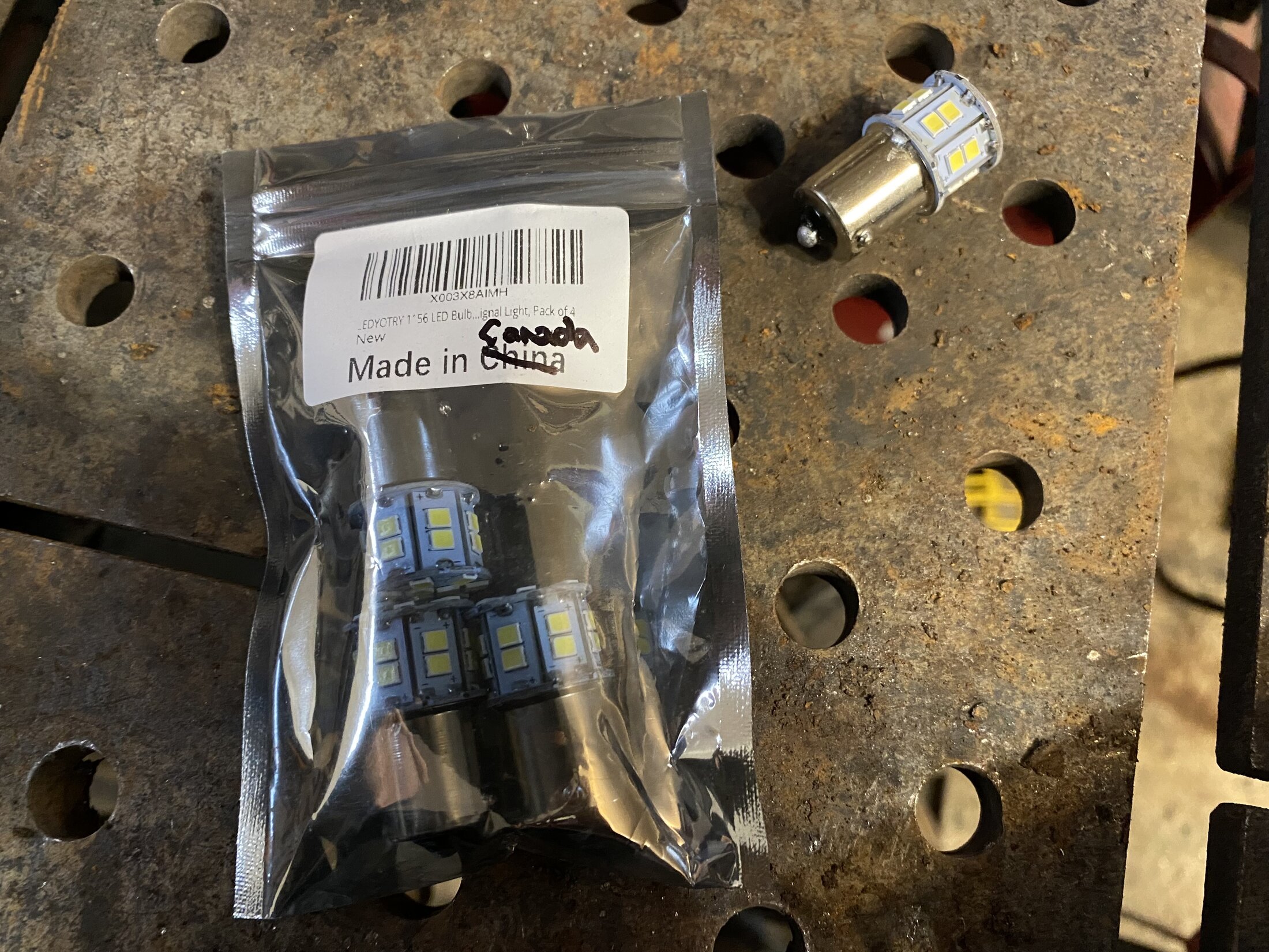

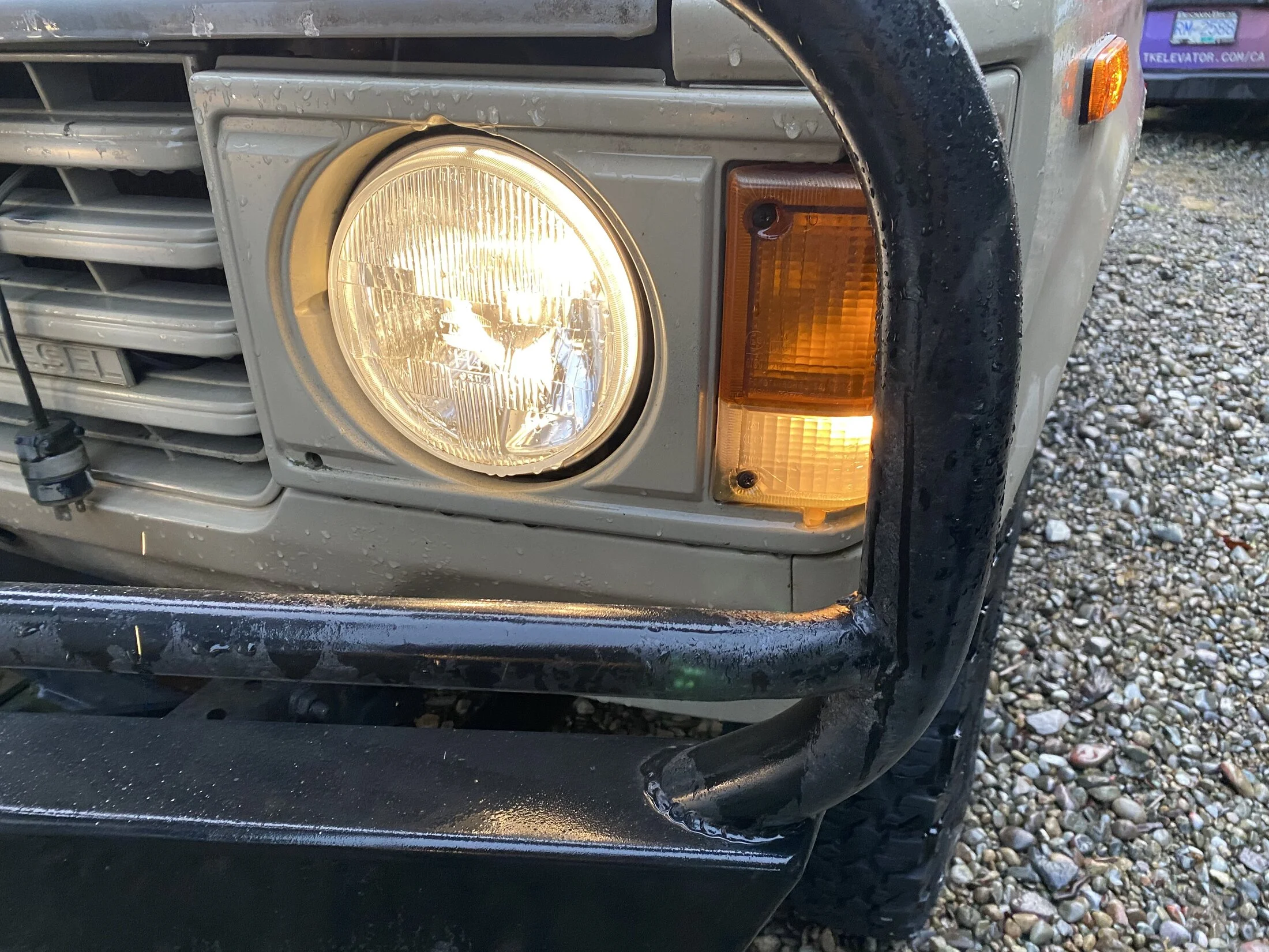

I ordered up those 12-24v led bulbs we were talking about to try. As luck would have it i burnt out a front running light on the recent super bumpy drive. Almost don’t need the headlights anymore!
Other side with an incandescent for comparison.
