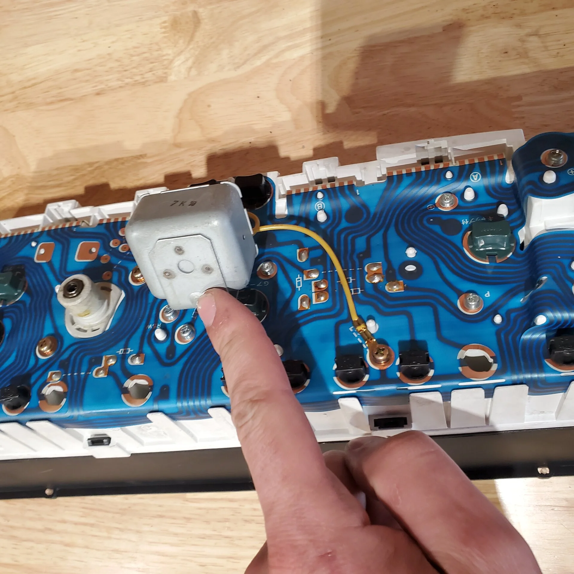

in my 80 I just pulled the Pezo speaker out behind the cluster
I pulled mine out from behind the cluster. '90 JDM Hilux. Here's a picture.
Once removed, no more 110km/hr ding.

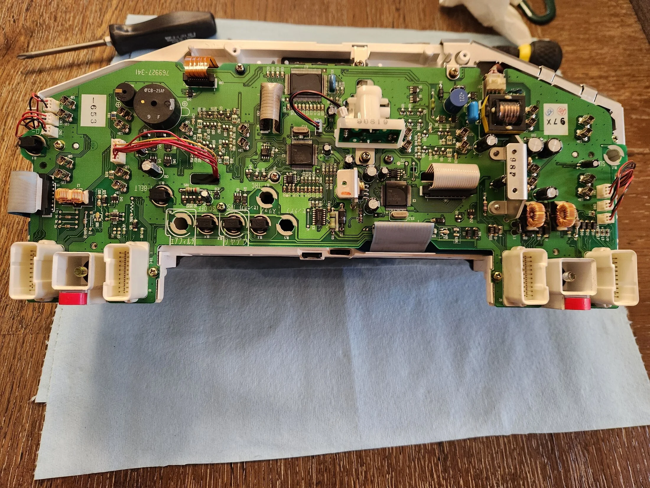

I have a HDJ101 that was imported from Japan with the same speed warning beep as in the video above except mine comes on at over 100km/h. I feel like the sound is coming from the combination meter as well since with the combination meter disconnected, the reverse beep which is the same sound doesn't work. I have taken the combination meter out but cannot find what i need to remove from it to stop the beeping. This is highly annoying. Has anyone found the fix?
