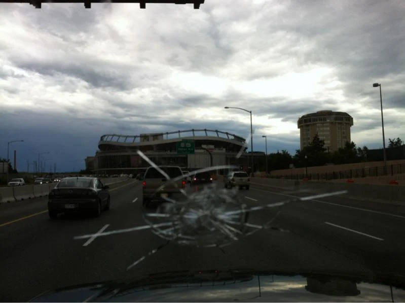

Just got my fourth windshield installed and the first non-OEM one. The insurance company here in NM won't pay for OEM glass, so it was either $1700 out-of-pocket for OEM or $250 for third-party. I figured I'd try third party since they gravel the roads during the winter here in NM. Based on reviews here at mud, I went with Pilkington glass instead of PPG. I inspected the replacement windshield before installation. It was optically clear (no blurring), had a bronze tint like the OEM, and designated places (w/ brackets) for the rain sensor and rear view mirror. The glass had pretty good thickness. I wasn't able to compare it to the OEM, but the thickness of the glass on either side of the plastic laminate sheet was respectable. Total thickness was probably around 3/16". It appears to be otherwise made to the same specifications (bronze tint, black border w/ the black dots, fit, etc). I went with a glass company that performs the installations for the local Lexus dealer so they are familiar with the rivets and dissassembly of the headboard and A-pillar. I also had them use OEM moulding pieces, rivets, and rain sensing tape, which they ordered through the local dealer. The vehicle was ready in 2 hrs. I drove it home on the interstate going 75mph...no whistling sounds, no rattles, vehicle is as quiet as before with the OEM glass. I can't wash it for 2 days, but will test out the rain sensing wipers after that. So far, so good. I'll see how durable this one is. The OEM ones are almost guaranteed to crack if you get hit by a stone within an inch of the edge of the glass (3 of my 4 OEM windshields cracked that way).
This was no rock. 2500 mile trip and this happens in the last 30
Wondering if the installer will know what it was, I can only guess a ball bearing of some sort dropped from an overpass
